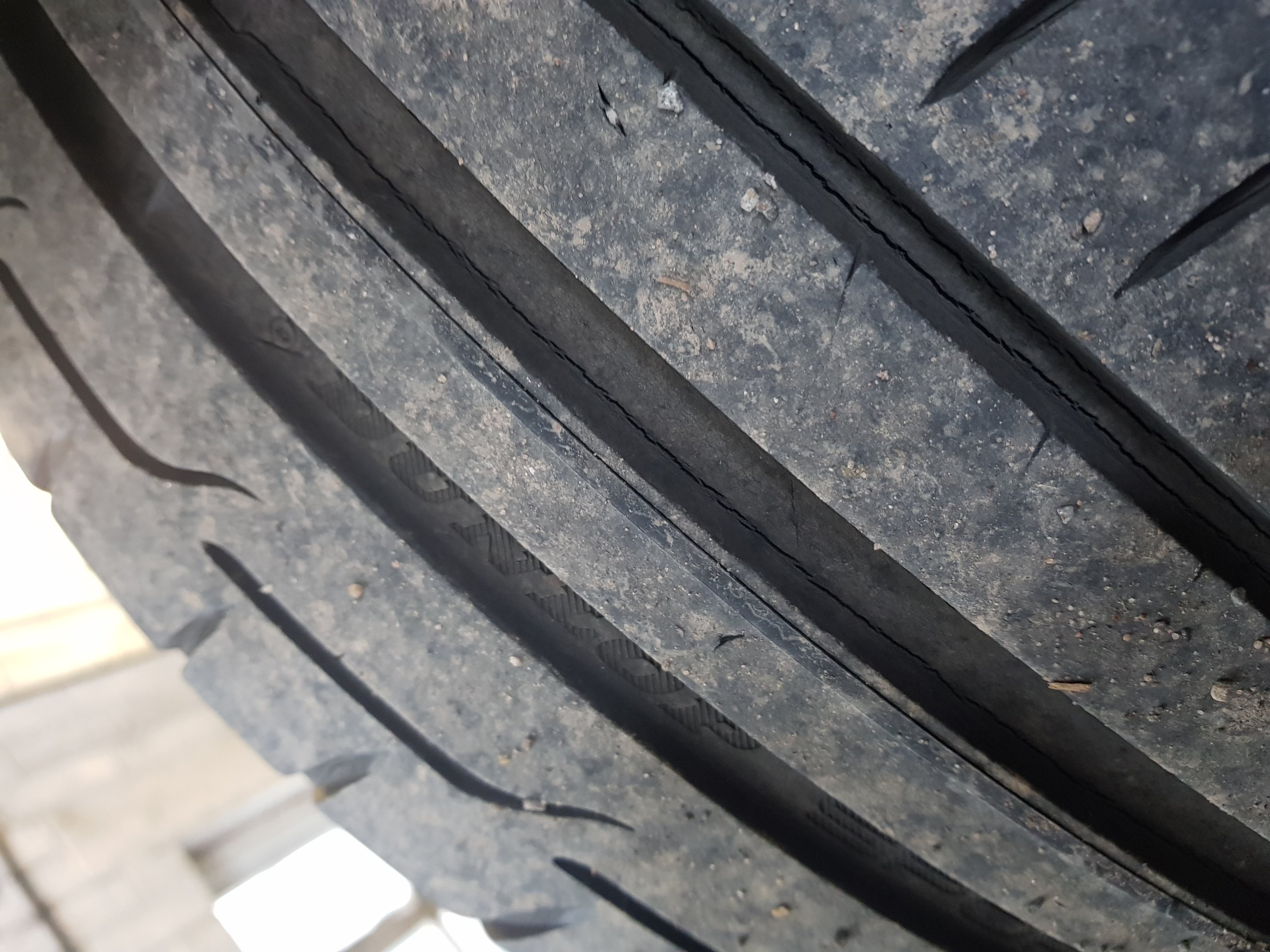

Cracking stuff ( see pic )
Car  clio 182
Dunlop Sport Maxx RT
1.5 years old
20,000 miles covered roughly
Should the rears be cracking like this?
Fronts were replaced recently and was advised these would need changing aswell.
Thanks
I've seen worse tyres . Its hard to tell from that one section in the pic . Depends who advised you if they genuinely mean it or are they just after a sale . As @imprezaworks says 20k is bloody good going for tyres . I'd be happy with half of that lol . They might be old tyres , as in when you had them fitted they'd been in stock a long time ?
I was hoping to rotate them onto the front, but will just replace them when I get chance. Was hoping to get another year at least because the tread is still 5mm+ both rears
@SamB123 Just out of interest . Where did you get them fitted and who advised you , you need to change them ? Was it one of the big tyres places ? Maybe try a small local tyre place and ask them their opinion if they need changing .
Interesting that. I'm pretty sure my boss's A5 had the same issue with a set of Dunlop Sport Maxx's. Also were only a year or two old at most and would be lucky if they done 5k. Think they were worse than that mind you.
I'd be inclined to just replace those. If they're on the rear of a clio they'd last about a million miles lol. Had a good run at them with 20k!
I'm not with the car currently so can't get manufacture dates, but I'm going to get then replaced soon anyway before they blow out. Cheers for your input guys

They're fine, it's just in the underlayer near the carcass, that's much harder than the compound on modern tyres and it's common for it to crack a bit as it ages.
