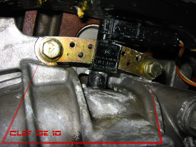

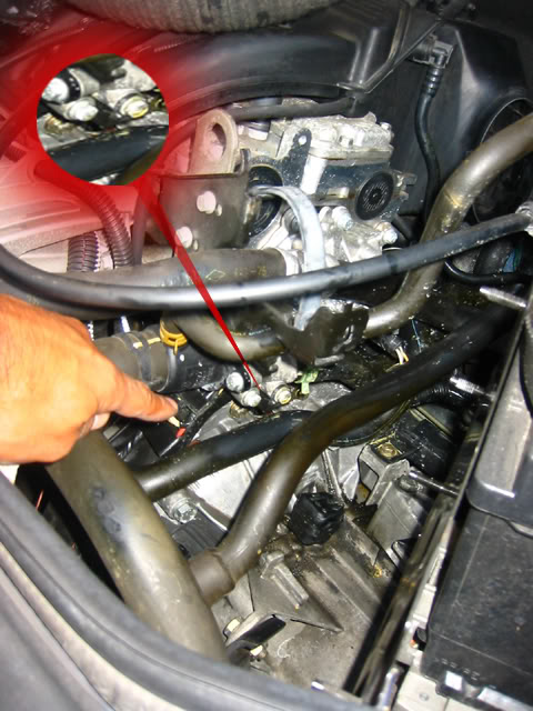

Rhys you need a 10mm on a socket ideally, and a little pick/screwdriver to remove the block plug from the sensor. Basically, remove airbox that sits above the bell housing and the block, you can't miss it, it sits right ontop of the flywheel.
Ignition off, remove airbox etc to gain access, remove 2X10mm bolts, unclip sensor. If you get one from renault you'll need a blow torch and a pair of wire strippers.
Where its located, on all clios.
What it looks like
