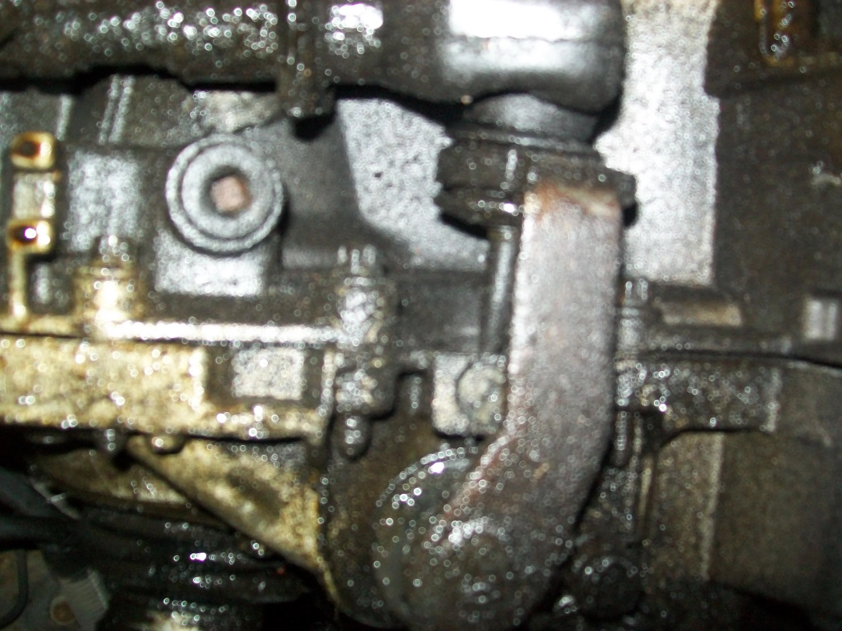

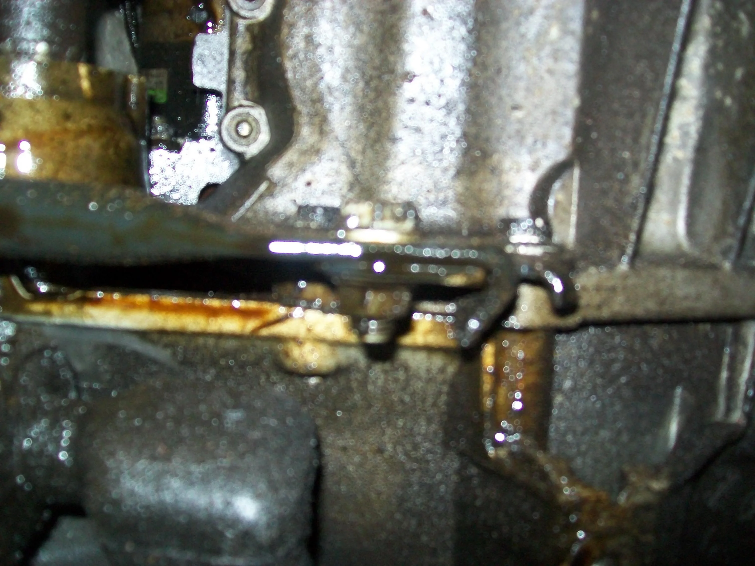

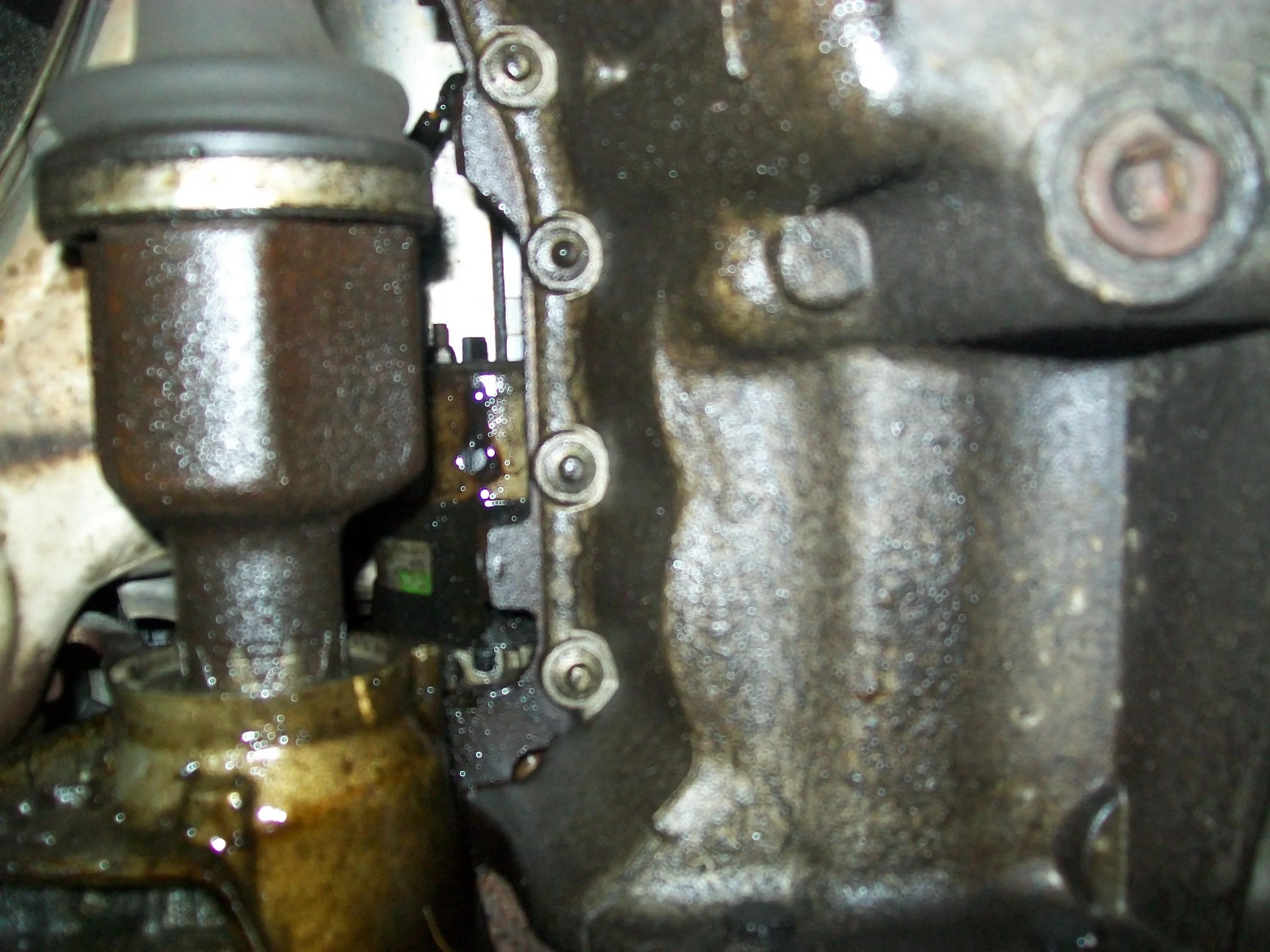

No i have noticed an oil leak but cant quite see where its coming from i took pics of under the car, dunno if anything can be made out from them but here goes.
This first pic is EXACTLY where the oil was on the floor

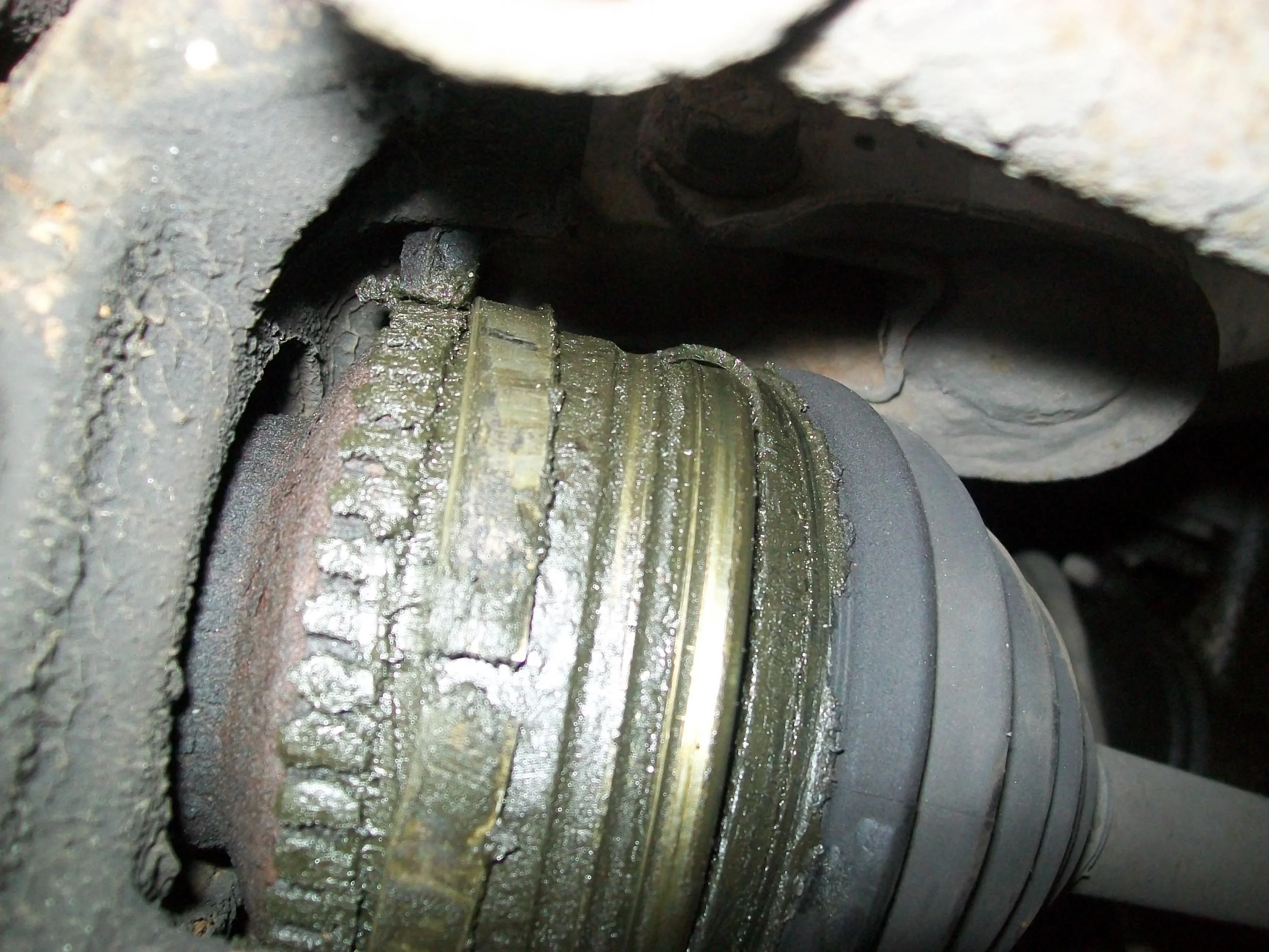

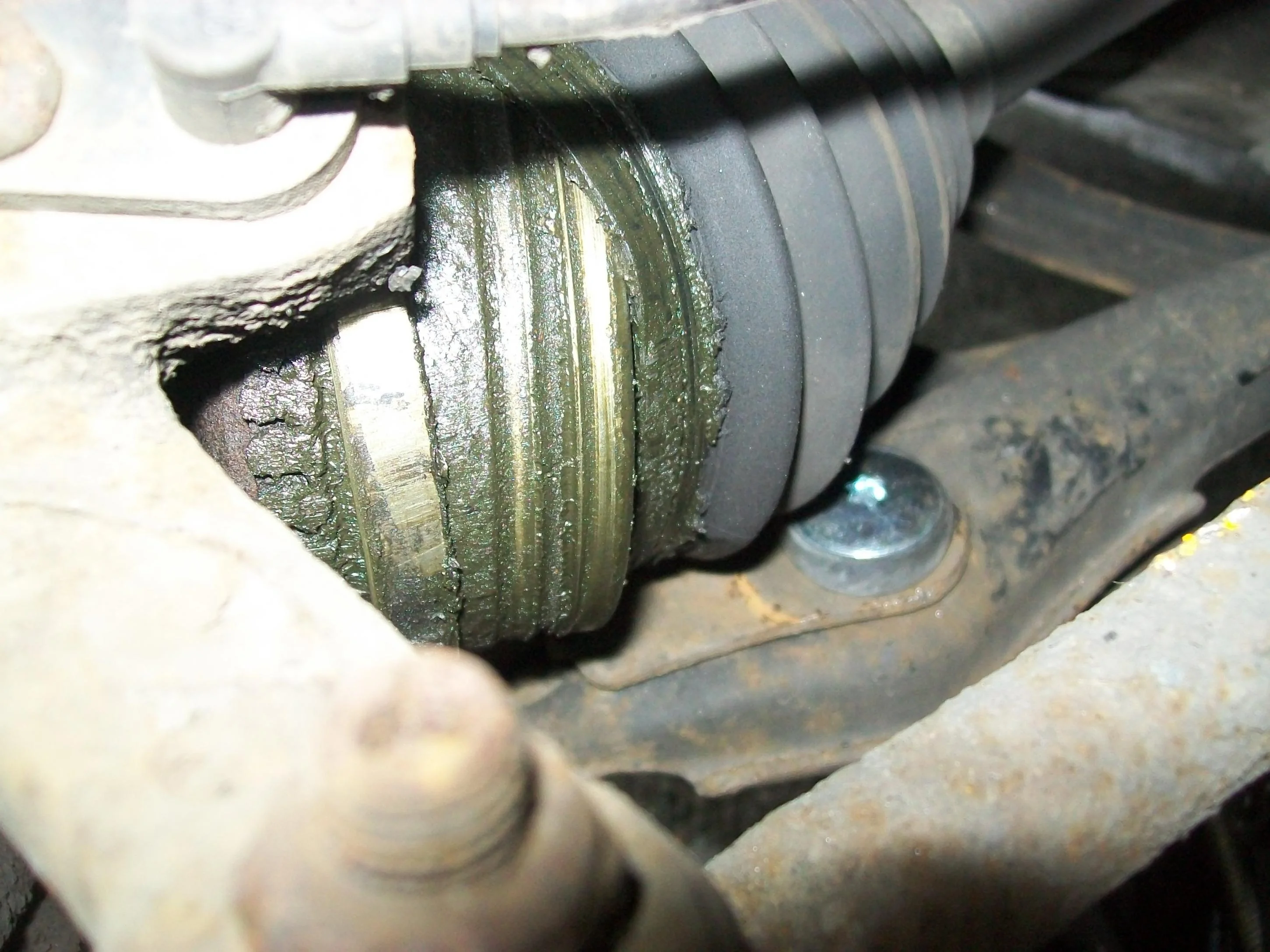

I also noticed the Passenger side CV Joint? was loose when the wheel was pointed inwards, how is this fixed and would this cause the 'Ticking' noise i am experiancing.
ok been told by a garage it is a leak from near the thermostat housing and will be £121 for the part from renault and labour, does this sound correct?
