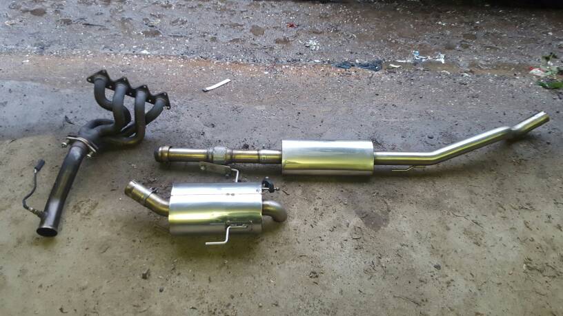

Give the PMS exhaust a wipe over as will be going on this week :)

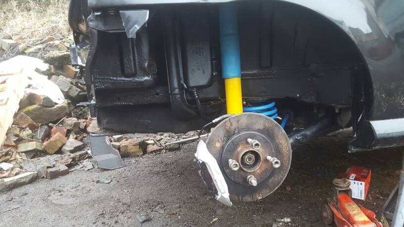

Spent alittle more time on the clio.

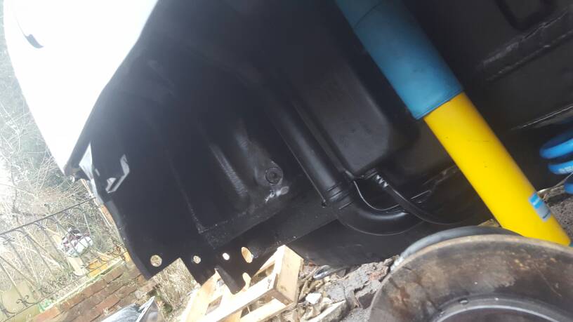

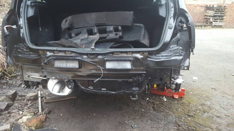

Swapped the rear beam for s low mile cup one with the cup stub axles also put 10mm 1 deg camber spacers on as i ad them kicking around.Removed the rear brake lines and levaler to swap for the cup lines (ABS delete)
I then fitted the b14s with adjusters and the whiteline RARB i ad a set of stud n nuts from another car i ad so onto some good rear discs only suffering surface rust still need to get some locktight for them. On removal of the rear calipers i could see i needed some rear pads so a small order to ECP grabed oil and filter while i was there in perp for the engine refit.
Gave the calipers a paint and the rear end a clean under the bumper and lights as the spider webs where doing my nut in.
Fitted the scenic shifter just to make sure all is good.
Last thing was bolt the secand hanger for the pms exhaust and the prima racing exhaust mount.
Thats all for now.

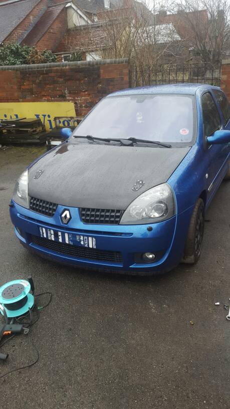

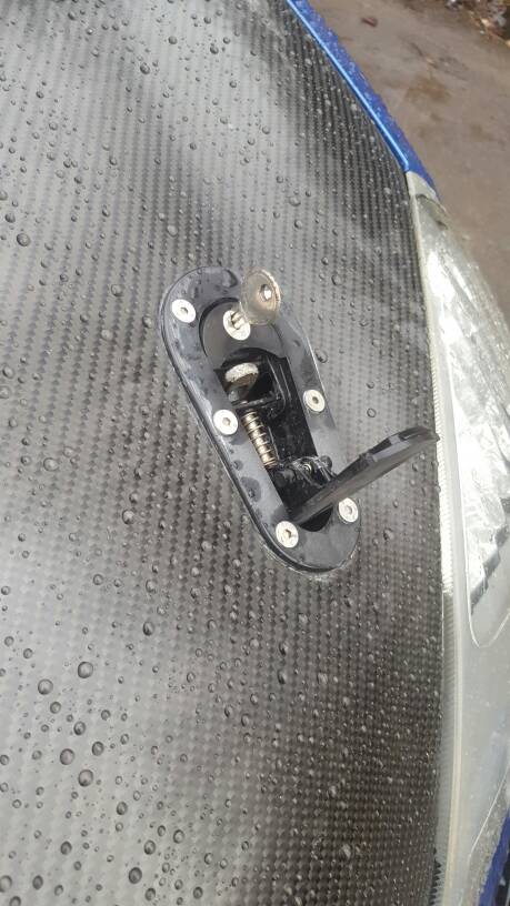

Well the bonnet has been put in today still need to drill for the areo catches as the bonnet was secand hand i didnt put catches in so need to drill to make them fit

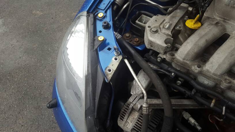

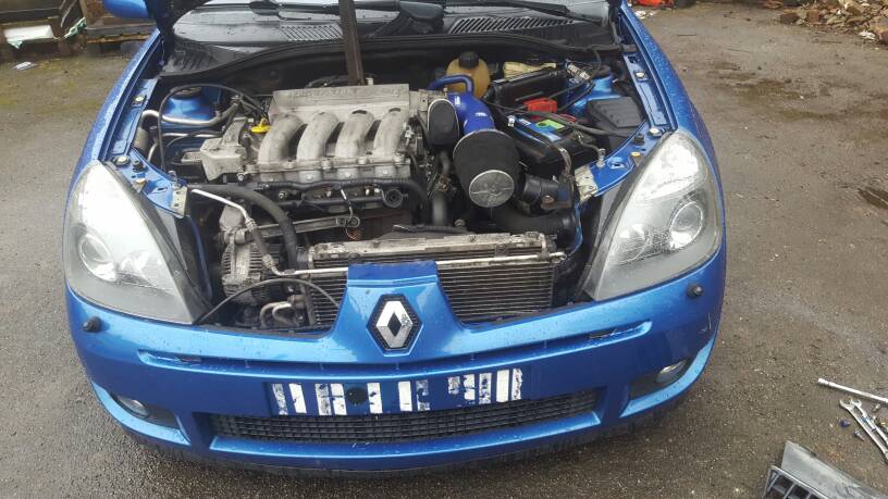

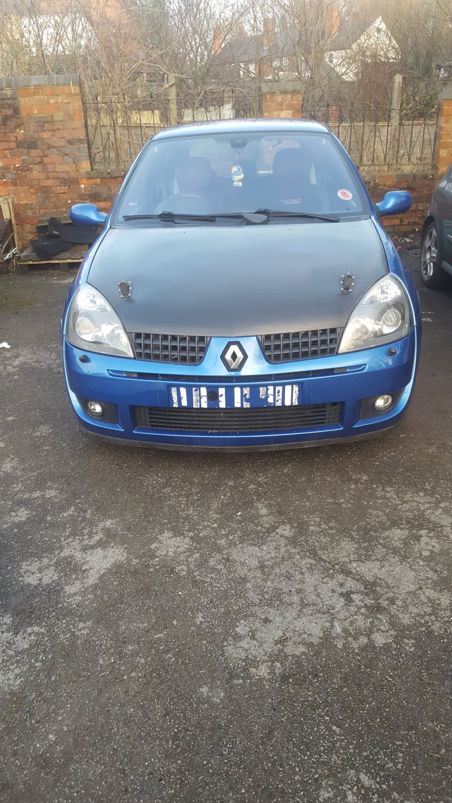

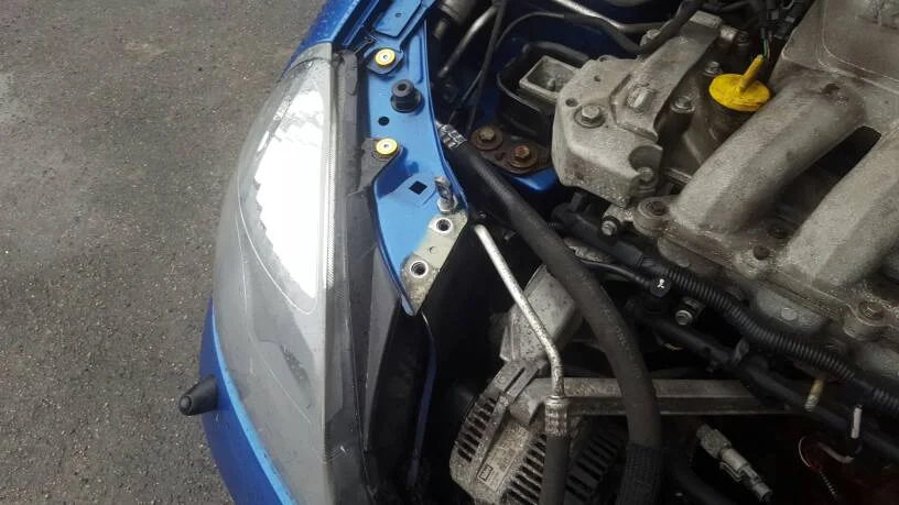

At last i got around to removing the slam panel and drilling for the areo catches all went to plan so pleased the bonnets finally on.

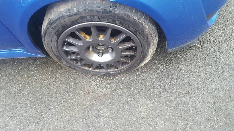

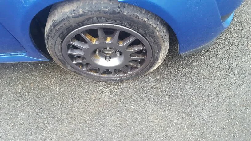

Got a set of 2118s from @B00mer as im doing him a favor n stripping down his cup for him its 100% the last breaker ill do so im not advertising items via cs due to the trader fee and no money will be mine at the end of the day. They have been plasty dipped by christ that stuffs hard to remove.
1 wheel has curb rash so the set will be poweder coated at some point.
