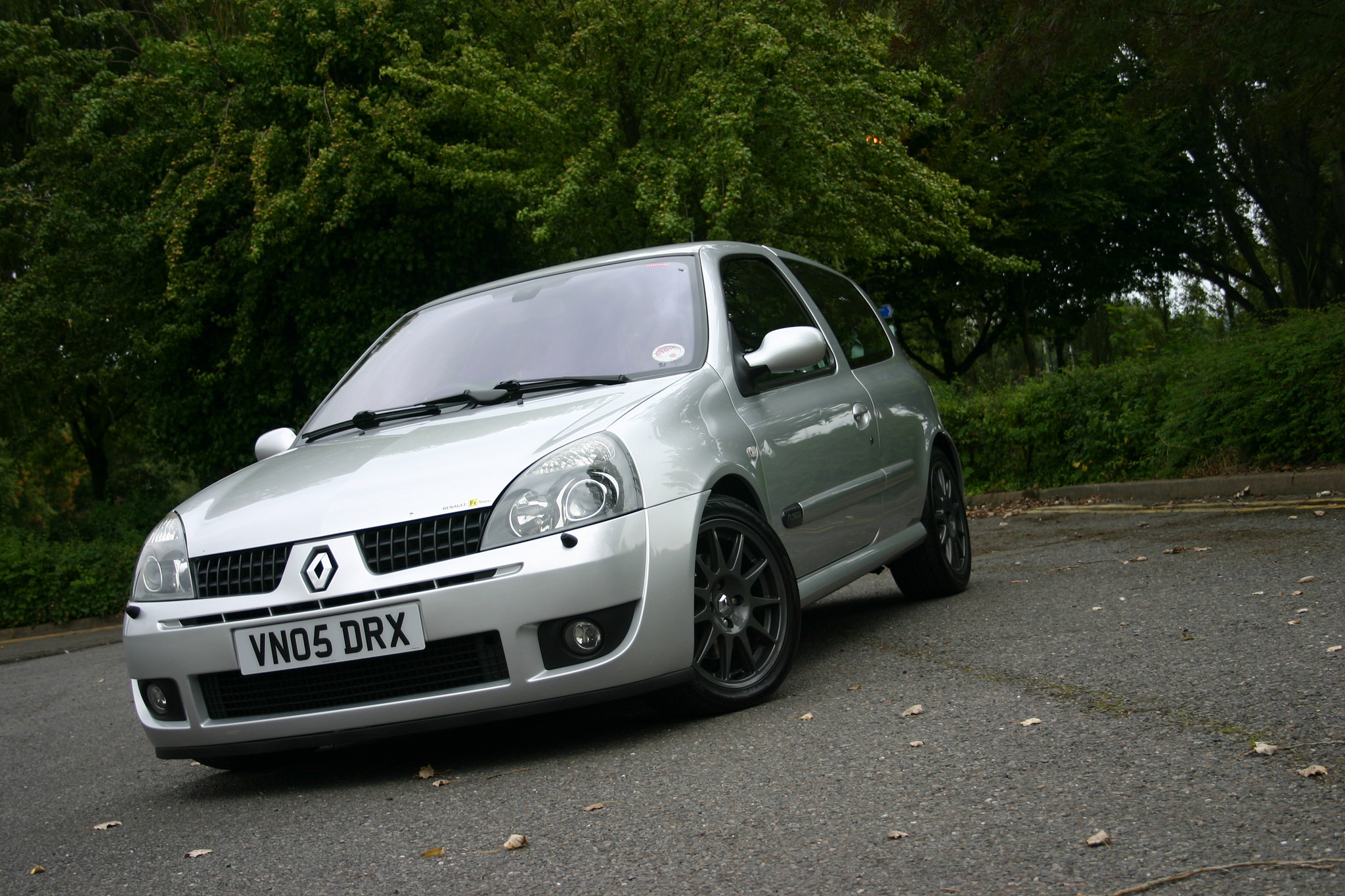

Side by laurence.hucker1234, on Flickr
Cheers. Late the held on with clips etc? I'll check the threads for the Skoda part number and get one on order. Great tip. Many thanks.
The best way is to cut the mounting tabs off (because there's no where for them to clip on the Renault bumper) and fix it to your bumper with approx 8 short self tapping screws. Works a charm, look good, and you'll not need another pretty much ever because they bend as opposed to snap.
They're actually too long, but are soft plastic so can be trimmed using decent scissors, about 2 inches off each end does it.
