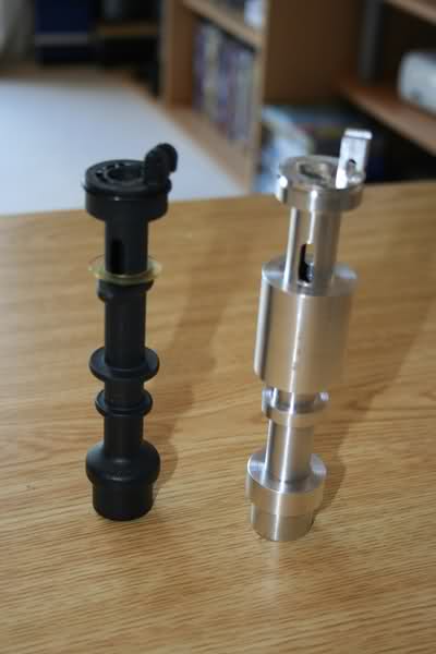

Knocked this up in my lunch break yesterday, only had 30mins so its not perfect. No performance gain at all just purely the product of boredom.

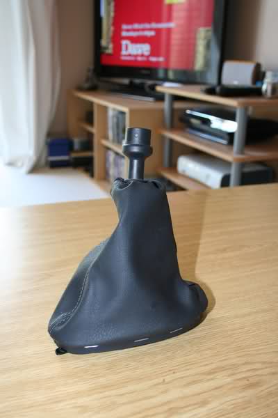

Old lever...
Old vs New...

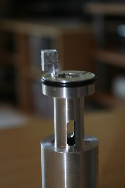

Cable hook & O-ring...

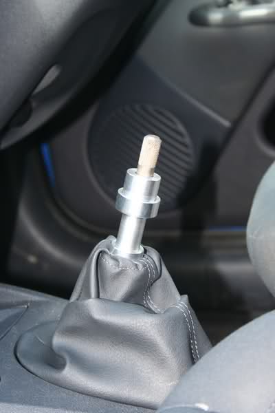

New lever back in...

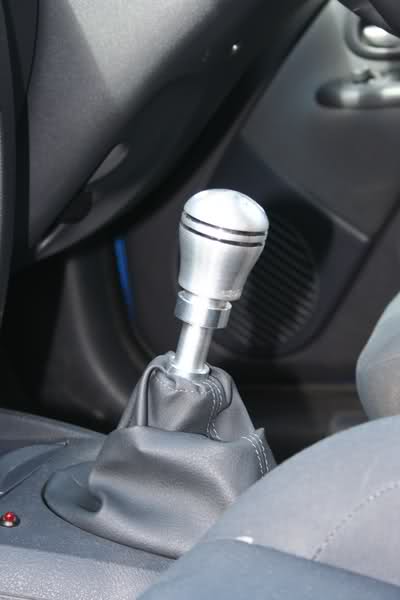

And with gear knob (temp gear knob, will make my own soon )...

Turned the diameters and o-ring groove and drilled the hole down the middle in a lathe, and milled the slot and the cable hook in milling machine. I'm a machinist by trade, which helps :)

Dont have a drawing as i just made sure the important bits were the right size and in the right place (ie: the slot in the shaft and the cable hook) and just made it up as i went along. It only takes 2mins to remove it so i'd just take it out and make a quick drawing.
