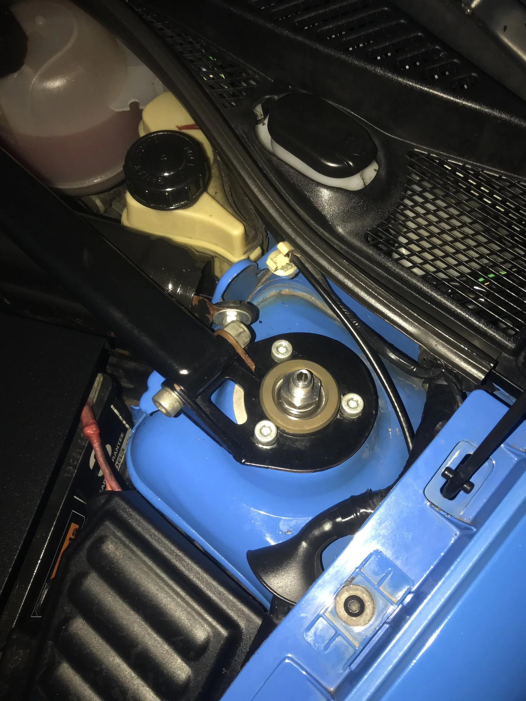

Looks like it has PMS top mounts and brace bar. Unless they are worn I wouldn’t be replacing them. Have the garage said what parts they will be using?

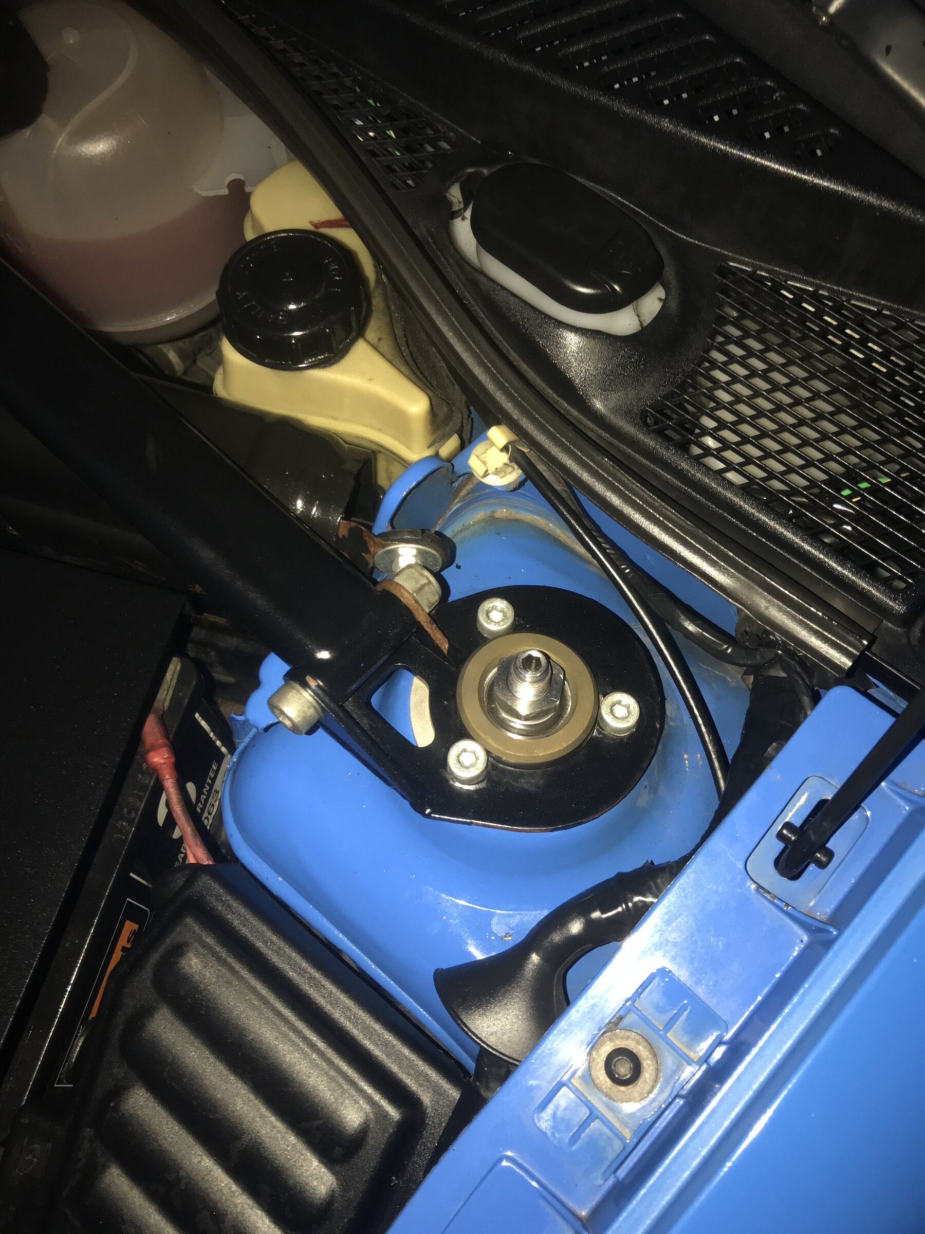

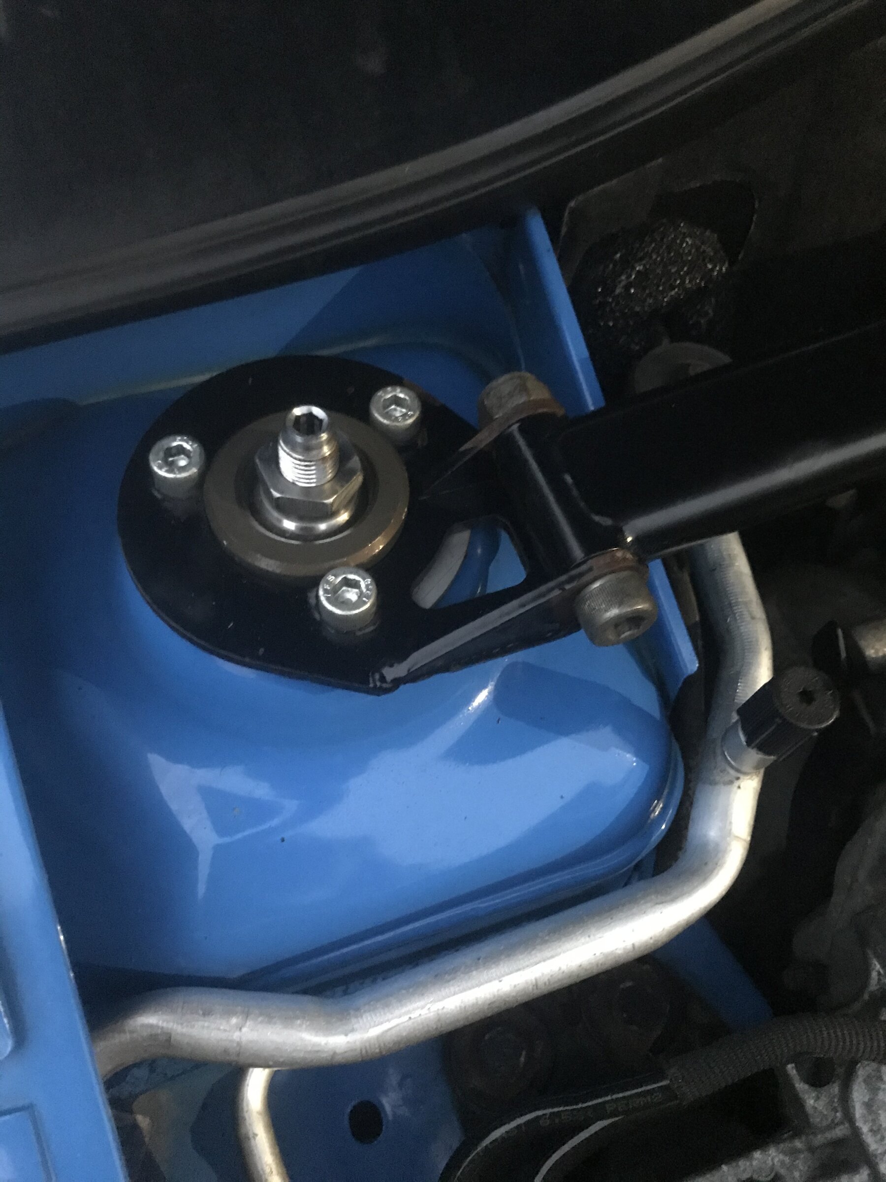

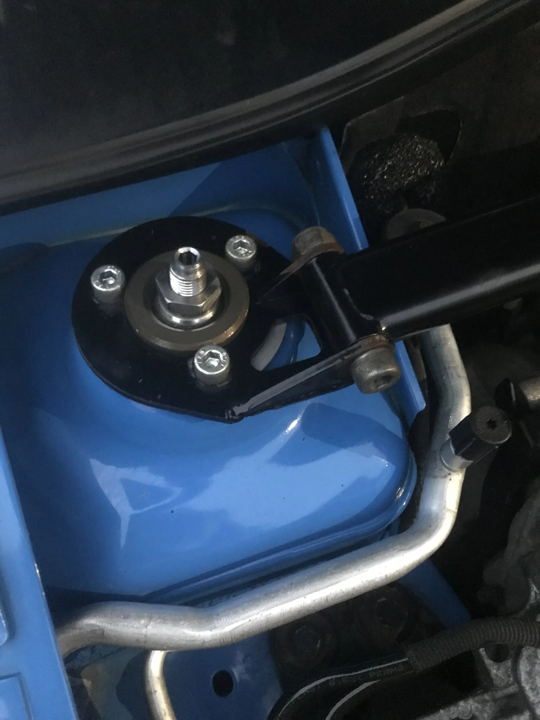

They do look like Pure Motorsport top mounts and that's definitely one of there strut braces.
Second that.
So if the garage are replacing the top mounts make sure the know what they are doing.
I think the PMS ones don’t really “knock”. They can get stiff if the bearings dry out but I believe the bearing can be replaced.
Second that.
Just had a look and I would agree. They look identical to the pure motorsport images. I'll make sure to get the bearings checked out before replacing them as a whole. Thanks!
They are not the ones that were on it when l had the car.
So the most they’ve done is around 6,000 miles. They shouldn’t be in need of replacement already unless they are generally too hard, and noisy.
