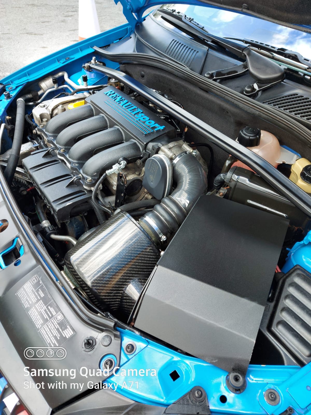

Pretty straight forward. Had to remove the induction kit to make my life easier.
