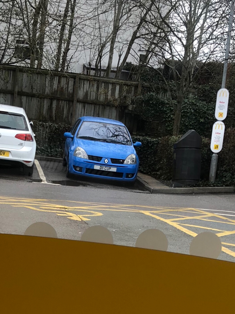

What the f**k was I thinking! I can’t sell this, even sat in McDonald’s car park on a miserable day it looks the business!
I’ll give myself a good stern talking to.
