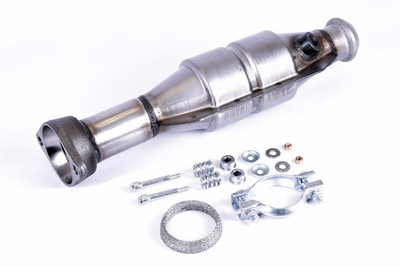

Need to find a cat... MOT coming up soon and it’s not going to pass as it is! Any pointers to any available? Thanks!
The problem is the prices of 182 cats. I'd imagine a lot have been sold because there worth so much now.
Ktec sell these:
Or you take a punt in something like this:
That is the issue with the 182 cats.
I'd be tempted to go for one of these if you need a cat: https://www.ebay.co.uk/itm/Sport-ca...less-Catalytic-Fits-to-OE-Sports/142528559110
