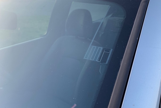

Great suggestion there - trialing it before fixing it in place! My wife's car has an integrated DAB system with the aerial stuck on the windscreen next to the A-pillar, straight from the factory. I guess placement of such things are much easier before the dash is fitted in place.

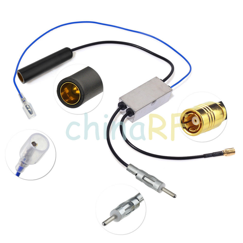

Fit a splitter and use the standard ariel, works just fine.

I have a pioneer DAB head unit and the antenna is on the main screen by the passenger a pillar - works absolutely fine for me

I had a Kenwood, the DAB was as good as a factory fit system in our other car. That was using the stock Clio Ariel with a splitter.

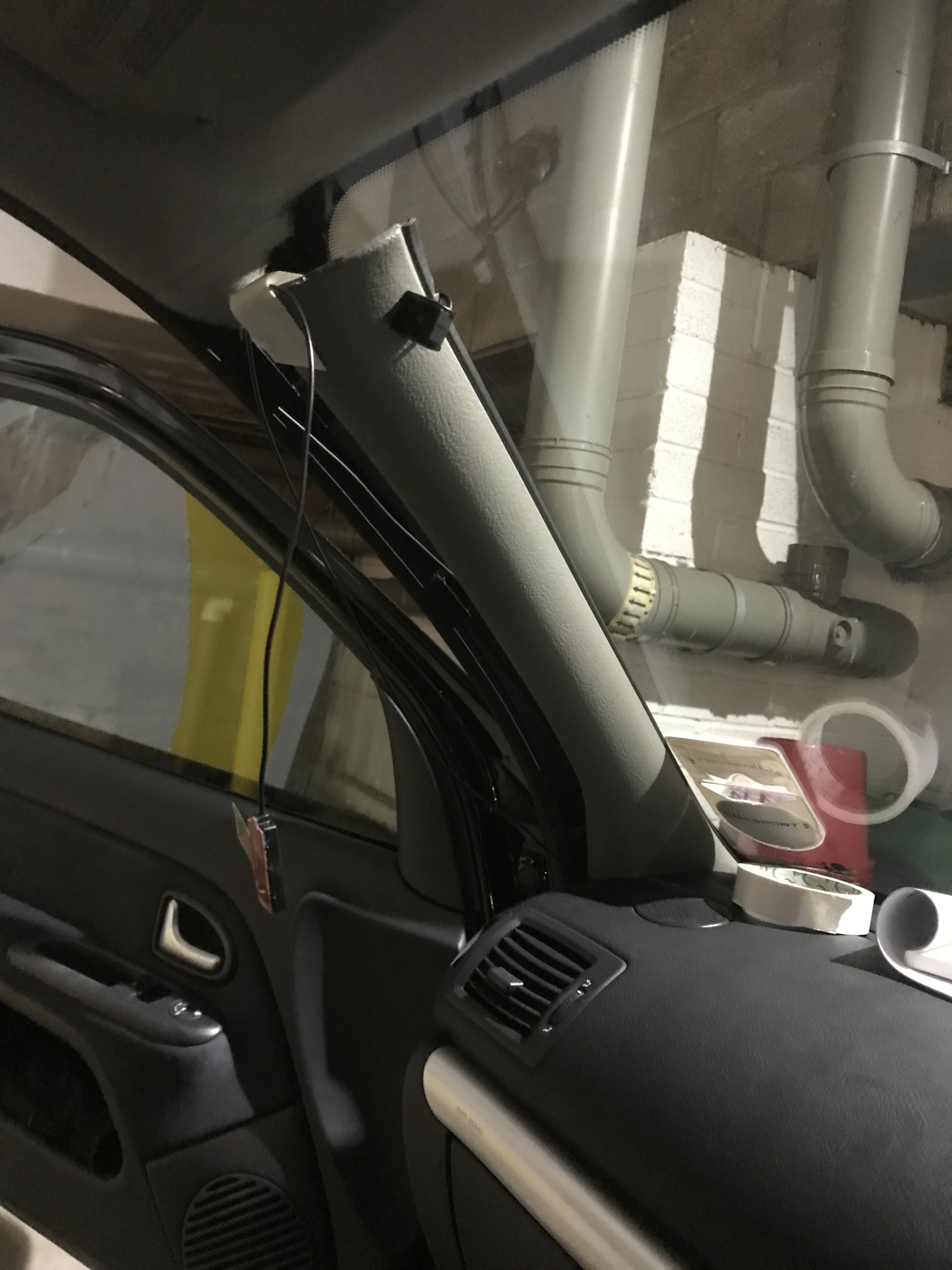

That went a lot more smoothly than I thought. The trim tools finally got to be used after owning them for about two years and made an easy-ish job, even more ridiculously straight-forward.
1408098
I just took my time with it - and with a torch peering down the open gap at the top of the A-pillar trim, it was easy to see where the rest of the clips were and where the existing alarm sensor cabling ran.
With the door rubber peeled back a bit, I had no trouble passing the DAB antenna cable around the back of the passenger foot well and similarly, the microphone from the top of the driver's side A-pillar. Perhaps the trickiest part was being 6ft 1" and trying to cable-tie the excess cable, up and out of the way.
