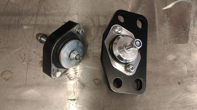

I'm buying Dr jekyll (can't tag :( )'s solid engine mounts from him next week!!

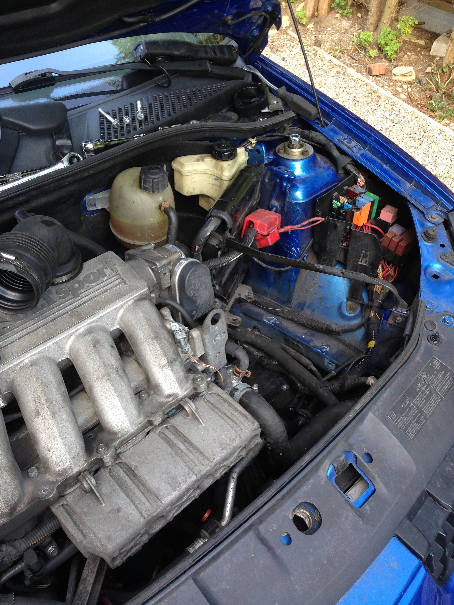

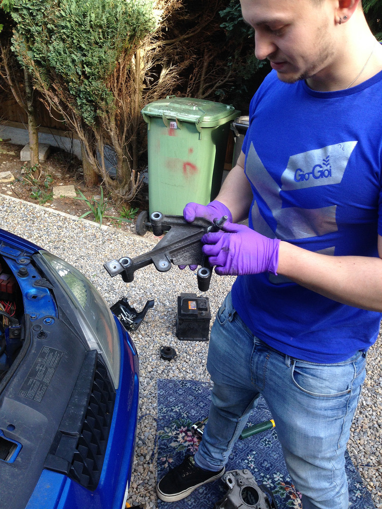

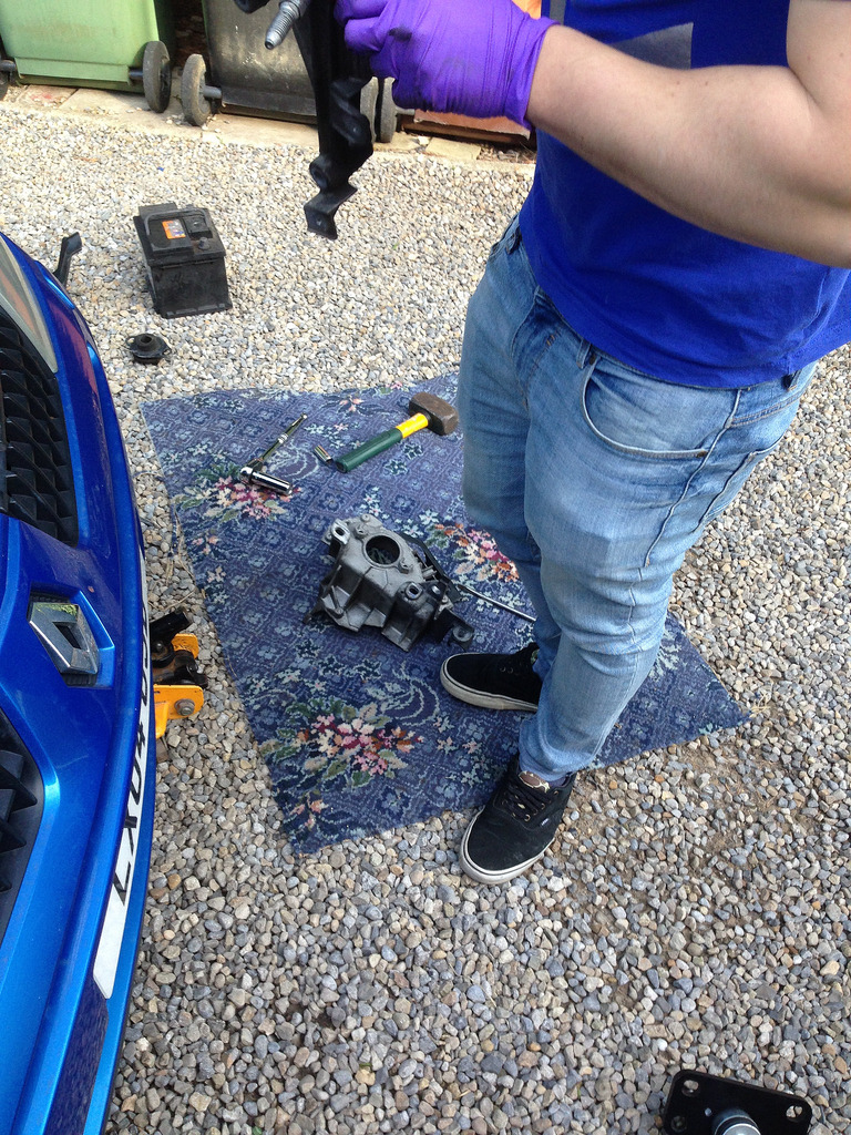

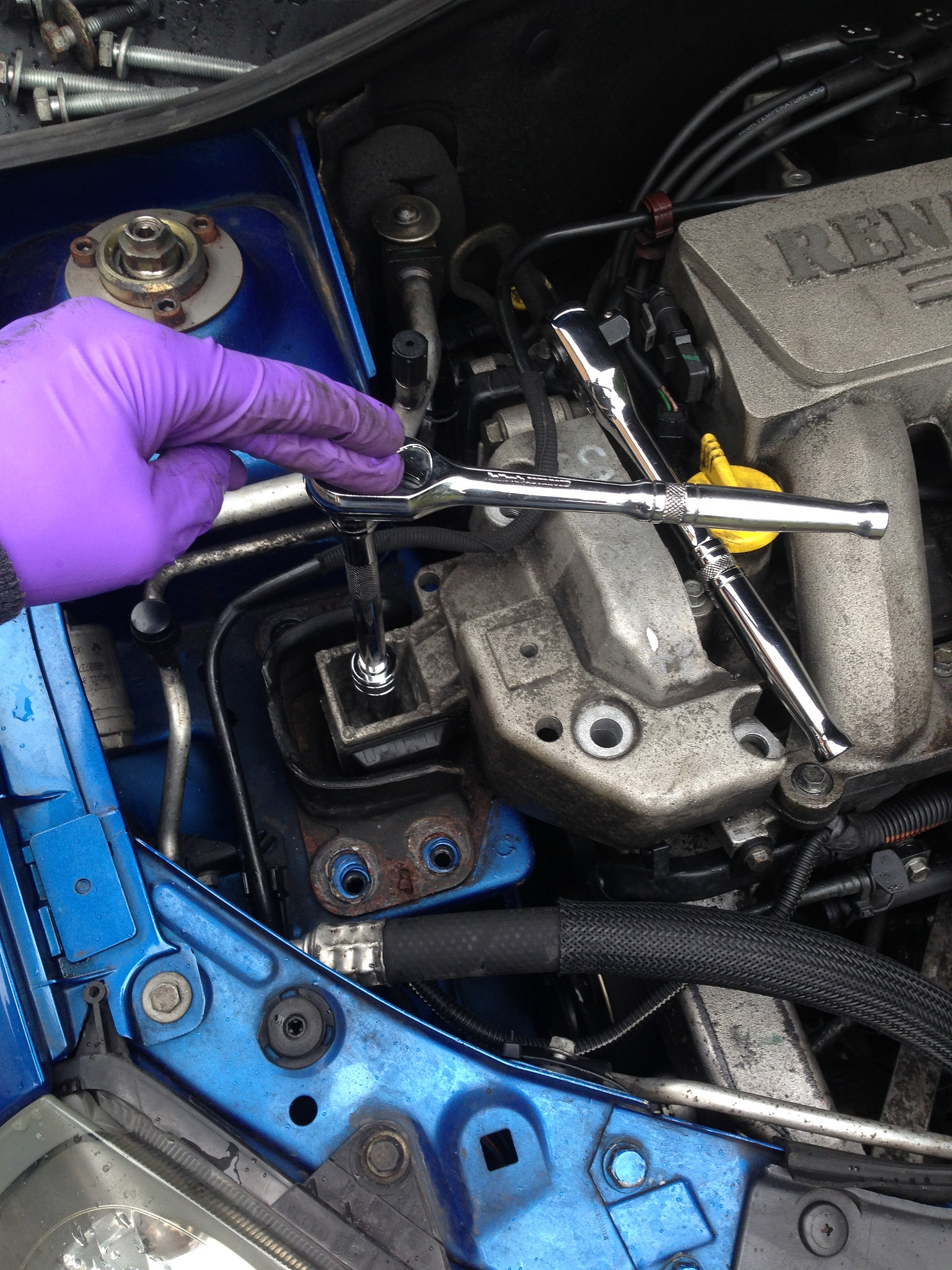

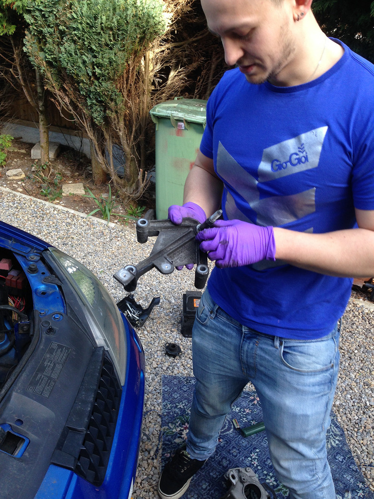

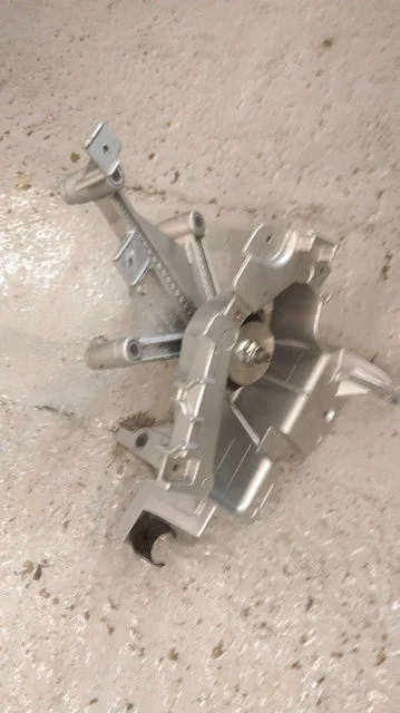

As mentioned in PM's but it may help others, I'd advise to remove the airbox, battery, gearbox mount cage and gearbox cage bracket rather than trying to undo the gearbox mount. The bolt under the ecu and at the side underneath the battery can be a bit fiddly but you'll have all the sockets and extensions in your halfords box.
It will be easier to remove and fit the new gearbox mount once the cage is off as you'll have access to the top and bottom of it for the pin nuts and gearbox mount nylocs. By all means try the otherway but although this way seems long winded, I think it'll be easier for you in the long run.
Not the best pic but you get the idea.
Blurry pic of gearbox cage removed
by Dr-Jekyll, on Flickr
Drivers side is easy peasy but gearbox is time consuming. Make sure you have a jack with some wood under the sump before you start and set yourself a few hours.
We ended up doing it your way mate! Took quite a while and thank f**k matty is massive as we really had to swing on that pin to get it off the original gearbox cage!! Got that side done though so thanks mate! :D

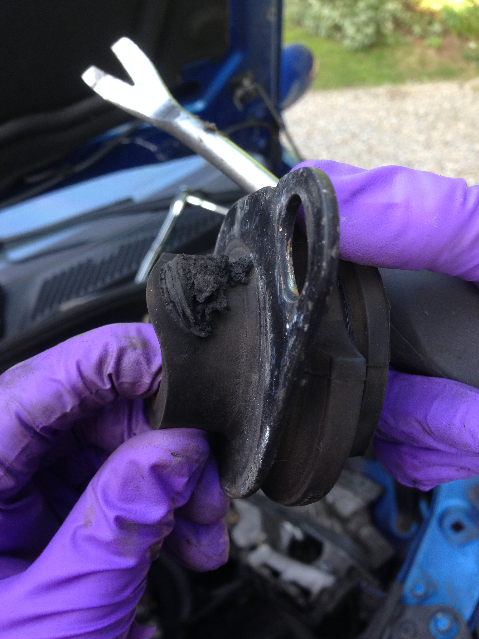

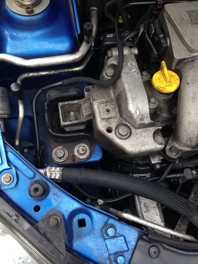

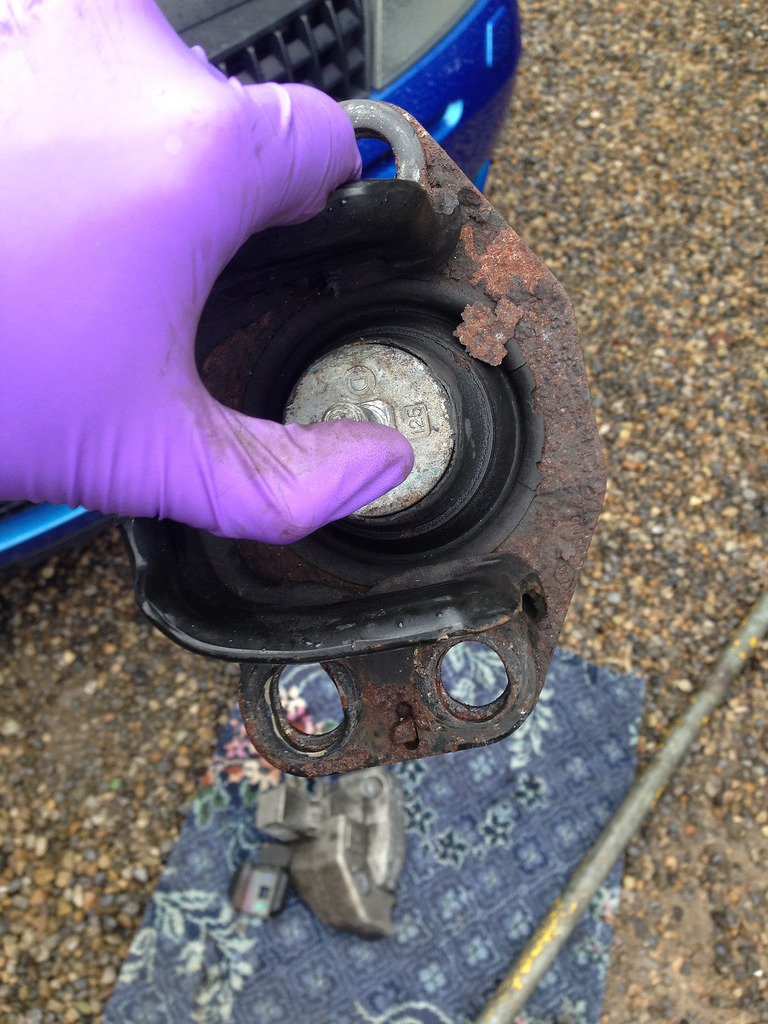

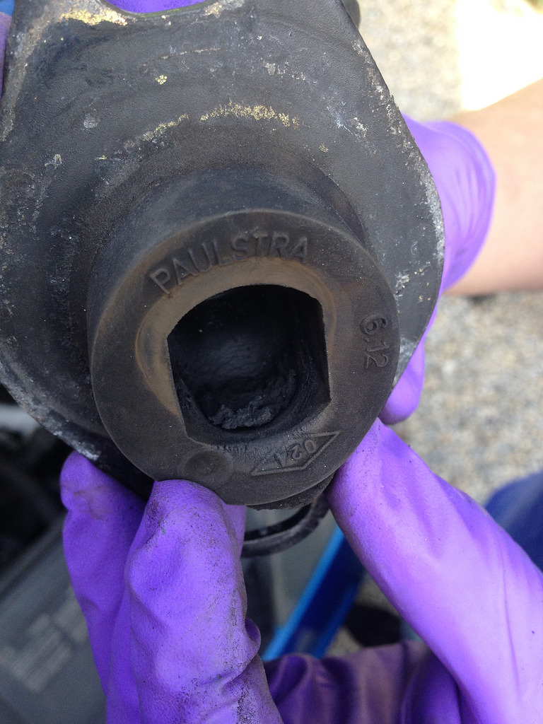

So we started with the mount. Checked out the original and it looked like something been rubbing through it :S :S
IMG_0255 by dann2707, on Flickr
IMG_0256 by dann2707, on Flickr

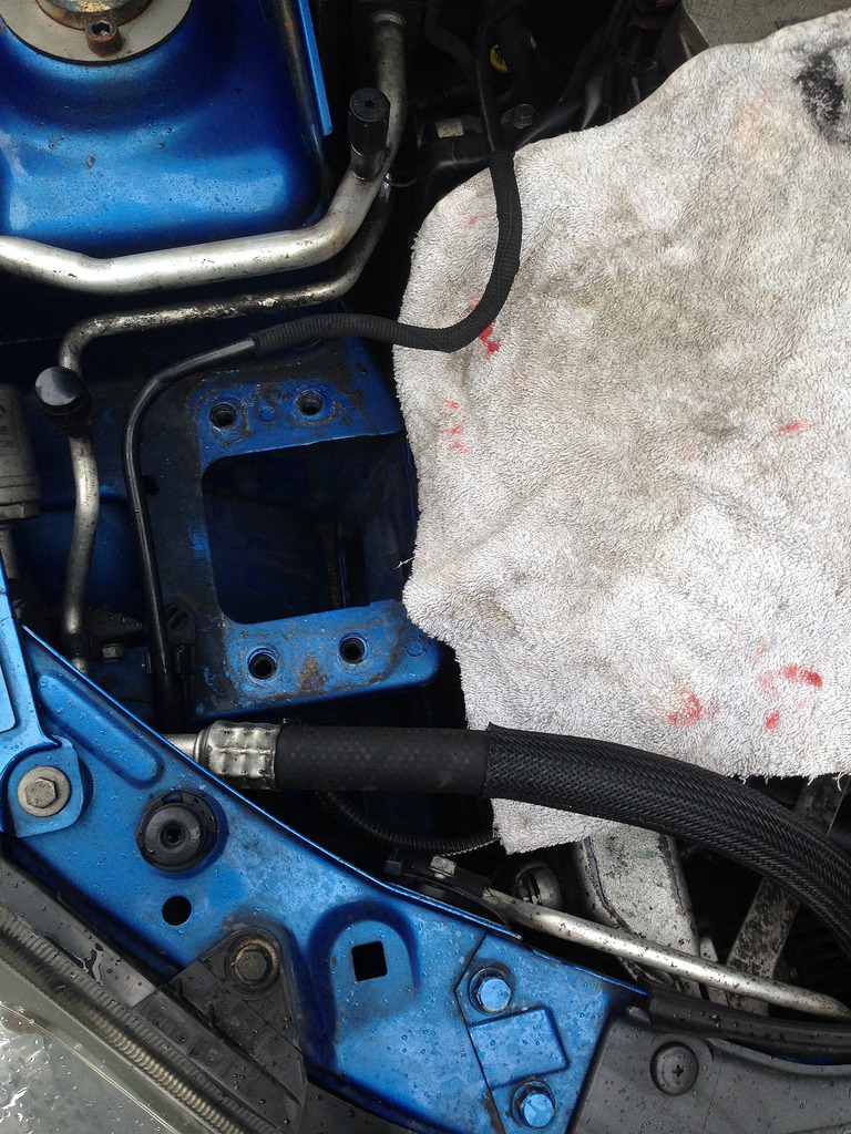

Got it all off
IMG_0257 by dann2707, on Flickr
IMG_0259 by dann2707, on Flickr
IMG_0260 by dann2707, on Flickr
IMG_0261 by dann2707, on Flickr

Imagine trying to fit the mount without removing the cage. F*ck trying to get your hands under there for those 2x M8 nuts! At least the hardest one is done. Don't say i didn't warn you! Lol
I was gonna say common sense vs bullshit you should get away with it. Then I thought if a lorry was trying to get in/out you would have a smashed up clio lol
I changed the other mount today. Jeeeeeesus that was incredibly easy compared to yesterday haha, literally 8 bolts!
I haven't had chance to fully spank it and test it but so far so good, no horrible noises and the engine doesn't move AT all now which is ace :D

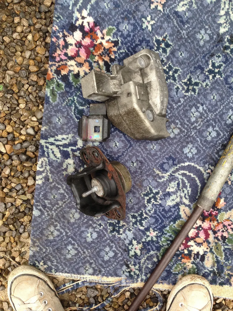

Old!
IMG_0321 by dann2707, on Flickr
We love an action shot haha

mmmm rusty

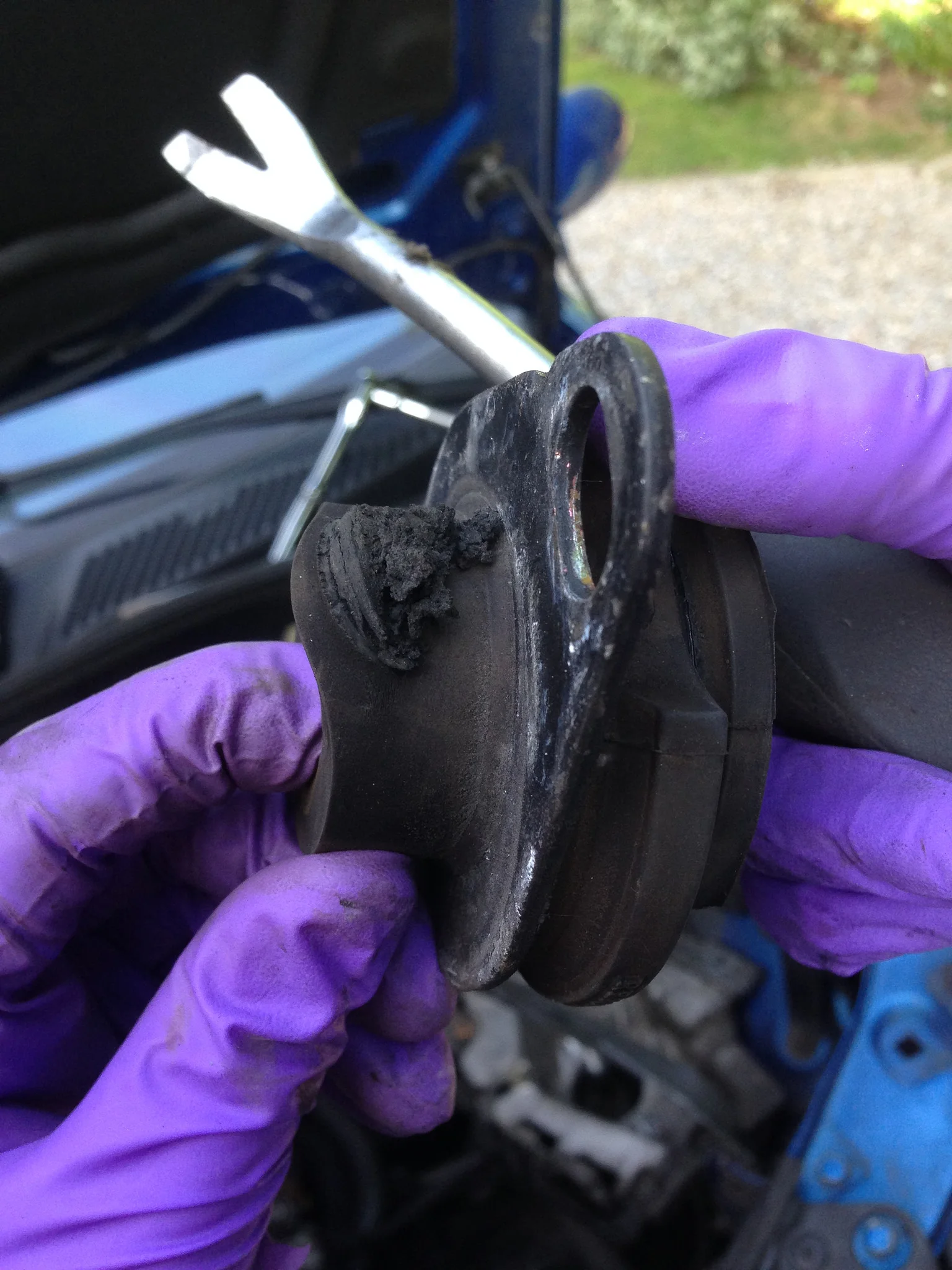

And the gaping hope hehe! I found a nut in there so today was a good day :)
IMG_0325 by dann2707, on Flickr
F*ck that old one is like the titanic! At least the replacement is in a LOT better condition.
