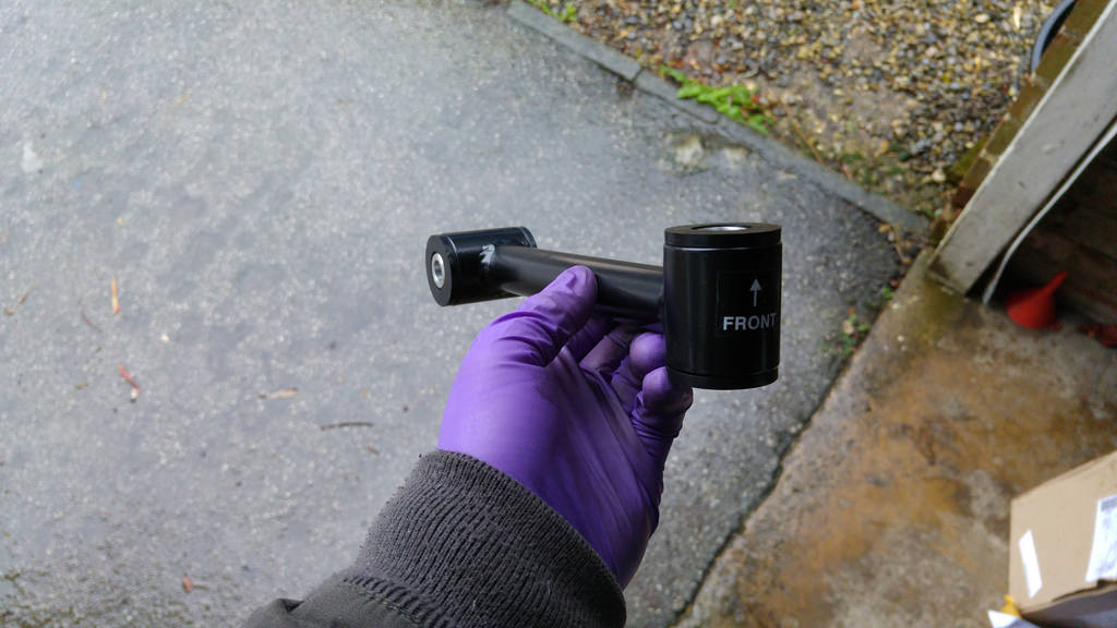

To fit the @EvolEngineering2013 dogbone. Jason is fantastic to deal with and made sure I got the part ready for the weekend when I was planning on doing car stuff. Fantastic service and a great price.

It's stiffened the car up even more, vibrations are nowhere near as bad as people make out on here despite it being the hardest level. Sold my purple one to @fairm010

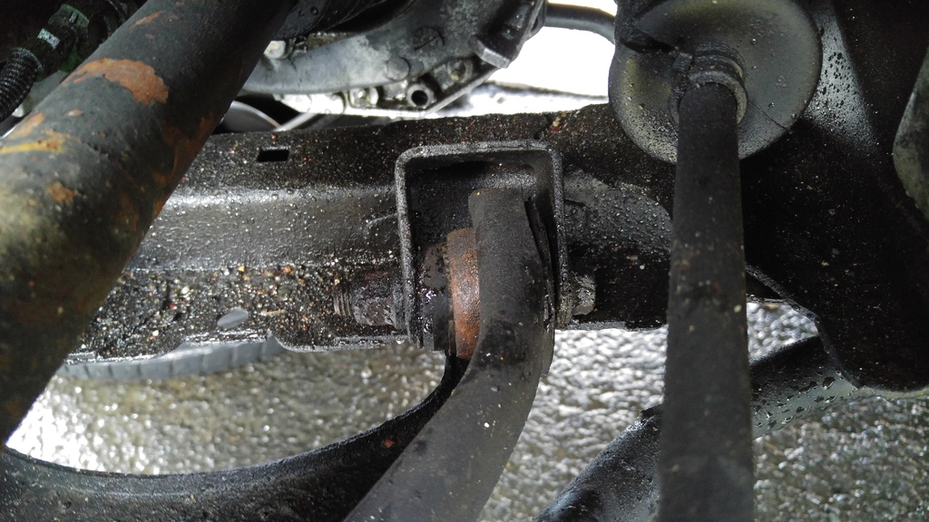

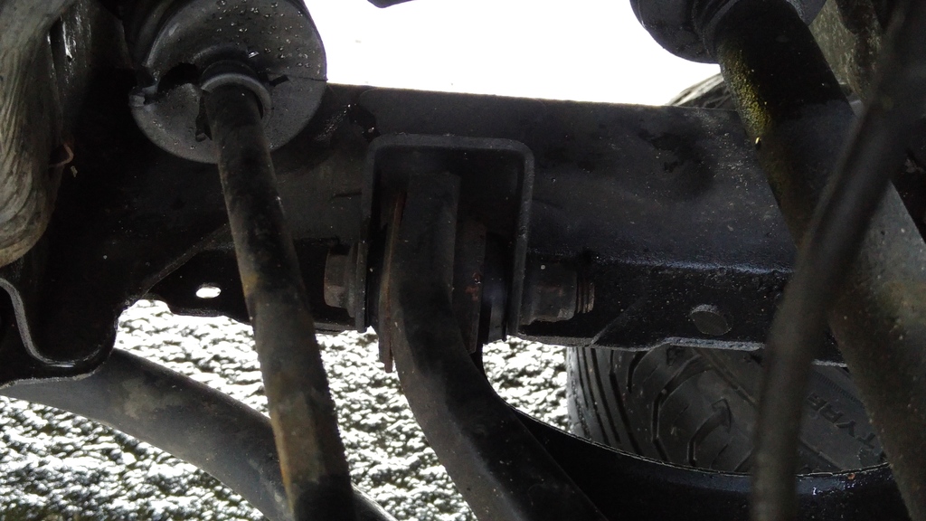

I've also noticed an issue from a while back. When accelerating I'm pulling to the right. When decelerating I'm going left. At very high rpm in vtec y0 it's very verrrrrrry twitchy pulls right and left it's a massive handful. Not sure if it's to do with everything being polybushed etc but I noticed my bushes looking like this. Looks like one might have unseated itself?
Perfect reason to upgrade the bushes to powerflex if it looks fucked. Wishbone doesn't look bent.

Not saying it's connected to the issues you're having, but I'd check the condition of your inner tie rods, mate. The rubber boots look to have split and you don't want any dirt or water getting in there. If the inner tie rods are ok you can just replace the boots themselves.
Admittedly that was me when I fitted them. They're fairly newish but thanks for noticing man I appreciate it!

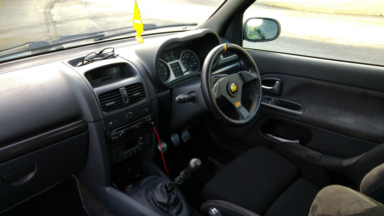

Today I did some car things.
I got my michelin pilot sport 3's fitted. Can tell already that they feel much more direct that the uniroyals I had on before, and that's whilst still needing to be scrubbed in.

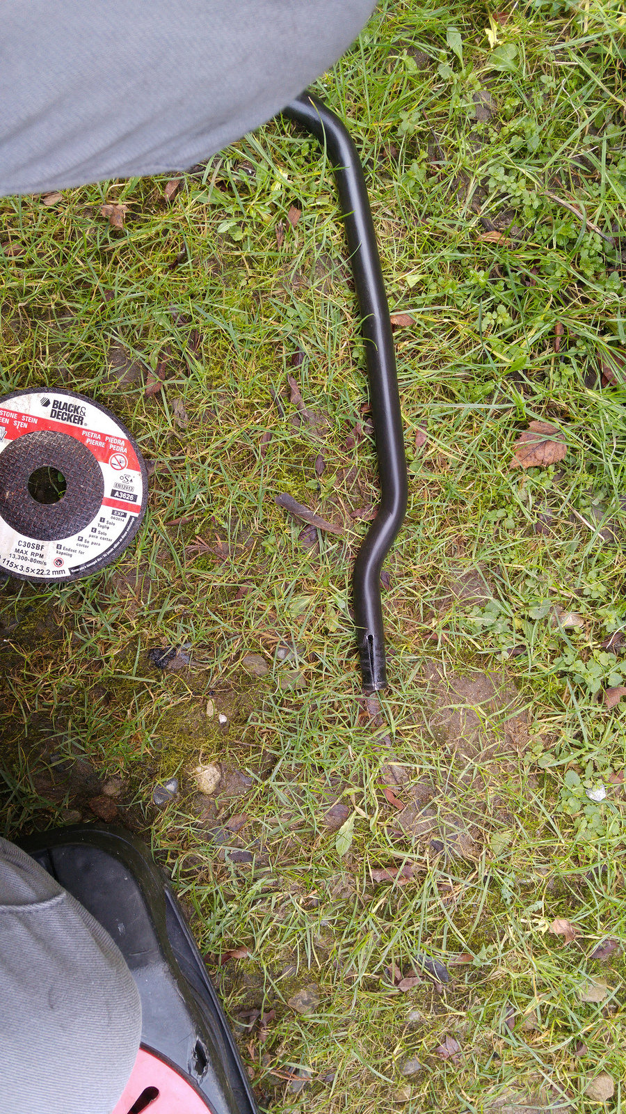

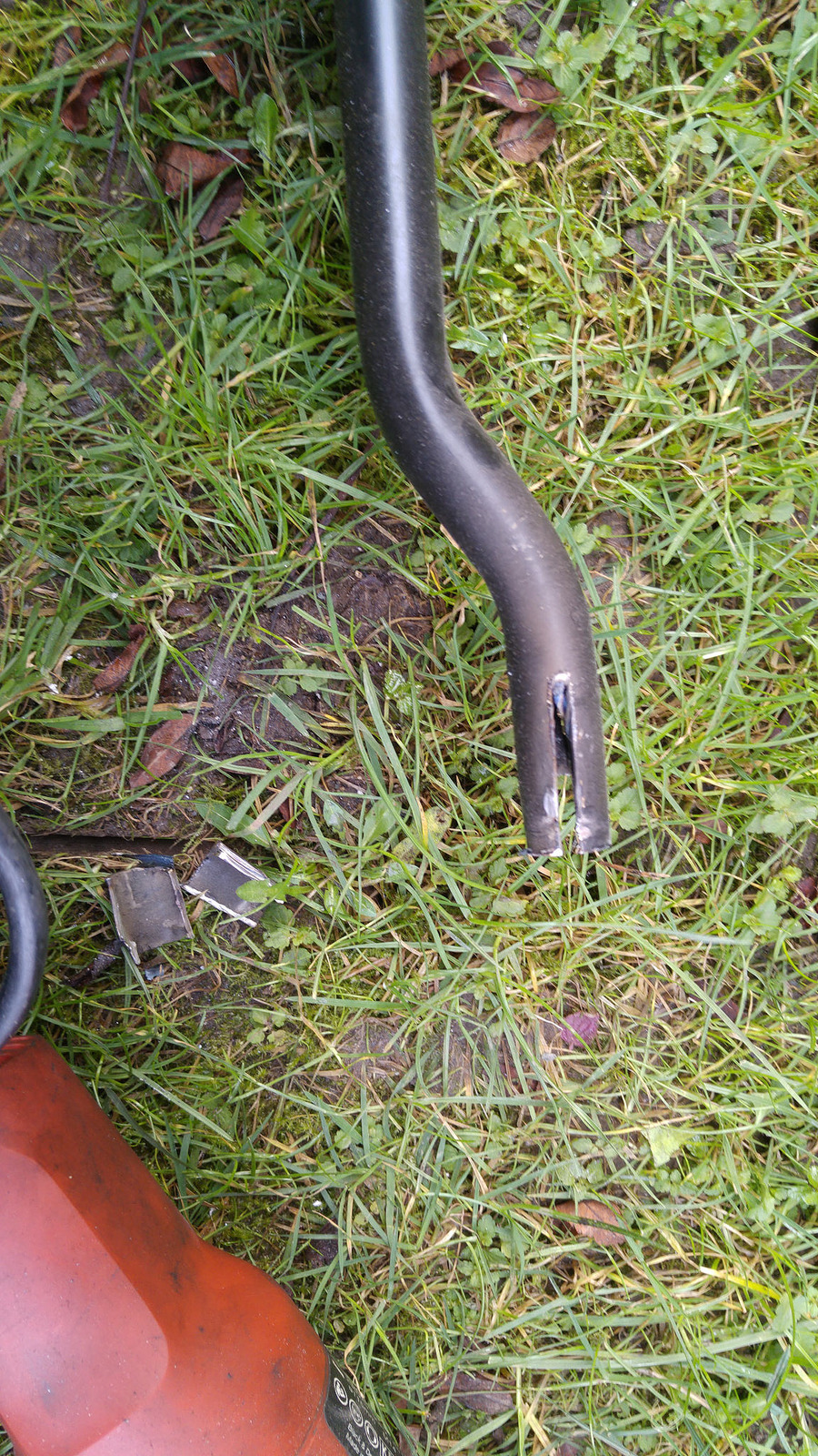

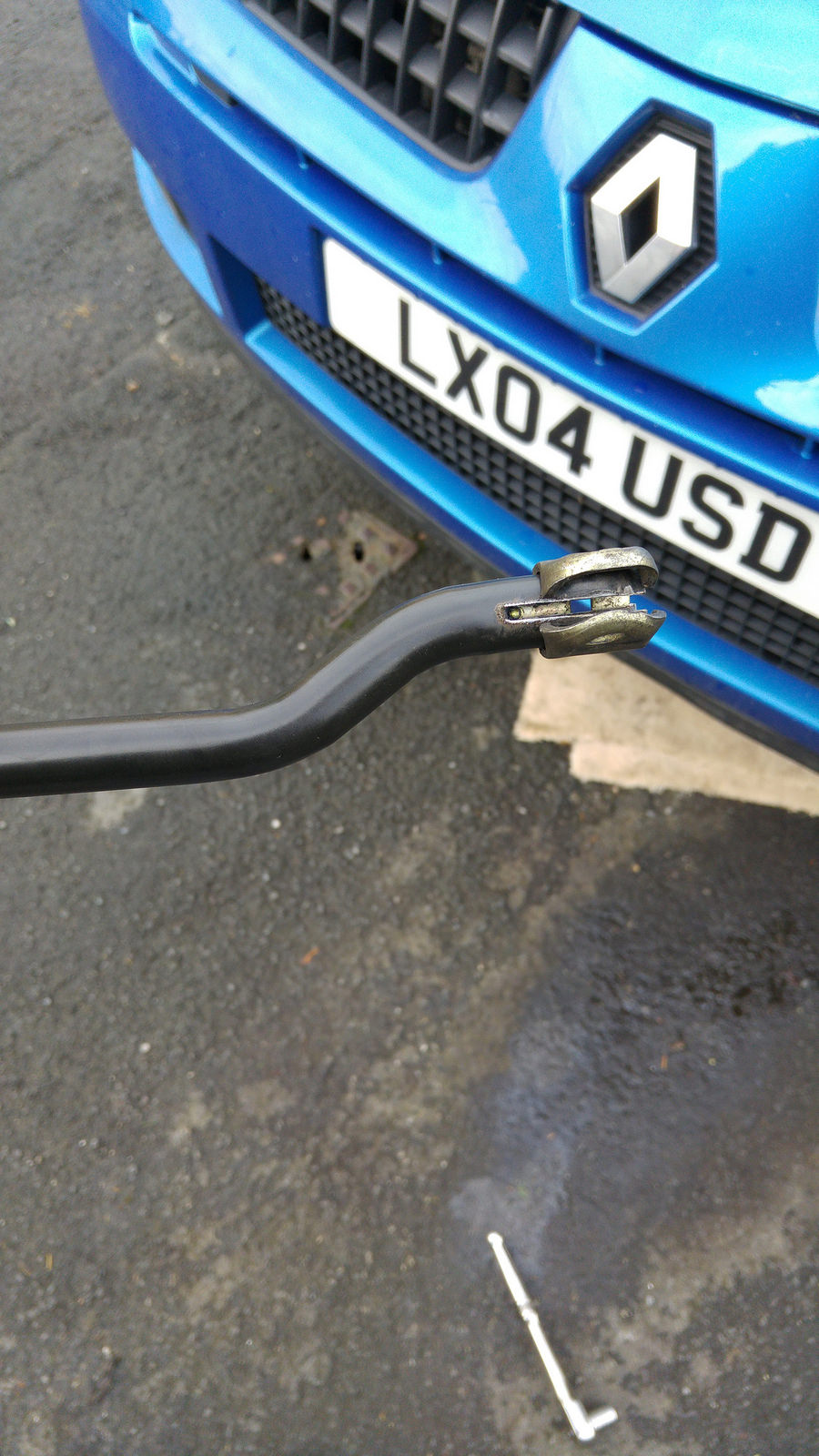

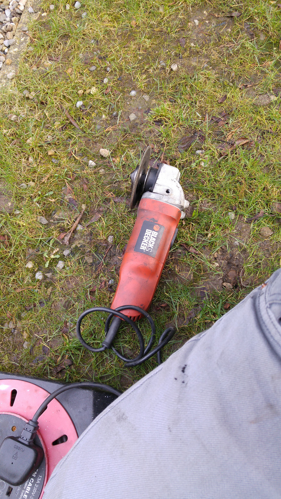

I shortened down my linkage a few weeks ago by cutting the filtration module down slightly, this helped but I needed it shorter. I can feel the tendons stretching slightly in my arm when going into third indicating it was still a reach away. I wanted it right in front of me having my elbow bent a bit soooooooooooooo. I removed the gear linkage.
This is it standard.
20160110_132032 by dann2707, on Flickr
Meets Mr grinder
20160110_132034 by dann2707, on Flickr
Cutting this amount off seen in the background. I cut slits in the linkage so that it could grip the filtration module
20160110_132538 by dann2707, on Flickr
Post pic I filed it all smooth and flat.

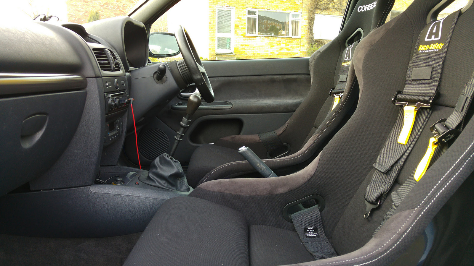

And some random interior shots just because!
20160110_143951 by dann2707, on Flickr
20160110_143957 by dann2707, on Flickr
20160110_144003 by dann2707, on Flickr
Drove the car back to my house and it feels incredible. Neutral is in the perfect position now too.

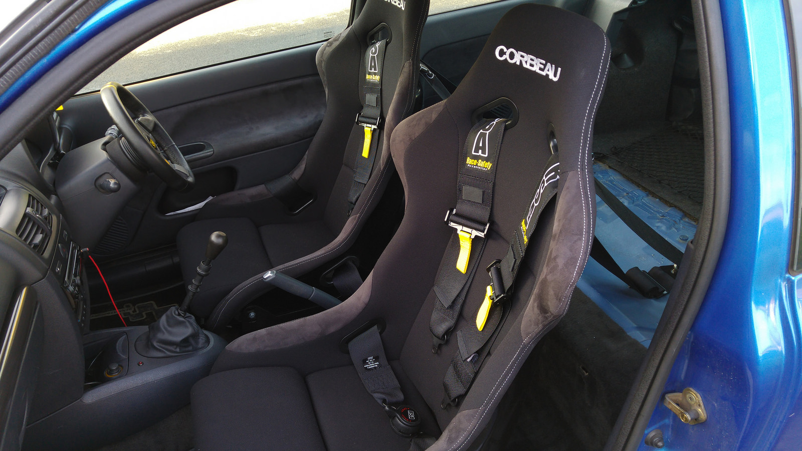

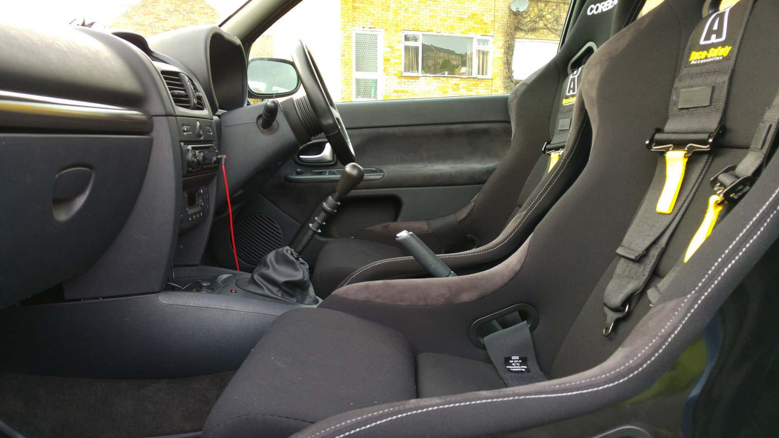

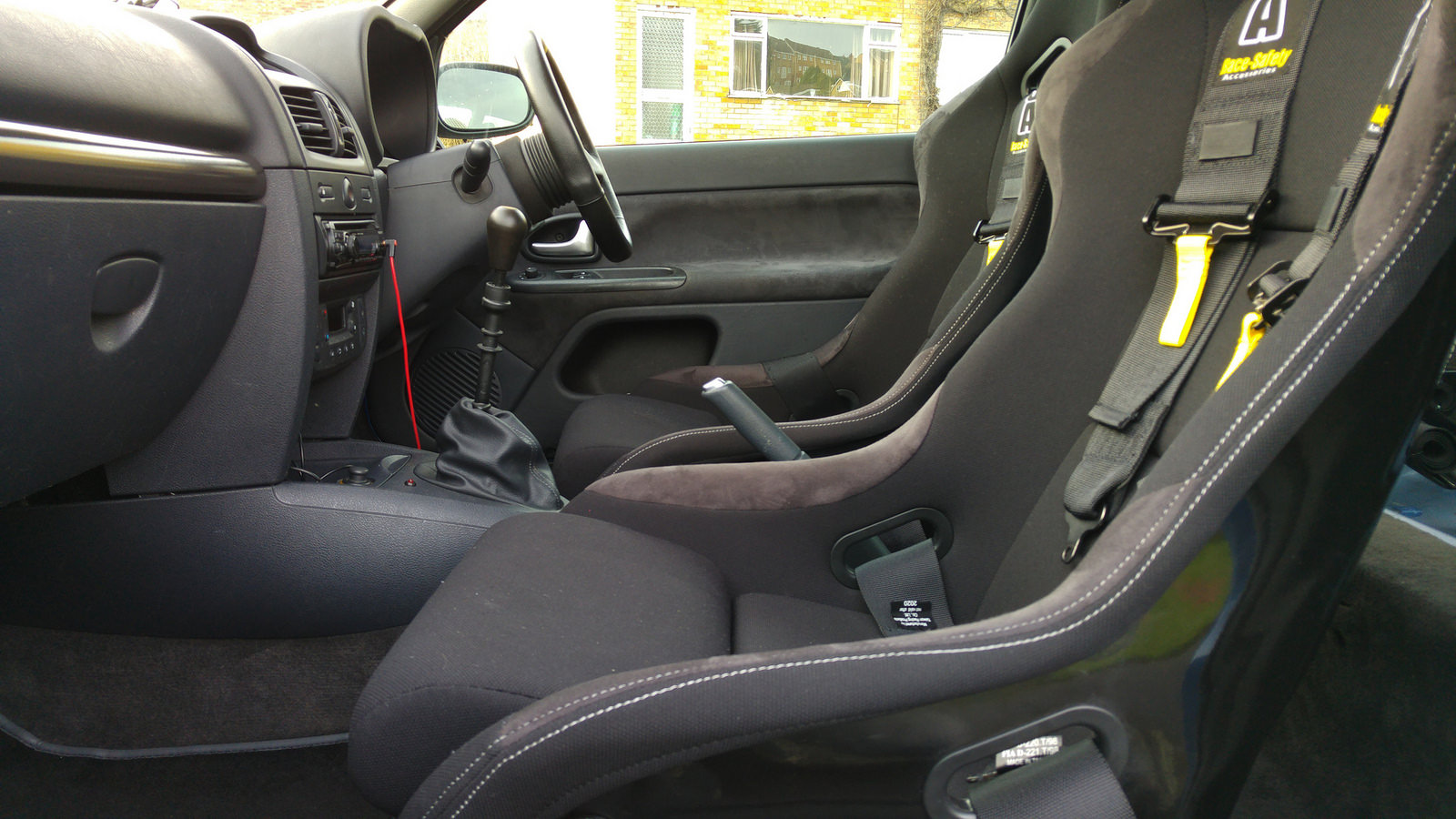

Car looks good pal. One question, your seats. I can see from your interior picture that you have the front of your seat sitting in the middle hole on the side mount. Have you managed to bring the rear of the seat down a hole or two? Ive lifted my seat upwards to get it more angled but cant get the rear lower due it the screws and subframe hitting the seat before it gets to the next hole! I run the same Xlow foz frames as you.
Just wondering if maybe it was a problem you have/had. If not ill look at sourcing smaller bolts or shaving mine down.
(sorry for waffling on)
@dann2707
Dicky Belly 3
@dann2707
Hi mate cheers for the comment, i've just nipped outside to check and the rears on mine are actually on the top hole. I remember when fitting them that the bolts would knock so didn't bother going any lower!
I find i'm fairly low as it is!
  Clio 182
Cheers mate!
Yeah nice and low, just want more angle. Anyway, thanks again!
