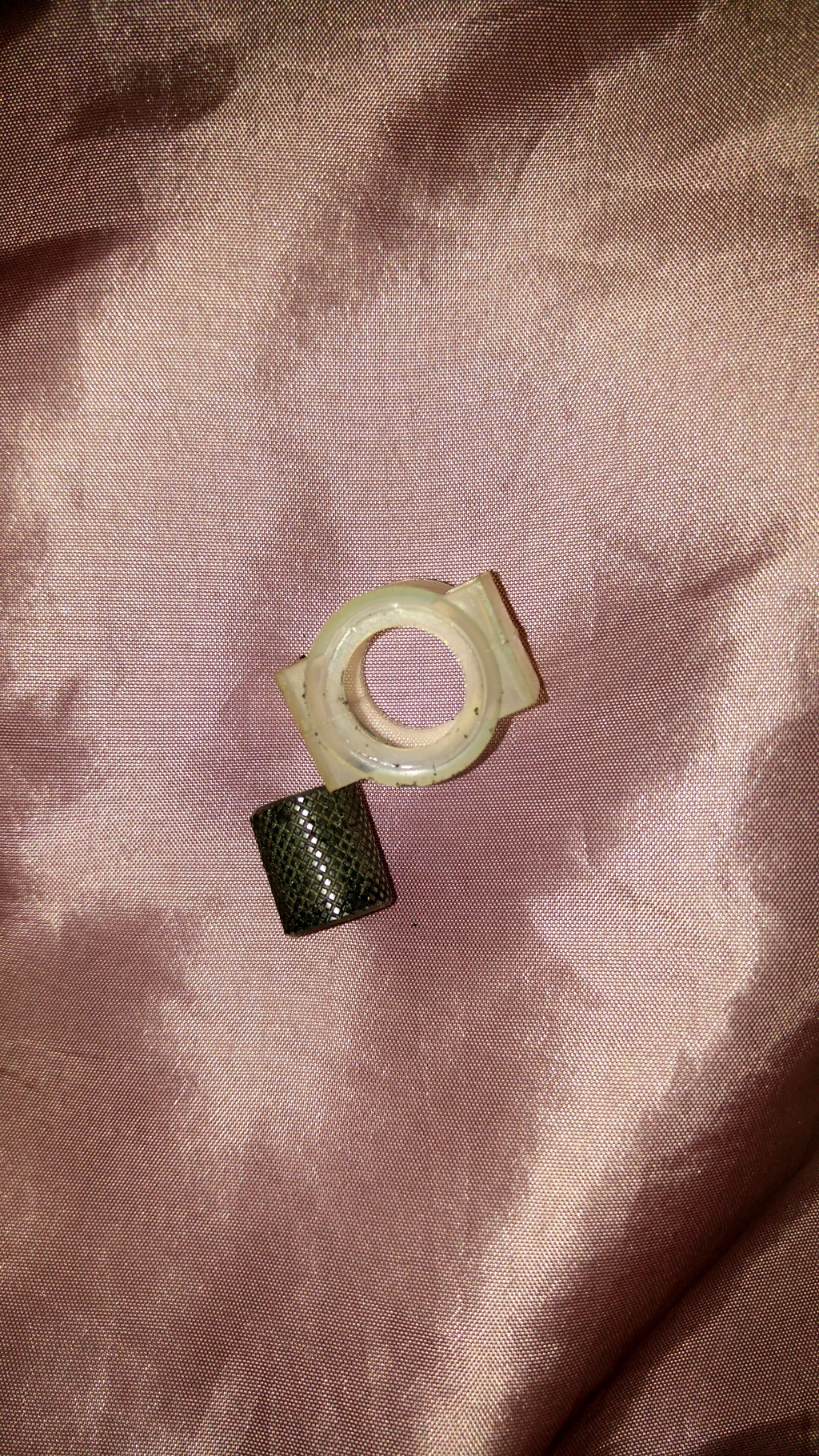

Thats the bit that looks like it has a lot of play inside despite it being new! It wobbles quite a lot inside you can see there's like an air gap and that moves when I'm putting pressure on it but then again it's supposed to move when changing gear right?
Should there be another washer on there holding it tight?

That's it!! That's the cause of your issue! On some there's a bush that sits on the rod. I've got some spares. :wink:
I don't suppose you have a picture of this. I have these spares that I ordered a while back. It's almost as if the plastic part is causing a nuisance itself by not allowing the bolt to be tightened properly and that's why it's wobbling??

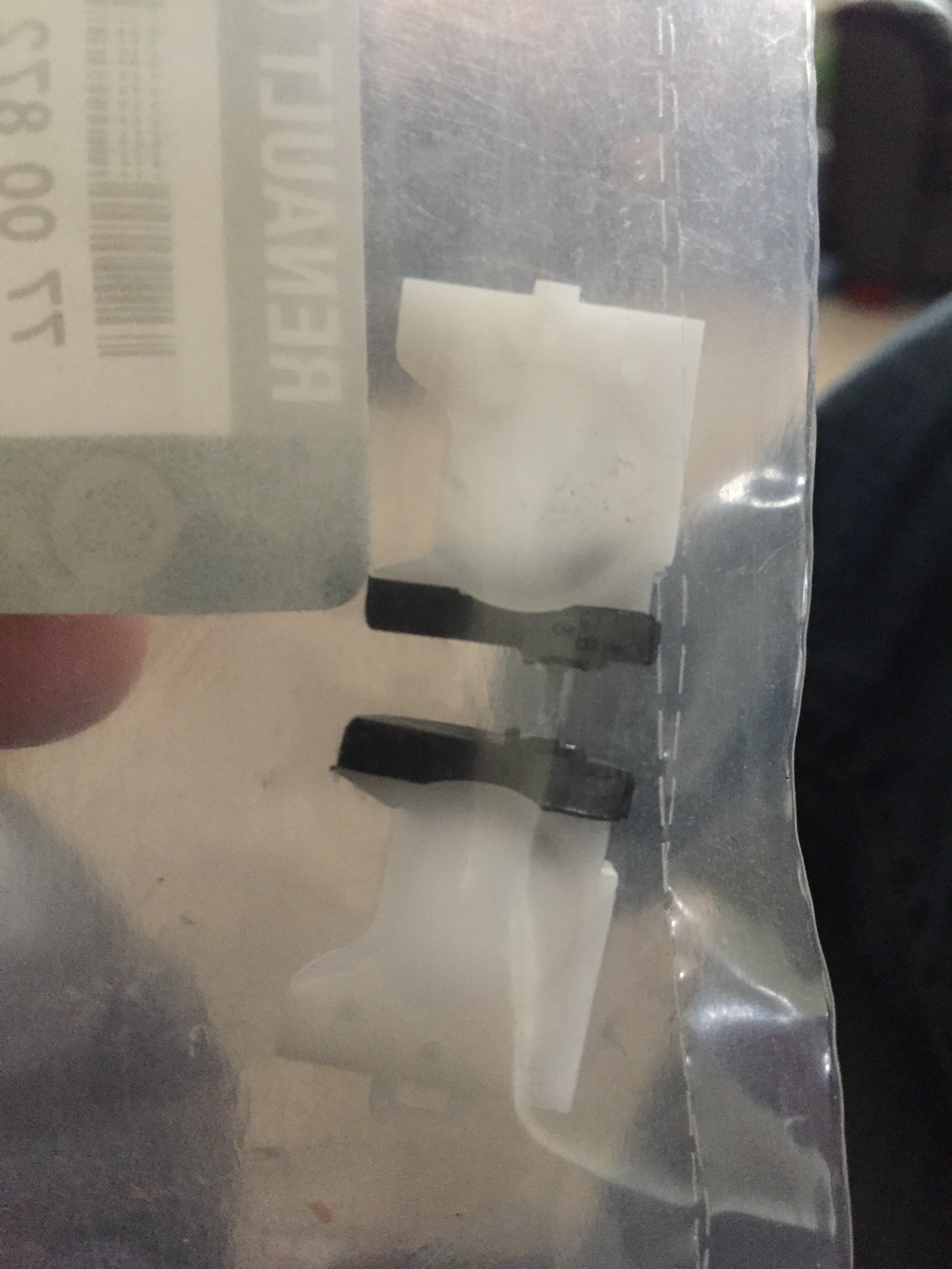

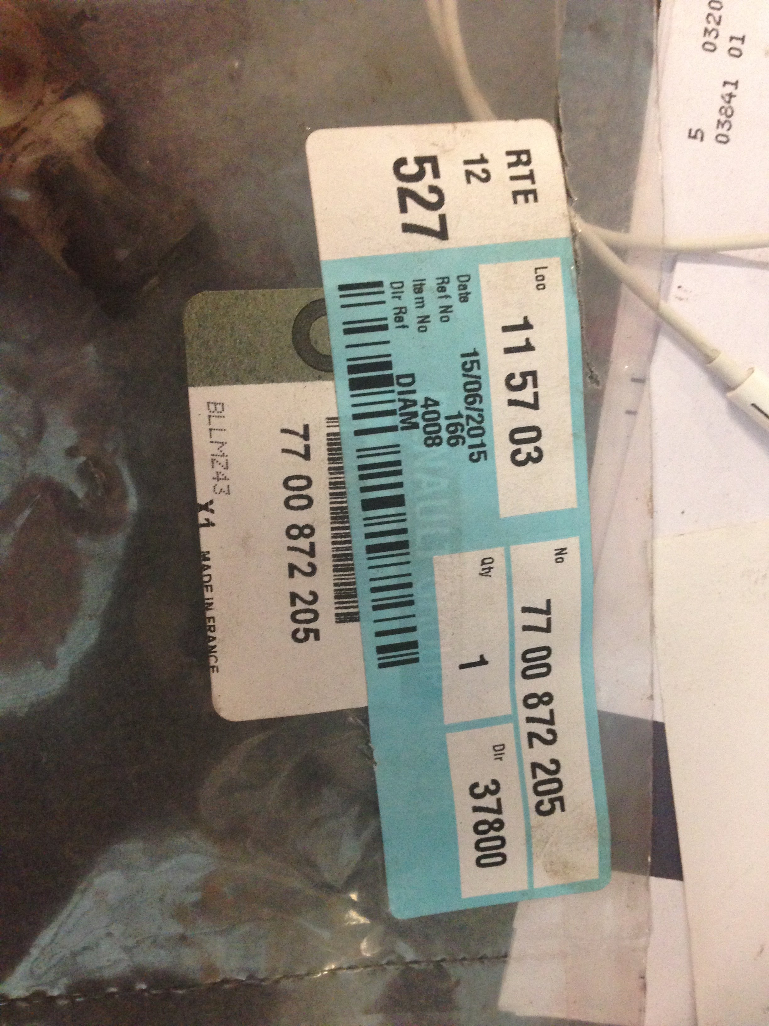

It's the white plastic bush that goes in at the gearbox end. View attachment 142912
Thanks man. Yup went over to dates today and he's diagnosed the pivot rod being worn to fooooook. There's a lot of slop in it. Do you have any parts in stock? Preferably the above part, the clevis knurled bar and the the other rod that has a ball on it half way. Will get part numbers later just on my phone and it's hard to navigate.

I'll have to have a look in the garage and see what spares I've got. The plastic bush is pence from Renault mate.
