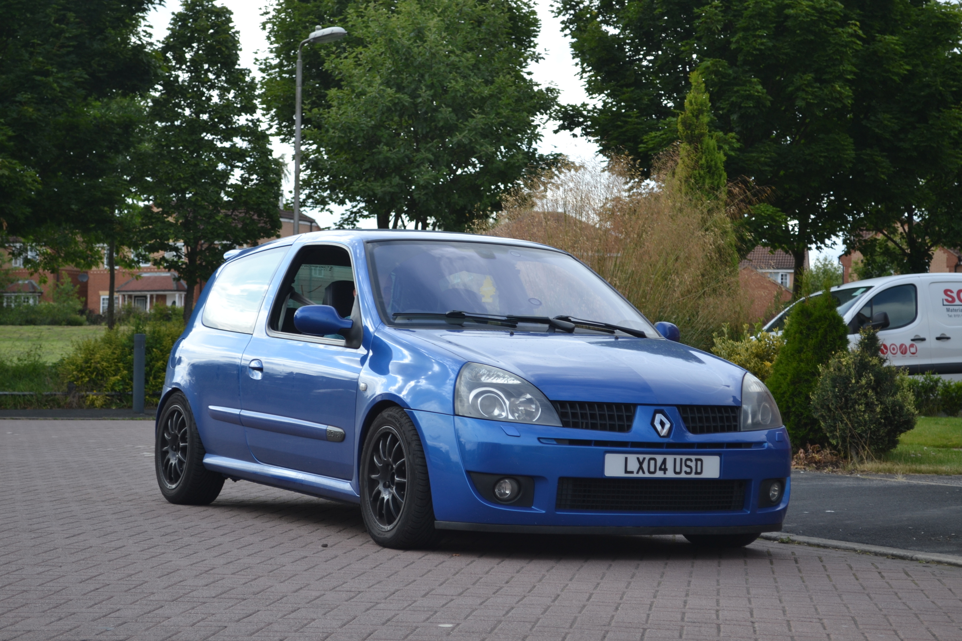

Daniels Blue 182.
dann2707
@Nick_Leeds
Interior:
MOMO Boss
OMP 300mm steering wheel
Megane Scenic shifter
Yanoo stiff shift 3.0
Quaife style gear knob
Extended throttle pedal
Dashcam fitted
Renaultsport mats
Corbeau Bucket seats
RSA 3" 4 point harnesses
JONFOZ ultra mega super low subframes
Dash strips sprayed the same colour as wheels
Yellow magic tree air freshner
Exterior:
RS200 badge
Trophy rep spoiler
De-wiper
Bullets sprayed anthracite
172 headlights
Grill sprayed black
Smaller number plate
Fabia splitter
Cup washer blanks
Bosch Aerowipers
20mm hubcentric front spacers
MAPS stud and nut kit (90mm front, 68mm rear)
Bumper ties
10mm rear stub axle spacers
c2 shorter aerial
4 x Michelin Pilot Sport 3's
Engine and Handling:
New clutch at the start of the year
RS tuner 98 Ron map
Ramair panel filter
Powerflow cat back exhaust
Bilstein b14 coilovers
Pure motorsport solid topmounts
Eibach camber bolts
Whiteline rear anti roll bar
Black series powerflex inner ARB bush
Black series powerflex outer ARB bush
Evol dogbone black series
Black series powerflex steering rack bushes
Black series rear strut top mount bushes
Vibratechnics solid engine mounts
