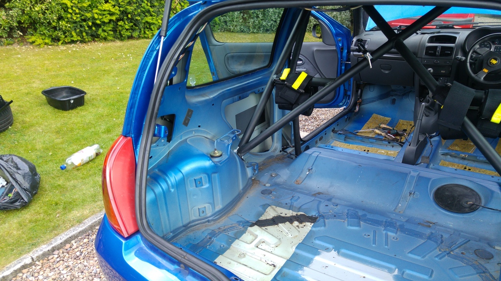

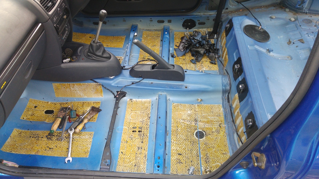

Well, what a f**king awesome weekend. I went to my parents house Friday and had a bbq with abi. Whilst that was cooking I washed Boris. He's been at home for a few weeks and abs caught my first reaction on camera haha
All washed
I then took him for his mot. He passed with one advisory :D

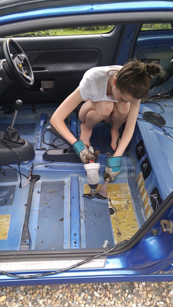

Then onto the tar removal. Abi cracked on with that!

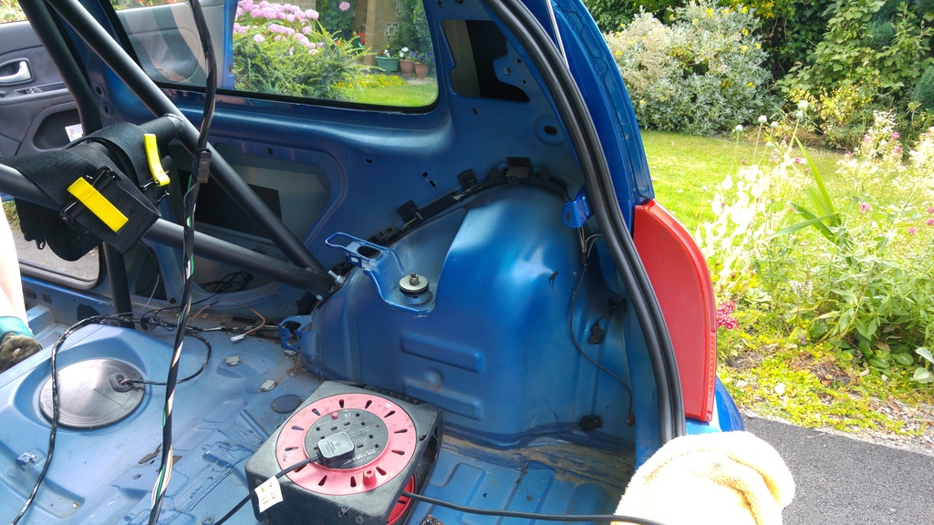

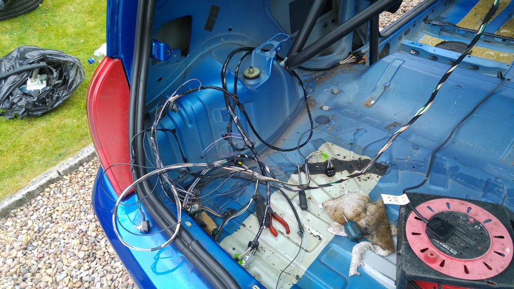

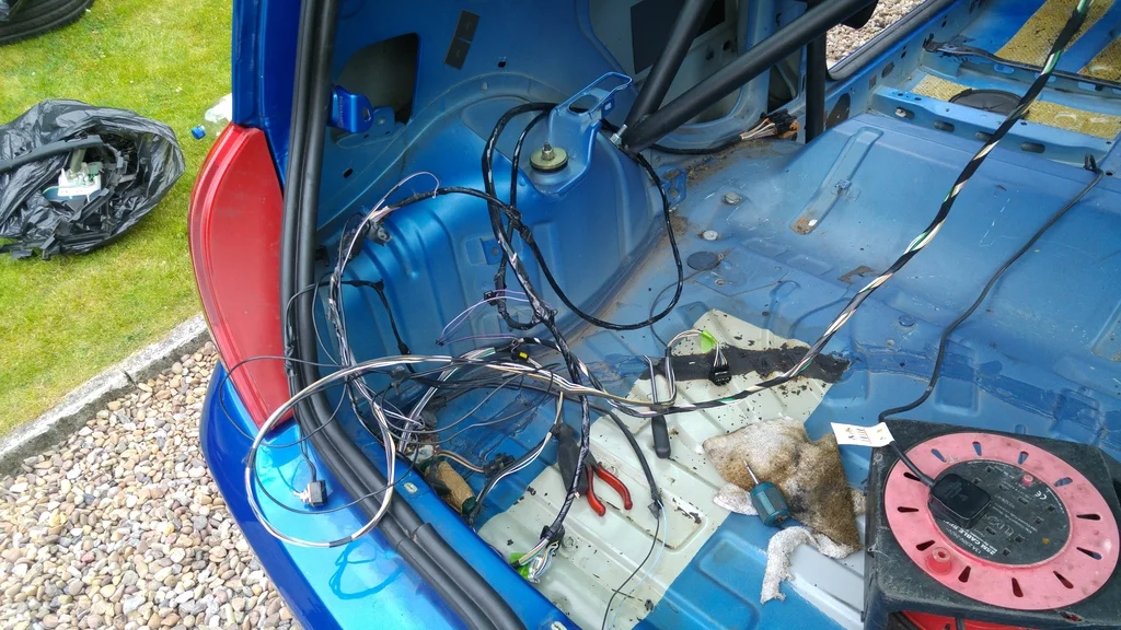

Then I made a start on tidying the rear loom. Thanks to @ nbr for that I've forgotten his user name!
Before
And afters. Still got some more tidying to do but it looks much better

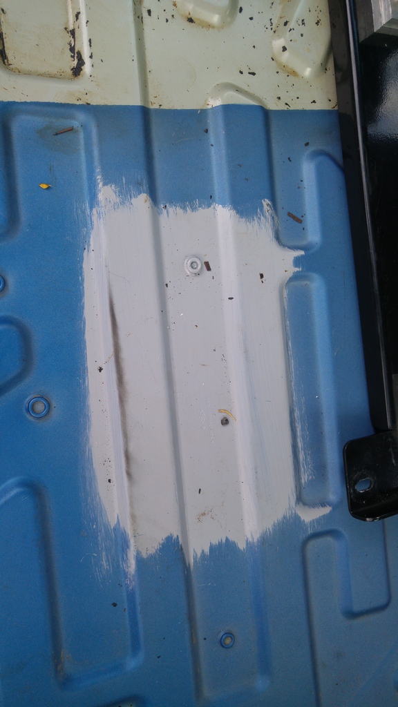

Trialled the paint too. Let dry overnight and I'm really happy with it.

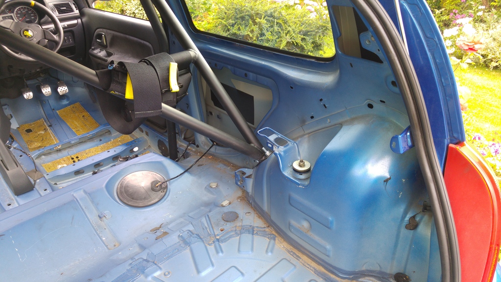

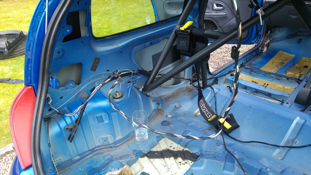

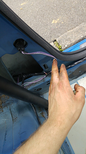

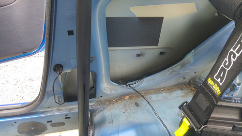

I did some more bits to it yesterday, that included tidying the loom some more and removing the glue left over from the tar. Really easily done and not as bad as people make out on here - Simply rubbed it with automotive tar remover in a car. £3.30 for a small tin and used half of it.
Wrapped some of the wires up that were loose such as this:
20160724_145824 by dann2707, on Flickr
20160724_145830 by dann2707, on Flickr

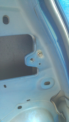

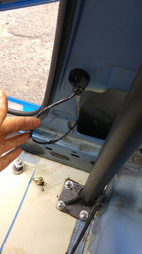

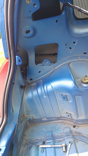

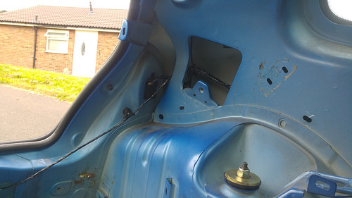

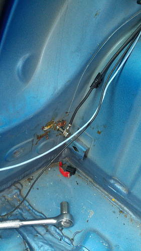

I moved the earth cable for the rear lights as it trails down really low and looks ugly. Went from here...
20160724_150820 by dann2707, on Flickr
To nut and bolted behind here. @Ben NBR Cup that is how i've done it, saves it trailing down!
20160724_150826 by dann2707, on Flickr

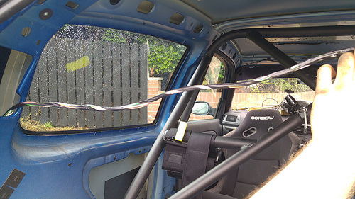

Taped up the tailgate loom looking like this
20160724_151506 by dann2707, on Flickr
To this
20160724_153007 by dann2707, on Flickr

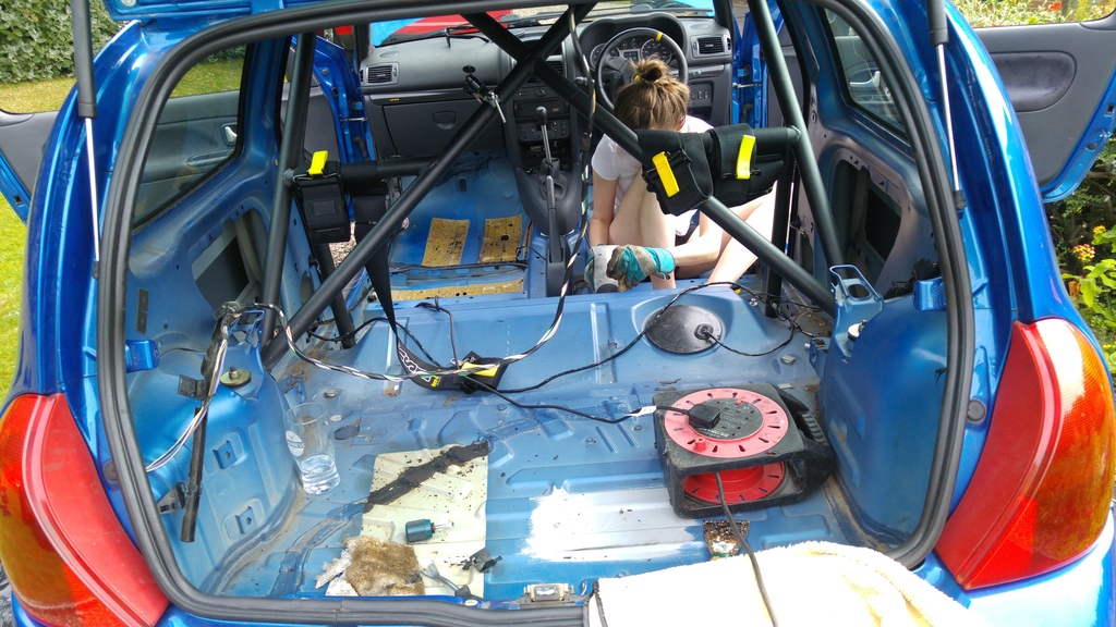

The back end now looks like this
20160724_151513 by dann2707, on Flickr
20160724_153003 by dann2707, on Flickr

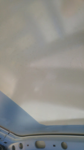

Roof is glue and tar free
20160724_154137 by dann2707, on Flickr

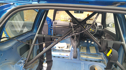

More pics of the rear, @RyG hopefully that helps!
20160724_154145 by dann2707, on Flickr

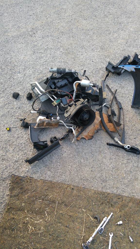

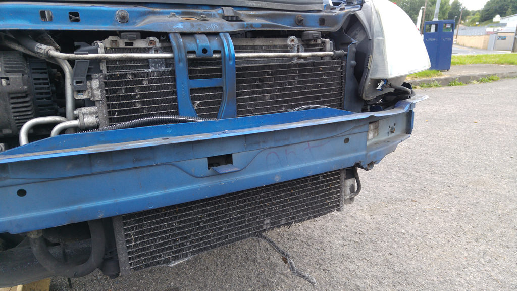

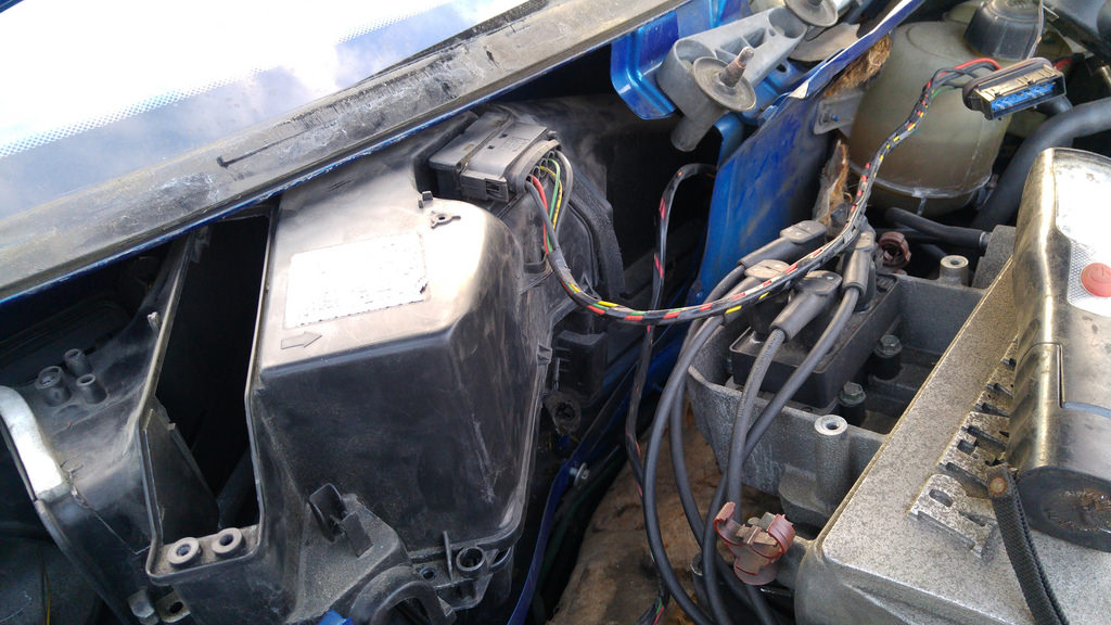

Tonight I started removing the air con and parts that go with it.... the phrase you're only supposed to blow the bloody doors come to mind...
20160725_191147 by dann2707, on Flickr
20160725_191542 by dann2707, on Flickr

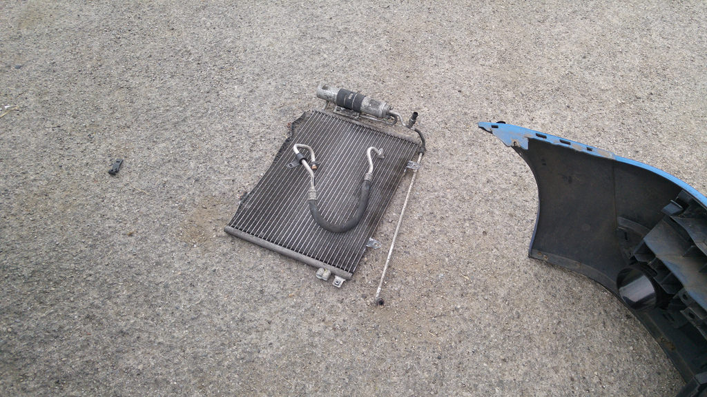

This thing was the biggest prick ever to remove! It just wouldn't budge and it was starting to get dark. I'll admit I lost my patience which I don't normally do. Ended up snapping a bit of plastic.
20160725_203113 by dann2707, on Flickr

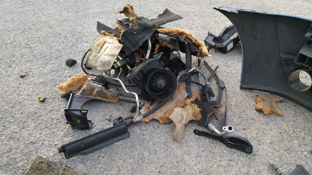

and voila. The whole fucker is coming out!
20160725_204948 by dann2707, on Flickr
20160725_205334 by dann2707, on Flickr

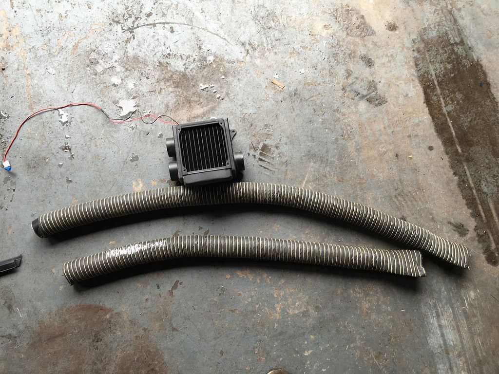

Going to be looking at race heaters now. Will be removing all the associated parts that go with it too.

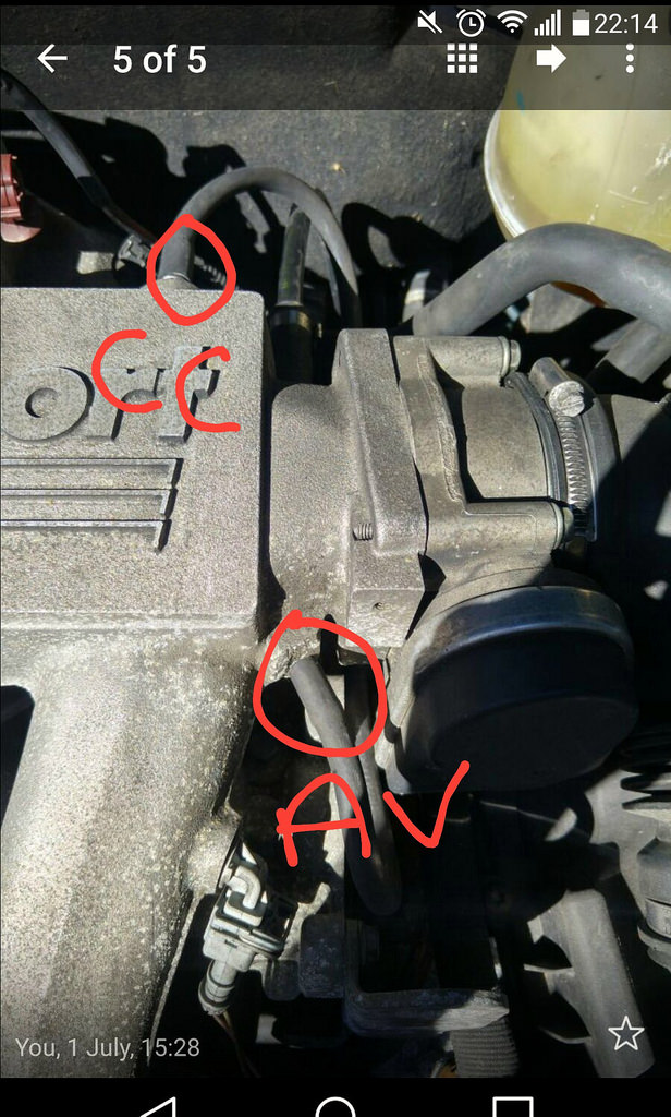

What did you do regarding removing the carbon cannister bud? Guide?
There is just one bolt holding it on, think it's 13mm which points towards the sky. Then there are three connections on the top they are:
- Plug connector with two pins
- Pipe going to fuel tank
- Pipe going to the inlet manifold (the plug at the back of the inlet and it's on a squeezy clip, it's also a solid pipe and not flexy to help you locate it)
I disconnected the plug (some say you need a resistor but mines been fine, no lights on the dash for it yet after a month). For the pipe going to the fuel tank I siliconed a screw in there just where it was disconnected at the CC.
Finally, for the inlet side I looped a pipe from the inlet manifold to where the acoustic valve goes also on the inlet manifold so basically it is feeding into itself if that makes sense? Will upload a pic in a sec.

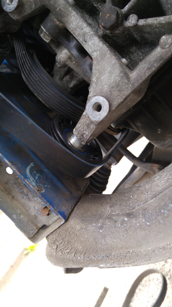

Finally got a belt on that actually fits @Mash. I followed the WRC air con delete guide on here however the belt was wayyyyyyyyy too long - tried a few more and couldn't get it perfect.
Managed to get a 6PK1625 on there and its tensioned well, the car drives! however it's squealing on full lock so think I might need an even smaller one maybe 1623.

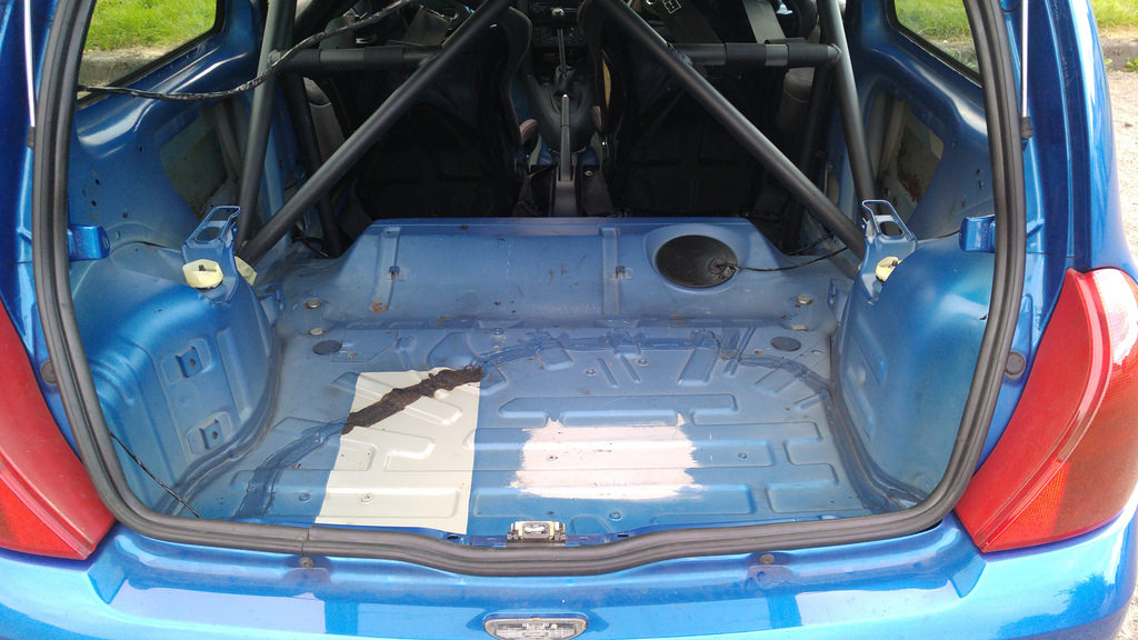

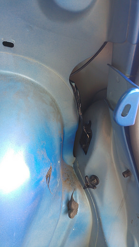

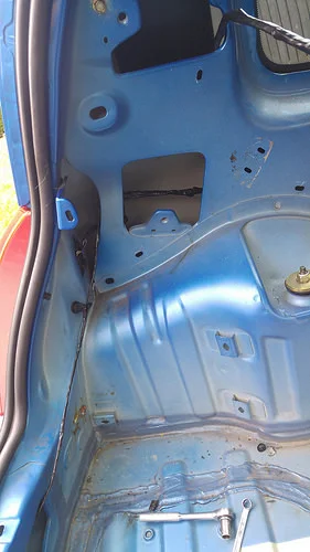

Tonight I removed more tar from the hidden parts of the car (side panels at rear) and under the skuttle panel. Probably another 1.5kg or so. I have then cleaned it up and masked off a few things ready for paint this week.
20160731_204422 by dann2707, on Flickr
I feel like it's not going to be as quick as I imaged regarding the painting as there's a lot to do!
