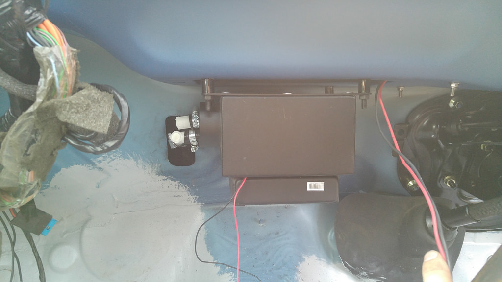

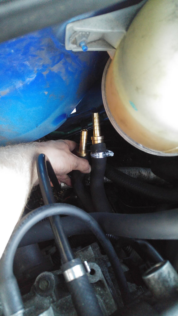

Tonight @Louis' kindly took me after work to ash silicone hoses place in Huddersfield to get my heater pipework.
We're on!
20160819_193936 by dann2707, on Flickr

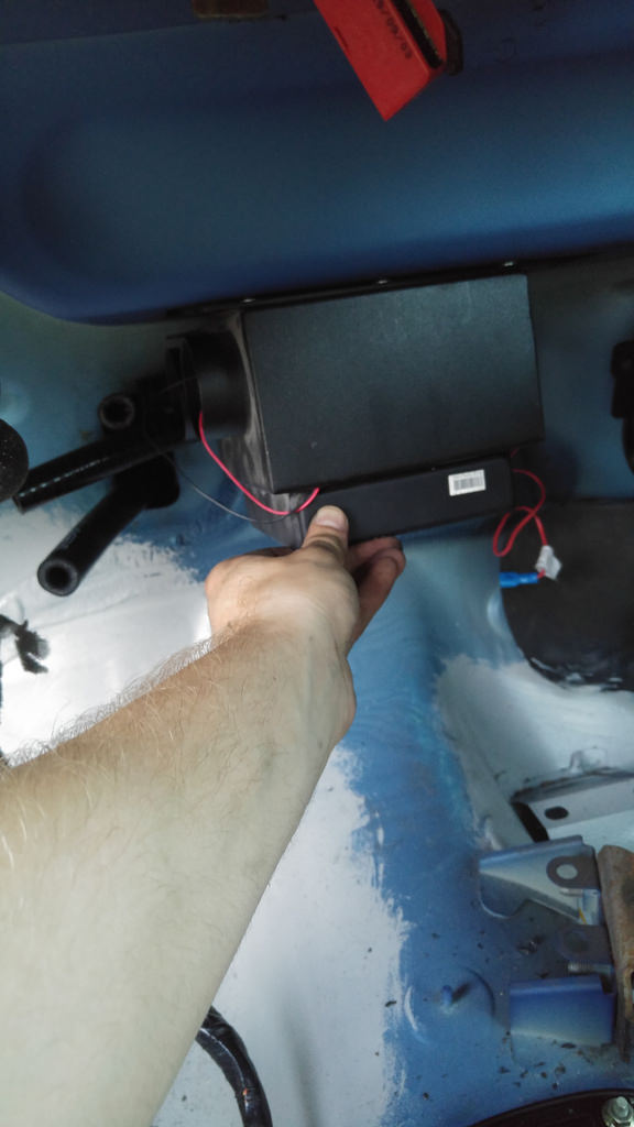

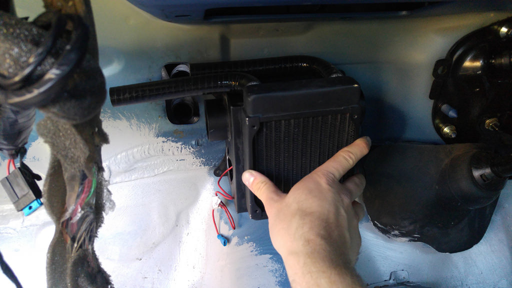

I have a few options of mounting it, both work either way! But it's just the pipework I need to make up.
Either like this
20160819_194011 by dann2707, on Flickr
Or like this
20160819_201347 by dann2707, on Flickr
Original water pipes were cut off and barbed reducers installed
20160819_195832 by dann2707, on Flickr
Will finish it tomorrow if my 90 degree connectors arrive.

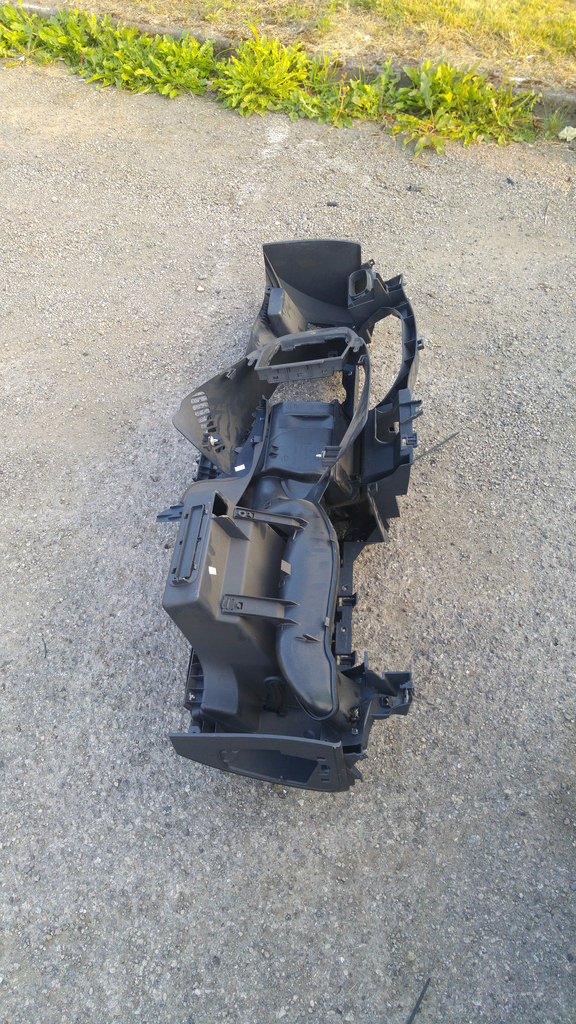

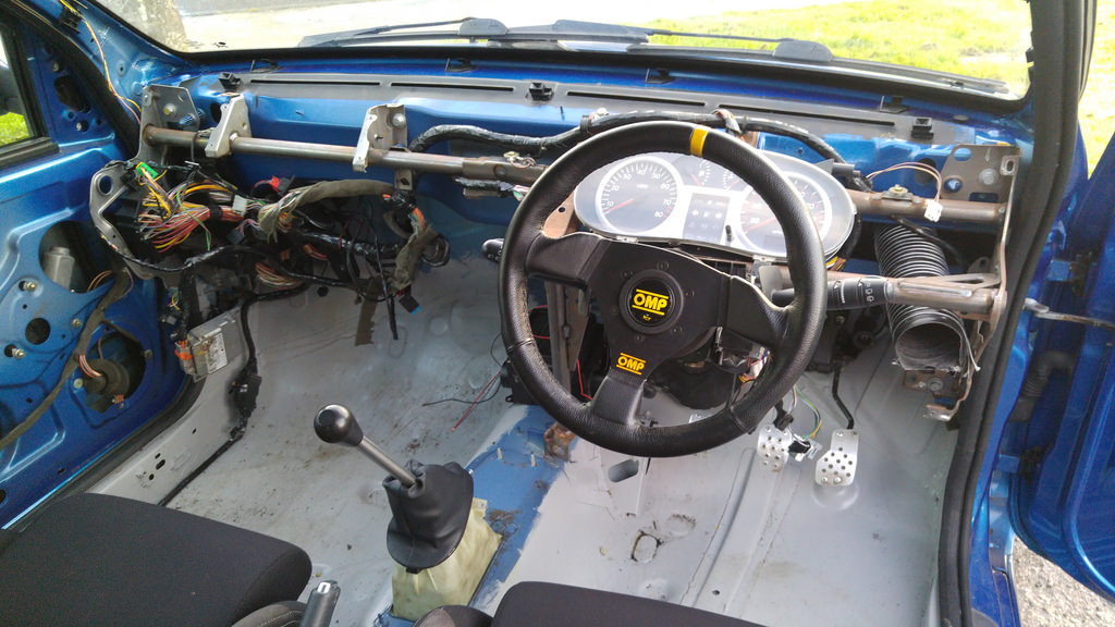

So long lower dash it's been nice knowing you
20160818_185412 by dann2707, on Flickr

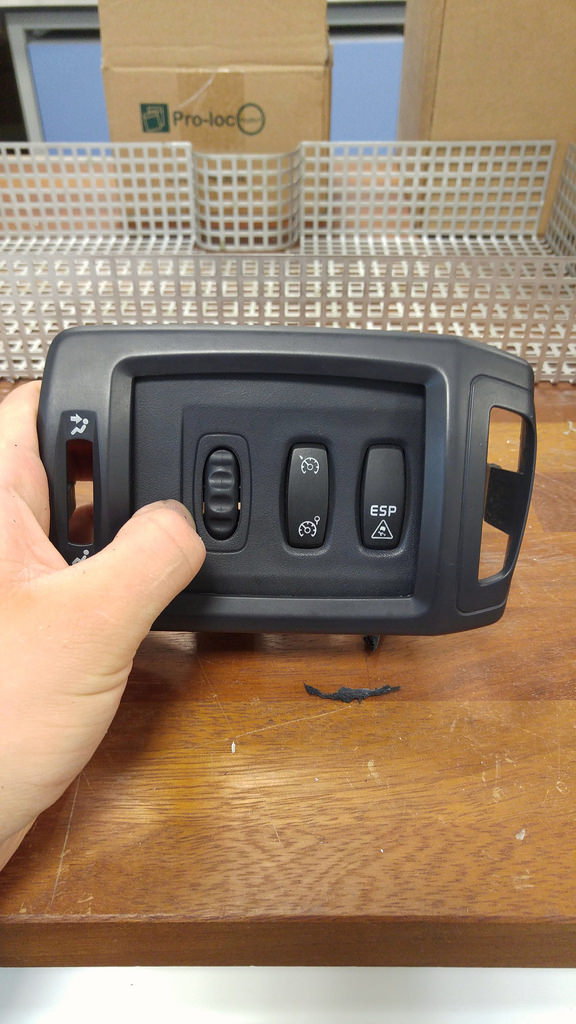

This week has been mainly cleaning peoples injectors and a few car bits. Nothing amazing as i'm waiting on SOOOOOOO many parts to arrive. Switches and carbon fibre for my centre panel,

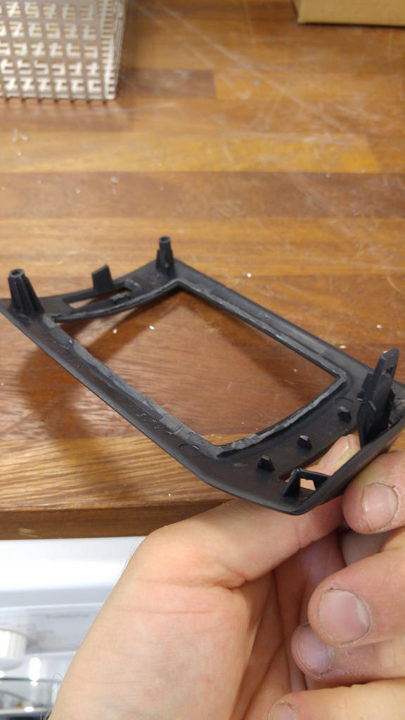

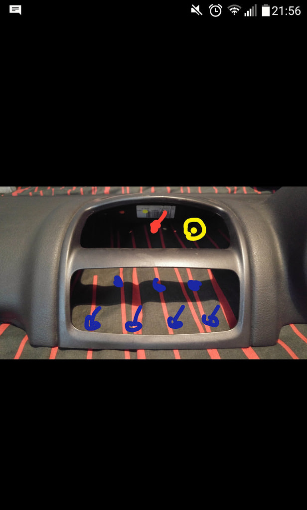

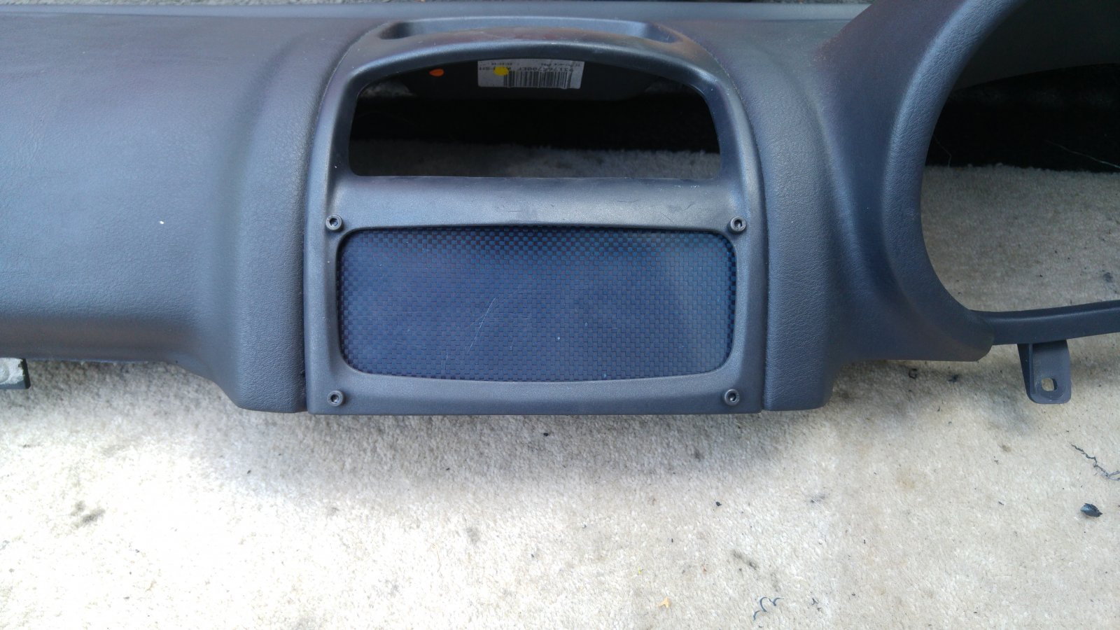

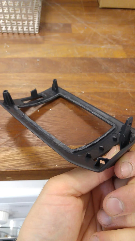

I also started making the panel for my ESP and cruise control by cutting out the old heater vent on the drivers side
20160823_172047 by dann2707, on Flickr
Got it in like that ready to be araldited in however i'm not happy with it, purely because it's not central and you can't get it further across due to the shape of it
2016-08-23_08-18-13 by dann2707, on Flickr
So i'm going for carbon fibre on that panel too, with custom switches - watch this space

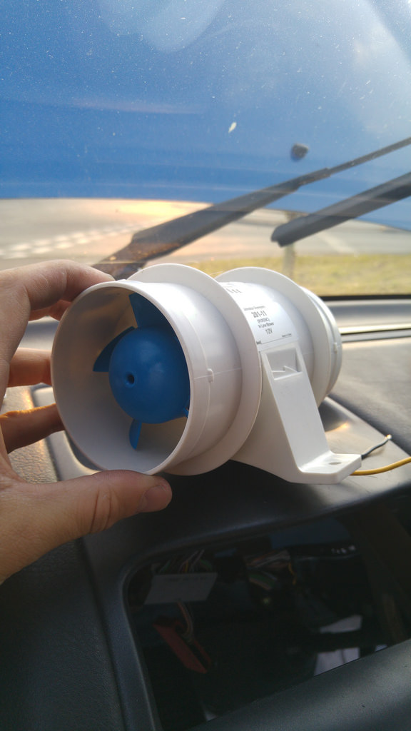

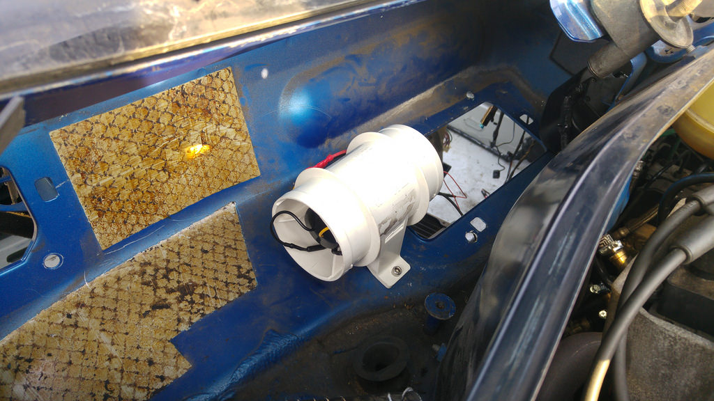

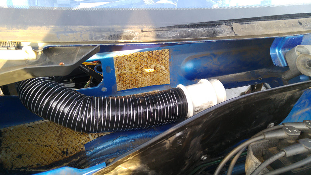

I fitted my blower
20160823_190734 by dann2707, on Flickr
20160823_190821 by dann2707, on Flickr
Its bloody powerful! But definitely sounds like a leaf blower.

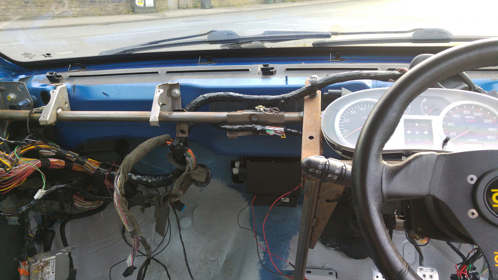

Tidied the dash up a bit, going to be relocating the ECU airbag etc
20160823_195959 by dann2707, on Flickr

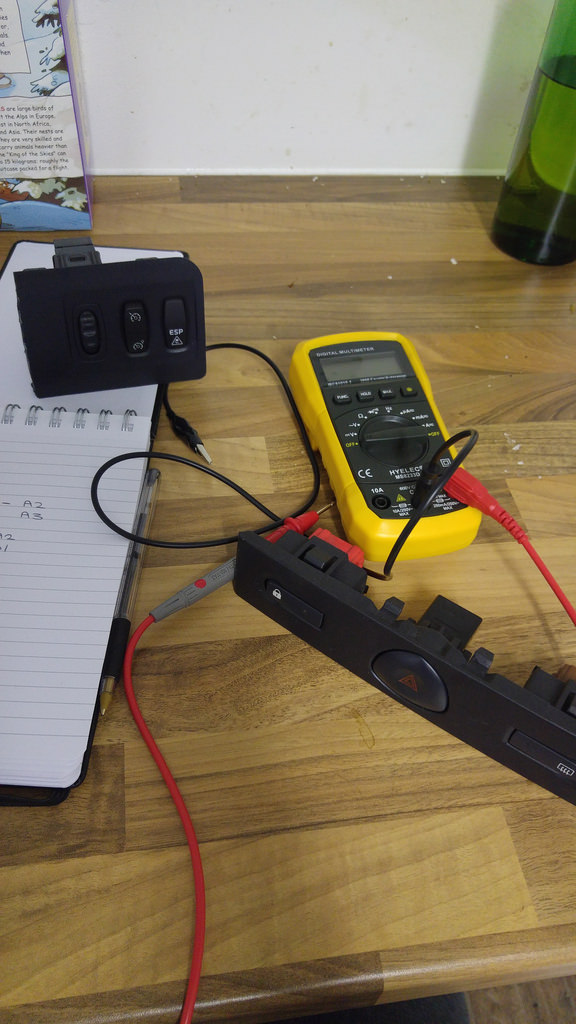

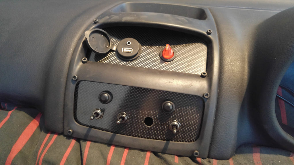

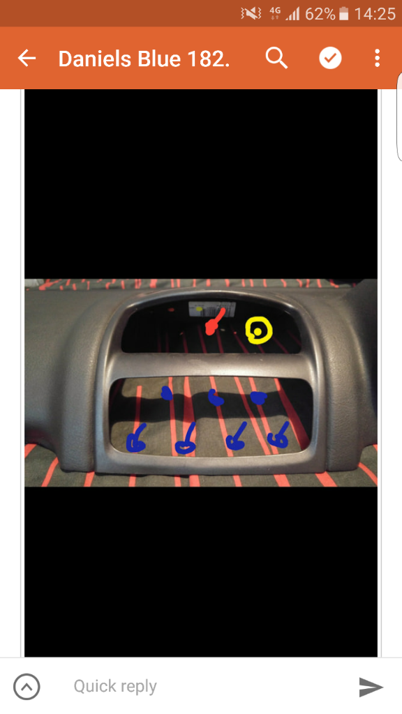

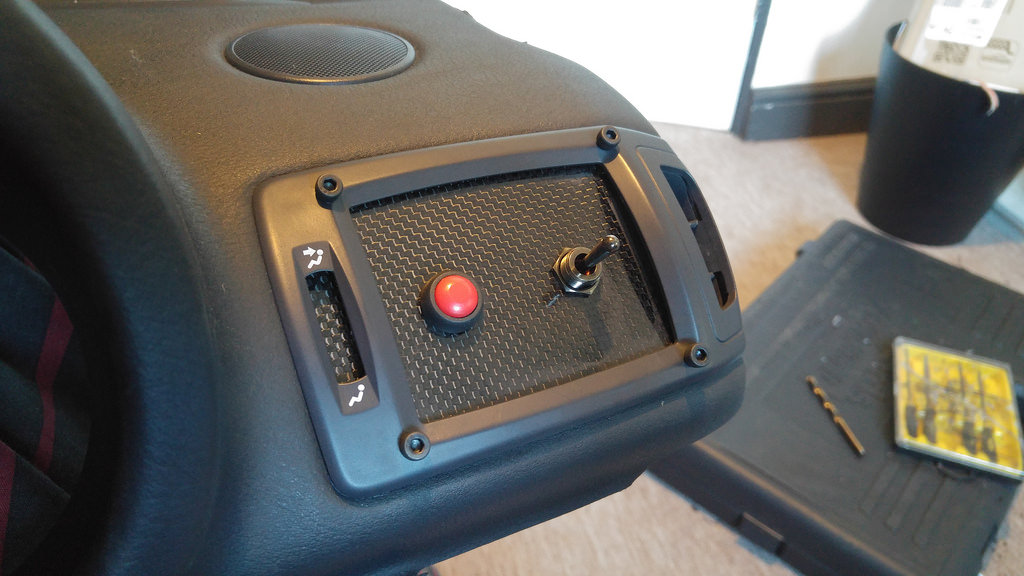

Tonight i've been identifying what does what on the switches and making a note of what the wires do. Pretty fun and very rewarding. Had to quickly dash out to my car with a button switch to make sure its doing what I think it is. IT IS
20160825_195747 by dann2707, on Flickr
20160825_195749 by dann2707, on Flickr
This is also how i'm mounting my switches. I've gone for these sexy switches but they're pretty costly but I really wanted black toggle switches and all the same style.
The top panel is going to consist of hazards, USB and aux input
Bottom panel will be:
Top - door lock, heated rear screen
Bottom - pass window, heater, cooler, driver window.
It's a multitude of (on) OFF (on) and on off on switches, coupled with a few MOM/off switches for good measure all depicted by the each type of switch I have in here.
Ignore that third blue button that was gonna be for my hazards but ive moved that to the top panel now.
2016-08-25_09-57-23 by dann2707, on Flickr

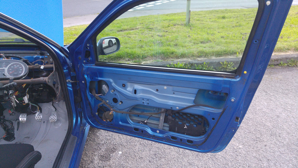

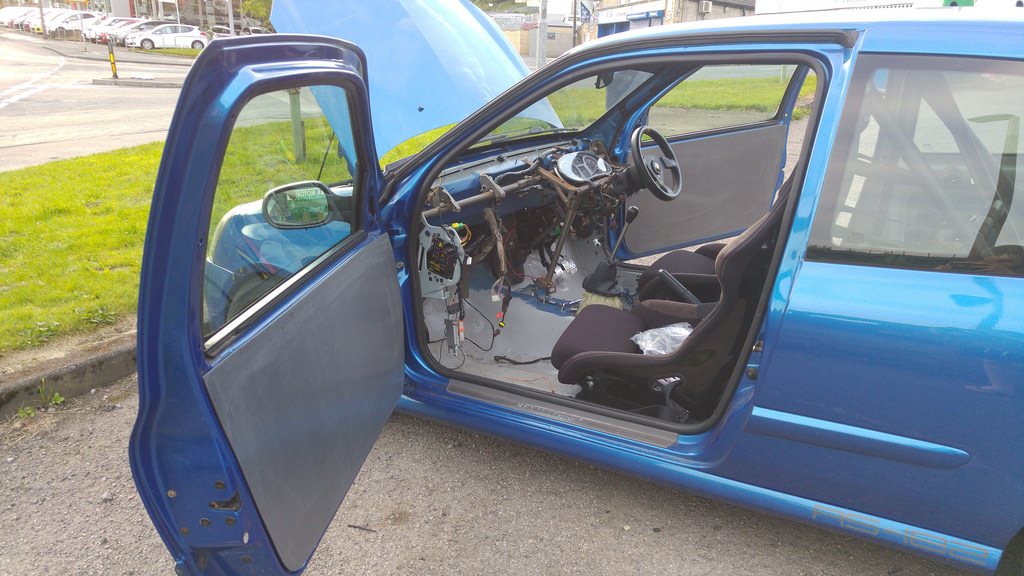

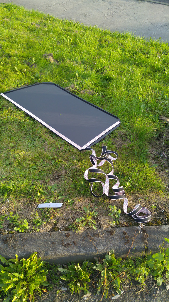

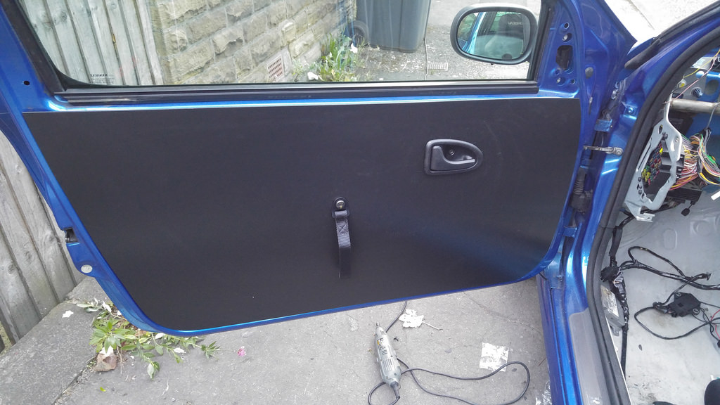

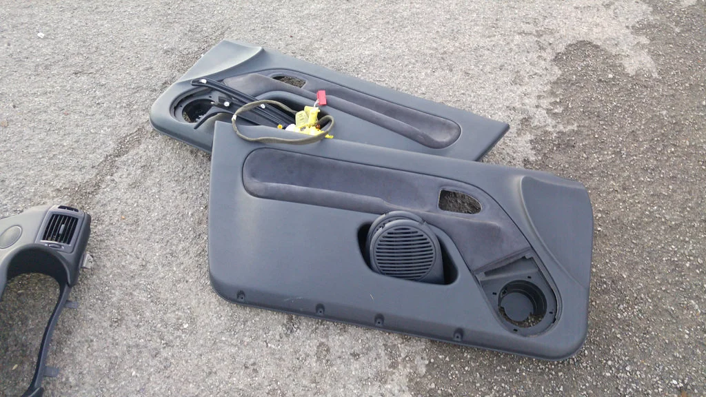

Going back in time now but I forgot to say, door cards are also off. Got my flat ones at work, just need to pick my dremel up from home so I can get cutting the slots for door pulls, handle etc.
20160822_201544 by dann2707, on Flickr
20160822_201548 by dann2707, on Flickr
I've learnt a lot from this. Really enjoying taking the car to bits!

Tonight i've been tinkering holy s**t it's 12.22! I feel like a student again.

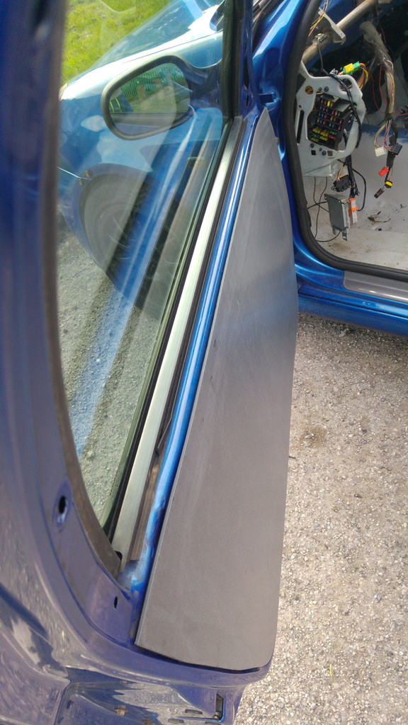

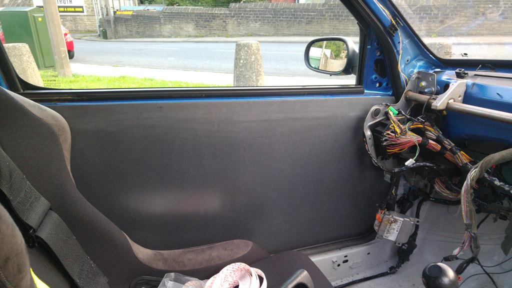

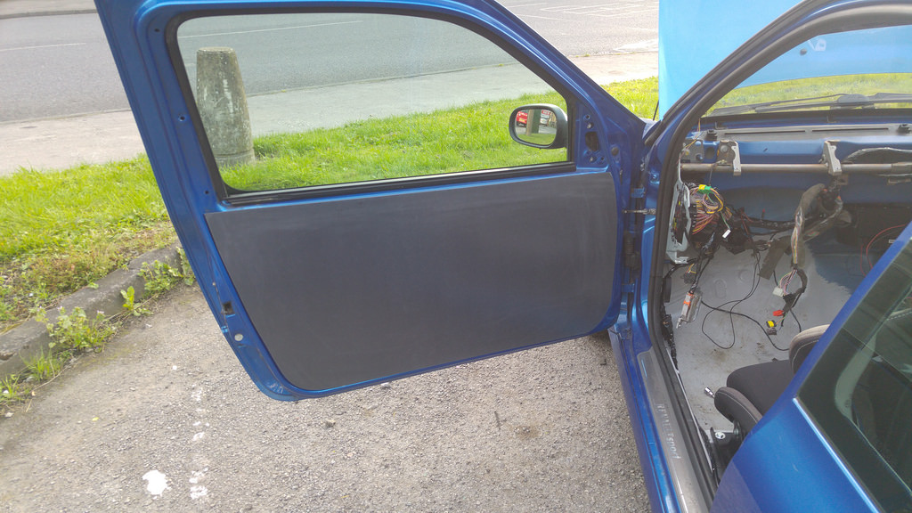

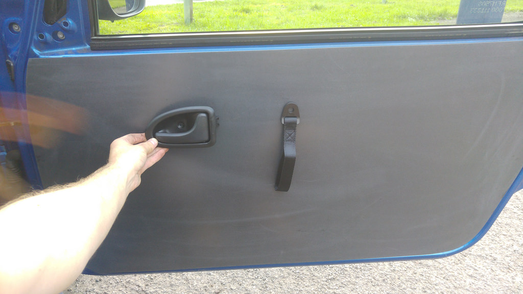

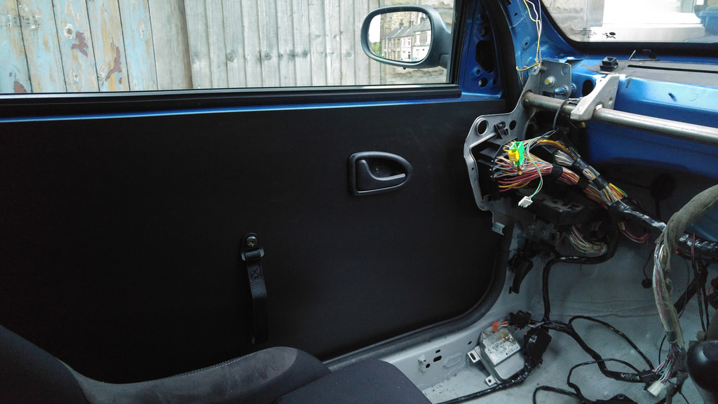

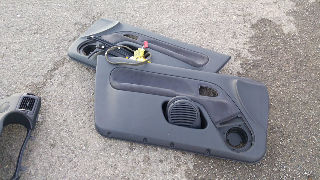

Got my @bristolnate door cards on. Absolutely beautiful things! I used velcro to stick them on. It's worked really well
Lots of velcro
20160826_190412 by dann2707, on Flickr
The plastic covering is still on
20160826_193135 by dann2707, on Flickr
20160826_193347 by dann2707, on Flickr
Thought i'd go for something different too, people usually use the silver door handles but i'm going for the stealth look
20160826_193819 by dann2707, on Flickr
20160826_194636 by dann2707, on Flickr

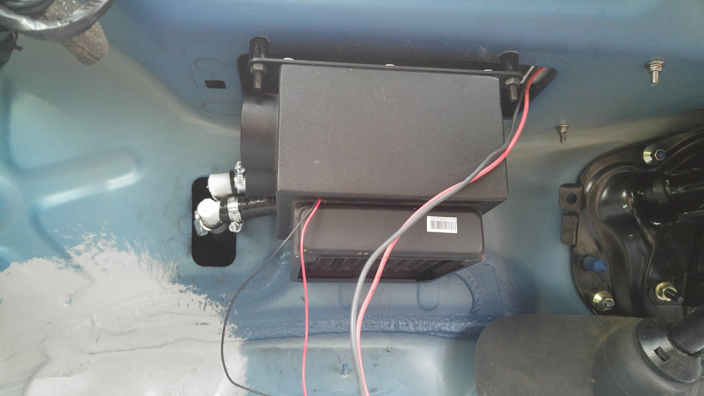

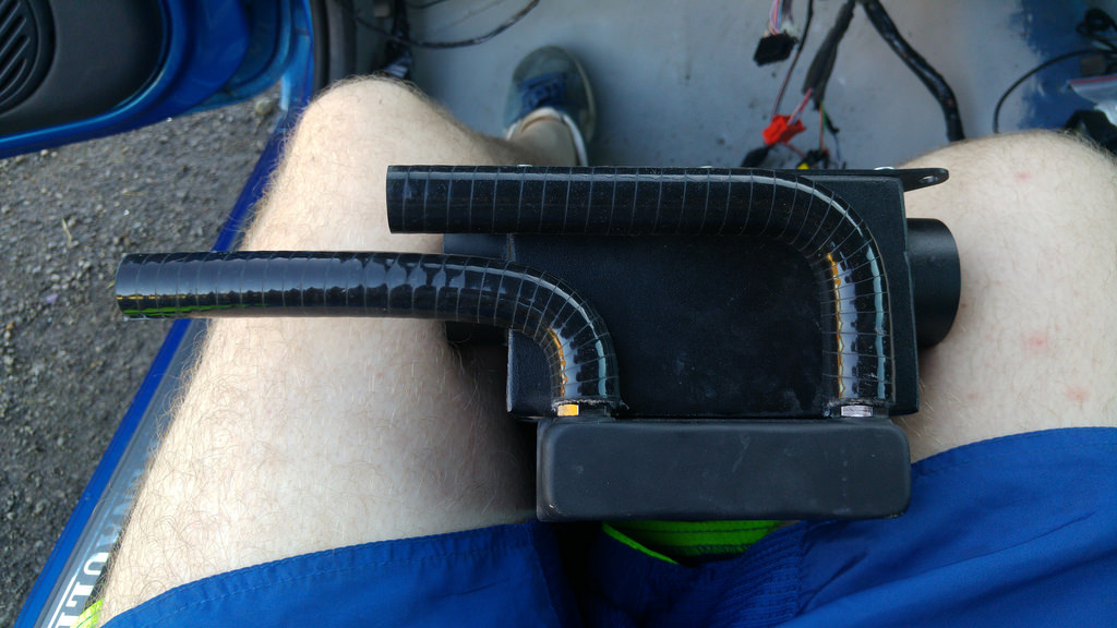

I also fitted the heater properly tonight. I've used nylon stand off washers to space it out due to the angle of the coolant pipes. Think it looks pretty decent too!
20160826_194747 by dann2707, on Flickr
20160826_194757 by dann2707, on Flickr
20160826_194804 by dann2707, on Flickr

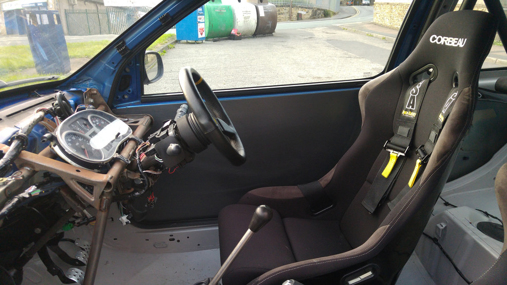

Another pic of the door card against the wheel and seat.
20160826_195447 by dann2707, on Flickr
Velcro holds it on well, it's nice and straight. Deffo recommend.

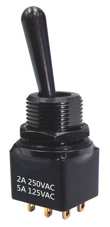

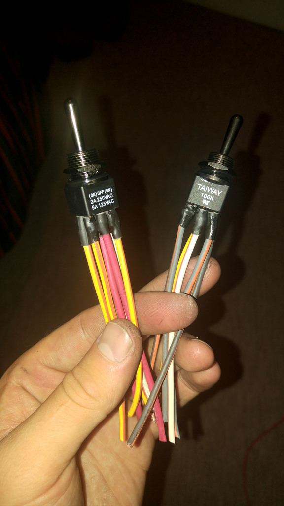

I also received my switches from RS so started wiring them up. These have to be DPDT as that's how the window operates. Basically when you flick the switch up and down it reverses the polarity of the wires to the motor which either goes up or down.
All done!

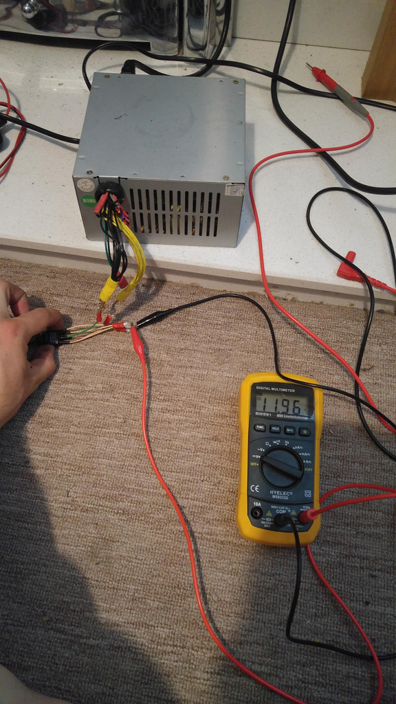

I then tested it to see if it all works, it does as you can see when im pressing it one way the voltage on the LCD display is negative 12v.
20160826_220108 by dann2707, on Flickr
Then flicking it the other way you get positive
20160826_220121 by dann2707, on Flickr
It's so handy having a PSU fixed for 12v output for things like this. Thanks @Matt555 for the tip with that.
20160826_195544 by dann2707, on Flickr
All done!
20160827_000646 by dann2707, on Flickr

And good call on ththe door handles being stealth, looks better than silver, I'm tempted for mine as the silver looks a bit cheap sometimes for me day to day.

Tonight i'm giving all my switches small wires for spade terminals to allow them to be fitted and removed easily. I fitted my passenger door card too with door pull. Got some sexy m10 cap head bolts to go in the place of that bolt that's there now.
20160830_195432 by dann2707, on Flickr
20160830_195911 by dann2707, on Flickr
I'm really glad I went with black handles. Think it all nicely goes together. I do have a gap of around 5mm from the door card to the handle though. I am either going to cut the door to get it in there more or... I can't remember the other one i'm too hungry hahaha
Thanks x
