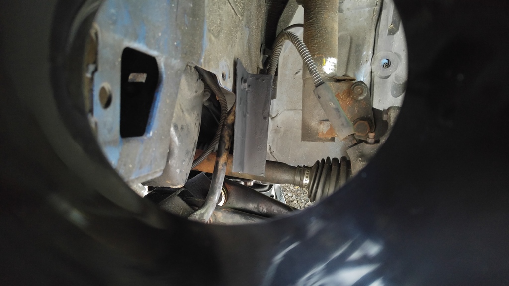

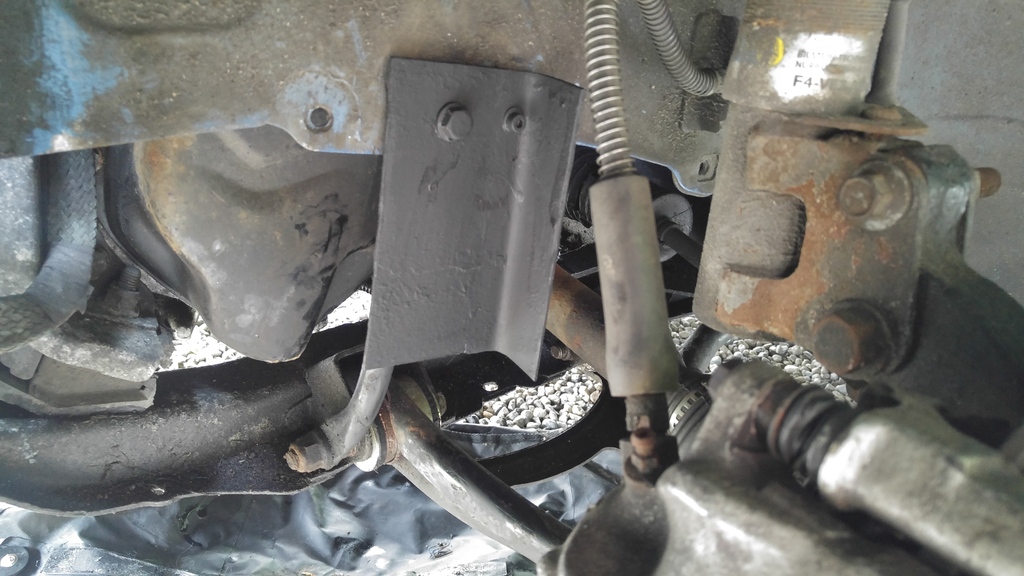

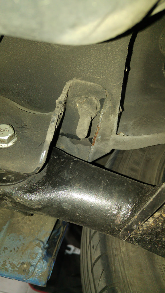

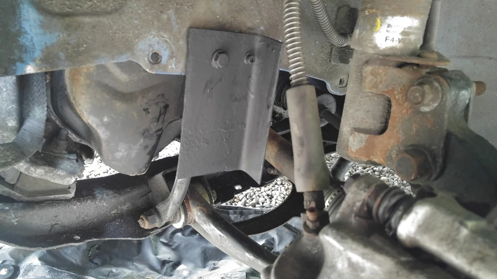

On saturday morning I had my alignment. They knew all about the crash and spotted this on the rear carrier to the beam. If you look closely at the right of the bracket you can see how it's shiny and clean as it's slide during the impact. We loosened the carrier bolts and slid it back into place :)

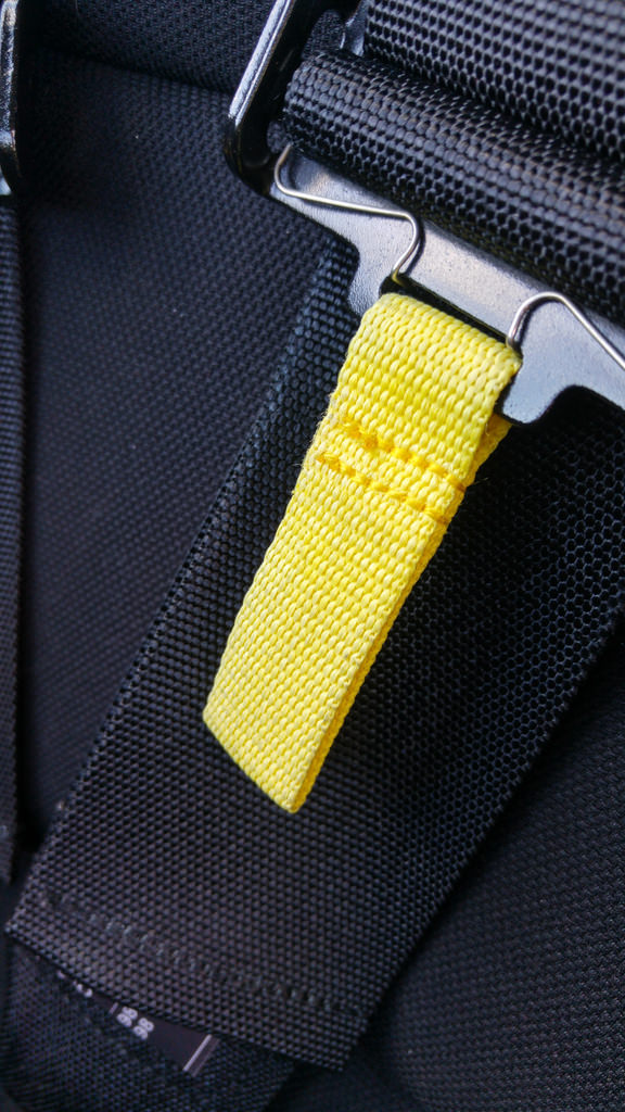

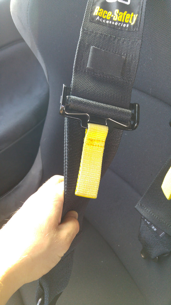

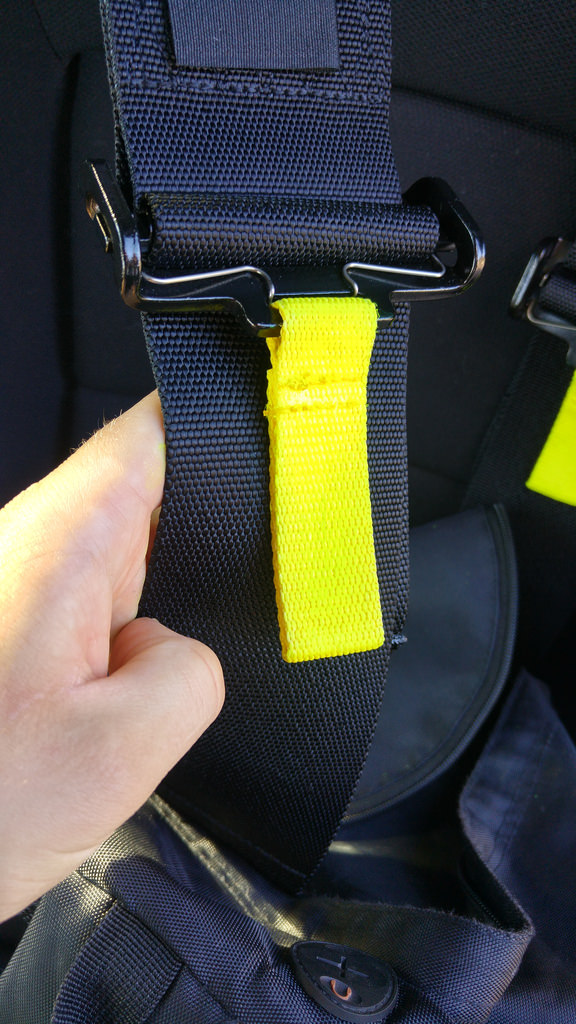

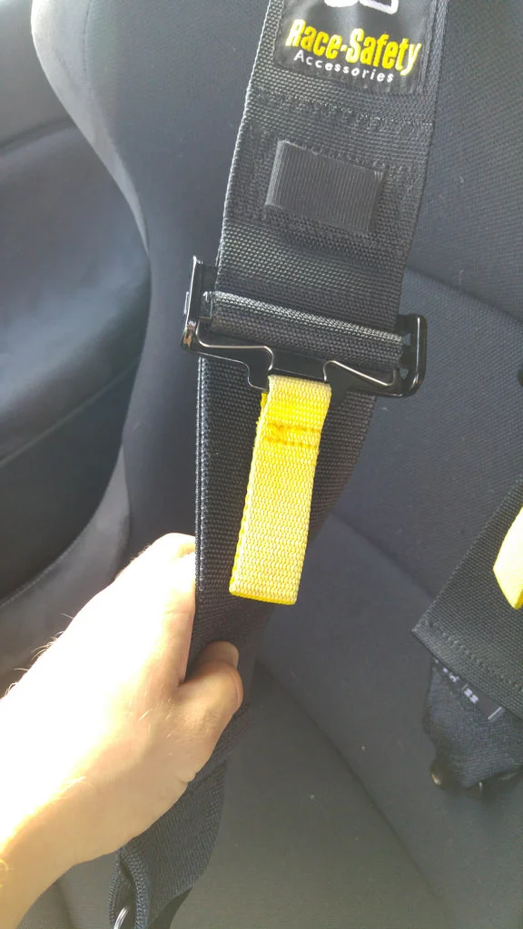

Did a little something tonight, just for a finishing touch really. My harness toggle pull things were fading badly. It's so hard to capture it.
20160629_190116_HDR by dann2707, on Flickr
20160629_190122 by dann2707, on Flickr
And now they look like this. Again it's hard to capture it but in the background you can see how it actually looks. it's luminous yellow! WOOOOO. Also was only £5 for three from the range.

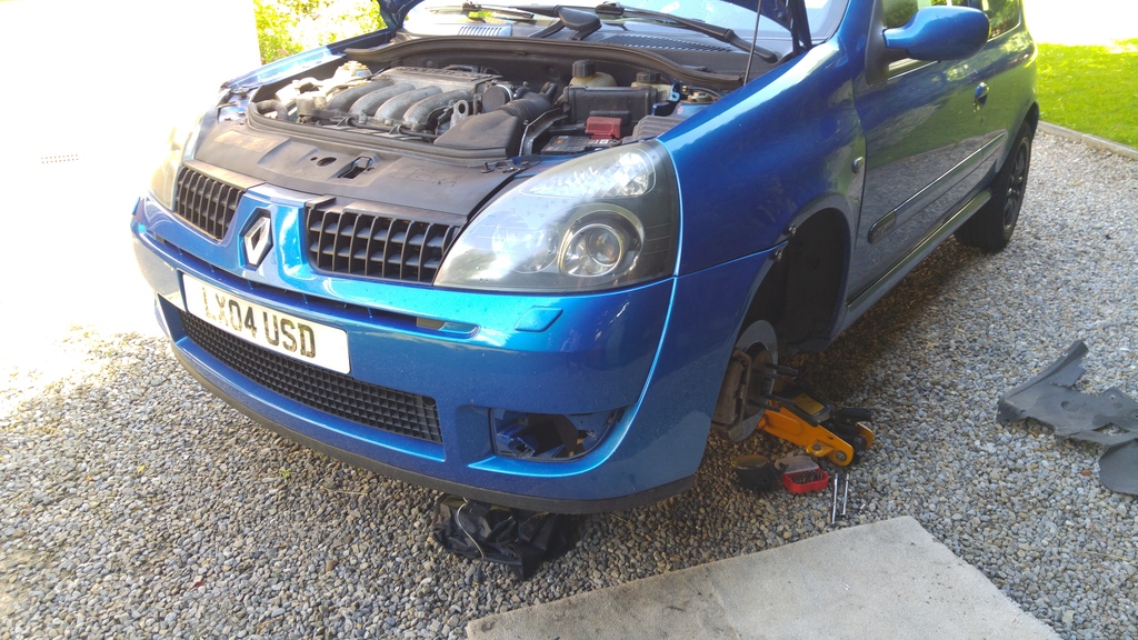

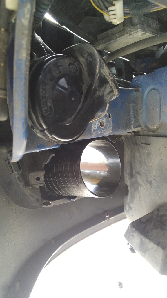

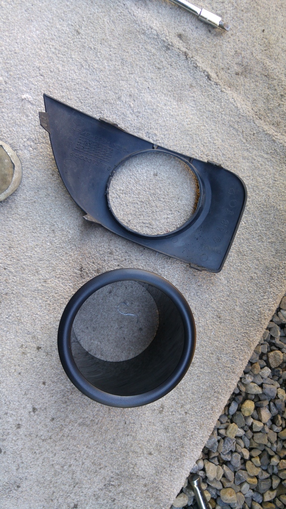

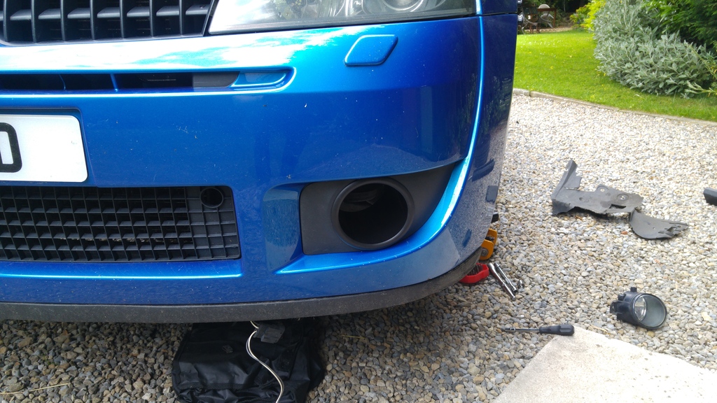

I'll post what I did today. It consisted of making brake ducts for my fog lights with inspiration from @RyG
Removed the original fogs
Then these 100mm bass ports have to be fitted inside the original housings
One in and one out
I relocated my horn above too to allow maximum air flow
Both fitted

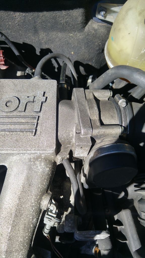

I had to remove the carbon cannister from the offside. Thanks to @JP83 for the help on that one.
I just simply looped the carbon cannister pipe to the acoustic valve pipe as they both aren't needed as seen here
I then made some brake deflectors by using some sheet steel bending it and drilling it. Painted it black
Got no ducting though as I didn't have enough time to sort that out but the air flow looks like it should hit them nicely
