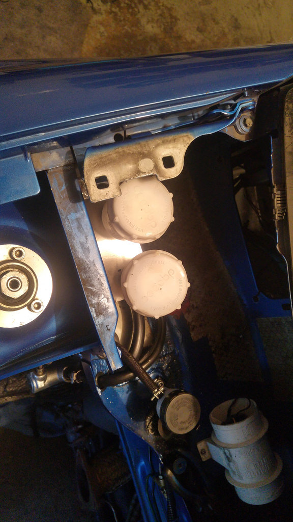

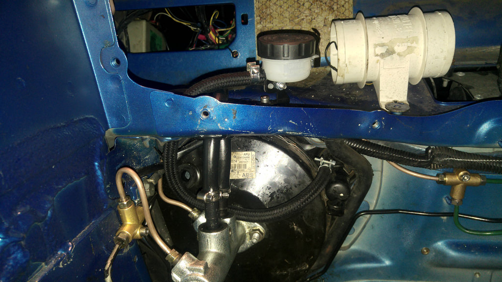

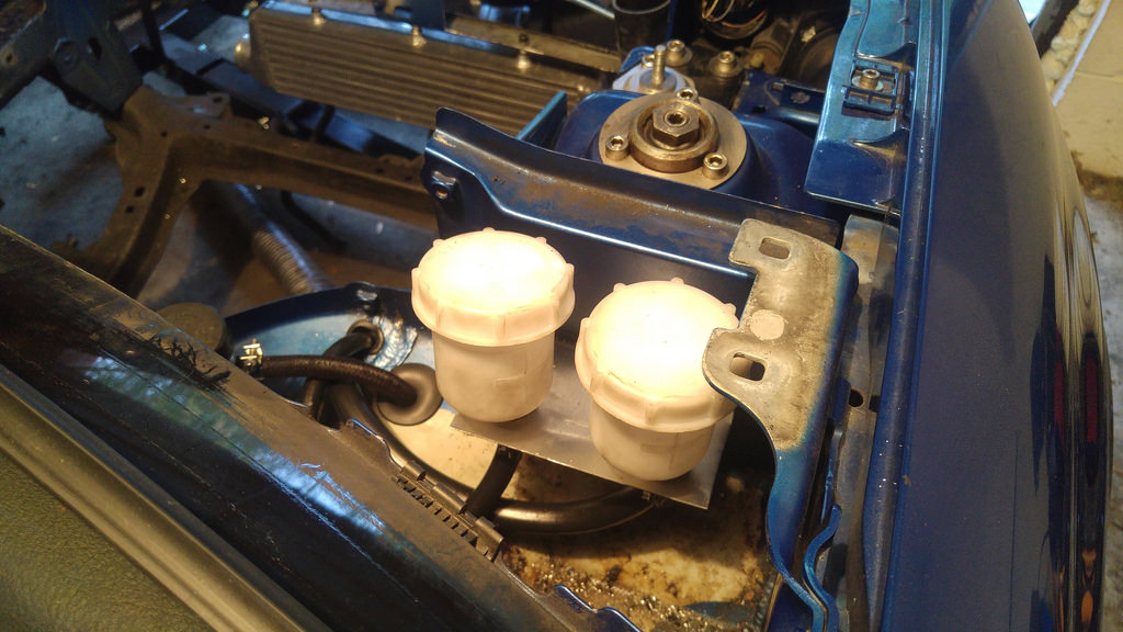

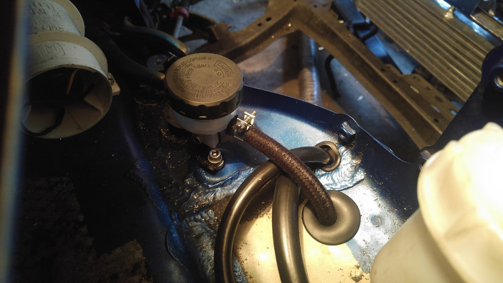

Had some time today so sorted out the reservoirs to the master cylinder. Along with mounting the clutch reservoir which is all plumbed in now.
The brake ressys are mounted where they were before, used some alu sheet that I have bent and riveted to the car.
20171008_174015 by dann2707, on Flickr
20171008_174009_HDR by dann2707, on Flickr
Then the clutch bottle is mounted here, using a rivnut. Pipe fed through grommet to the master cylinder on the bulkhead
20171008_174022 by dann2707, on Flickr
You can clearly see the pipe feeding around here.
20171008_174400 by dann2707, on Flickr

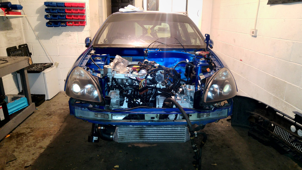

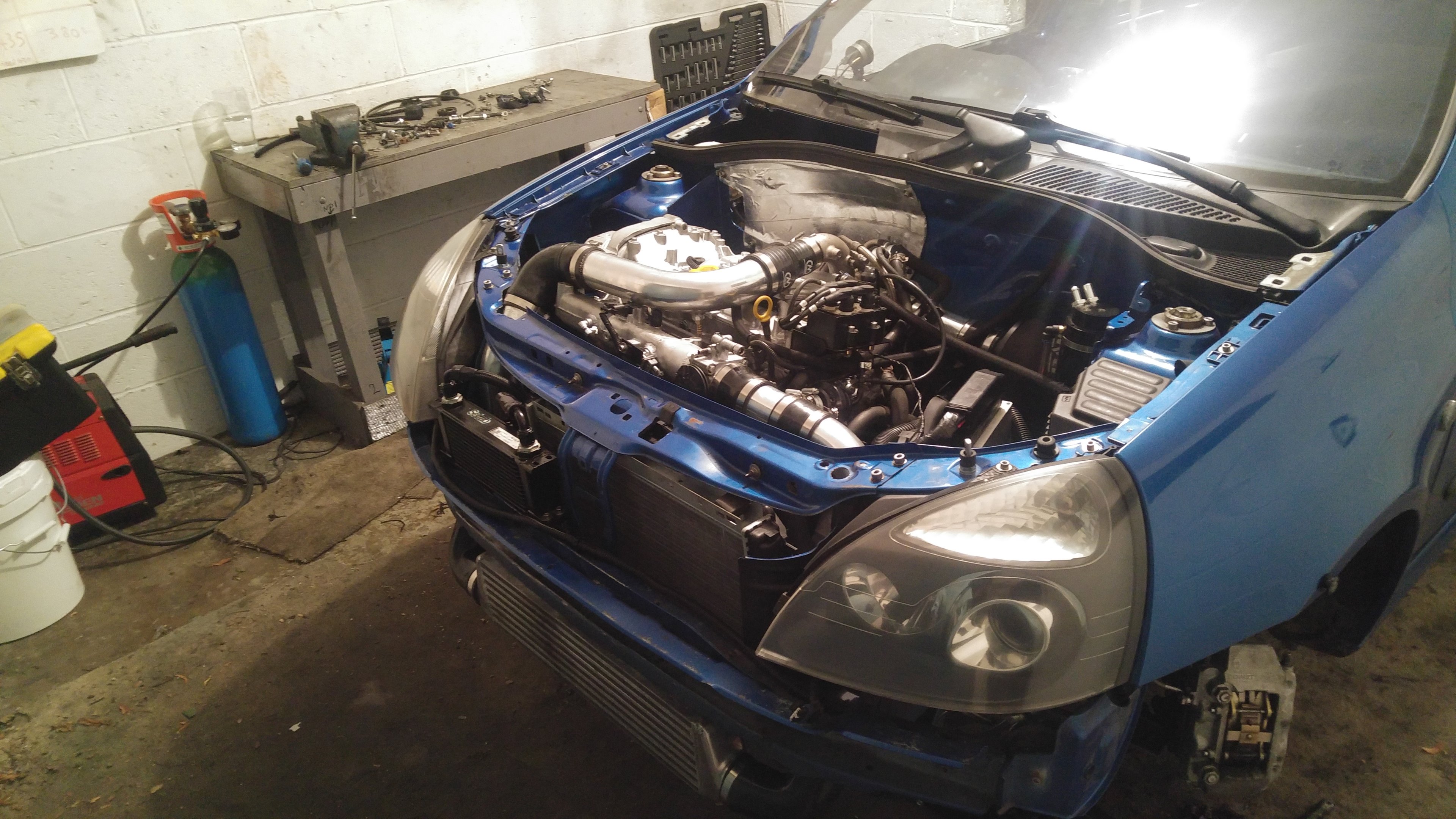

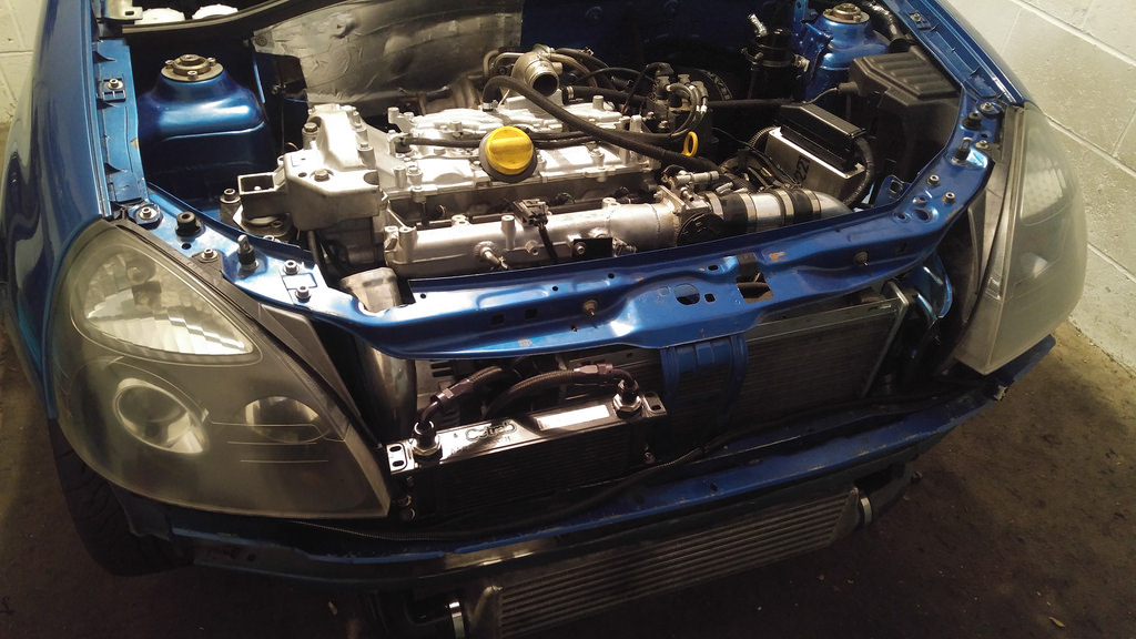

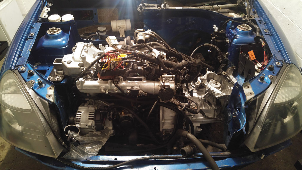

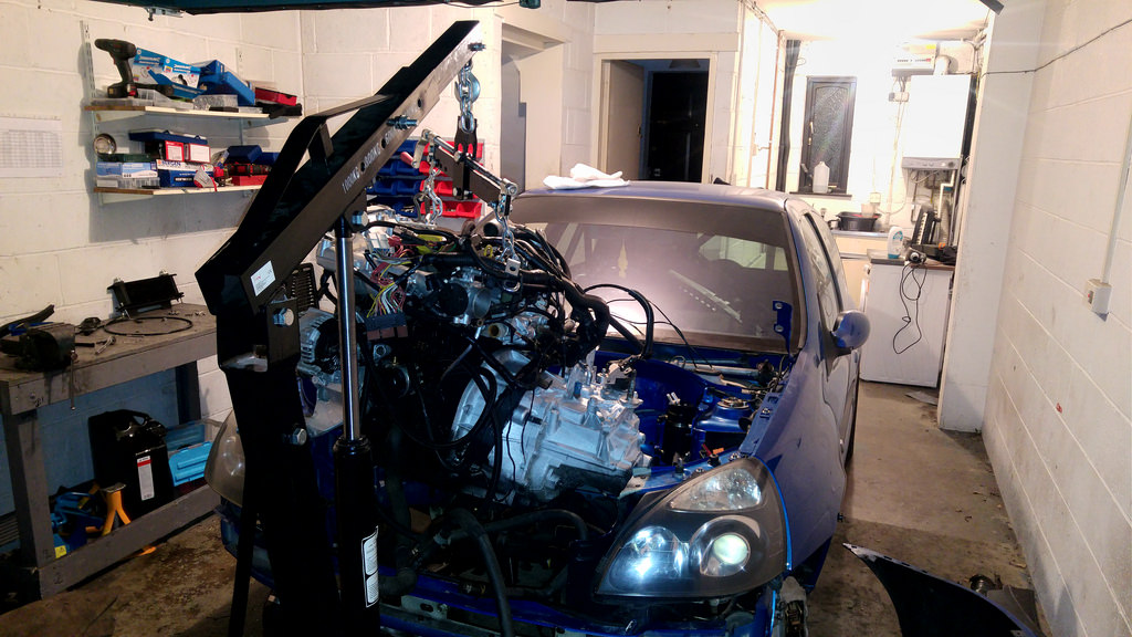

Got the engine back in. Excuse the garage mess at the moment. It is absolutely killing me seeing it in such a state.
20171104_172527 by dann2707, on Flickr
Voila
20171104_180110 by dann2707, on Flickr

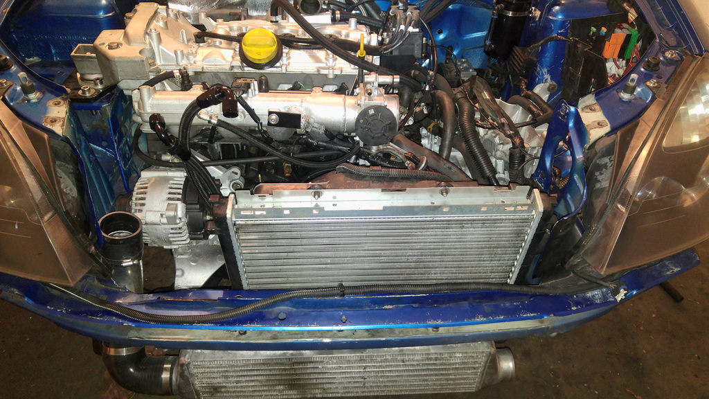

I then started plugging everything in.
20171104_185709 by dann2707, on Flickr
Now I have messed around with the box mounts some more it's raised the gearbox up which means it's clearing a lot of things. Before the engine was resting on something.. more on that later for a lol story. The engine now happily swings on it's two mounts which is excellent news. Before when dropped in it was almost wedged.

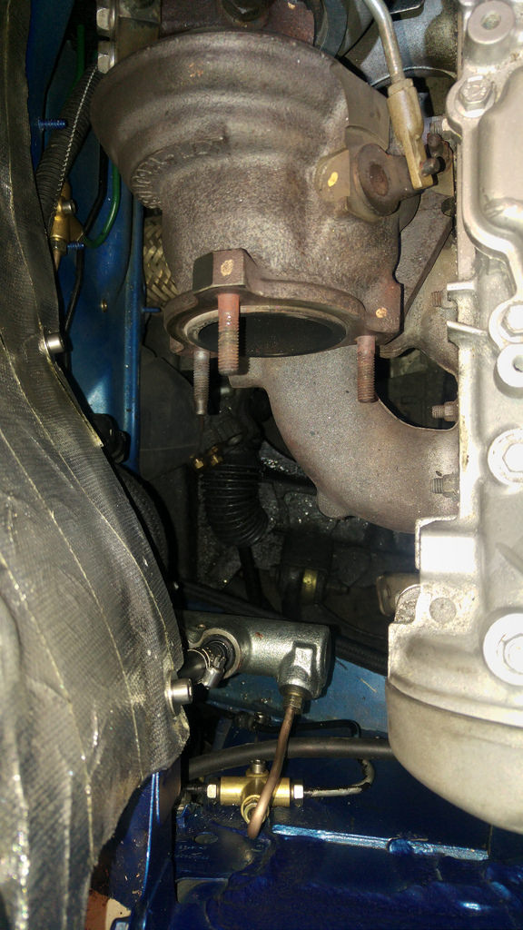

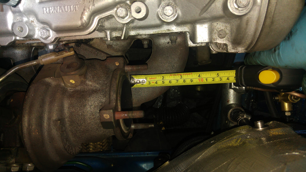

So the next issue, the turbo being so close to the master cylinder. We all knew it was going to be an issue so just showing the issue in hand
20171108_203947 by dann2707, on Flickr
For reference and for those wanting to do the conversion (don't) this is how far away the turbo is to the mc. New custom downpipe required
20171108_204028 by dann2707, on Flickr

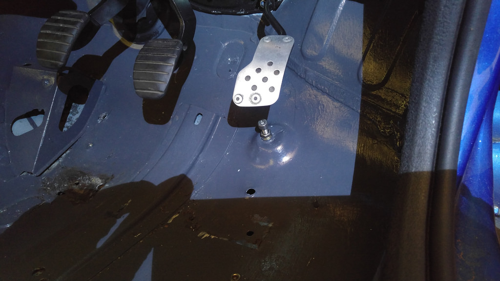

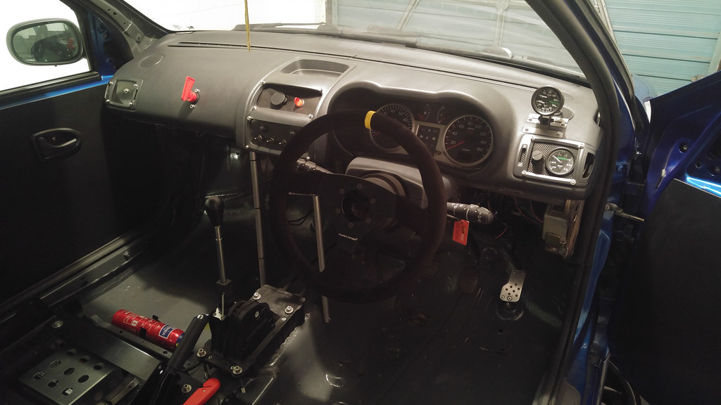

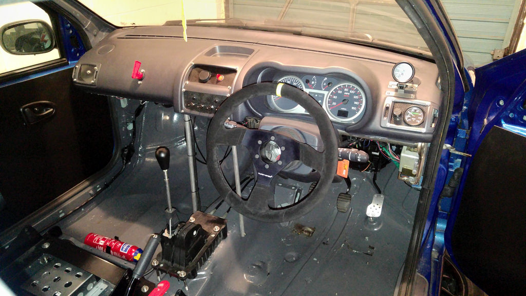

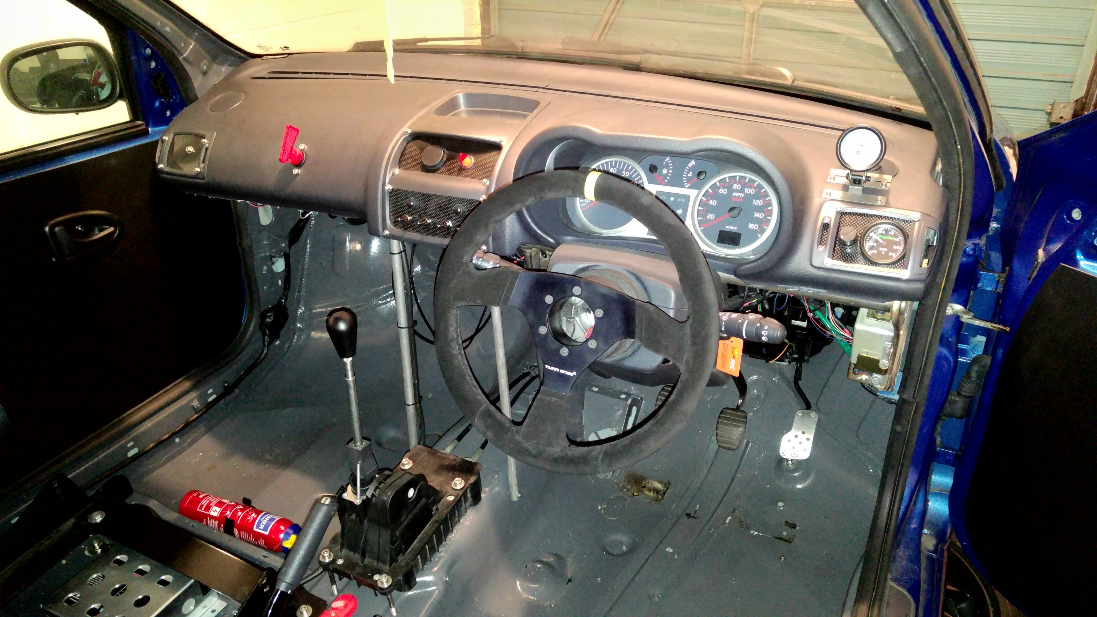

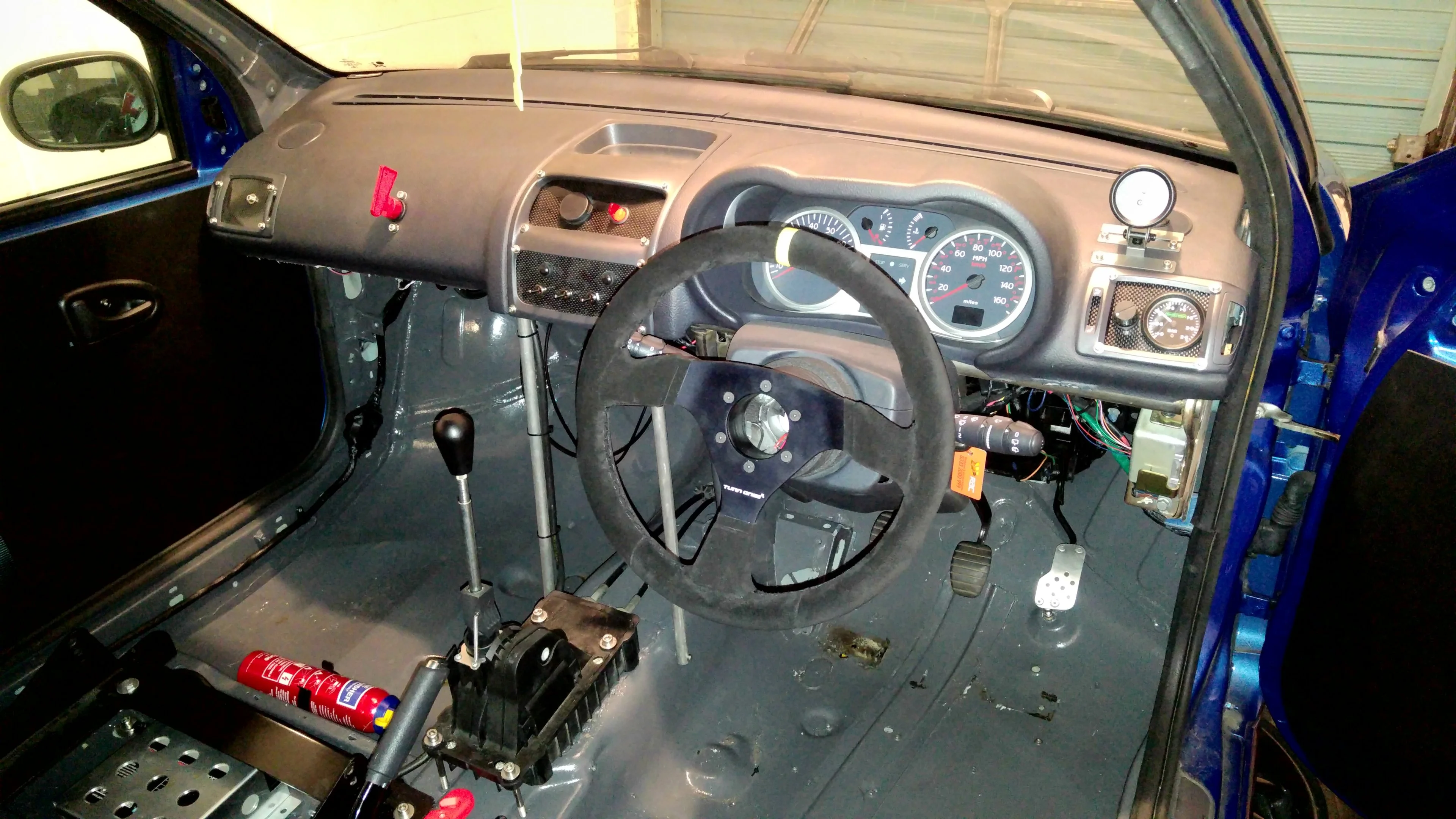

Firstly, the accelerator cable from the ph1 is now all in and connected however due to not having any carpet in the car the pedal could quite easily be overstretched which would snap the pedal so with a trusty m8 bolt and nut I now have a stop. Luckily that rivnut was already there from the pedal box.
You'll probably notice that there is infact a gaping hole in my floor too hahah, that needs welding over a bit.
20171120_204020 by dann2707, on Flickr
Random shot of the new wheel which I don't think I ever pictured despite it being 4 months ago or so. Really happy with the interior now.
20171120_205507 by dann2707, on Flickr
With the flash on, andddddddddd the wheel looks knackered already and it hasn't seen a single mile on the road haha
20171120_205519 by dann2707, on Flickr

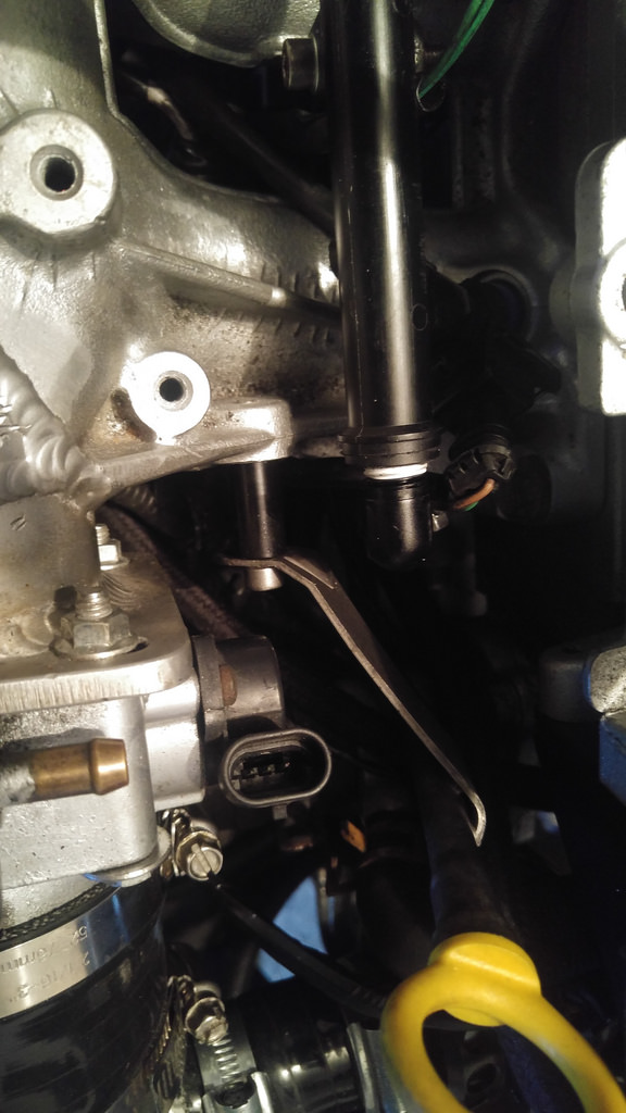

The hole here is where I am taking the feed from for the vacuum servo.
20171124_164221 by dann2707, on Flickr

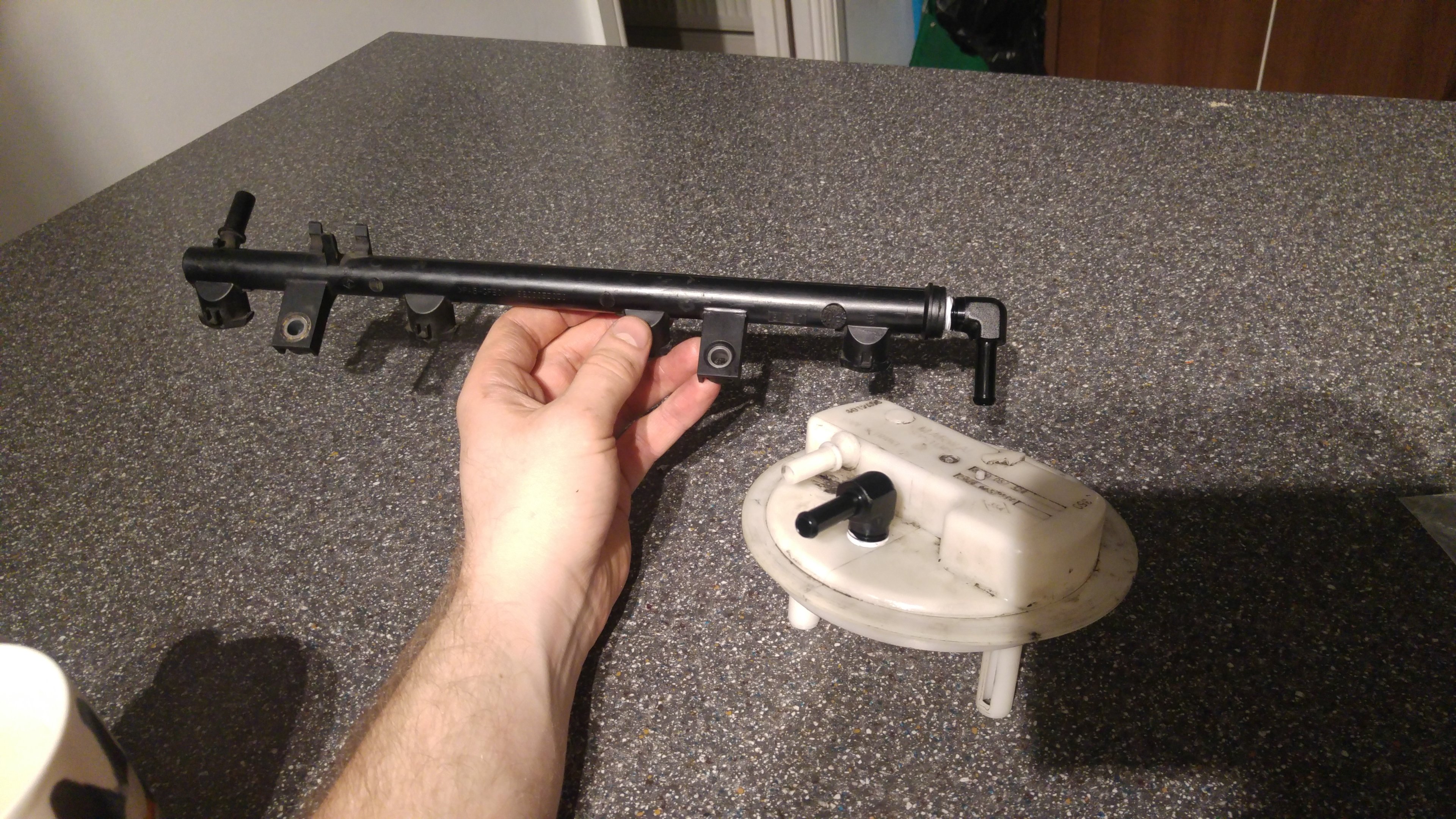

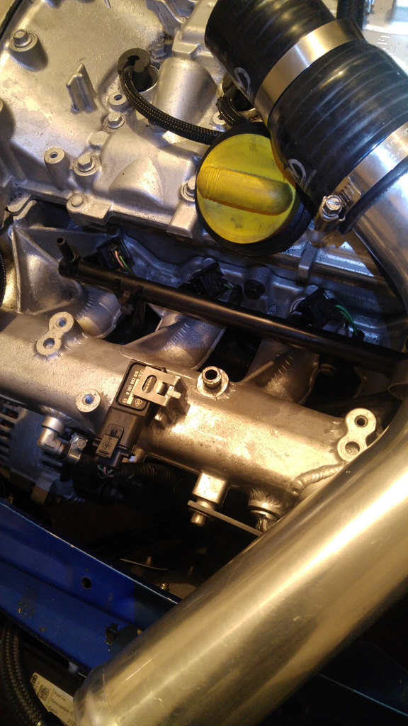

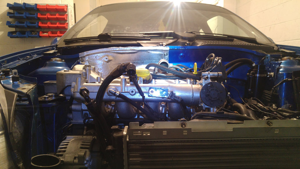

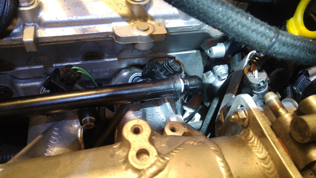

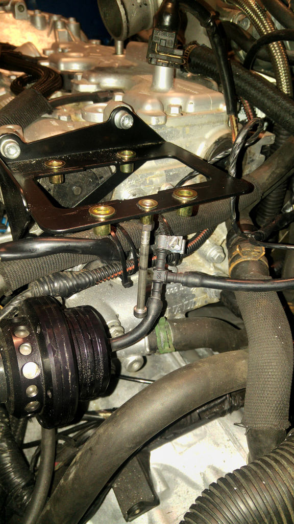

I then fitted the new rail with the 1/4 npt fitting which acts as the return for the fuel
20171124_180038 by dann2707, on Flickr
As the return now protrudes where the dipstick goes I had to drill a new hole in the dipstick holder and bend the bracket a bit, coupled with a little spacer it looks OEM ish
20171126_153312 by dann2707, on Flickr

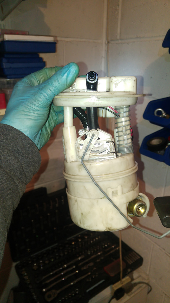

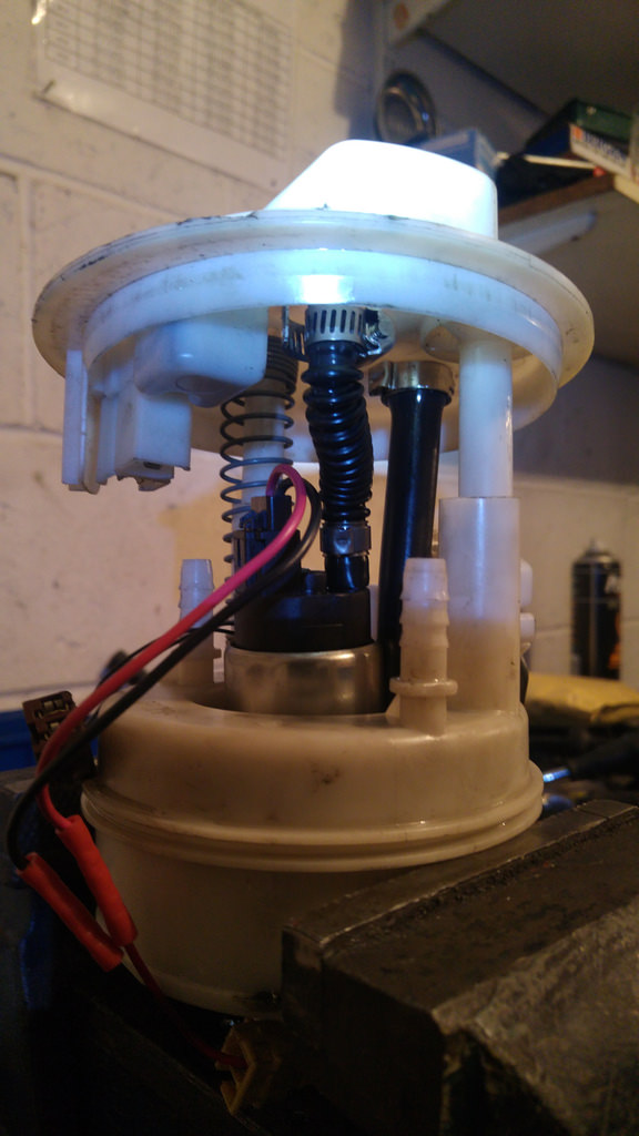

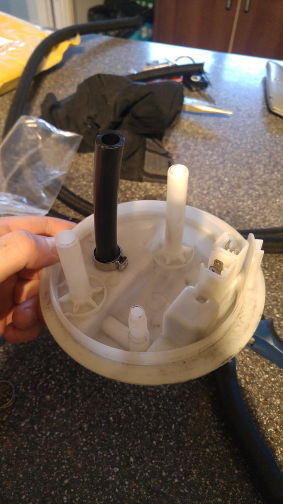

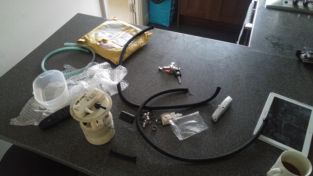

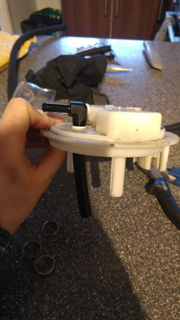

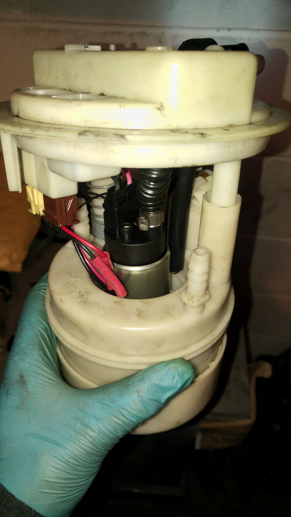

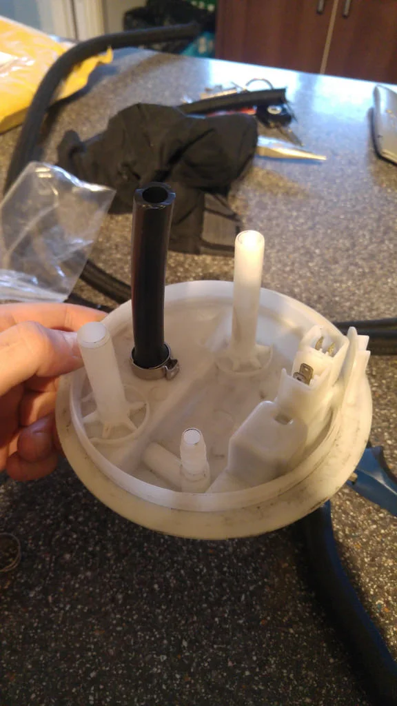

I then needed to create the return line into the sender unit. So at my trusty workstation ie kitchen breakfast bar I started assembling...
20171125_145934 by dann2707, on Flickr
This is a bit of fuel pipe attached to the return line, this will direct fuel back into the swirl pot.
20171125_152858 by dann2707, on Flickr
20171125_152905 by dann2707, on Flickr
The next two photos show it better as to where it is now pointing, its going down the side of the fuel pump itself directly down into the collection of fuel. This means that when it returns its not being returned to anywhere in the tank, but into the swirl pot so fuel is always there.
20171125_162708 by dann2707, on Flickr
May be able to see it better there, the black little tube pointing down.
20171125_163240 by dann2707, on Flickr
20171125_171337 by dann2707, on Flickr

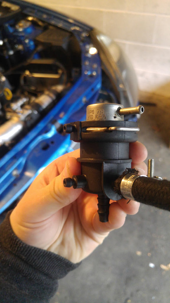

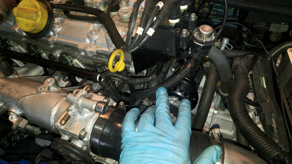

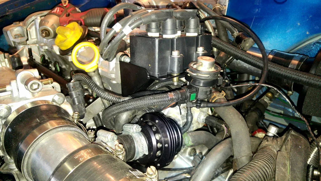

Today's job was to fit the fuel pressure regulator. This is the jobby which I got from a saxo 8v. Runs at 3.5 bar so is absolutely perfect. My only gripe is that there is no decent mounting position for it but it's okay for now.
20171126_125125 by dann2707, on Flickr
Decided to mount it here, it's just held there in this pic
20171126_125151 by dann2707, on Flickr

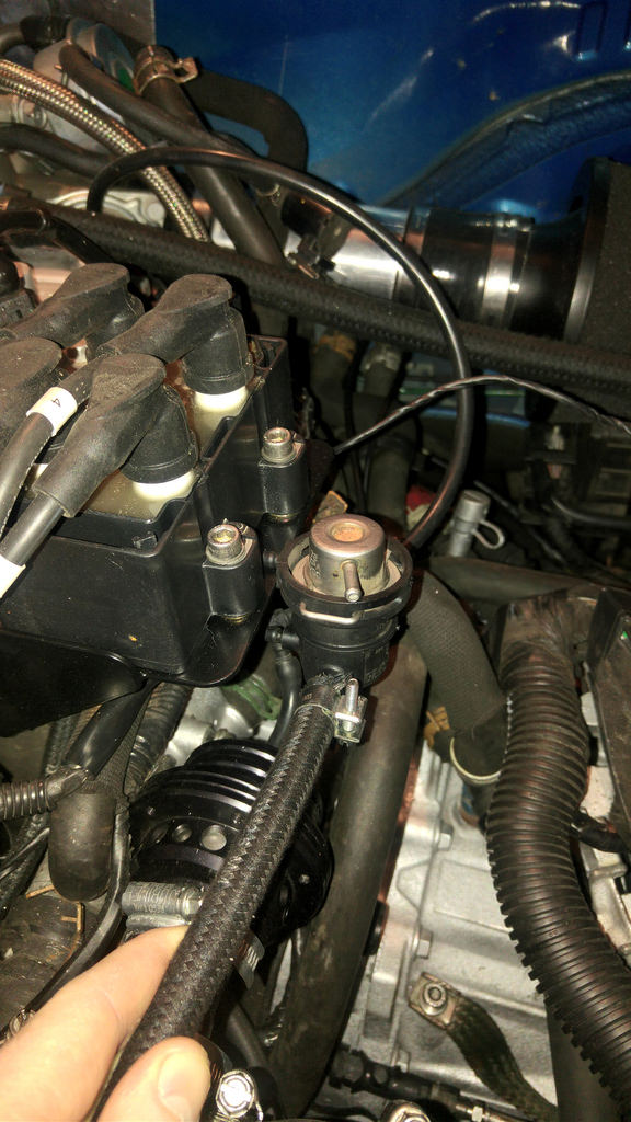

Rivnut again to the rescue which I rivnutted to the coil pack bracket which would hold the FPR crudely.
20171126_131600 by dann2707, on Flickr
FPR cable tied to that bolt then pipe work fitted. Luckily I've kept a load of fuel connectors from before so i've used them where I can, as you can see on the FPR inlet there.
20171126_134605 by dann2707, on Flickr
20171126_134611 by dann2707, on Flickr
Stupidly I didn't buy enough hose, I honestly thought 5 metres would do both the feed and return but I was wrong so Ive had to order some more but in the mean time I wanted to try it all out so the return was directed into the petrol can. Turned the car onto ignition and voila. pressure was released after a little bit.
20171126_144227 by dann2707, on Flickr

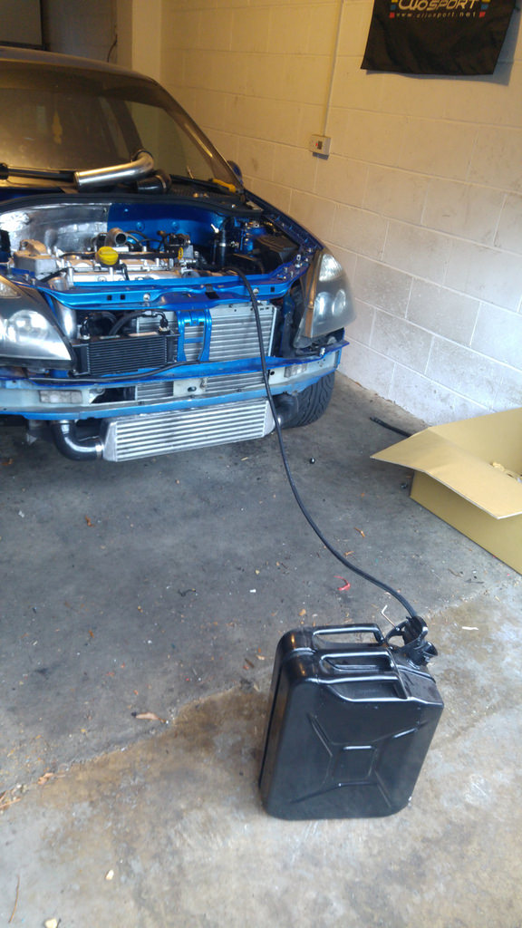

I then wanted to start the car with the new set up, turned it over and boom, fired straight back into life although it sounded horrendous as it had no lambda or exhaust. The former because of the latter.
But overall i'm mega chuffed that it fired up despite the dicking around etc.
