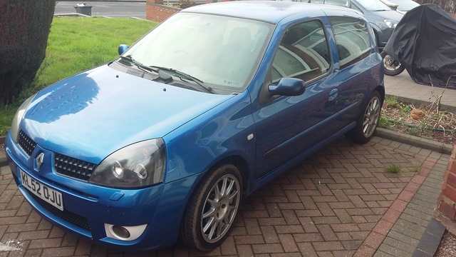

So after a fun drive home I finally got it on the drive, after a quick gander it needs a new rear engine mount, drivers side strut and drivers side driveshaft then from then ill be tidying up and 'improving' it. I also own a classic mini which im doing a full nut and bolt resto on. Anyway enough jobber jabber, the car in question

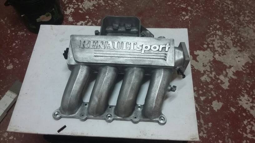

Had an hour today before work, its got a bit of a lumpy idle so removed the map semsor and ordered a new one and also removed the inlet ready for a lick of paint and to change the plugs as they dont look to fresh

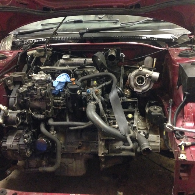

The 306 wasnt definatly fun was running around 190bhp not bad considering its 92 standard and was all done in my lil workshop

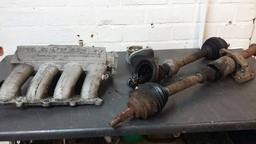

Well not much going on just collecting a few parts that need replacing also received these today
Nice keyring, also bought a spare inlet and throttle body so i can paint them up with a set if front calipers to

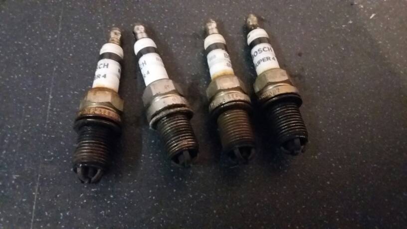

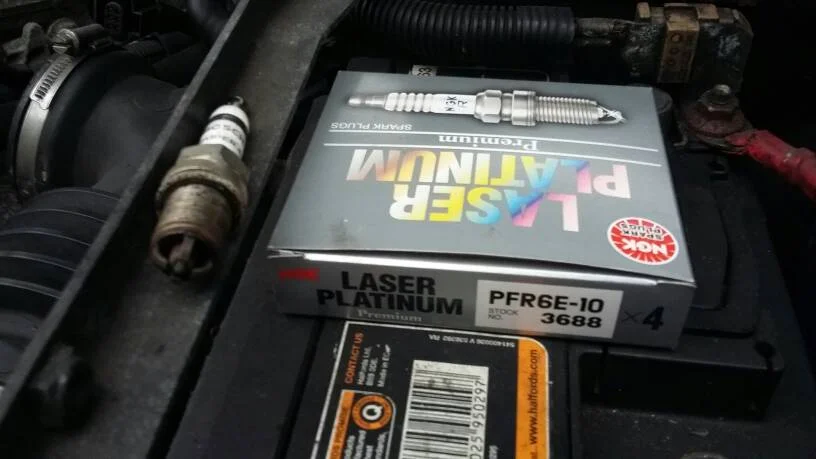

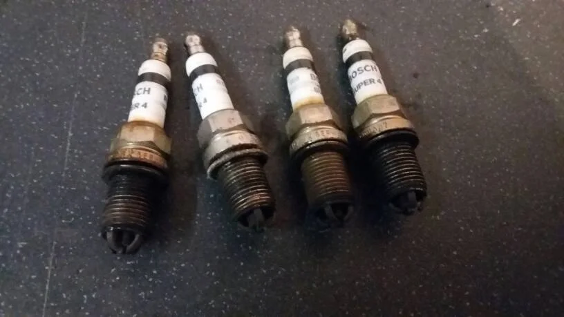

Had a couple hours today so changed the spark plugs amd fitted a new map sensor to hopefully sort the lumpy idle
Old
New

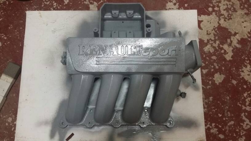

Then it started pissing down so went in the garage and cleaned up my spare inlet and chucked some etch primer on it
Gonna hopefully get time to give it another coat then a splash of colour, also set up my little electrolysis bath to clean the spare calipers up for some paint to :)

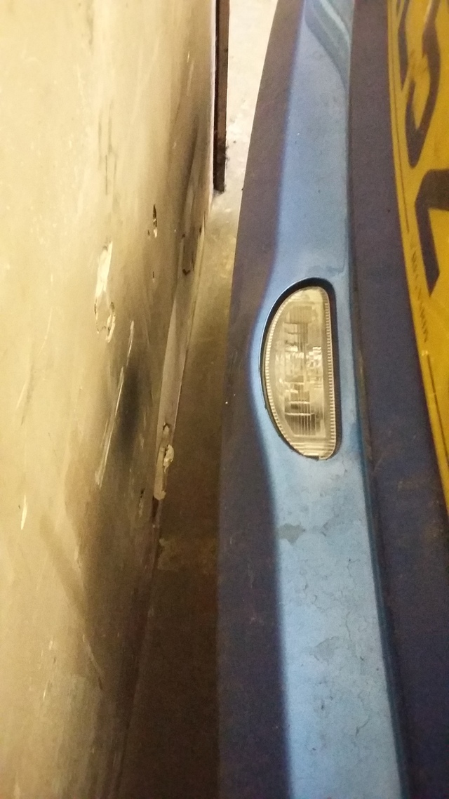

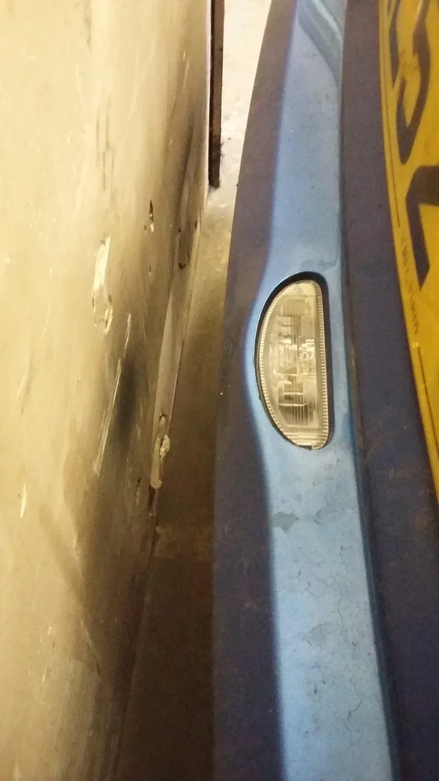

Well not much happening just tidying up little bits, changed the rear bumper light for a brand new item

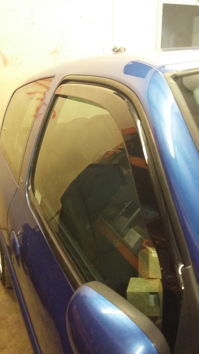

also added some wind deflectors

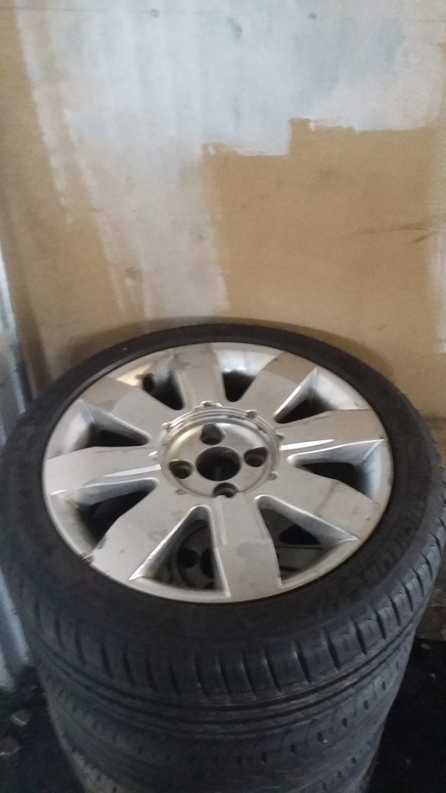

in other news I also bought some spare wheels for the occasional track outing
