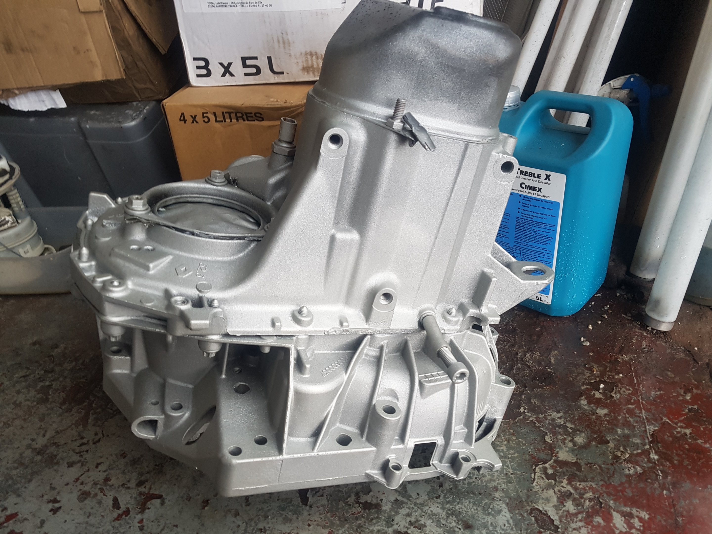

A pressure wash and spray it with enamel seems par for most reconditioner's these days tbfh....

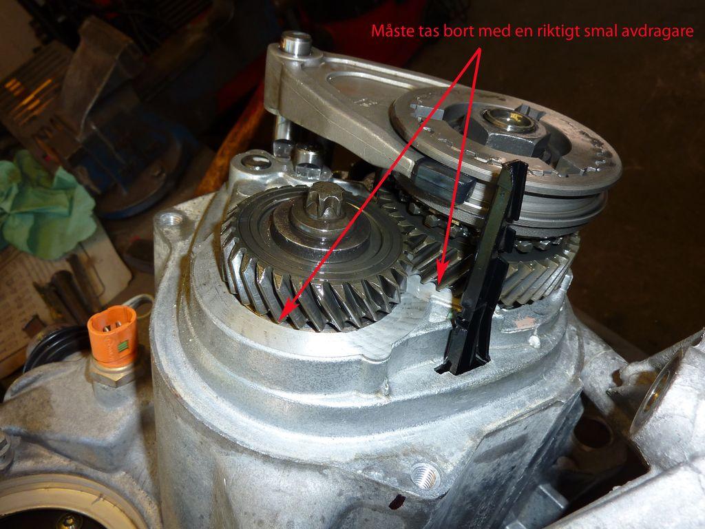

What are the odds that the black piece of plastic in that picture is missing (feeds oil to the 5th gear )
seen a few that have lost the tube in the end cap or been rebuilt and the plastic drip tray is broken or missing. either way 5th generally the first thing to take a hit, plastic wears on the fork and gets worse from there.
In Bloke's pic?
Doubt it, it's my old box which ran fine in the 4 years I used it.
that's not your old one, but i sent the pic to niall to show what they look like with the aluma paint on. that's a dci box i got given to try in a boosted one.
