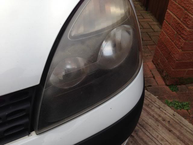

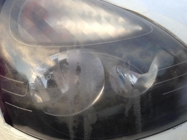

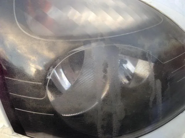

thought i would give the headlights a going over as they were a advisory on last years mot so thought i would try and rescue them before spending on a replacement set

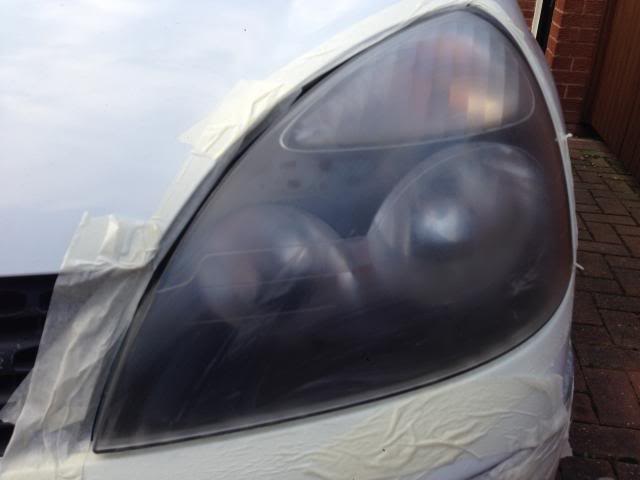

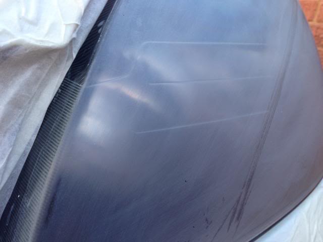

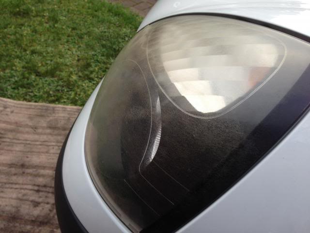

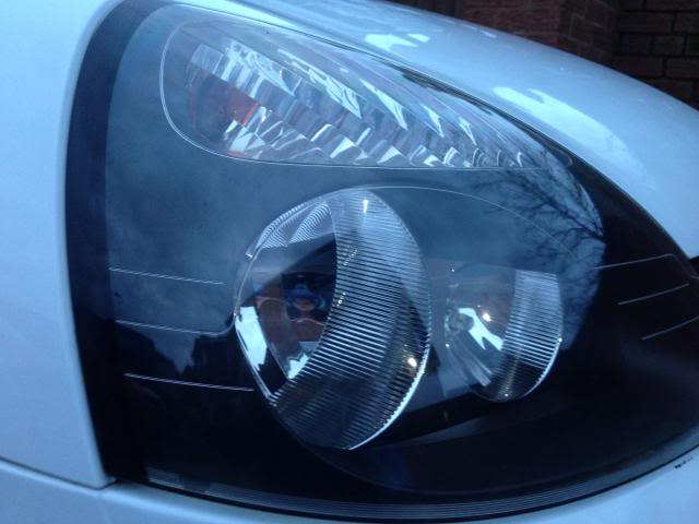

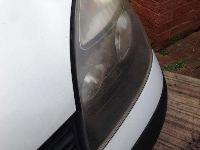

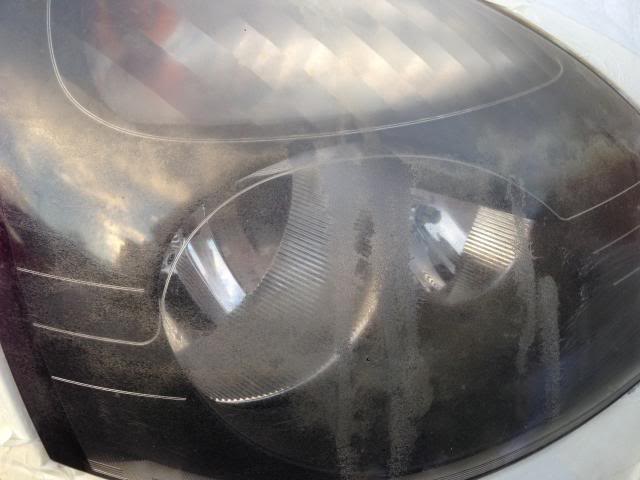

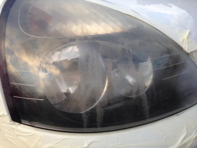

before
passenger headlight
drivers headlight

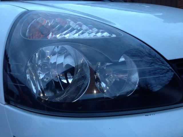

wet flatted with 1200
went on to flat using 2000 then 3000 (sorry no pics got carried away)

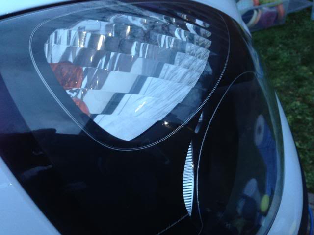

then buffed with
white pad and fast cut 3m
yellow pad and fine 3m
green pad and ultrafine 3m
black finishing pad and meguiars scratch x plastic polish
finished headlight (sorry only drivers)
could probably go a bit more but i am more than happy with the results compared to the way they were.

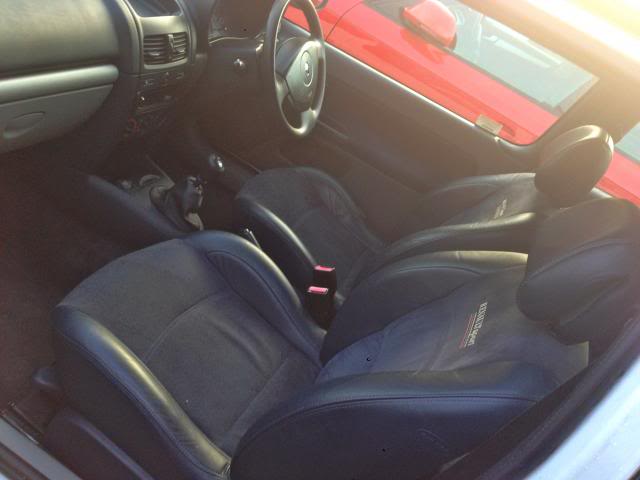

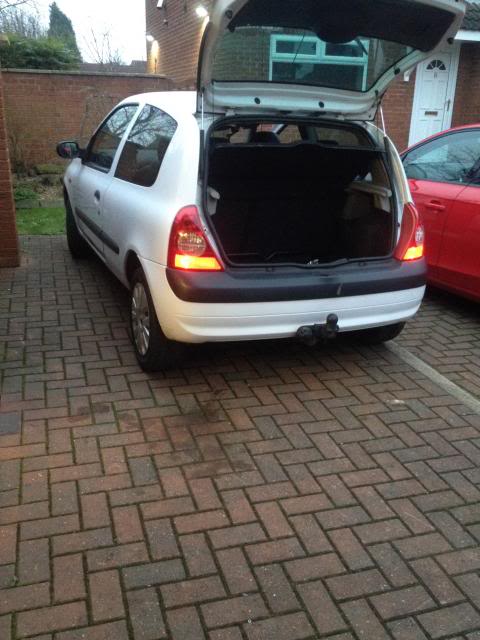

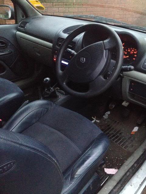

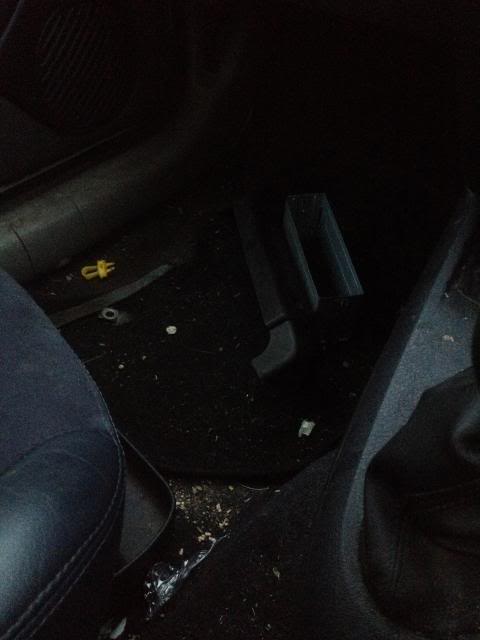

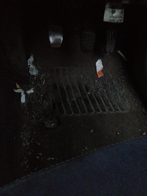

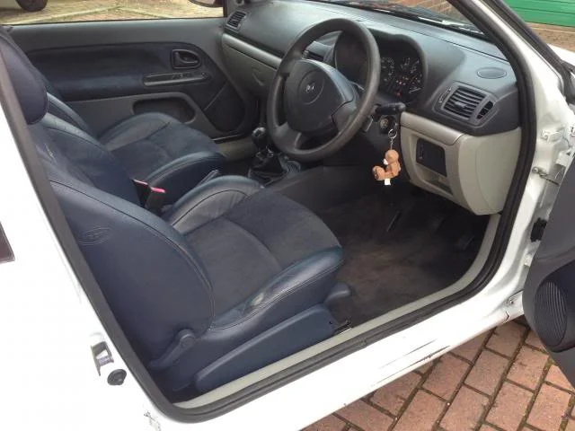

a couple of pics of interior before i ripped it all out (sorry for poor quality they are off my daughters iphone

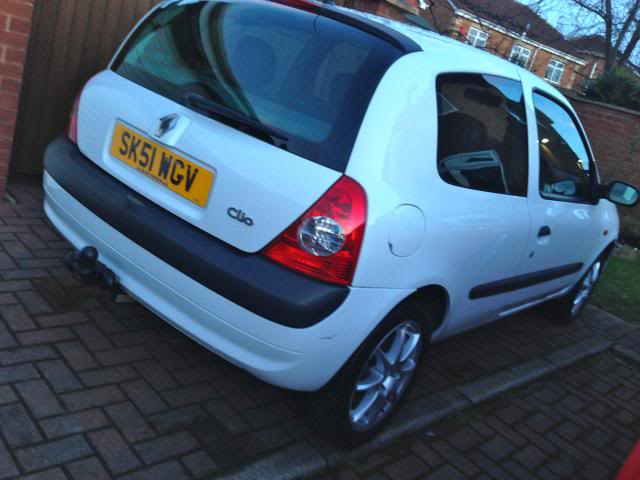

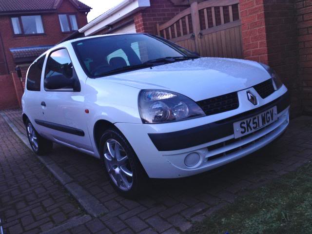

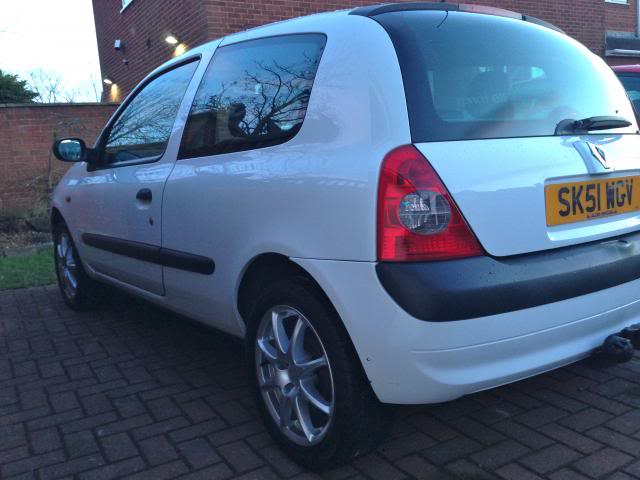

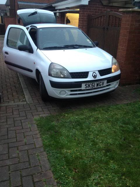

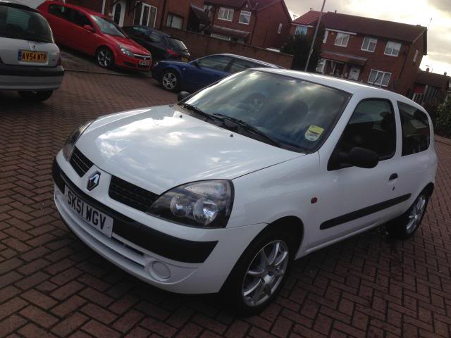

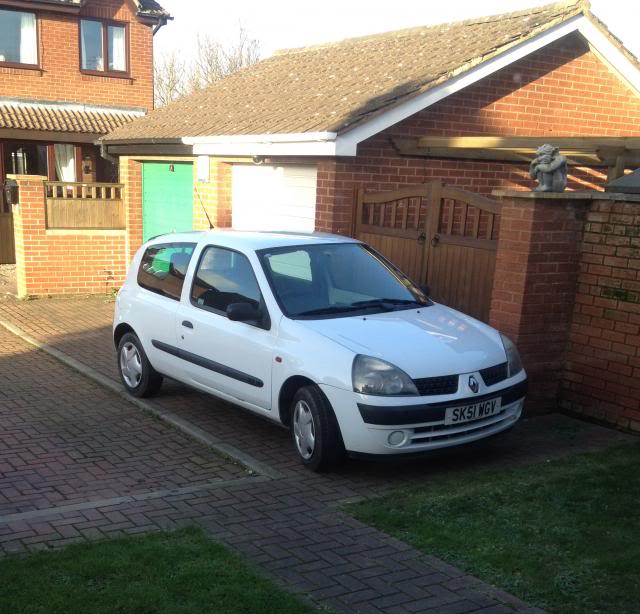

car shot looks better than it is ,nice and straight but paint is disgusting

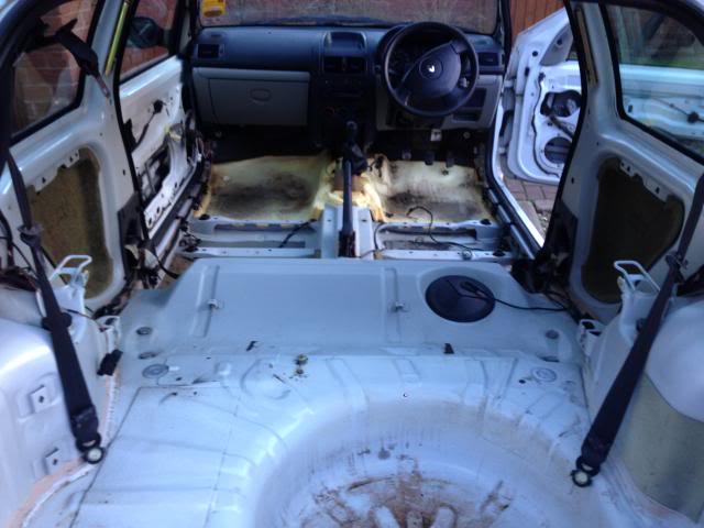

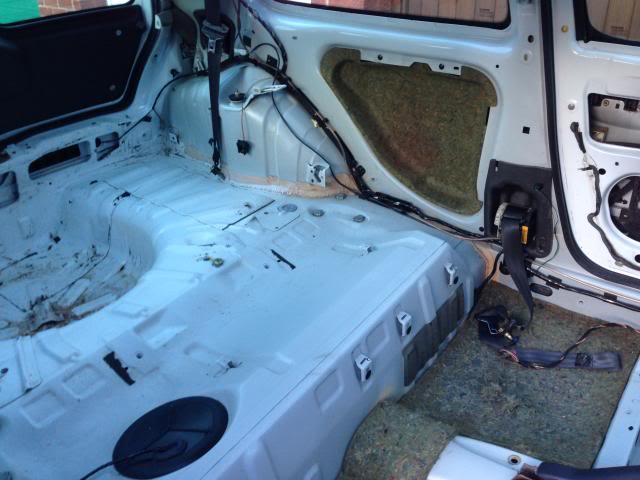

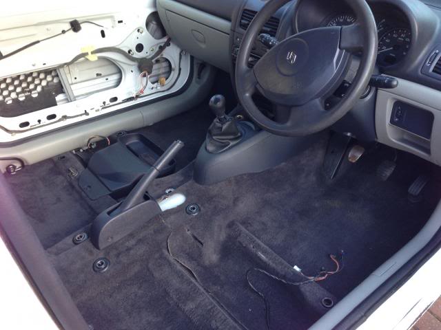

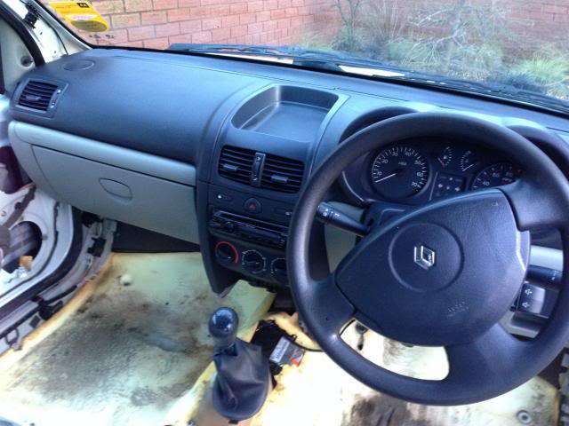

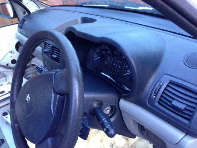

interior gutted and scrubbed using meguiars apc
dash cleaned using megs apc the dressed using poorboys natural look dressing
also purchased a 172 carpet and head lining so will get those scrubbed up and fitted this week

Are you planning on getting all Phase 1 172 bits inside ? I only ask as they are bluey, on a phase 2 they are grey.

the two tone dash doesnt look that bad with the interior to be honest as the door cards are light grey with alcantara inserts so look ok really ,as for the phase 1 bits i will be keeping the standard pillar covers as they are light grey and the door cards i have as stated are lightish grey as stated so look ok ,may get a sport steering wheel but otherwise think this as far as i will go with the interior for now ,need some nice standard renault alloys dont want aftermarket for insurance purposes will be around £2000 to insure as it is :eek:

got the carpets scrubbed up and refitted much improved ( i now need the longer handbrake surround )

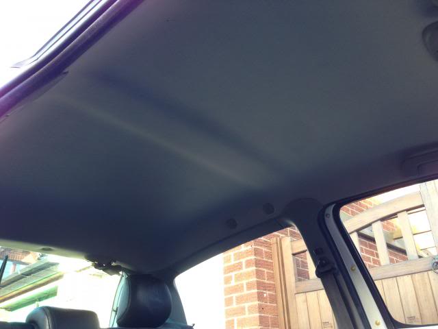

also roof lining scrubbed up and refitted

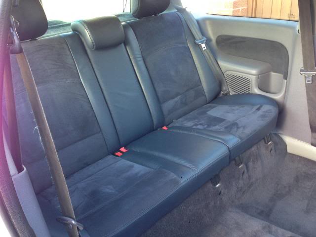

also got all plastics cleaned with apc and dressed with poorboys natural dressing and refitted along with cleaned rear seat and rear cards
its all coming together and looking a lot cleaner .

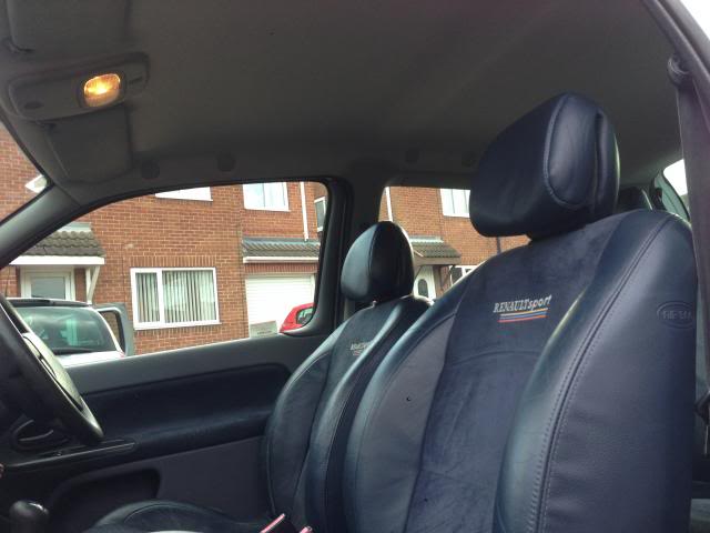

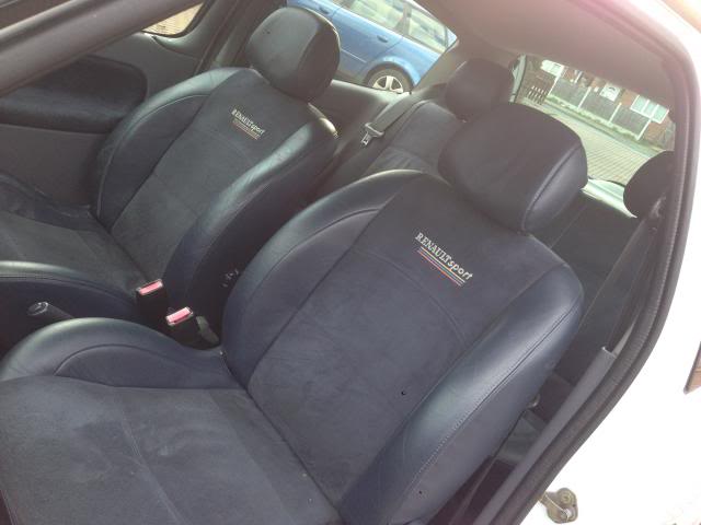

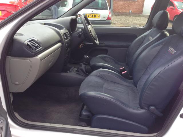

got seats back in , but need to get some better pics of completed interior ,its not immaculate but very very clean and wont stay that way once she gets her hands on it

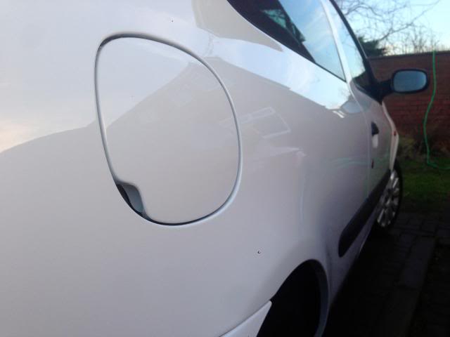

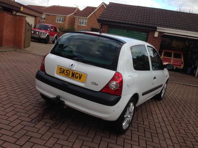

anyway gave the paintwork a good couple of days machining and the results are very satisfying ,but still need to apply some proper polish and wax only done with 3m products to get paint to a decent standard

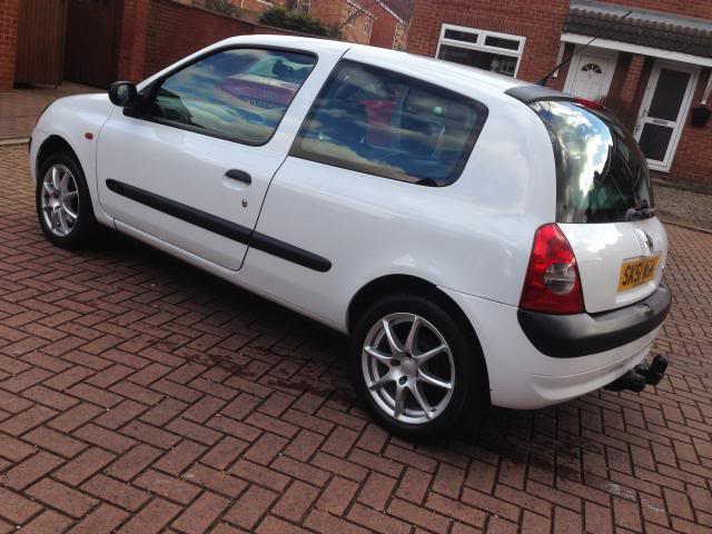

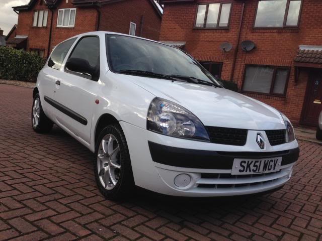

also got her a set of alloy wheels (bargain at £60 with nearly new yokohama tyres) not to my taste but not my car and she likes them
got a couple of bits of paintwork to touch up yet so will leave the polish and wax till paint is done (drivers door step and a couple of scuffs on bumpers)

a couple of interior pics you can clearly see the door step that requires paint here
