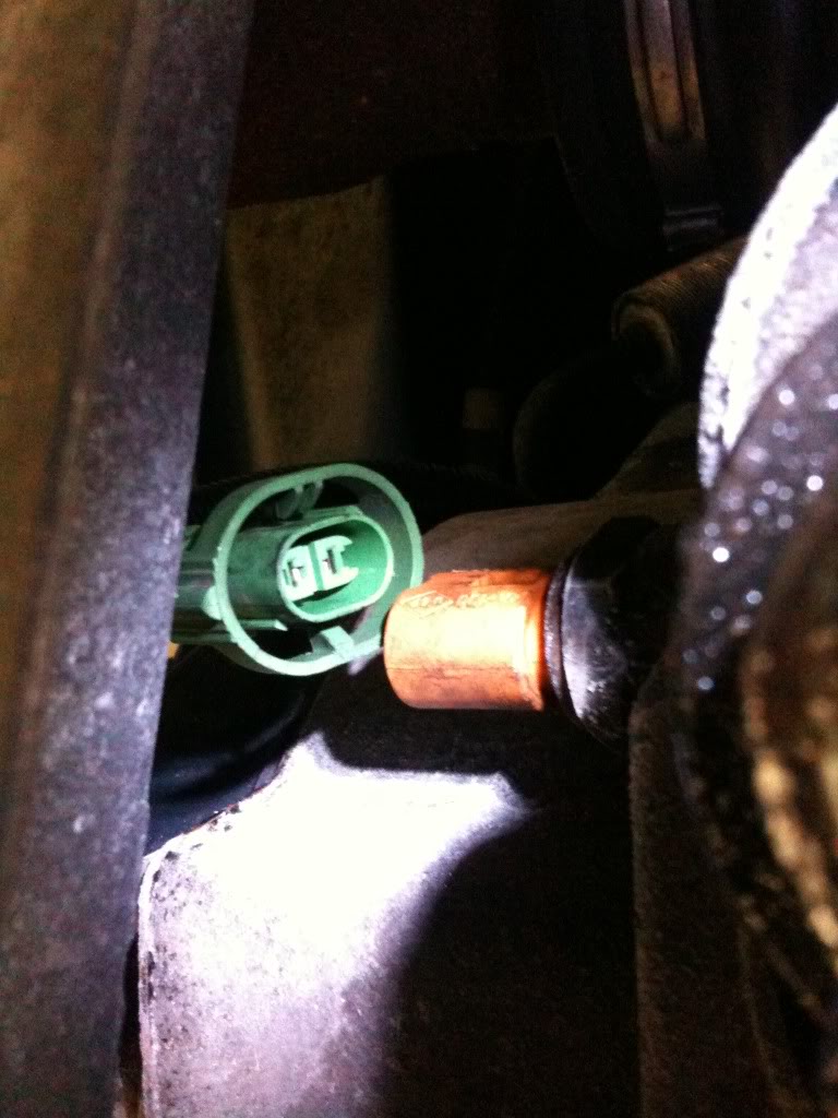

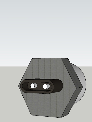

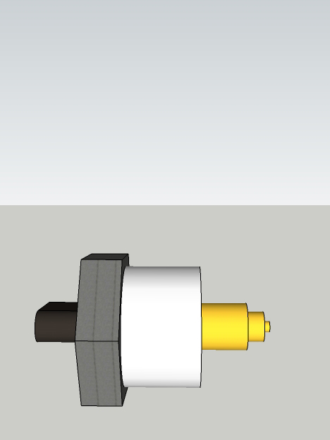

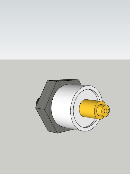

Reverse sensor is on the bottom of the gearbox, if its in the same place as it is on the 1.2, looks something like....

the reverse switch is just a pin connector type connection on the engine side of the gearbox, i think it was green, i've got a pic somewhere so will try and hunt it out for you if that helps

heres a pic of the reverse switch btw
