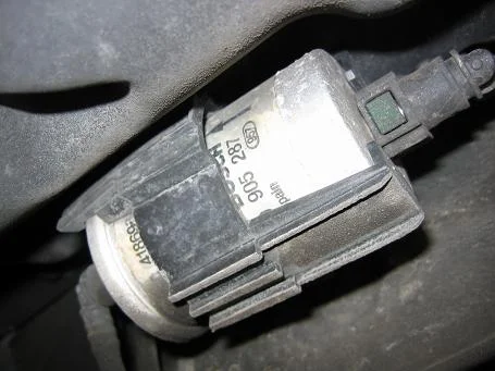

So you just unclamp the filterlines with a cloth over it to reduce chance of jetting fuel in your eyes?
I found the fuel filter under the car on the right hand side, close to the tank. That's the one isn't it?
@ picture
