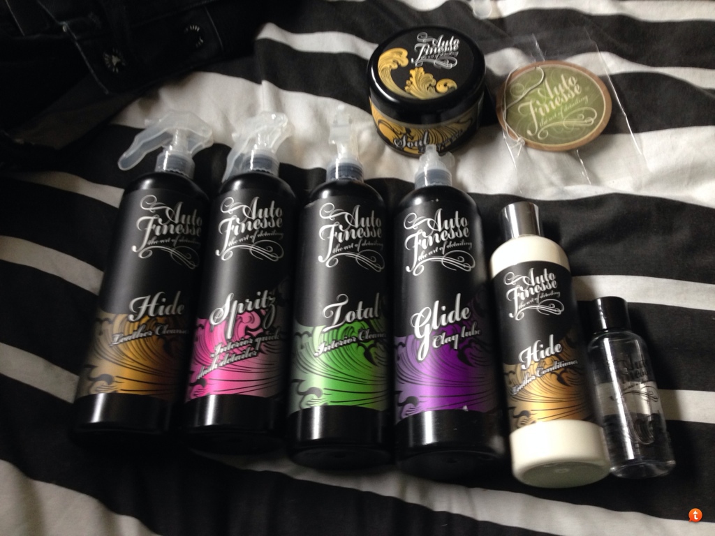

My order just turned up can't wait to get my interior cleaned
got a freebie of a clear liquid too but no idea what it is has a slight fruity smell to it

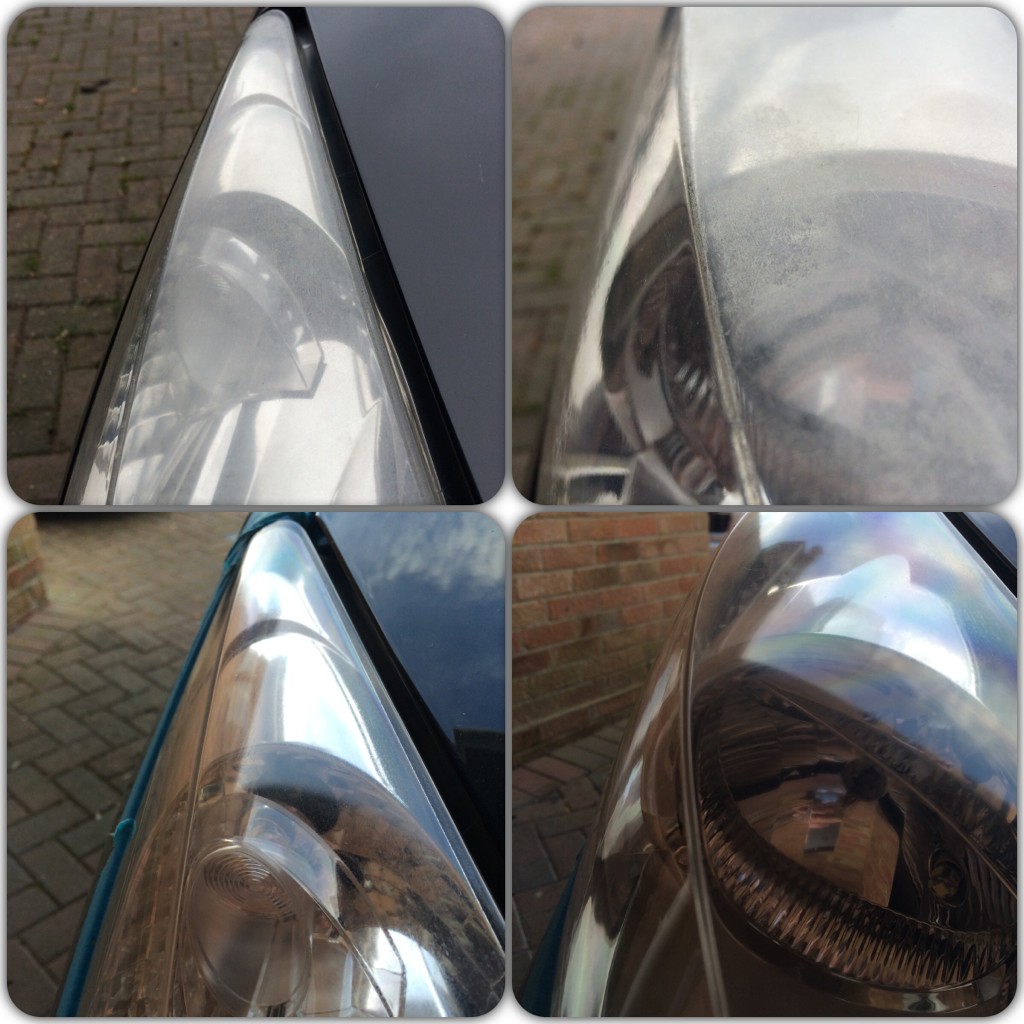

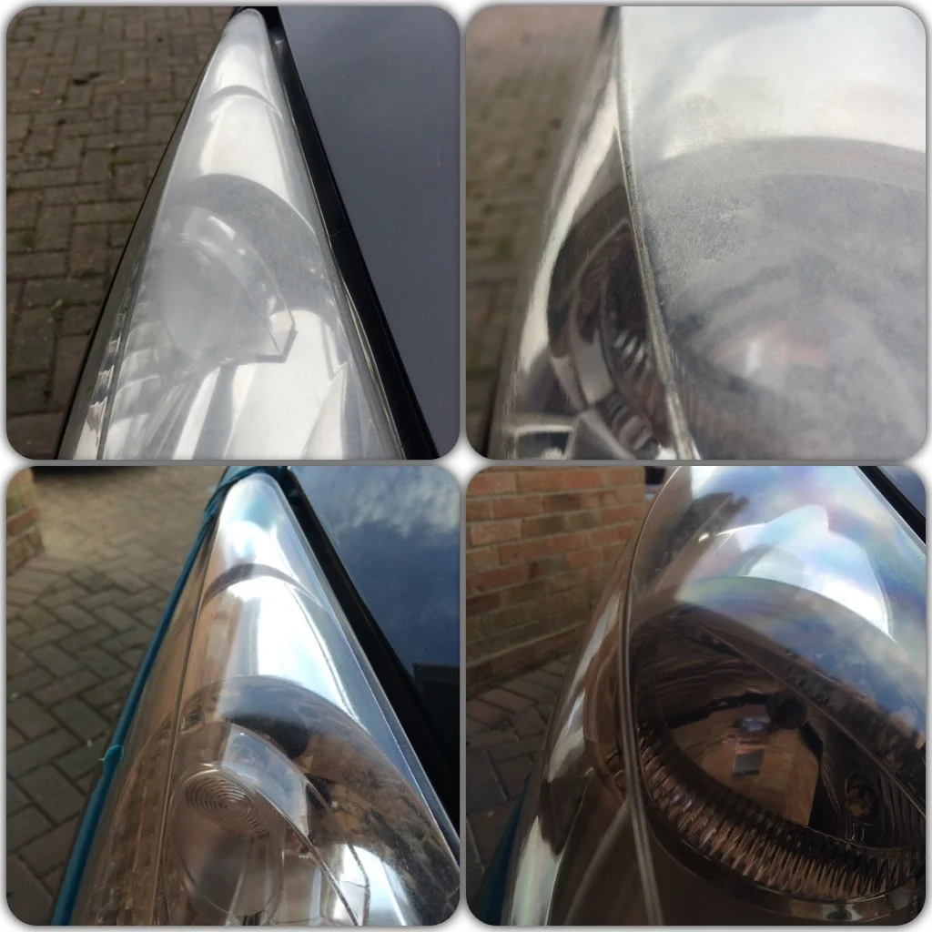

Quick effort on one of my headlights... First time giving it a go and it needs more work which I'll hopefully do before work tomorrow but still an improvement :)
