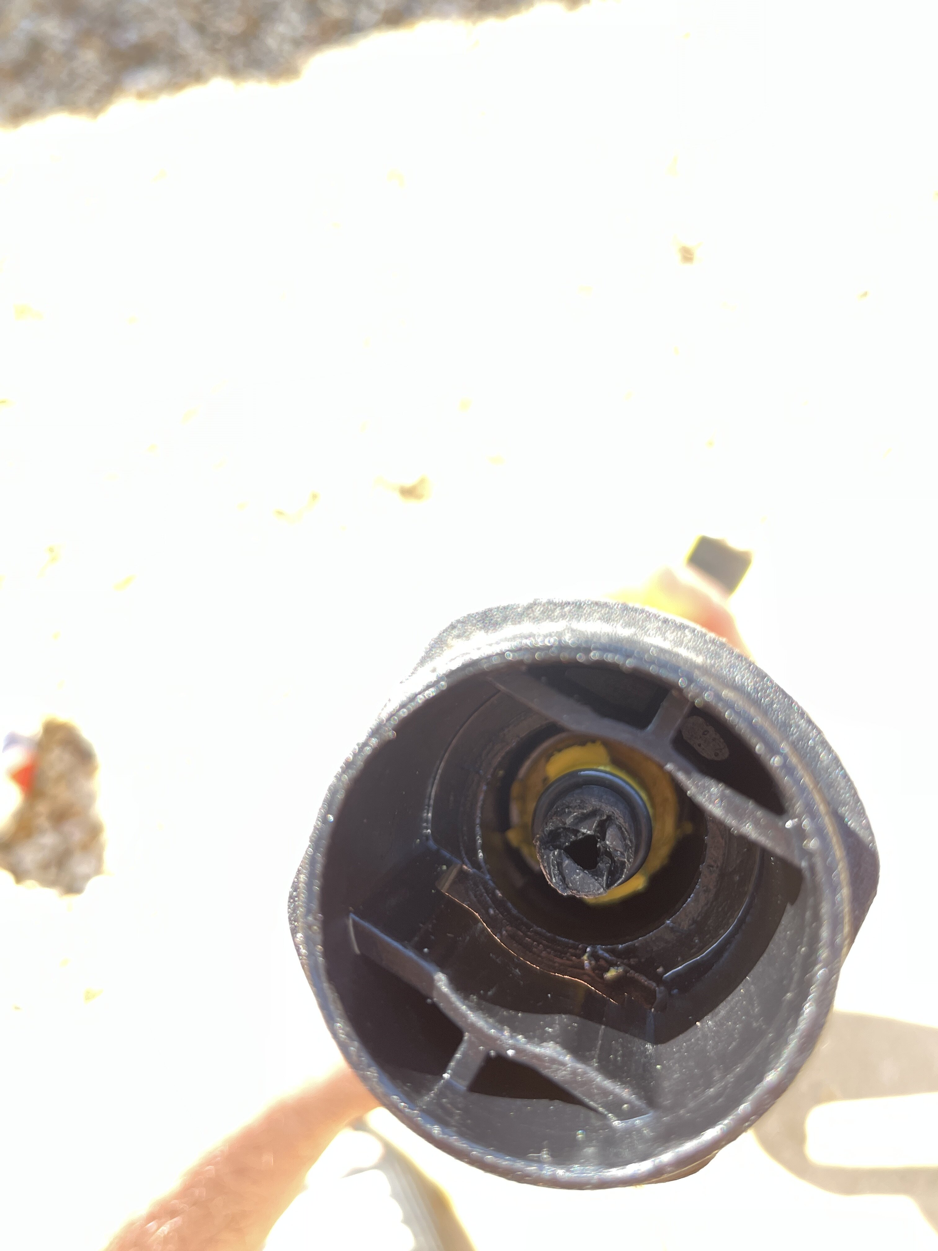

I’ve got a Karcher K4, and recently my snow foam lance has stopped fitting the handle. It doesn’t push in enough, to allow me to turn it to lock into place. Are there any aftermarket guns/handles that people recommend?

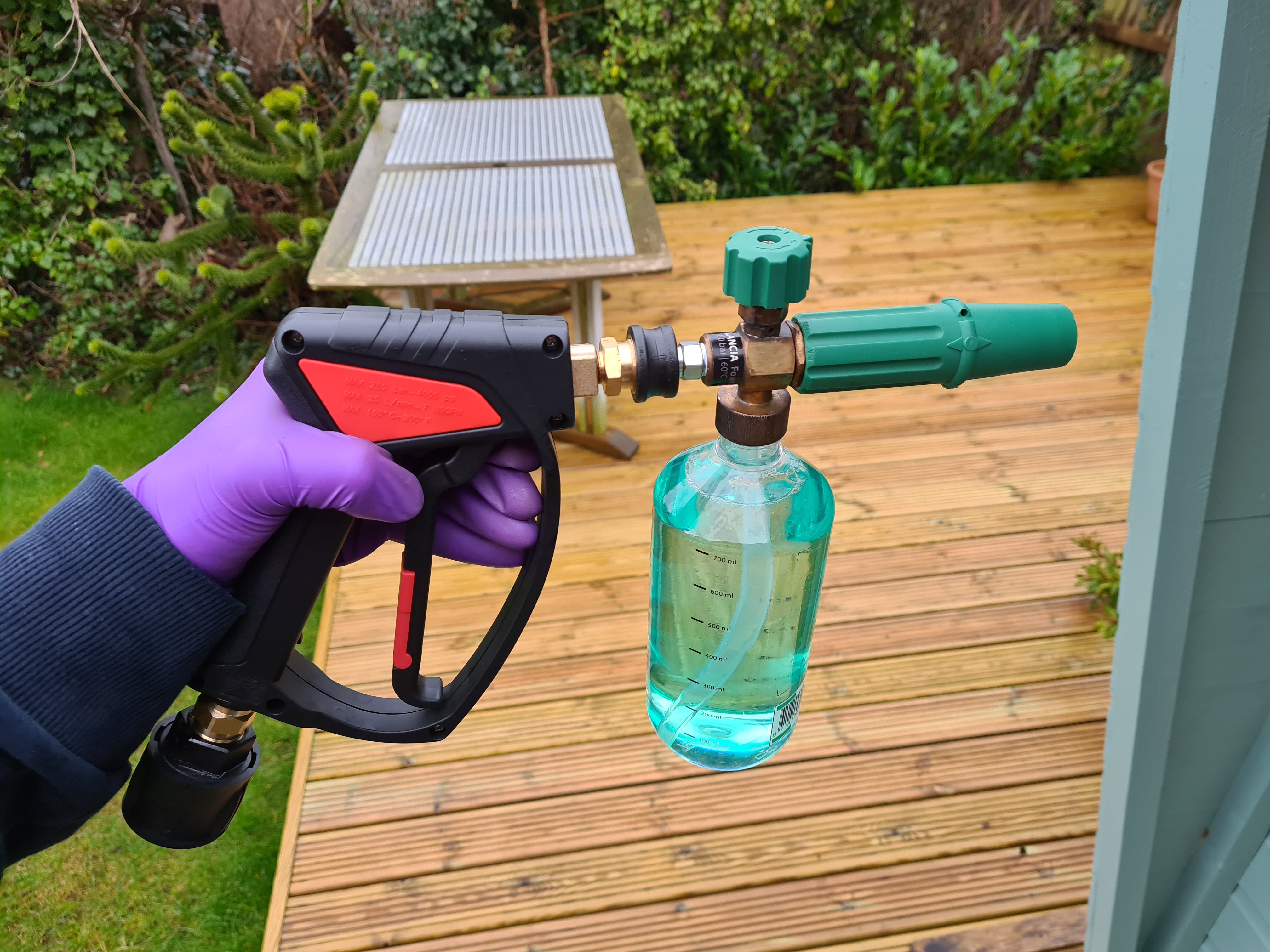

I've ordered this foam gun for a friend of mine recently and I was impressed with the quality.
Do you know if anything is broken? Is it the handle or is it the kardher attachment in the gun itself? The attachment might be easy to replace? Usually just screw a new one in.
Otherwise I'd go for a short trigger with the above foam gun.
My foam gun seems undamaged and as new. But when you push it into the Karcher gun, it doesnt push in deep enough to allow the foam attachment to twist to lock into place. Even the standard Karcher pressure attachments are hard work getting them in.
The short trigger stuff.. can you still attach the long pressure washer attachments to it?

My old karcher attachments got harder to push in the older they got. I think they must have an o ring inside that gets a bit hard over time.
Give the end a spray in some silicone lubricant.

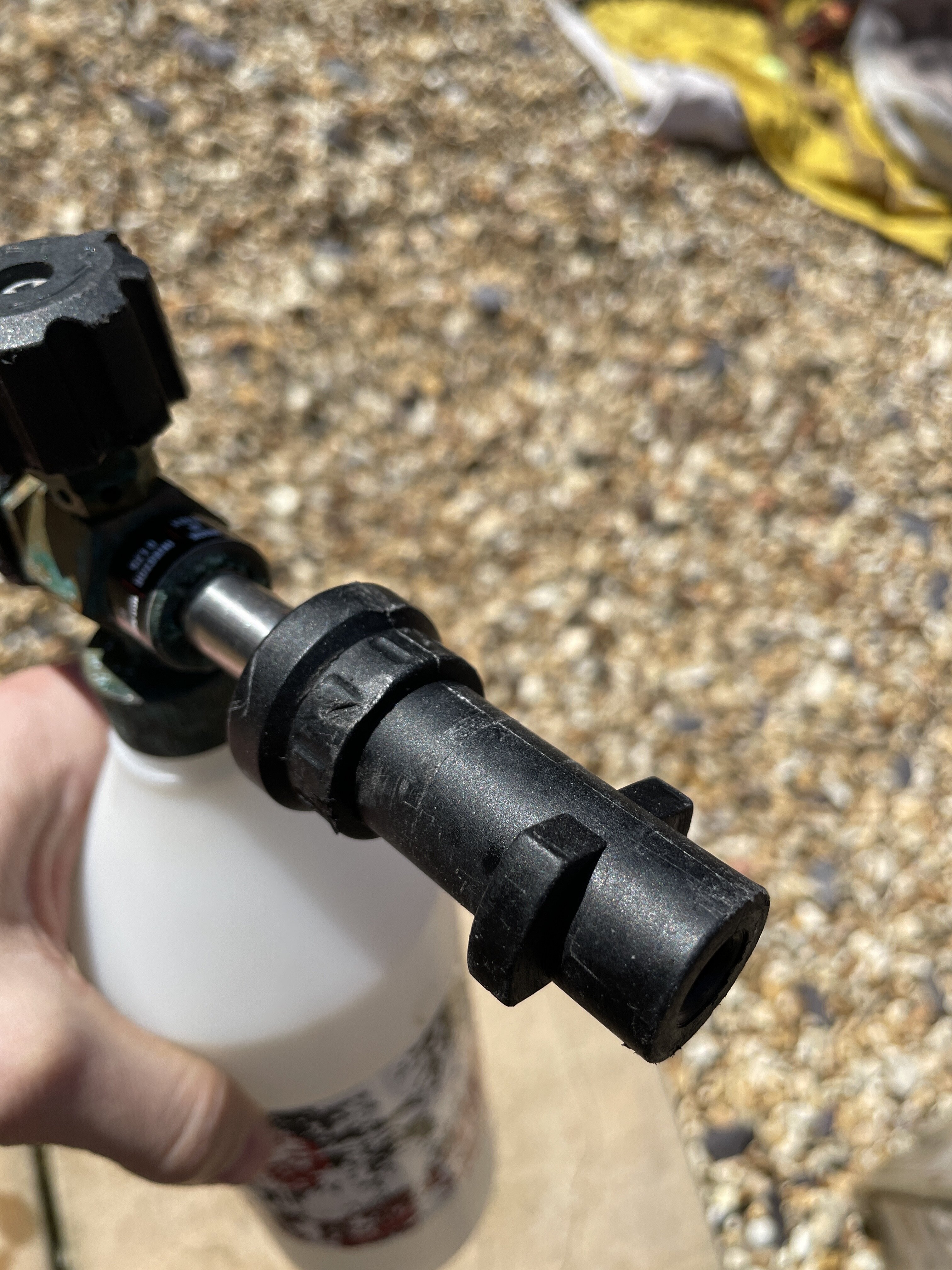

How would I attach my snow foam lance which has the Karcher bayonet fitting to this sort of gun?

No chance of it coming off. Guess i’ll just have to buy a standard cheapo Karcher handle, rather than buying a new handle and snow foam lance.

Tried the grips. It’s about 5 years old and not been cleaned ever, so feels like it’s welded on. Just gonna buy a new Karcher handle and keep that snow foam lance... should work.

They do come off. We replace hoses etc quite a lot and everything comes apart on pressure washers. Especially for seals.

Does this come off?
The gun is mangled and doesn’t compress properly.
Maybe best to look into getting a new Karcher gun? Do you know anyone with a Karcher, maybe an idea to try their gun with your attachments?

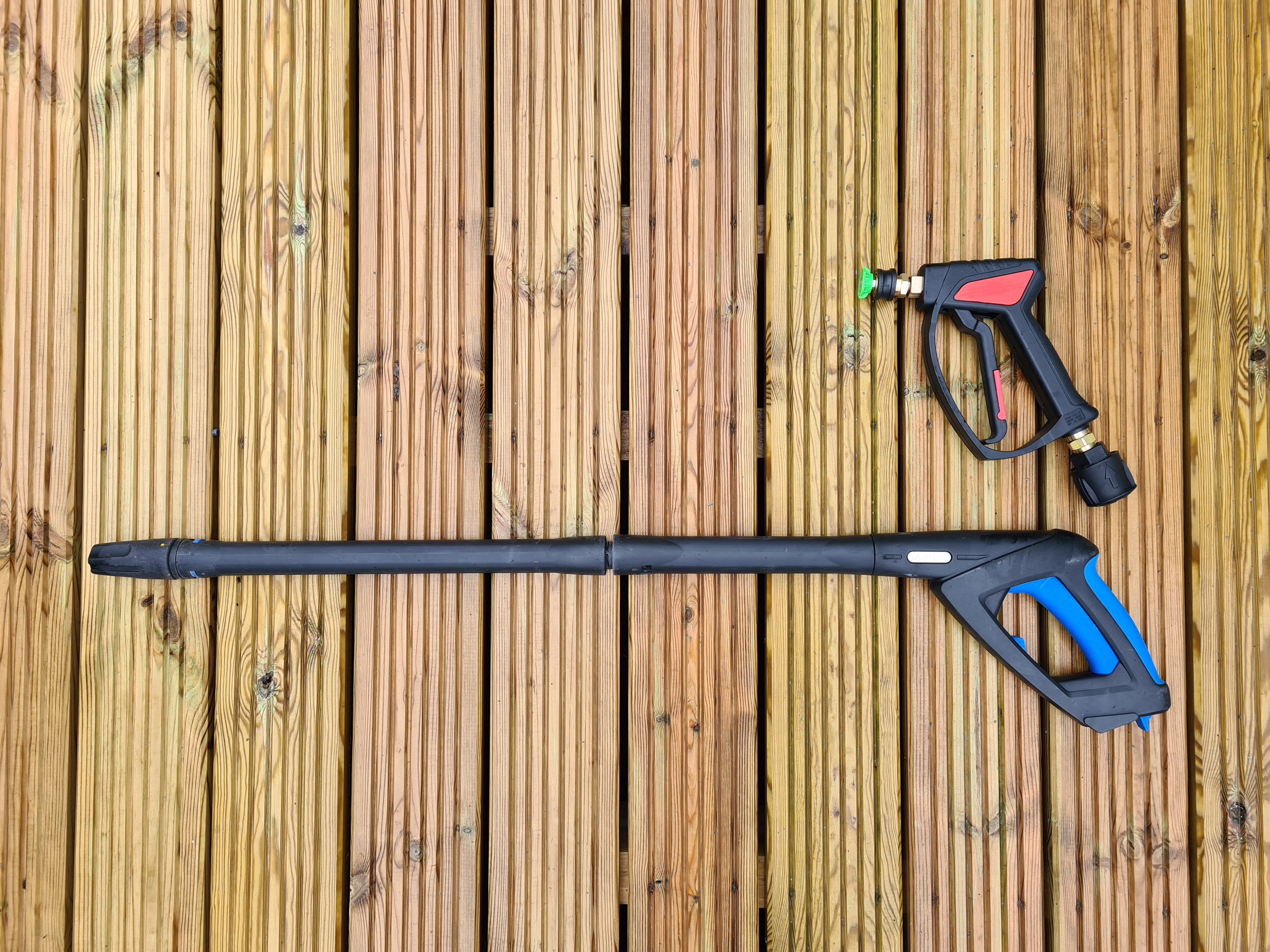

I removed my Nilfisk adapter in a vise, came off fairly easily and I think the short trigger adapter came with ptfe tape already installed.
Made a big difference in length, I find it ideal around the car.

Either way I would get a short handle...
Only problem I find is the karcher original handle is easier to adjust the pressure rather than changing those nozzles
