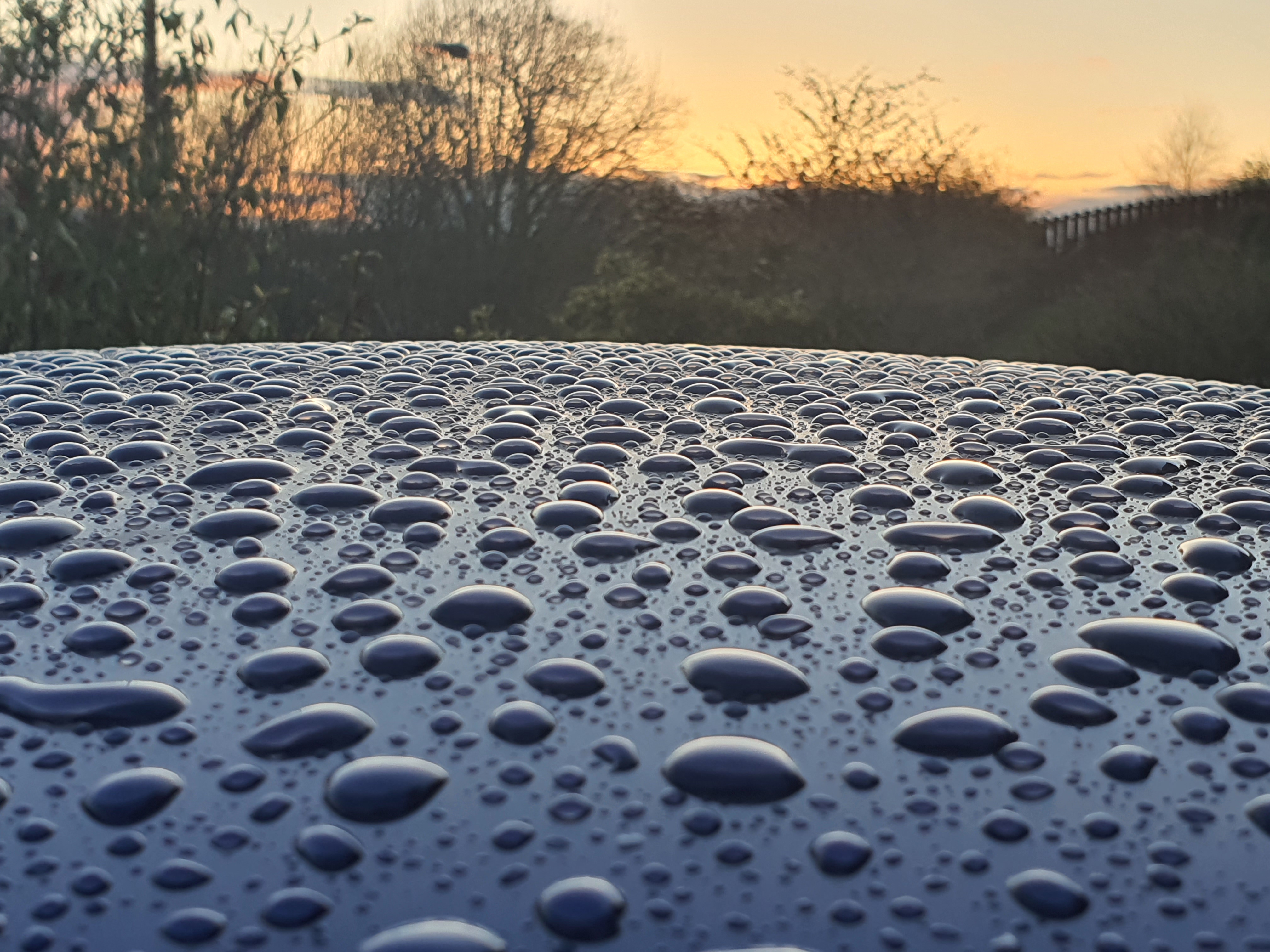

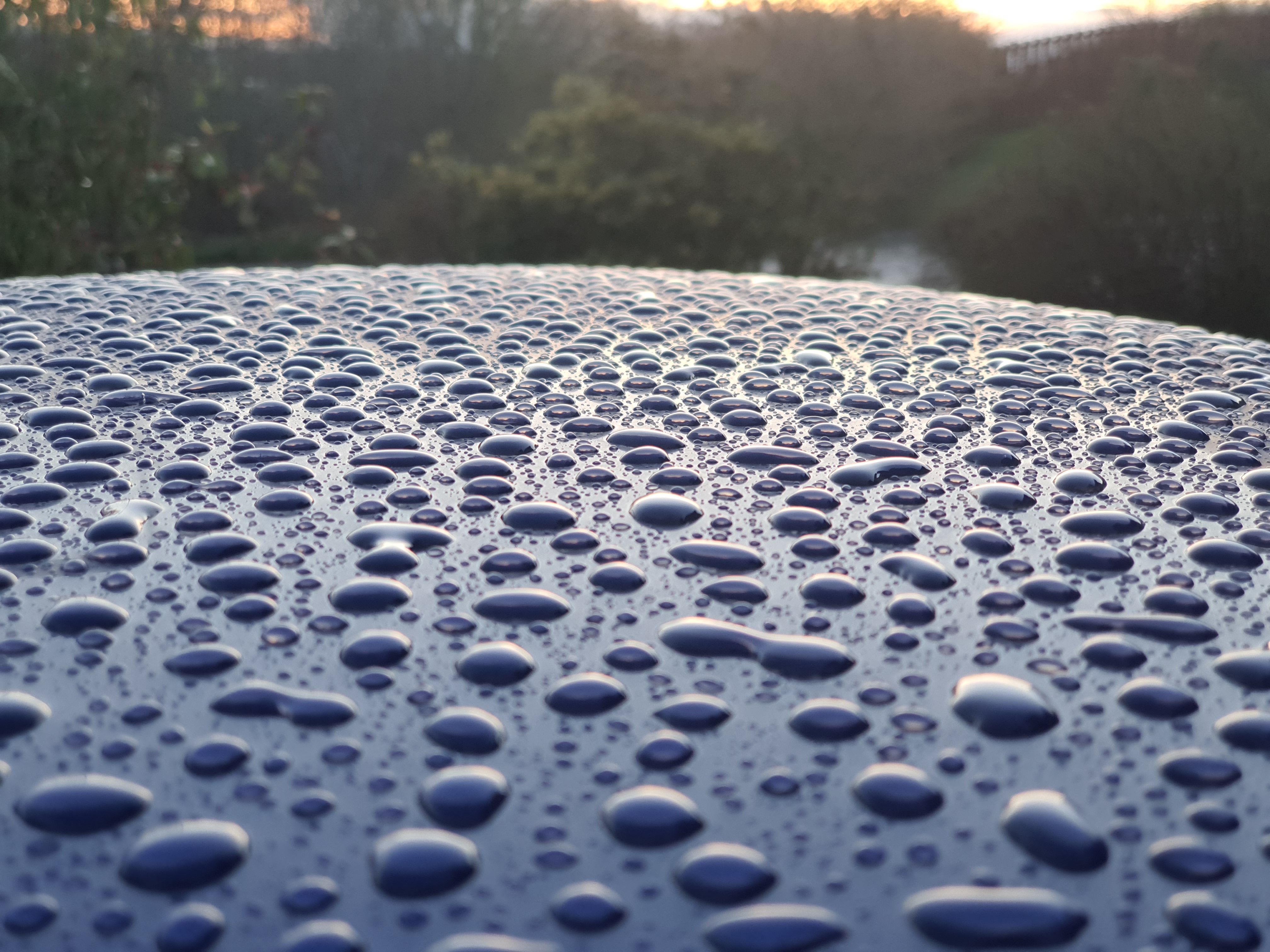

Infinity wax Graphene spray update. First 2 pictures are on a dirty car in the morning.
After washing with pure infinity wax shampoo...
It has some of the best sheeting I've seen from a quick spray product. Beading is standard sealant look, really repels water, snowfoam and shampoo when washing so it's bonded very well. Will keep an eye on it.

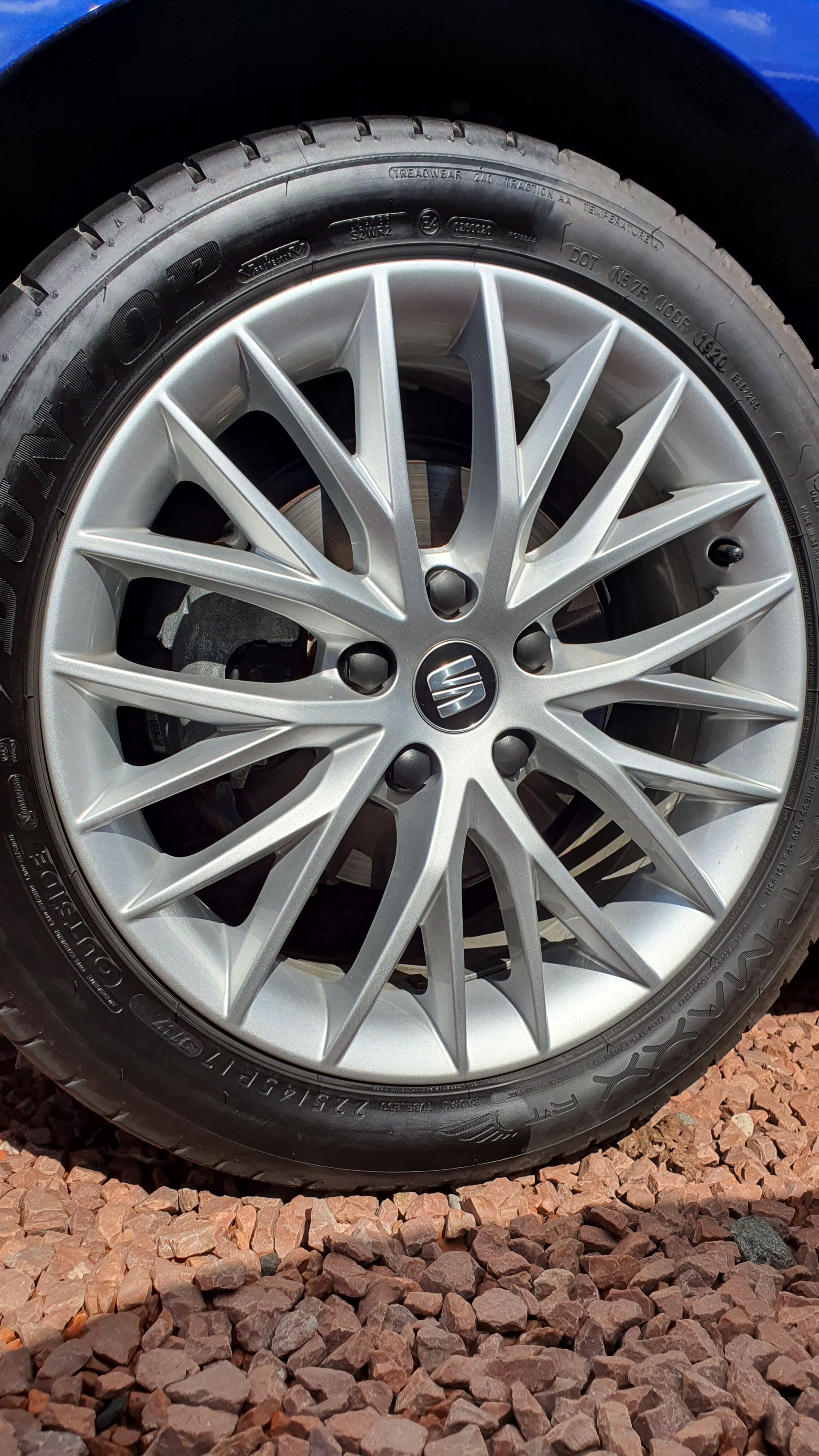

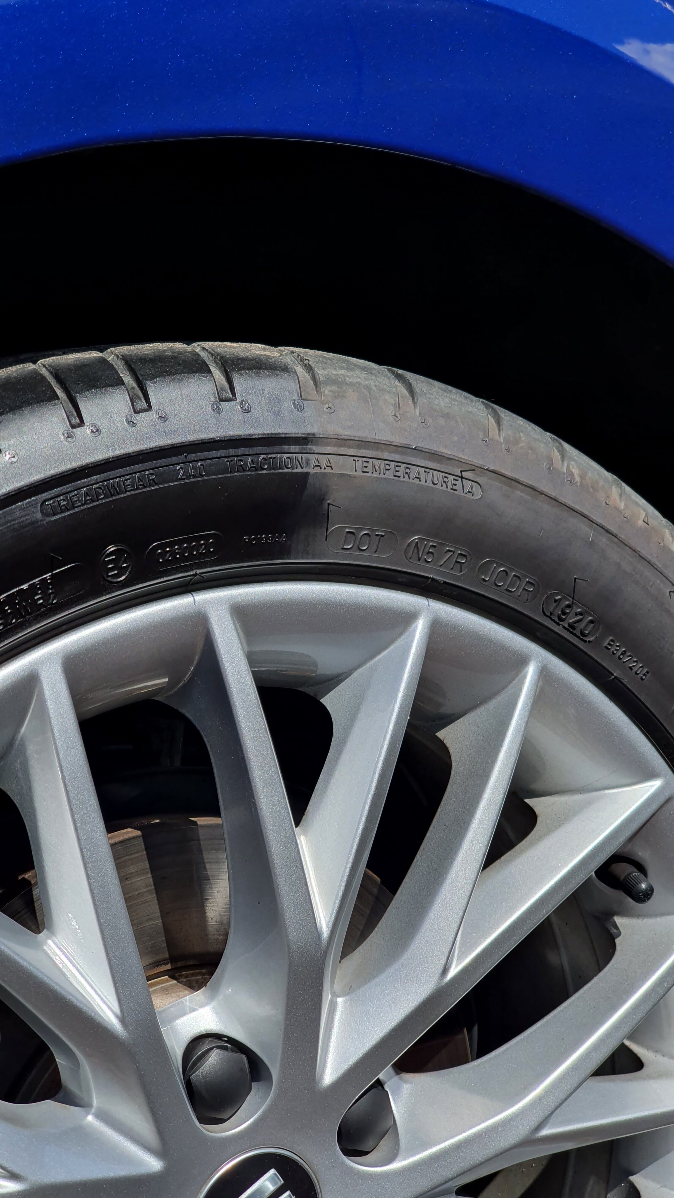

Carbon collective sateen 2.0
I've tried it a few times in the past and always preferred a gel but I've really like this product. Easy to use and perfect colour. Beads and stays black for a decent length of time also.

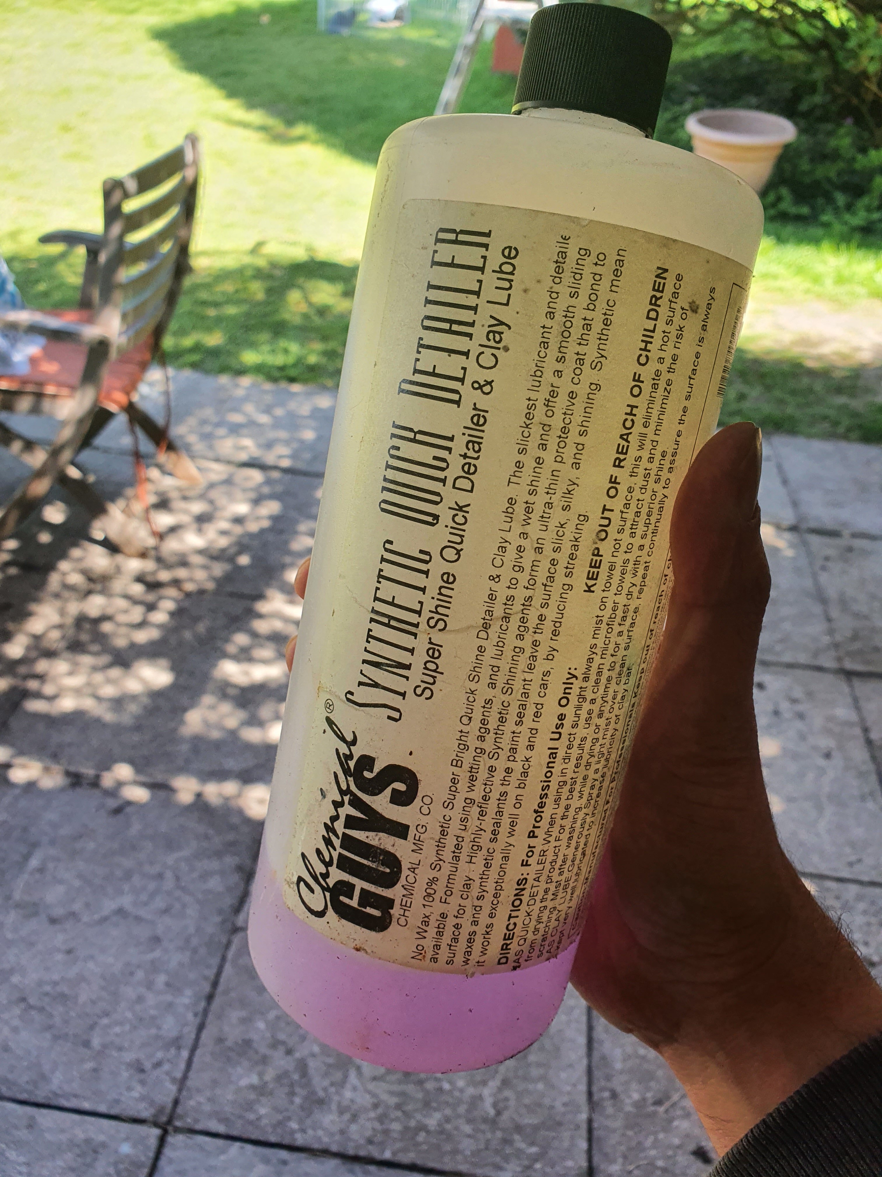

Found this lurking in my shed.....

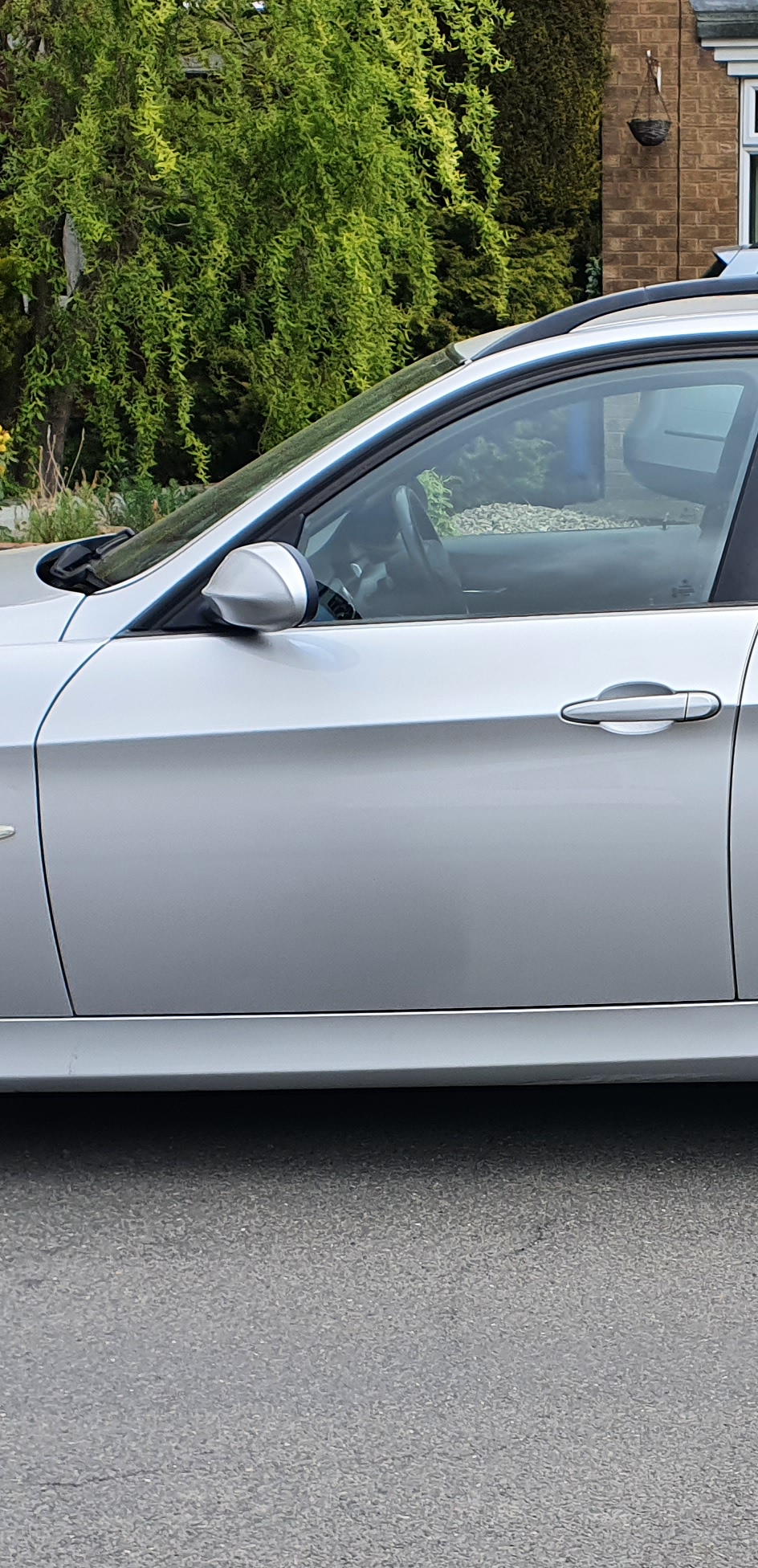

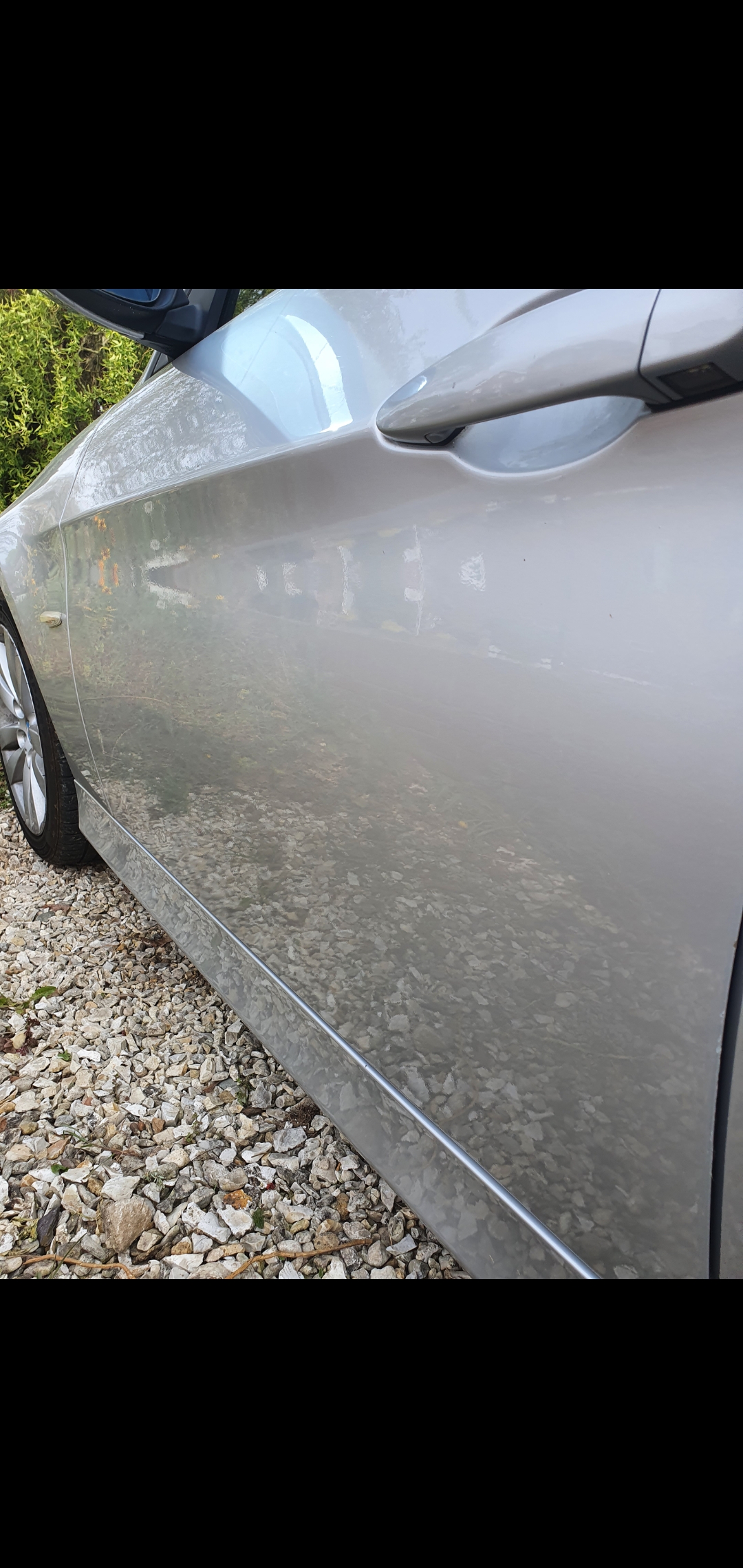

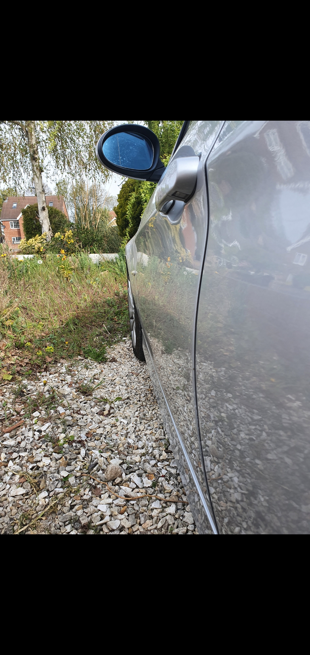

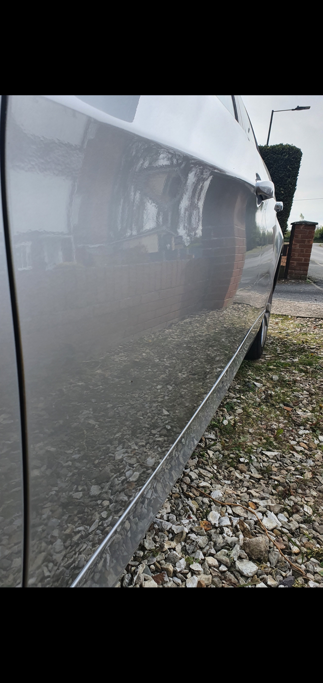

Apologies not a Clio, how do I avoid doing what i've done on the door here and end up with some bits shinier than others? (Front half of front door looks glossier than rear half)
I realised my mistake (trying to correct/polish a silver car) and it was tricky to see the product where i'd been with the product.
Working outdoors in the sun might not have helped and maybe should have gone into a shaded area.
If only using two pads - is there anything wrong with using a damp pad after being cleaned out or will it 'dilute/water down' the compound? My plan is, 3 pea sized blobs, use a couple of times, then into a bucket of water, clean by hand, spin up to get most of water out and onto the next pass? (Using a DAS6 and hex logic style medium cut pad and Menzerna heavy cut 400)
It was my first go on the car..i attempted the bonnet and the door and because i couldnt see where i had been...i gave up and applied a sealant with a soft pad, but again couldnt see where I had been.
Strange. Have you a side on angle of the door
Bit tricky to picture, attempted some side angle pics this morning.
Excuse the err not very well kept front garden.
That's a blend line my good man. Someone has painted the wing and blended the door badly. Or painted the rear door and front.
Looking at the dark area it's most likely the front wing and door. Very common on silver especially with average bodyshops or painters.
Repainting it will fix it.
Fair enough, there I was thinking im getting rubbish results with where ive been going with the DA and the compound. (Might still be though)
Not too bothered, i'll just use it as a practise car, but i guess it does explain why...i'll have another go see if i can improve. Cheers fellas
@Gally Cheers, I never actually looked at the paintwork that closely before I bought it, was more concerned on servicing side plus it was hell of a lot better than previous Fabia with its rusty sills and arches.
Managed to find an earlier pic and the blend line was there before I had a go with the polisher...thought i'd worked one half of the door more than the other or applied too much pressure...at least now i know it wasnt due to that!

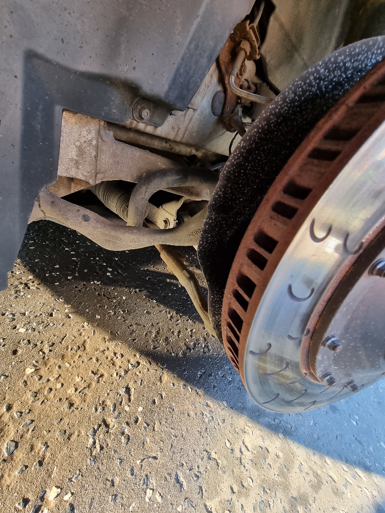

Was changing the pads on the E92 earlier and got a bit carried away.
Liners are still caked in tar but it's a lot tidier than it was. Just a shame the race spec AP caliper hardware hasn't stood up to road miles and the winter. Not a surprise to be fair and to be expected. Should probably of kept on top of it a lot more but the actual pistons are still spotless and the discs have all their float still
Raceglaze Alubrite for the alloy arms etc, AF APC as its all I had and dressed with CG barebones as again, it's all I had lying about [emoji28]
Bare bones is actually still great! Not many products do what that does!
Get some hammerite on those discs.
Need to replace the rotors at somepoint anyway this year and could do with some fresh rear pads and discs to be fsir
Yeah first time I've used it, wouldn't normally use 303 Aerospace for dressing but found an unopened bottle of Barebones
