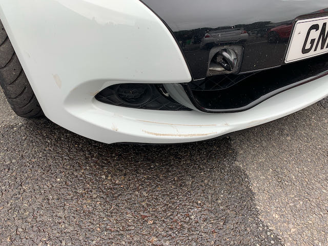

I was at Lydden Hill at the weekend and as I came round a corner the car in front of me was rolling and came to a standstill in my path, I managed to avoid the stationary car but came off the track on to the grass.
I have managed to scuff the lower part of my Clio 200 front bumper. The surface of the brown areas feels scratched and is not smooth. The scuffs on the drivers side closer to the wheel look like they will polish out okay. I am not sure what has caused the brown scuff marks other than the grass that I ended up on.
Can anyone recommend the best way to deal with the marks? I think that the bumper is just plastic so has no paint on it - although I could be wrong. Could I just use something like Meguiars Ultimate Compound to see if the area can be cleaned up of the brown dirt/residue and then just use a polisher to see if the scratchy surface can be smoothed out?
