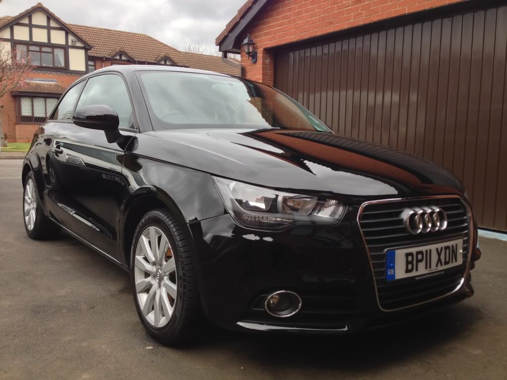

Did an enhancement detail on an Audi a1. Once decontamination was sorted I went straight for ultrafina which is usually my weapon of choice for light defects. But I needed something with a bit more bite and gloss.
So I went for scholl s17+ on a 3m yellow pad with the rotary.
Outstanding stuff if I do say so myself. I really thought I'd struggle with Audi paint but this served me well, great combo!!

I was worried ill be honest
Was my first customer that wanted a
Detailing service since I've been a self employed valeter. I really want to be doing more jobs like this as I feel there isn't enough detailers on the move around here.
So I was crapping myself, it's important I get the first job right and then the rest thereafter. Black Audi is probably the worst place to start haha
Turned out all good though :D
Gally
Lovely stuff JB, the S17+ is what I recommend for 1 step on hard paint, menz sometimes lacks the 1 step bite without stepping up a grade. Very good polish.
