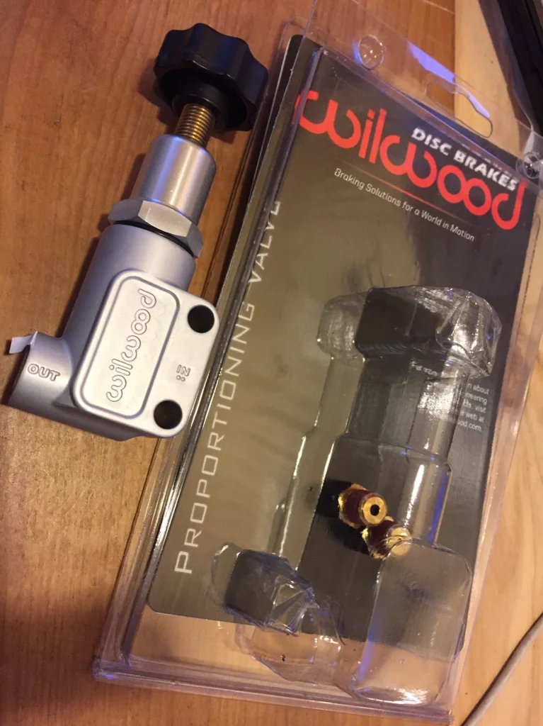

In short, I kept the rear lines but cut and bent them up into the cabin via the handbrake cutout to a Wilwood bias valve ( proportioning valve). I then made new lines for the front.

@JACAM T piece inside before the valve?
Yes bring the lines into a tee and out to the prop valve. Make sure any lines that might rub on the body have some sort of protection - old hose or something pushed over.
