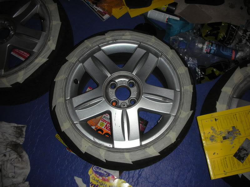

mask
use metal filler to fill the curbing then sand down to a smooth finish using wet and dry paper.

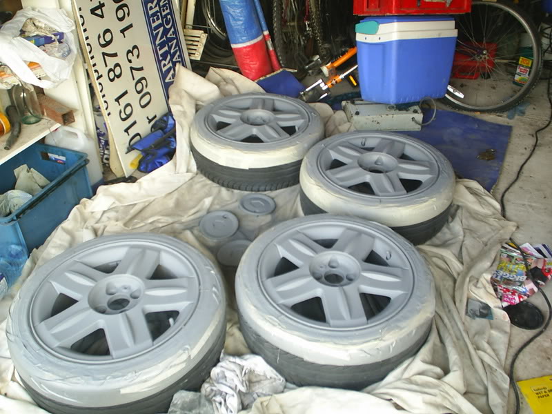

Prime
put several light coats of primer on then sand to a smooth finish again with wet and dry.

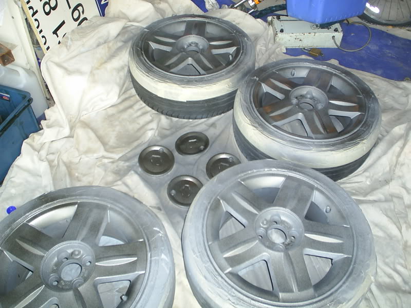

spray the colour of your choice on the alloys using about 5 light coats.
then laquer

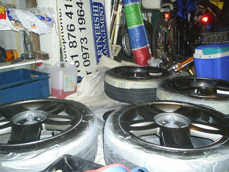

Whoops^^ Bit of a mistake! if you don't sort it asap your wheels will fall off.
You haven't masked the wheelbolt seats, you need to remove the paint from the seats asap, or the bolts will become loose and the obvious will happen.
Remember when refurbing wheels (with cans, not powder coating) dont paint the bolt seats!!
Other than that great job on the above!
