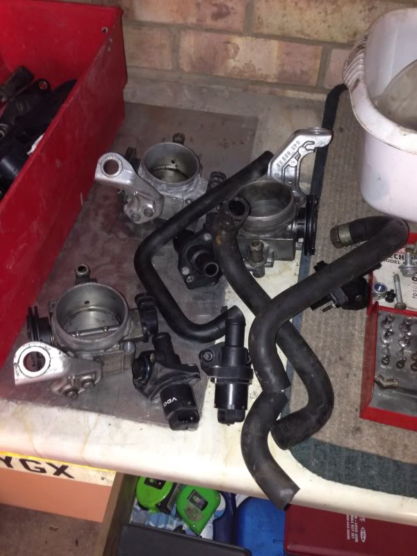

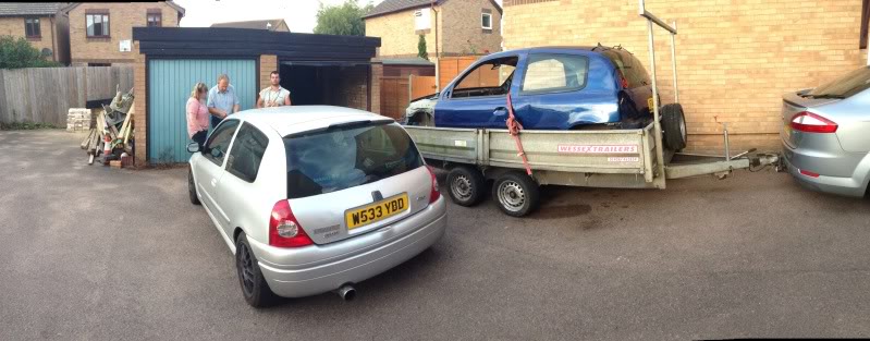

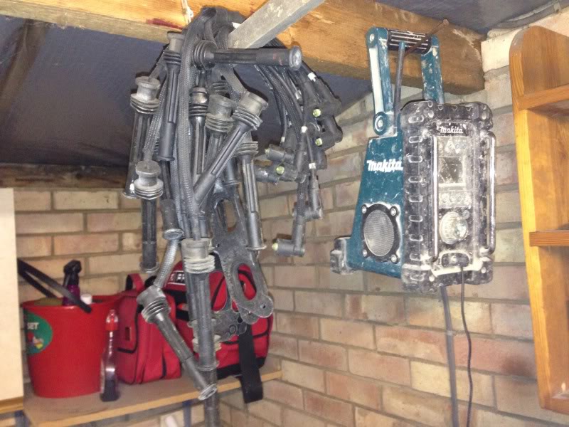

This week i went to DannyR's house to collect all of his spare, needless to say I now have even more parts kicking about but most of these were useful! I have issues with clios/part i feel.

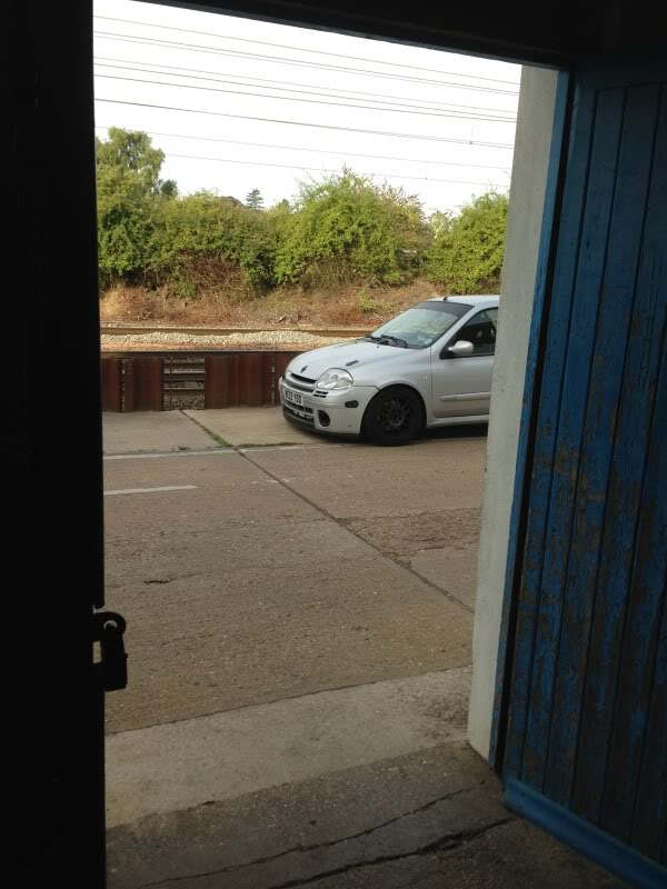

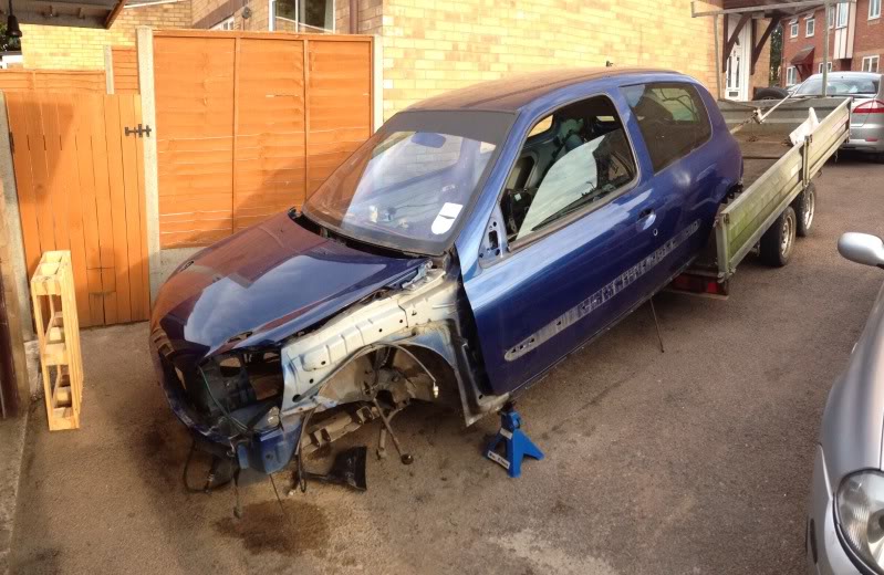

Then I decided it was finally time to part with the monaco after it had been stripped to an inch of its life. Look away Dan @ 519!
Fairwell!

Good to see the Monaco finally go, I think I got my fair share of bits from it :)

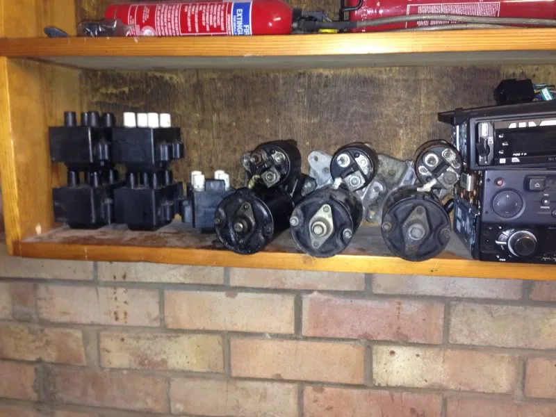

Lol! :lolup:
Some collection you've got there.

Lol! :lolup:
It is, couldnt believe it when Danny offered me his spares and there were 4 ICV's sitting there haha

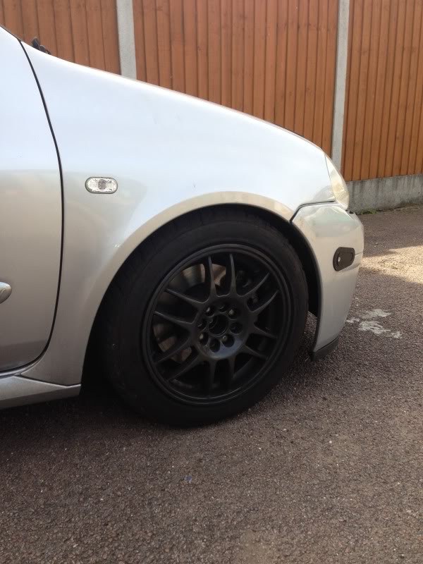

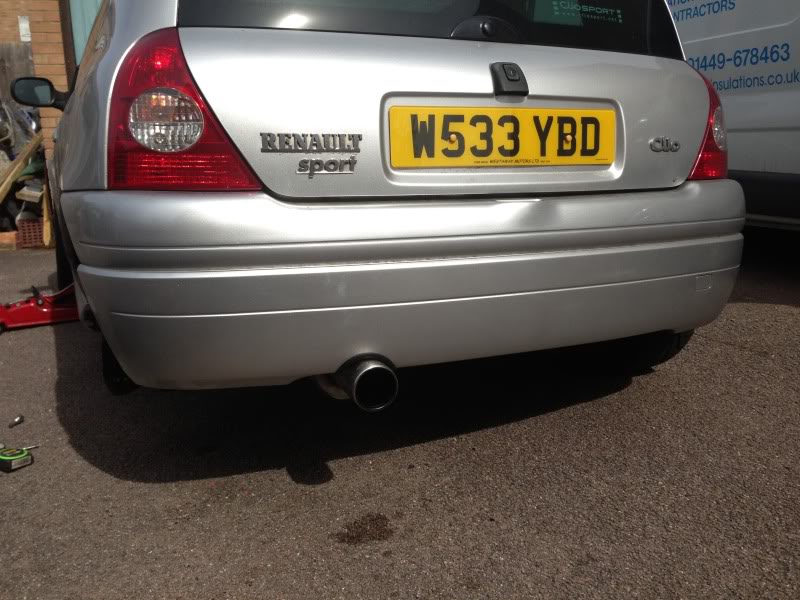

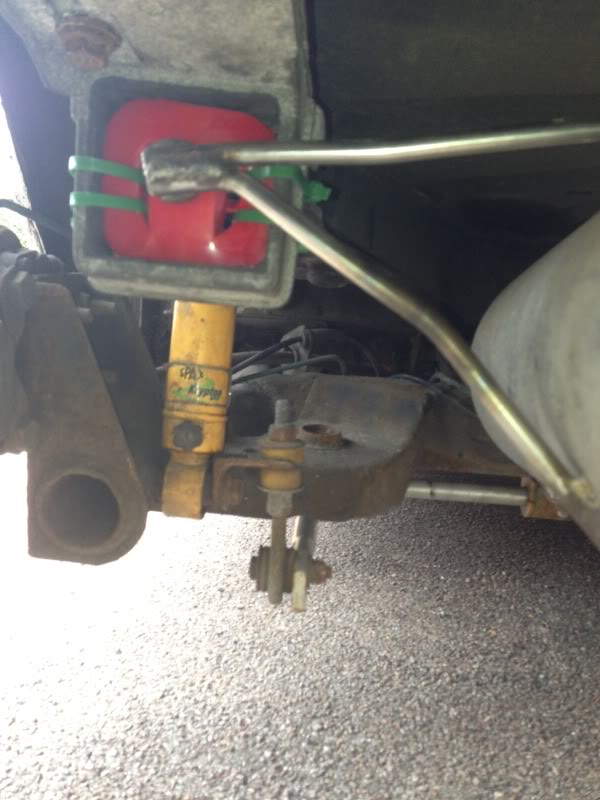

Finally fixed the exhaust, well kind of. Put a universal powerflex mount in it, it worked wonders. Though it looks s**t.

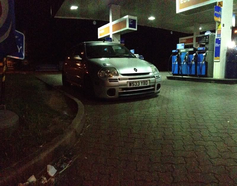

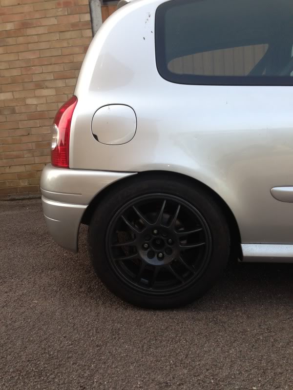

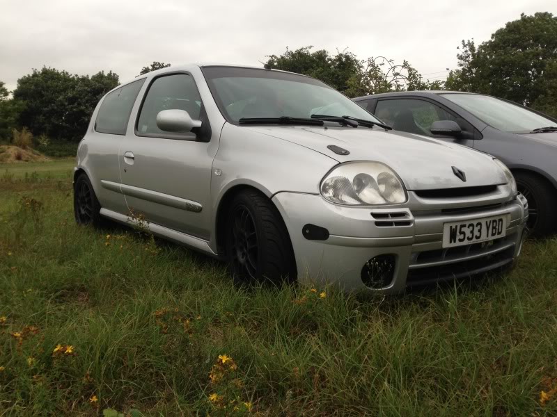

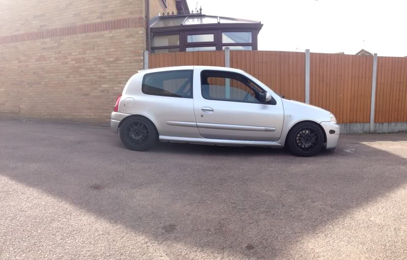

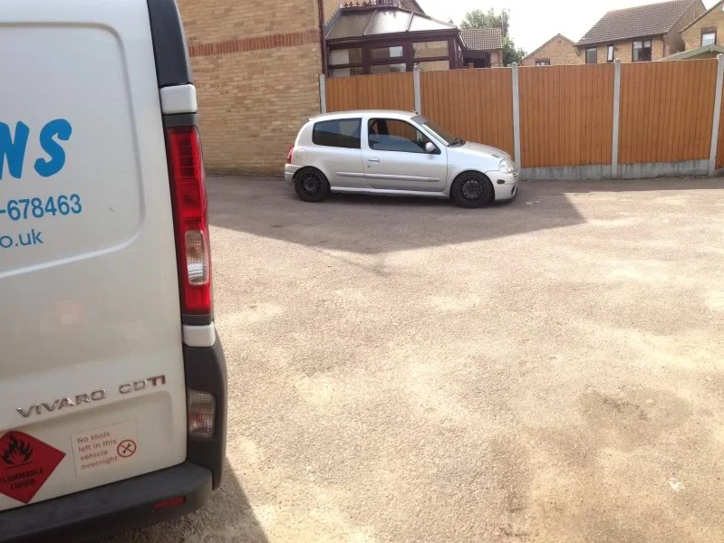

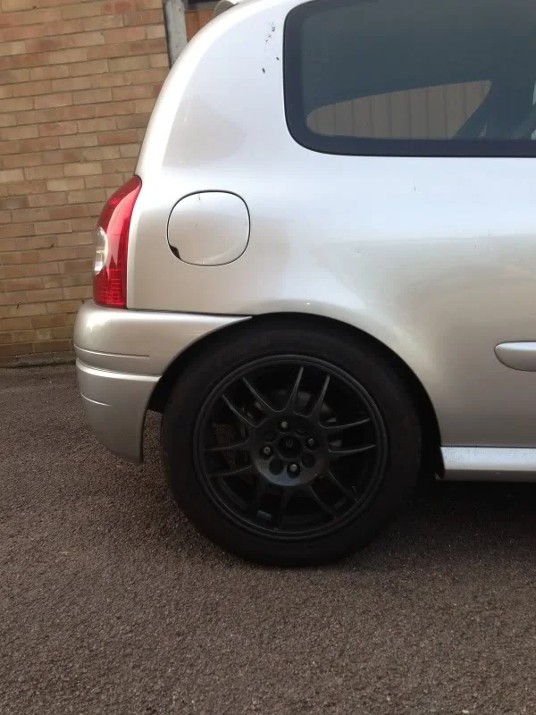

How it sits now. Sits slightly to one side but thats the best I could get it
Added some lows as coilovers were set the same as on the monaco.
One day I will take pictures of it off my drive way and with out using an iphone, one day!

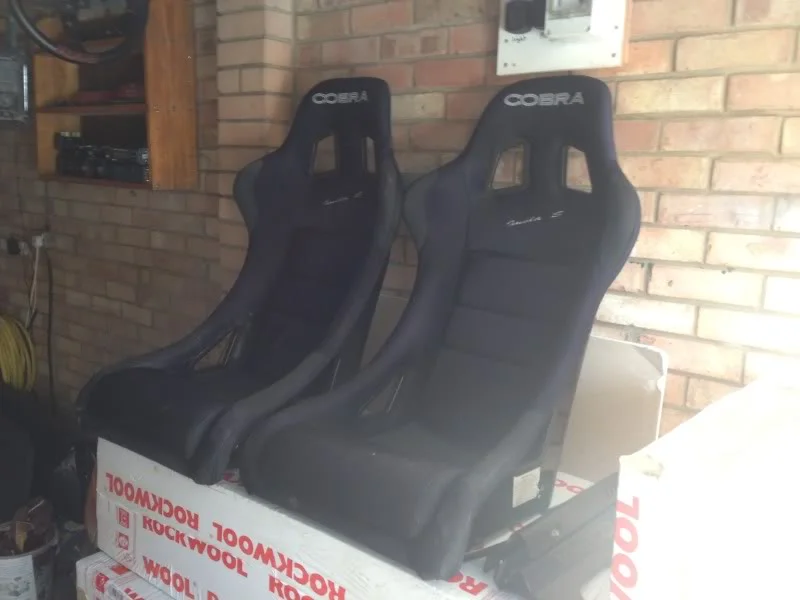

s**t update as per,

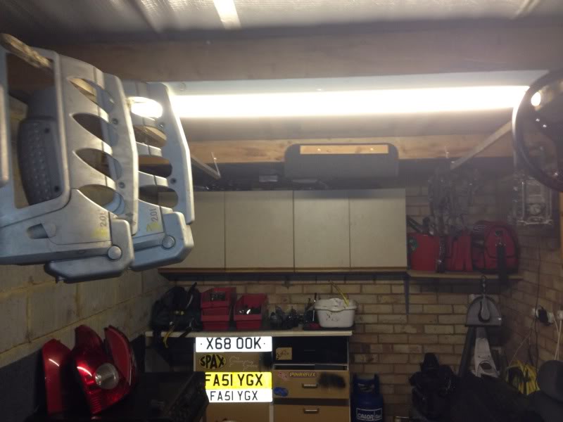

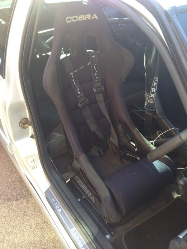

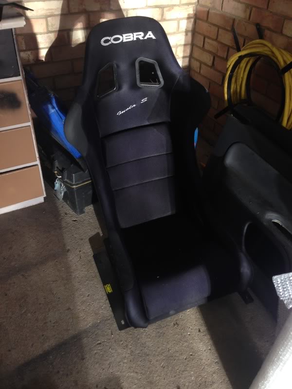

Bought a set of matching bucket seats
Fitted the drivers side one, yet to fit the passenger side one!
Passenger side seat on OMP subframe ready to go in when i get round to it

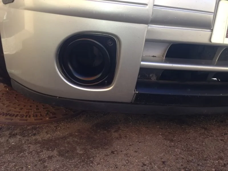

Painted fog air duct things satin black

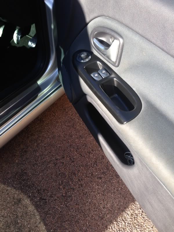

Painted door grabs satin black

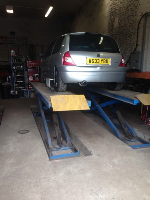

Got the geo set up, 1.5' camber either side 20mins toe out. The man doing it ask if it had been in a crash as the geo was that bad, truth is I hadnt had it done since owning the car and pulling it apart/changing various bits.

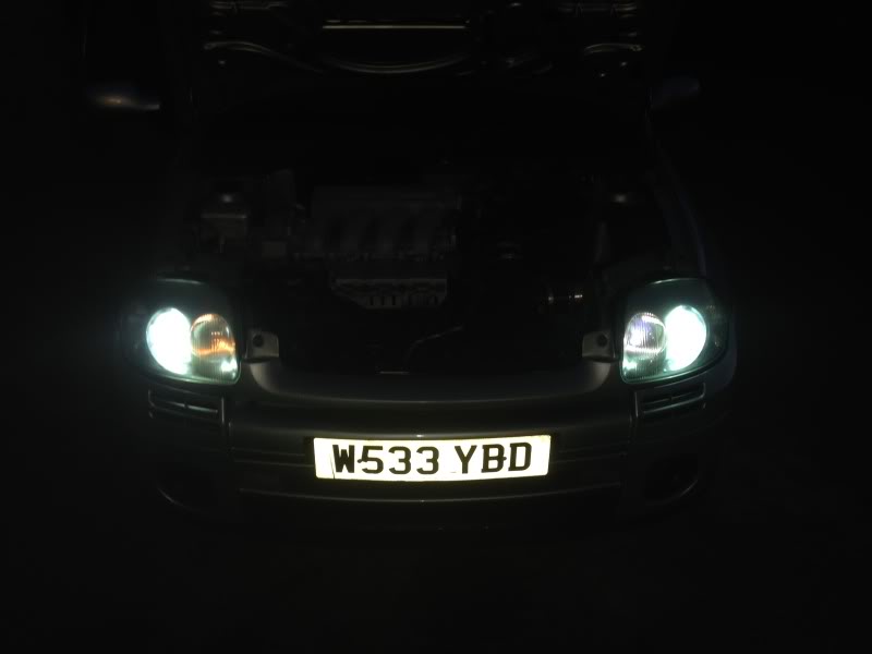

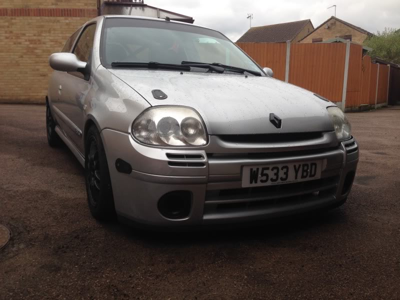

Lost a HID ballast whilst driving one night, so replaced them with another set of chavtastic HID's, note the mismatching side lights :eek:

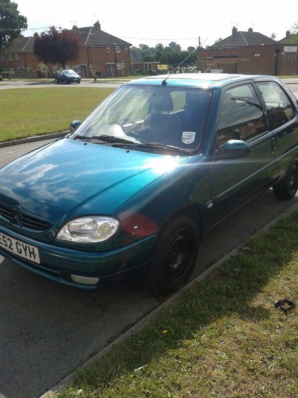

Girlfriend went to uni, so i now have her car to use along side my car/works van. More french s**t on my drive! She also hinted it needs a service and the central locking fixing, oh joys. But it does mean that I never have to drive the clio anymore if I dont want to

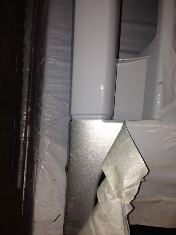

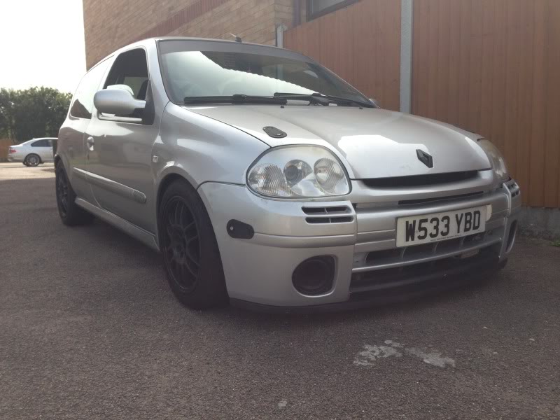

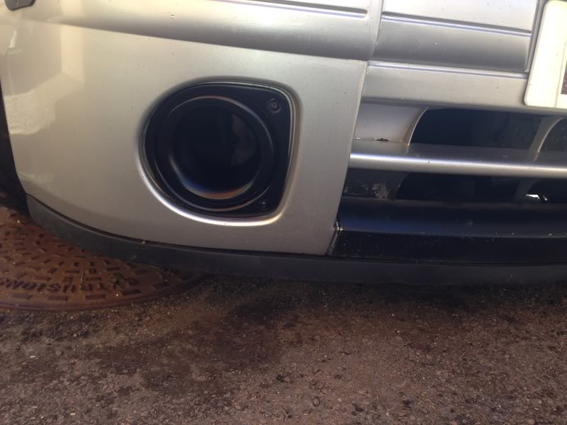

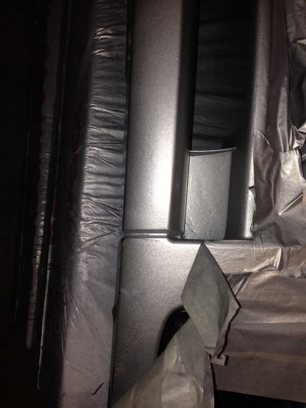

Then I got some paint mixed up at halfords to paint the bottom lip on the bumper (currently matt black). For £10 i thought it was worth a try, i wasnt expecting it to be the same, but this is something else! Looks like primer to me :S
Unsure what to do, get some more paint mixed up? Go black? Go the same colour as the wheels (graphite grey)?
Ideally i should just get the bumper resprayed, but I would rather wait until after winter and get the wheels refurbed at the same time.

Back to halfords today to winge about my paint, got another one mixed for free and it looks roughly the same colour, finish is shocking on it but ohwell!
Re: dmallett's titanium ph1
Much better!
Ta mate, reality is it still looks s**t!

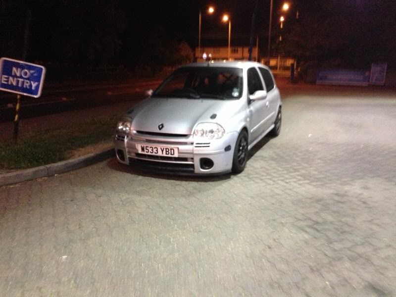

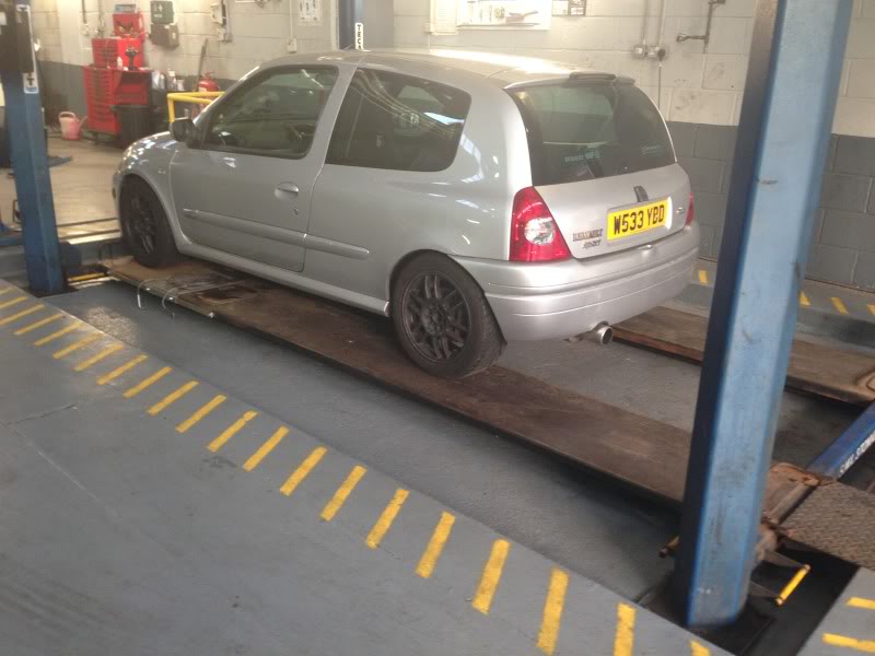

Car passed its MOT this morning, slight play in the driver side inner tie rod. So nothing major, probably do a track/tie rod and bushes refresh on the front end at some point anyway so that will be sorted. Only other thing was i managed to ruin the exhaust mount on the way there, spilt my powerflex mount down the middle! Probably only last 200miles so need to get a new one and re-align the exhaust so its not under so much stress.
Also put 6months tax on the car so its safe to say the car will be alive for at least another 6 months. Hopefully the new year will see some interesting developments with it :)
In all its filthy glory!

Glad it passed ok, can't see how people use the power-flex exhaust mount bush's without them splitting, when I used them they split within a few miles.
Cheers! On the flamer it lasted to the ring and back so im blaming this exhaust! Might look for an alternative method
