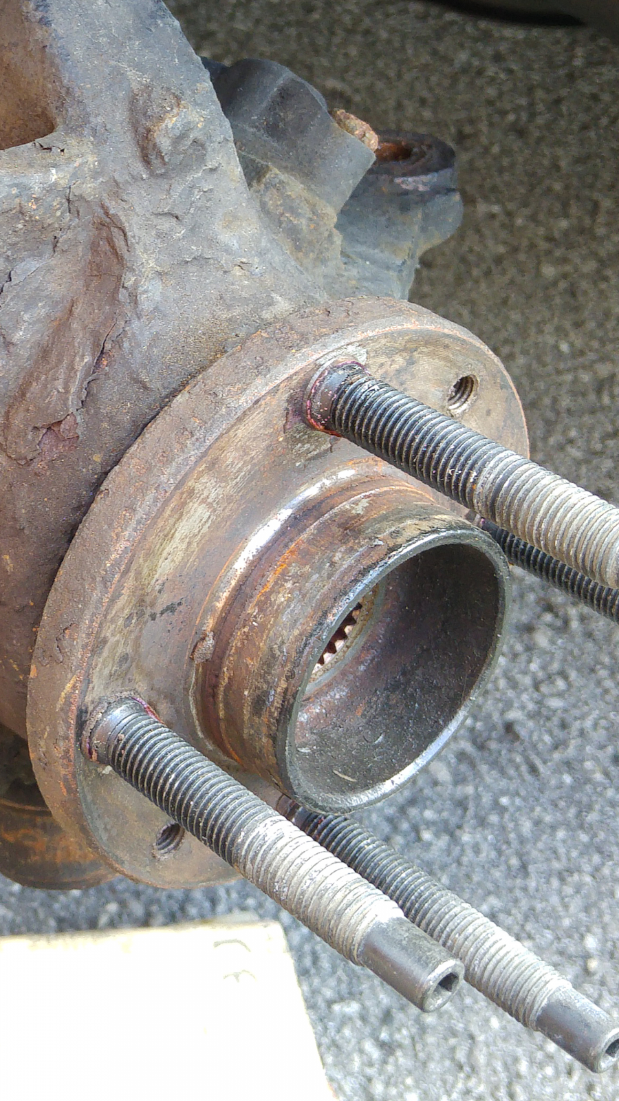

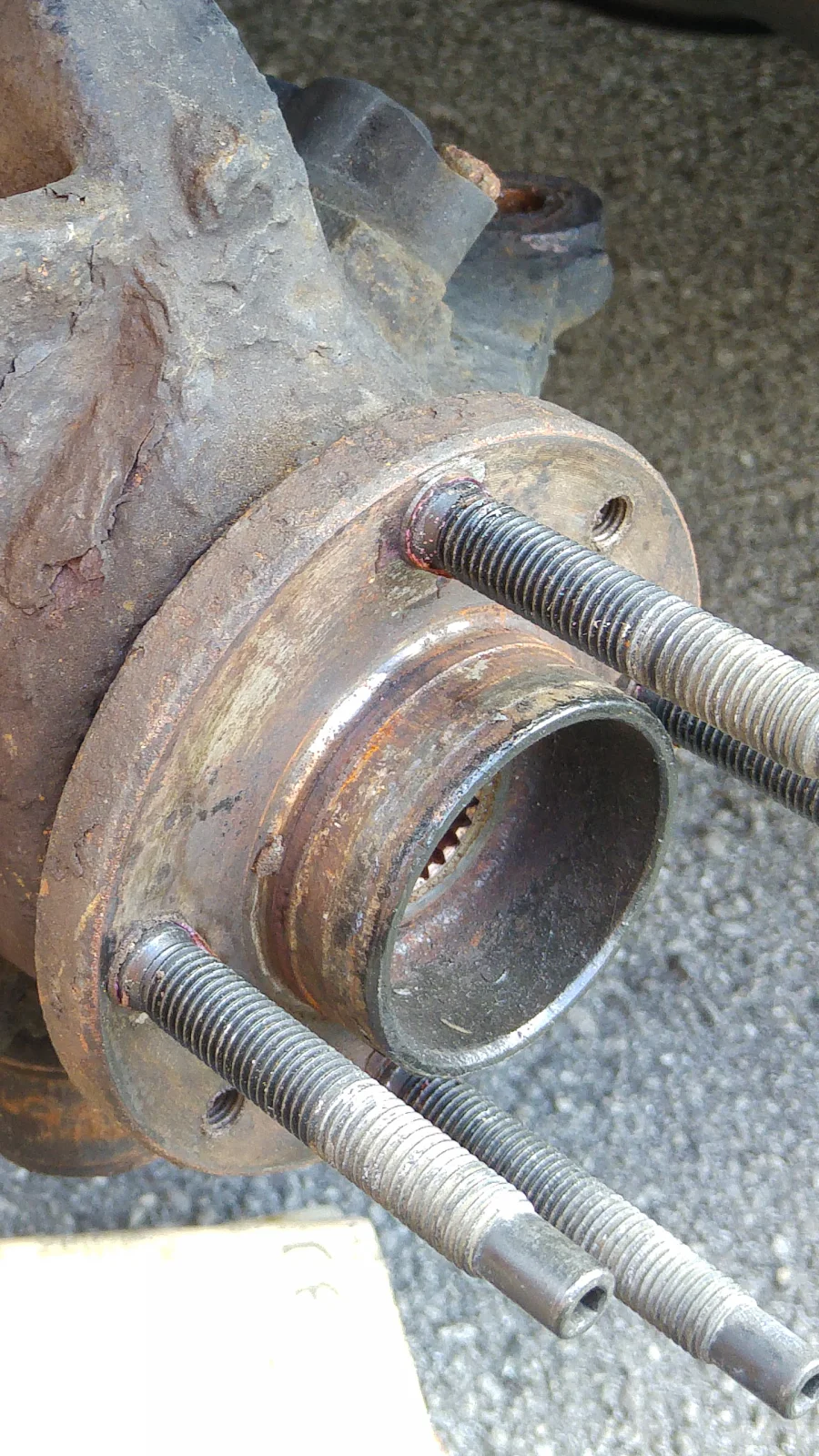

Drive shaft wouldn't fit on the hub if the hub was a nonsport. As per the pic, the splines there are a completely different size on the sport compared to a non sport.

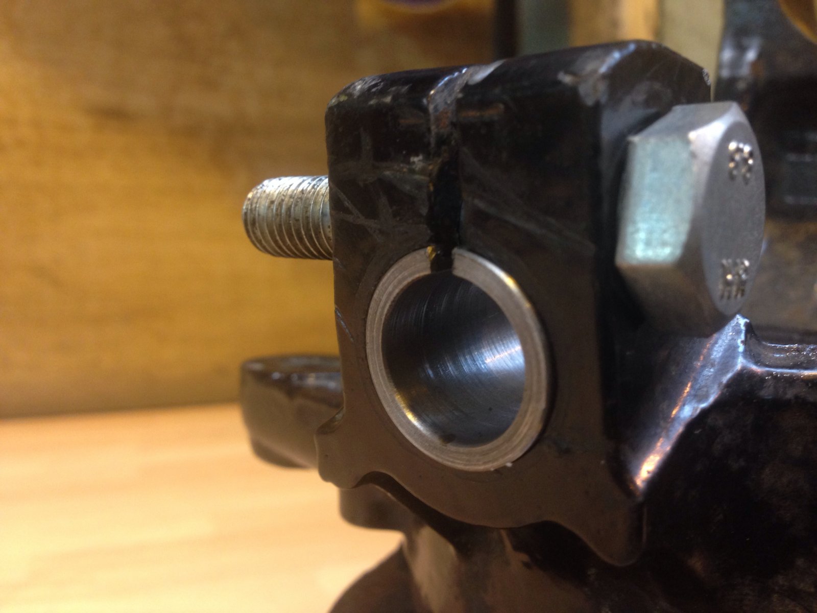

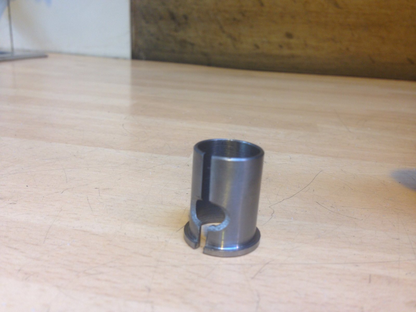

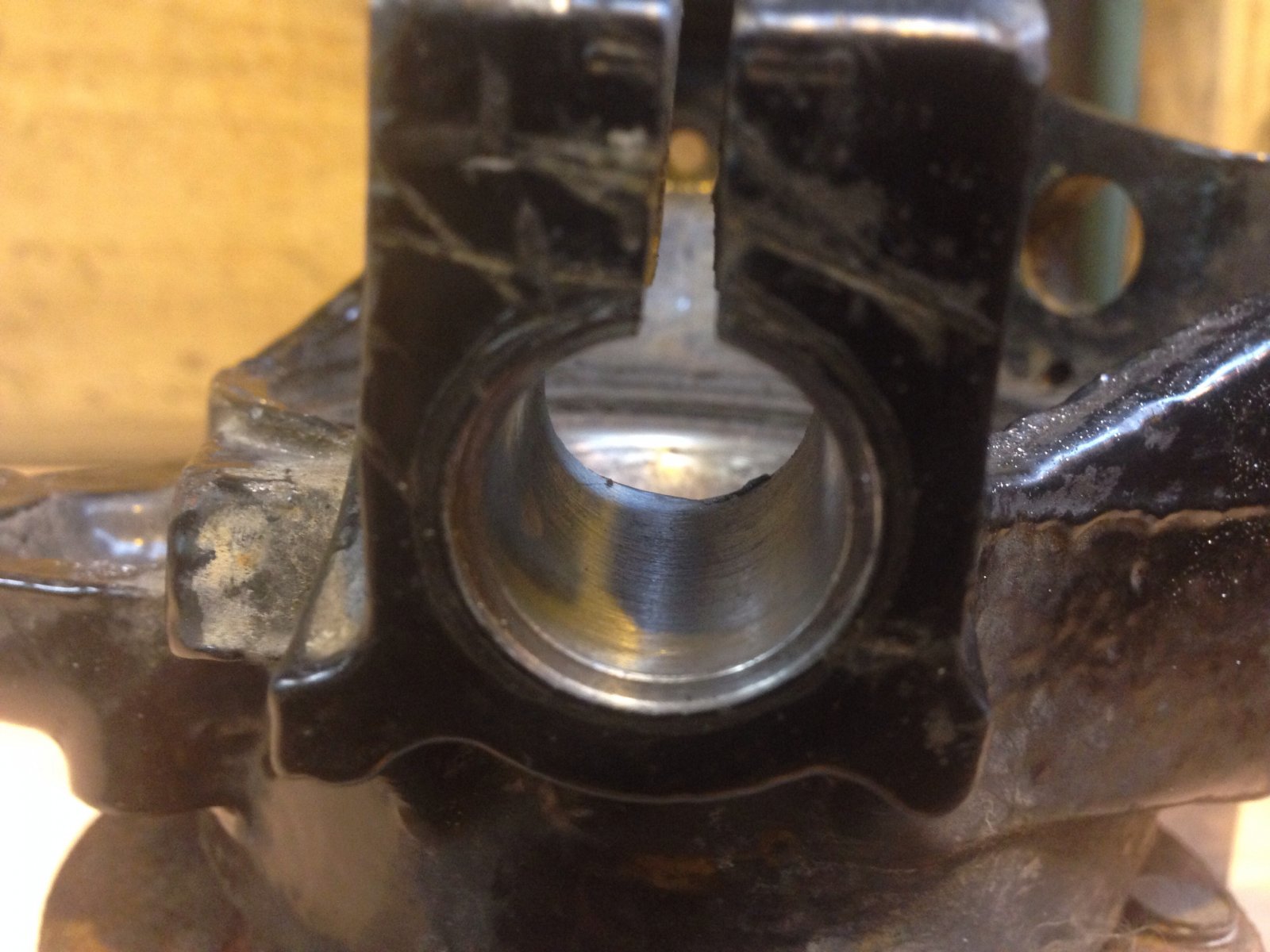

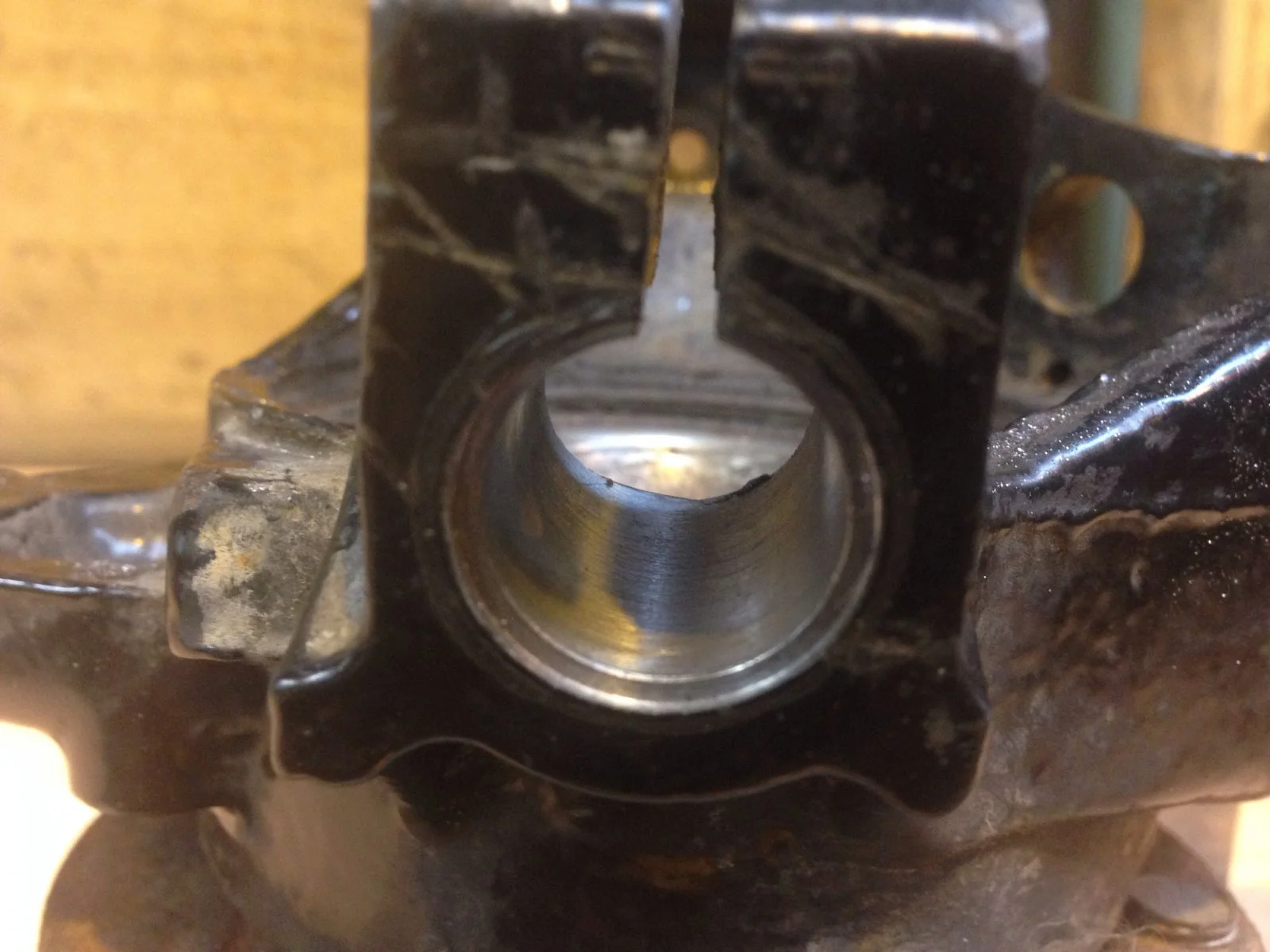

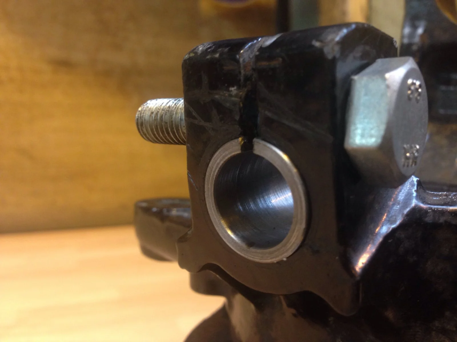

Theres a lot of free play yes, its got a brand new wishbone and ball joint, so problem must lie with the hub carrier no?

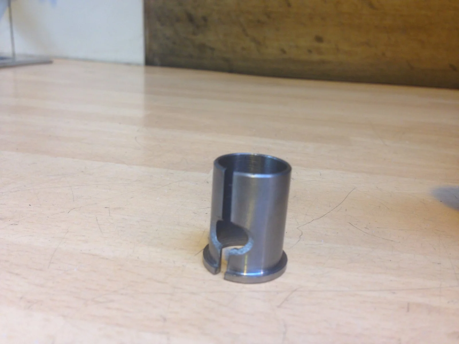

I'd check the bbj hole in the hub is nice and round, they oval if they over tightened/run loose, very common on older peugeots.
I can repair the hub if you struuggle to find another, 172 hubs seem fairly plentiful though

Check the ball joint diameter.
There are two sizes, so it might have the wrong one fitted.
If not, a second hand hub from a breaker is only £25 anyway!
Thanks so much for all your advice guys, bought a second hand hub now, so ill give that a go :) ill keep you in mind allanallen if all goes tits up :) cheers
