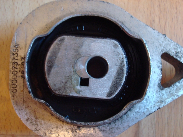

One thing I thought was strange is that the old bush I took out had an offset hole (attached). This made me think that this was done to pull the bottom of the engine backwards to help lift the manifold clear, ot it's a defect!!. I didn't get the knocking with the standard dogbone bushes, but it kept trying to push out of gear, which is why I replaced them!
I'm hoping that by replacing the top mount and gearbox mount with the uprated k-tec items and pulling the top of the engine forward, the manifold will hopefully clear the ARB.
Anyone else had this?

you may find the top engine mount has split. mine was ok, but put the dogbone one on and after a week it got bad again so i removed the top mount and it was split in two. got a replacement (2nd hand) one off of a low mileage wrecker on ebay :).
I had a look at the top mount and I can see a couple of small pieces of rubber that have come away from somewhere, so I am guessing it is coming apart. Problem seems to also be my manifold doesnt have the dent in that apparently it should have had from the factory to allow clearance for the ARB, so this isn't helping either!
