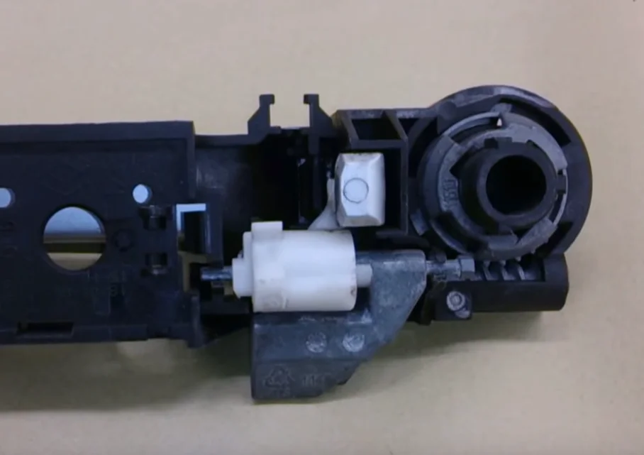

Could do with a picture of the inside mechanism, from memory it's a worm and gear type set up, but without moving the gear. the handle wont come out.

yes it’s the worm and gear type as you say. I have tried tightening it again, but still get the same problem. Once it is undone (I understand the screw doesn’t come all the way out), what should happen - should the little silver piece behind the door handle come off? I’m just checking really that it’s not actually undone, but I’m getting the next step wrong.
It should just waggle loose. It maybe a bit stiff and stuck to the door with 10 years of crud! If I remember correctly, it's just the plastic that comes out.
Mine got so far and jumped teeth.

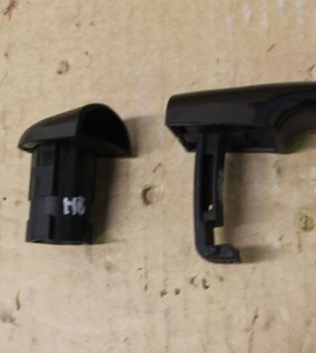

Found this on you tube, it shows how the plastic part is held in. Are you changing the micro switch?
Thanks mate, that’s very handy. I understand you can’t change just the switch on these, it’s the handle you have to replace? I’ve pulled the outer skin off the handle and had a look at the switch, and it doesn’t look like you just unplug it.

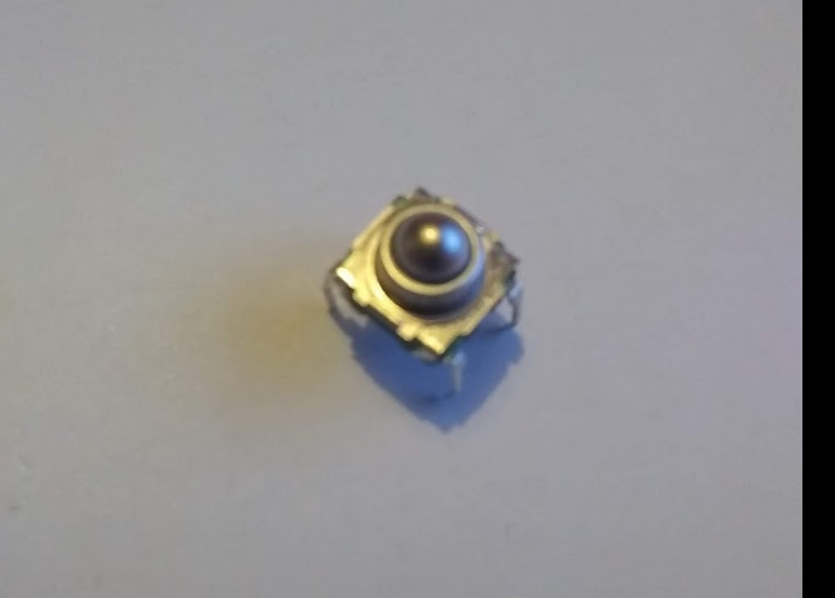

You can replace the micro switch.
It isn't expensive, there's a how to for removing the door card, but you've obviously sussed that one out!
Have a read, the switch needs to be soldered, but I've done 4 now and it's not too difficult.
