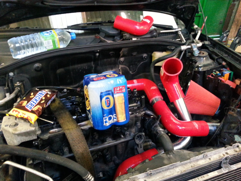

Out of interest is there not a risk of the silicone hoses collapsing under pressure?
Why would they collapse when they are pressurised?
I dont know nothing about it, people just always seem to squeeze them. So i thought i would ask the question lol
Or is it standard rubber hoses that collapse? or am i just going crazy!

They would only collapse on the suction side of turbo if they were too flimsy but 3 or 4 ply silicone is the stuff to go for. More likely to blo them off at the joints unless they have swaged ends.

Only way a hose will collapse is under vacuum, so the only ones at risk of doing so are the ones BEFORE the turbo (ie between it and the air filter) if the airfilter is too restrictive.

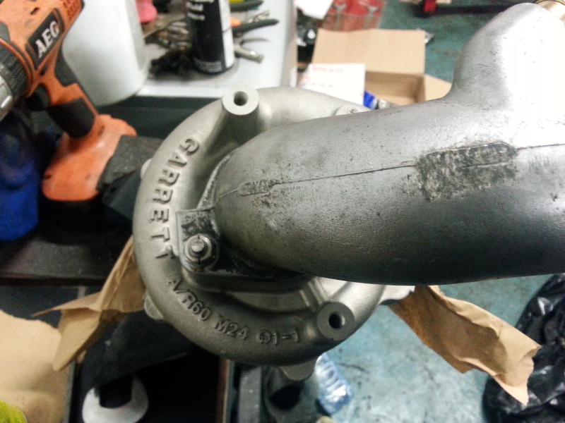

There has been a small issie with this the turbo we were sold as new and refurbed looks like its been shot blasted and cleaned up and no knes fittted the bearings back in :/
So after a dispute with PayPal over £700 we have just sorted out a new one from E.D :)
