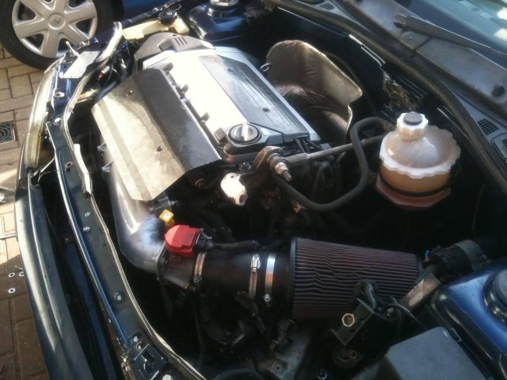

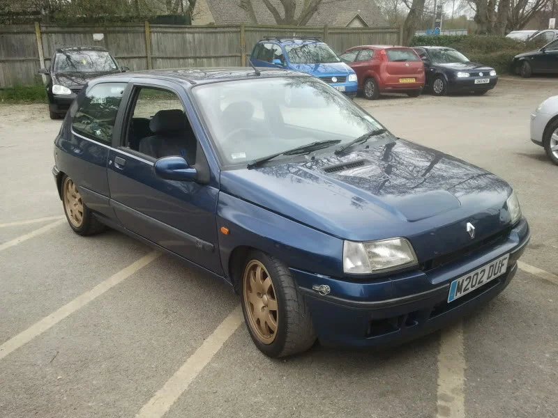

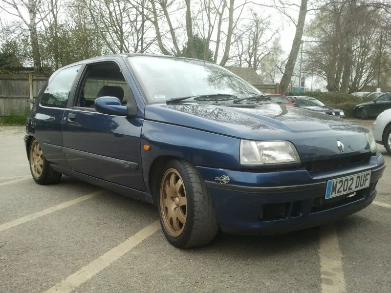

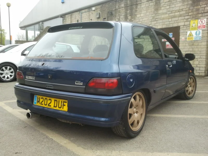

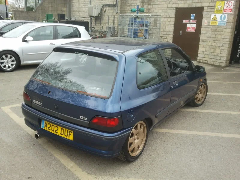

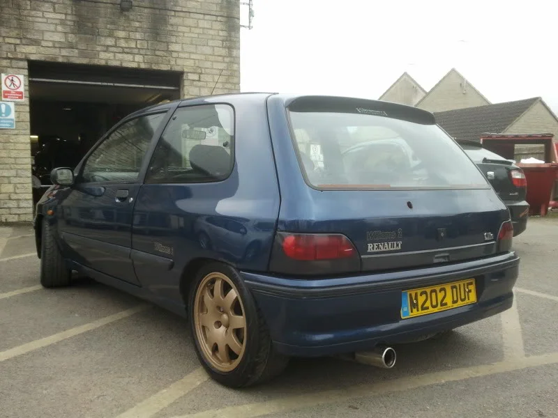

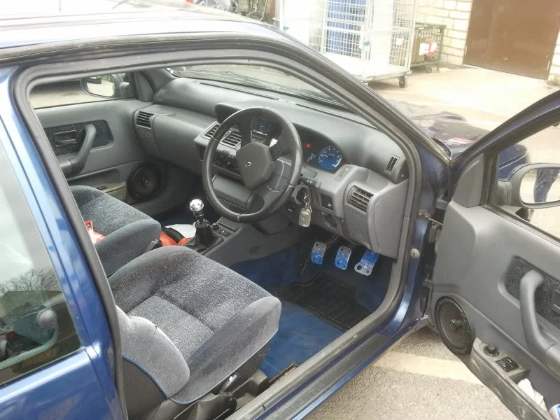

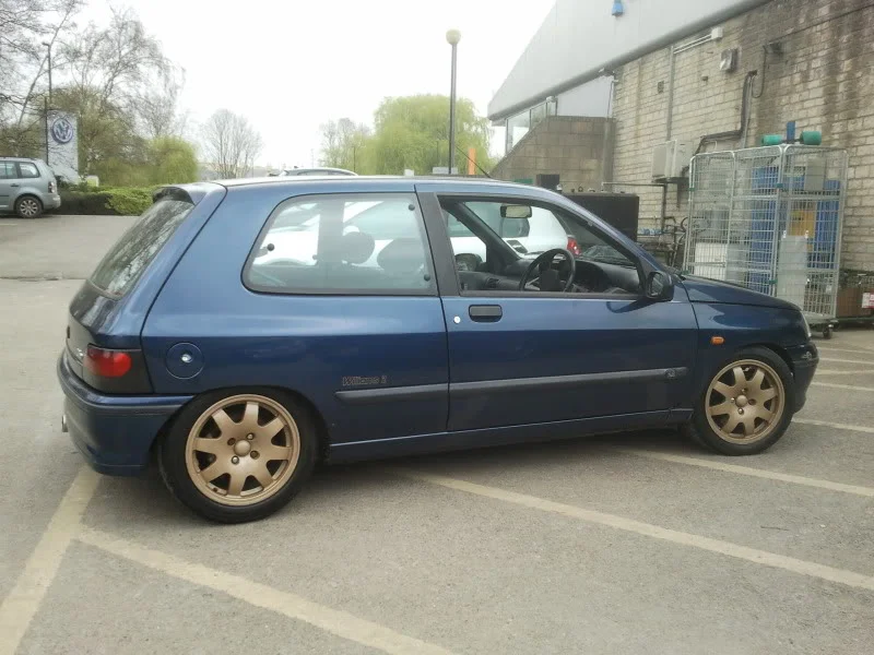

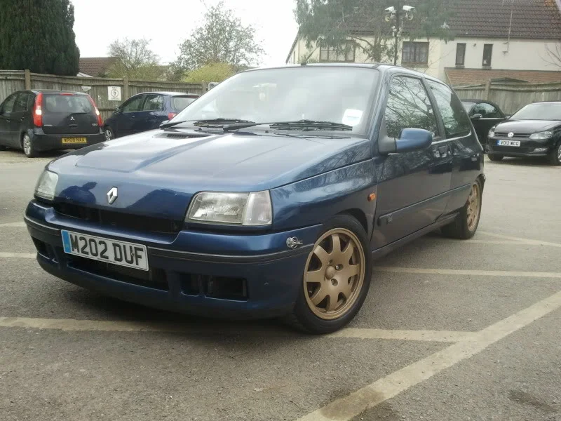

Some pics from today:

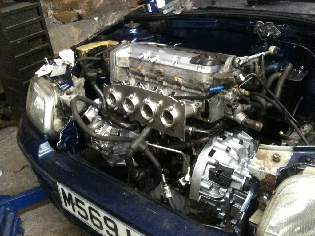

Inlet on mine is this one I knocked up from random bits I had laying around:
Excuse the comedy large filter, i put a bigger one on my nova and thats the old one from when it was only about 500bhp so this got it as it was free, same reason I choose a cossie throttle body, its probably smaller than ideal but I had one there so it went on.

looks plenty good enough, 180ish bhp?
Yeah probably about 170-180 or so I would think, was 172 on dyno dnyamics when it was on bodies but minus the cams and goes about the same now. I would say its a little less torque but little more rpm so seems to have come out in the wash.
