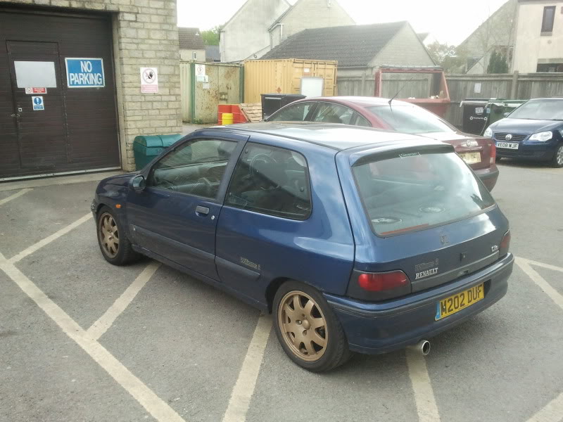

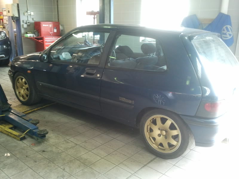

Nope, still got it Wurzle, collected it tonight, it's been away for a week having a new cambelt kit fitted, the rear raised up a bit and the exhaust stripped off to find where it's blowing.
Belt change went well, idler was nearly shitting itself so good job it was done, and the rear has come up about 2cm or so - ignoring arch gaps and going by the height of the sills, Duf now has a slight rake and looks much better - going to put some miles on and see how I find it, may get raised a bit more yet.
Exhaust blow turned out to be a crack in the prowler manifold :( though it's fixable so that will be sorted in a few weeks or so.

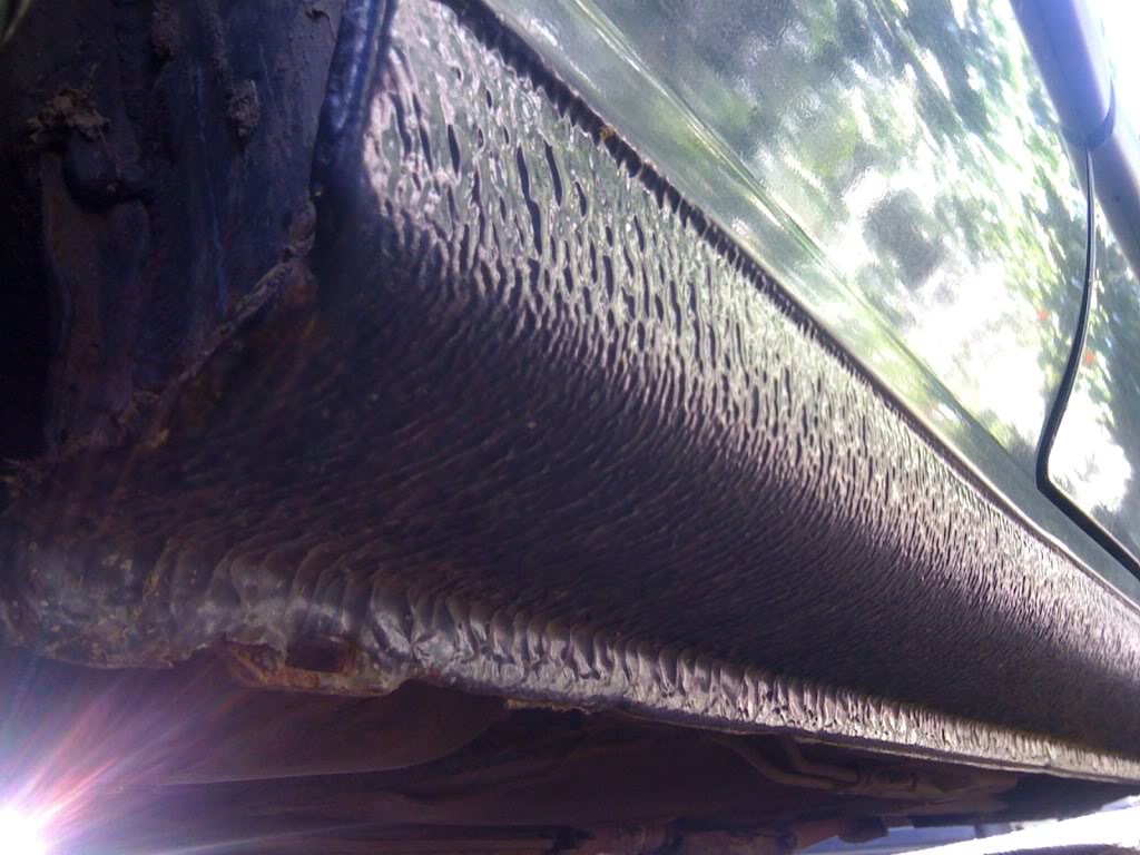

Thought id share a picture of one sill - other side looks the same, not bad for a near 18 year old car ;)
  53 Clio's & counting
Not even folded up and all bent about like normal let alone rusty, so that is a good sign :)
One side (I think the o/s) at the front has a slightly bent lip if im honest, but nothing bad thank goodness, and will be sorted in a few weeks when I start tidying up the underside :)

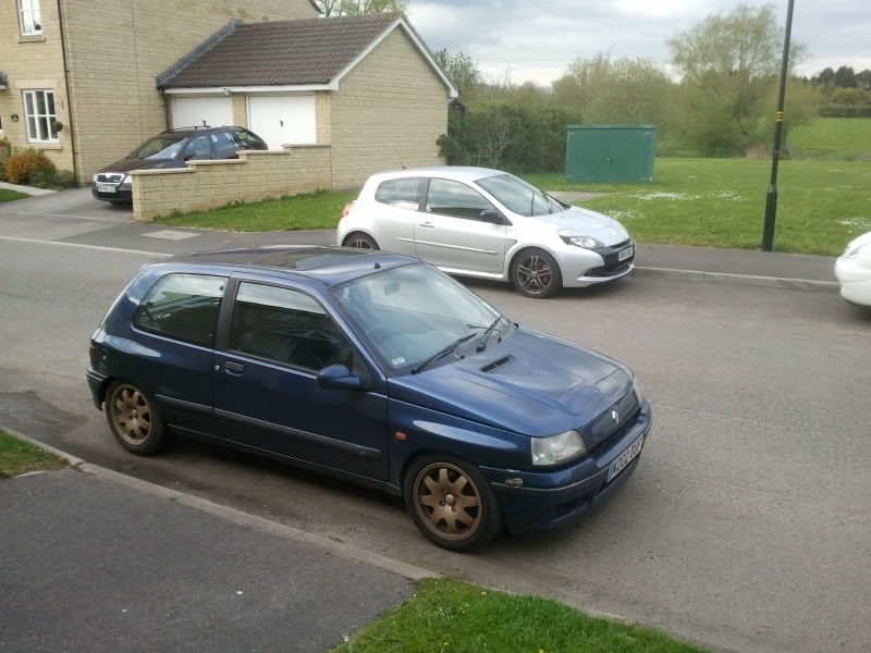

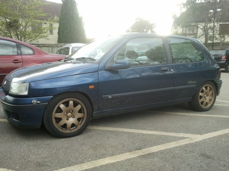

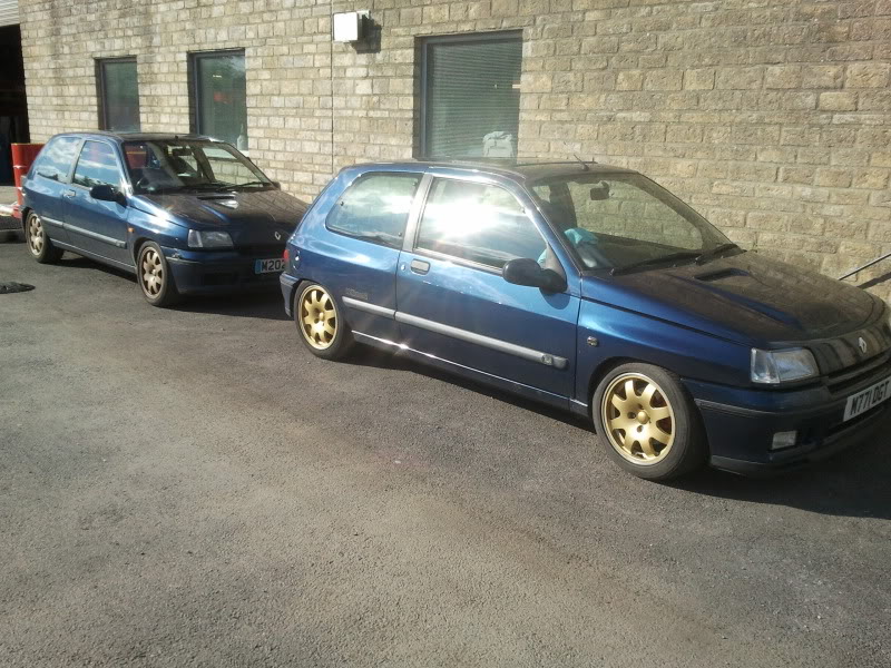

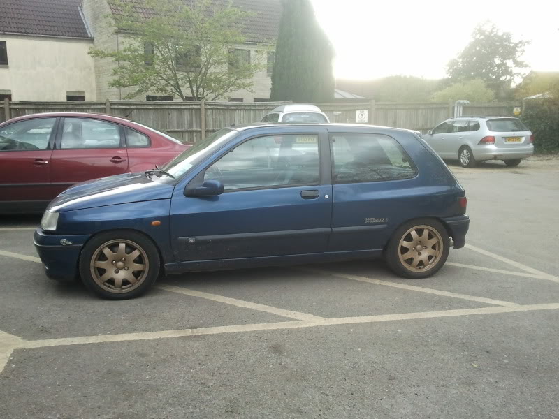

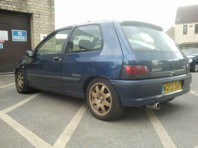

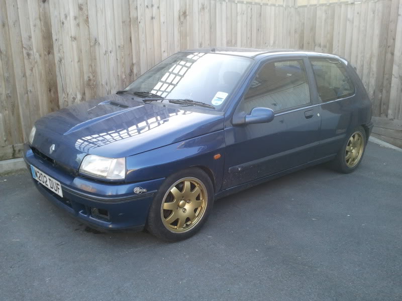

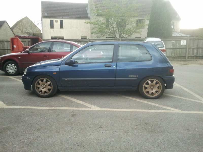

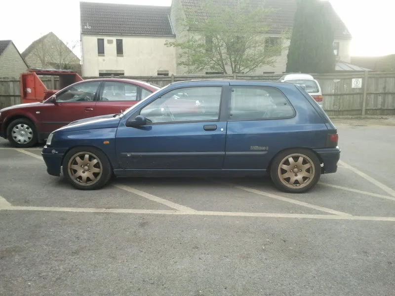

A few pictures of Duf with the new rear ride height.
Although it might not look like it's come up much, the sill heights now give a slight rake (Just as Clio's like) and to me looks much better:

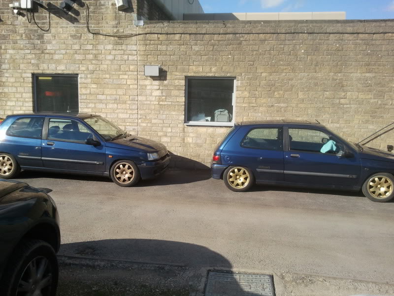

And one with a friends car:

So much better!!! It looked flat before, like there were 4 boom boom boxes in there.
(Is that 200 Mercury? looks good!)
Think the height is spot on now Dan, or shall it come up a little more? I can't quite make my mind up
(Oh, no idea on the colour, it's my dads mates lol)
Brilliant, puts my mind at ease as I was unsure!

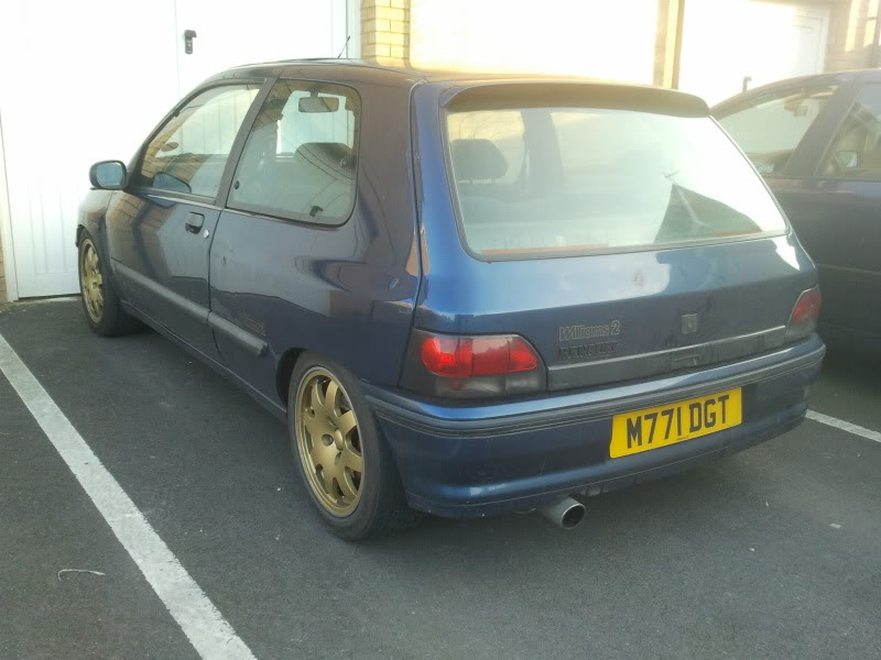

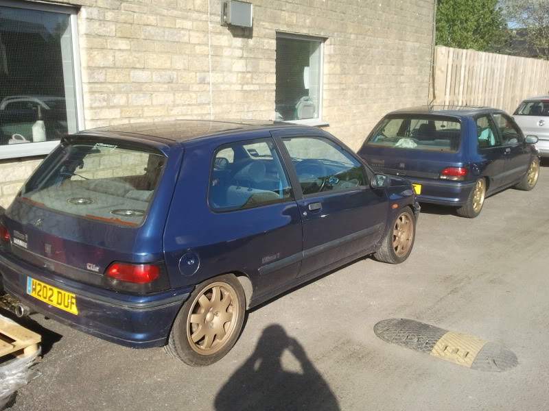

Well as some of you know, I recently purchased another Williams 2, which I bought for a good price - I did this as it had a few bits and pieces that I wanted for Duf, and it made more sense to purchase this one, swap some bits over and sell it, and today a fellow CS member came along and agreed to buy it, so the Willy currently known as 'Midget' (Check the reg plate) will be off to it's new owner on Wednesday :)
So now Duf has a new set of boots, a good parcel shelf with suit holder, plus a few more nice bits and pieces :)
A few pictures of both together:
And a bad picture of Duf with new wheels on

Flol, Neil I wish I could keep both, but I have not got the time for one at the mo, let alone two lol

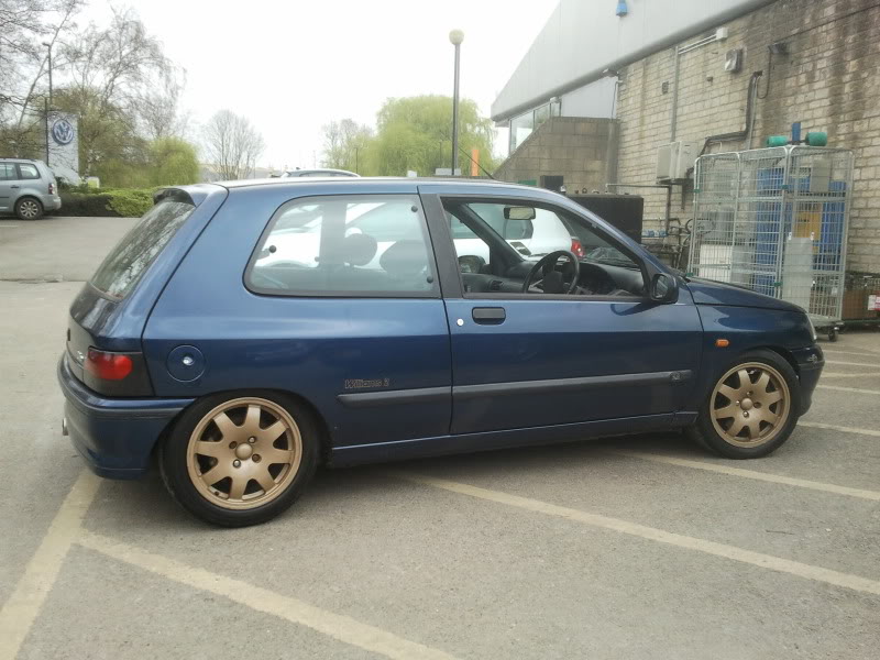

A bit of a better picture:

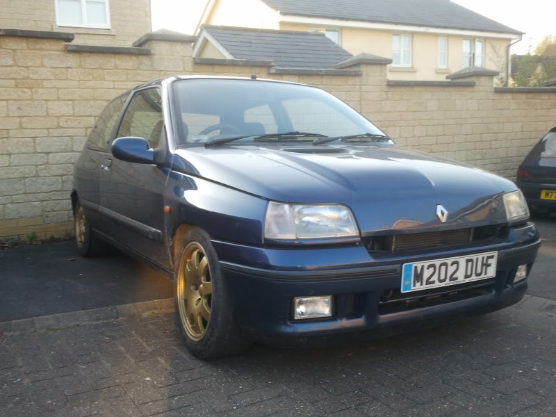

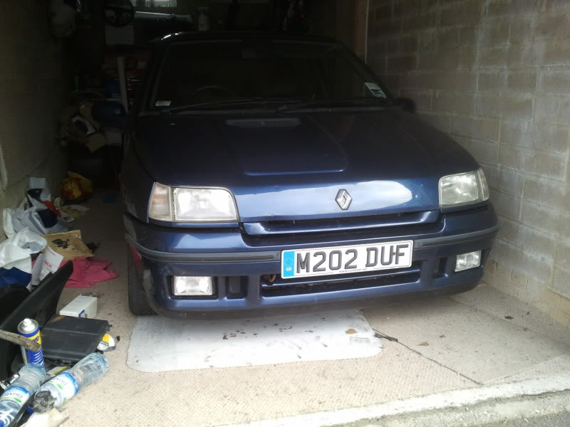

New front bumper
Well when I say new, what I really mean is a second hand one thats not snapped, cracked in 2 places, missing the bumper grille and held on by bonnet pins lol. I managed to get one from a chap off WilliamsClio who was breaking his Willy 2, and although it's not anywhere near mint, it matches the rest of the car and looks sooooo much better.
The Bumper grille had to be modified slightly as the oil cooler is mounted on the front panel and hangs directly where the grille is - my chap also had a pair of nearly new front fogs and the wiring loom spare, so those were fitted and look much better than 2 gaping holes.

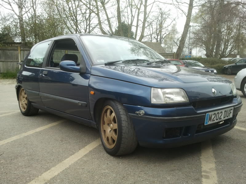

I think the new bumper, ride height and wheels have made Duf look 100% better, and with all the little bits and pieces done it has improved it alot.
So we have gone from:
To: (apologies for the poor pictures, I will update with better ones)
