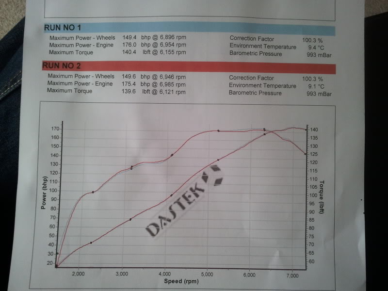

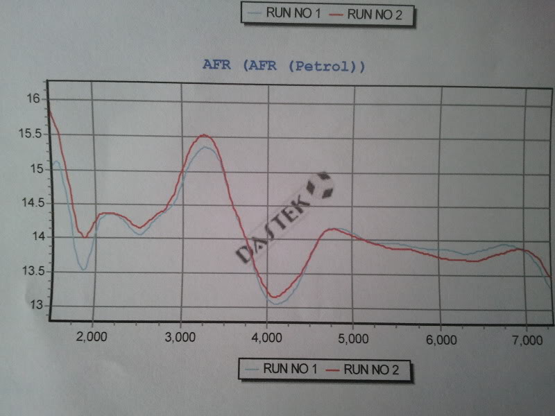

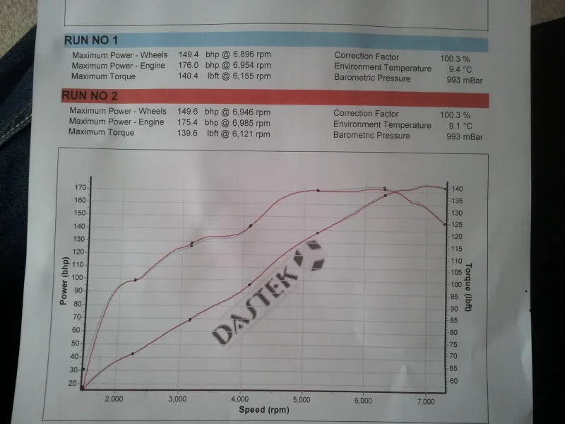

Now it's not perfect - the revs still go up slightly when I dip the clutch, and the revs don't drop to idle as quick as id like, but it is not correctly mapped so that may be something to do with it and it is now 95% better and much much more enjoyable to drive
