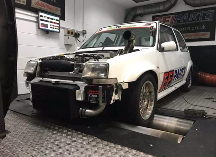

Chris at EFI Parts ever so close to a 1000bhp F4r but had to stop due to blowing a boost pipe off at 55 psi.

Is that a drain pipe sticking out of the engine bay lol

When I went he told me how he first started out with it doing runs down the M62 at 3am mapping the engine ^^

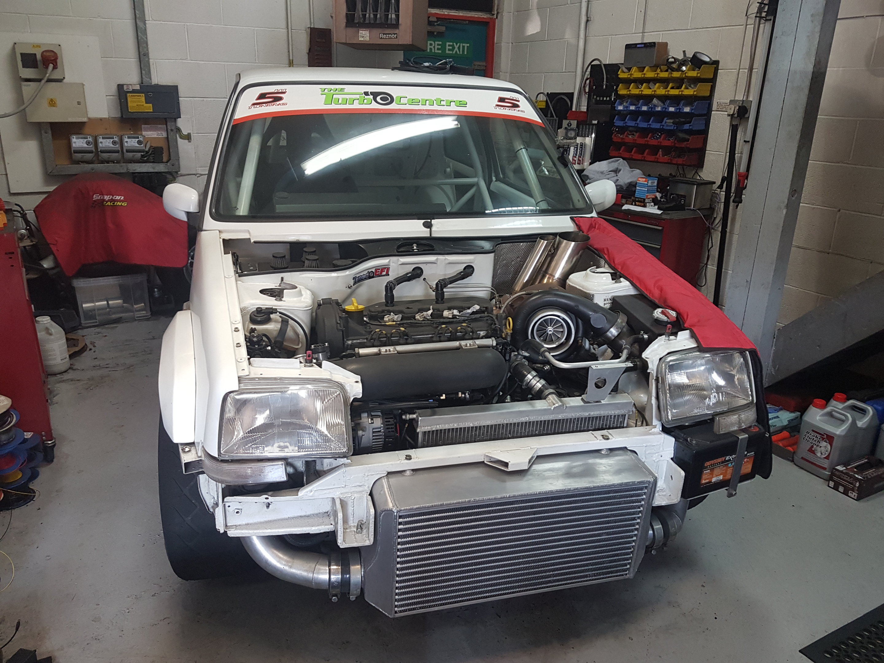

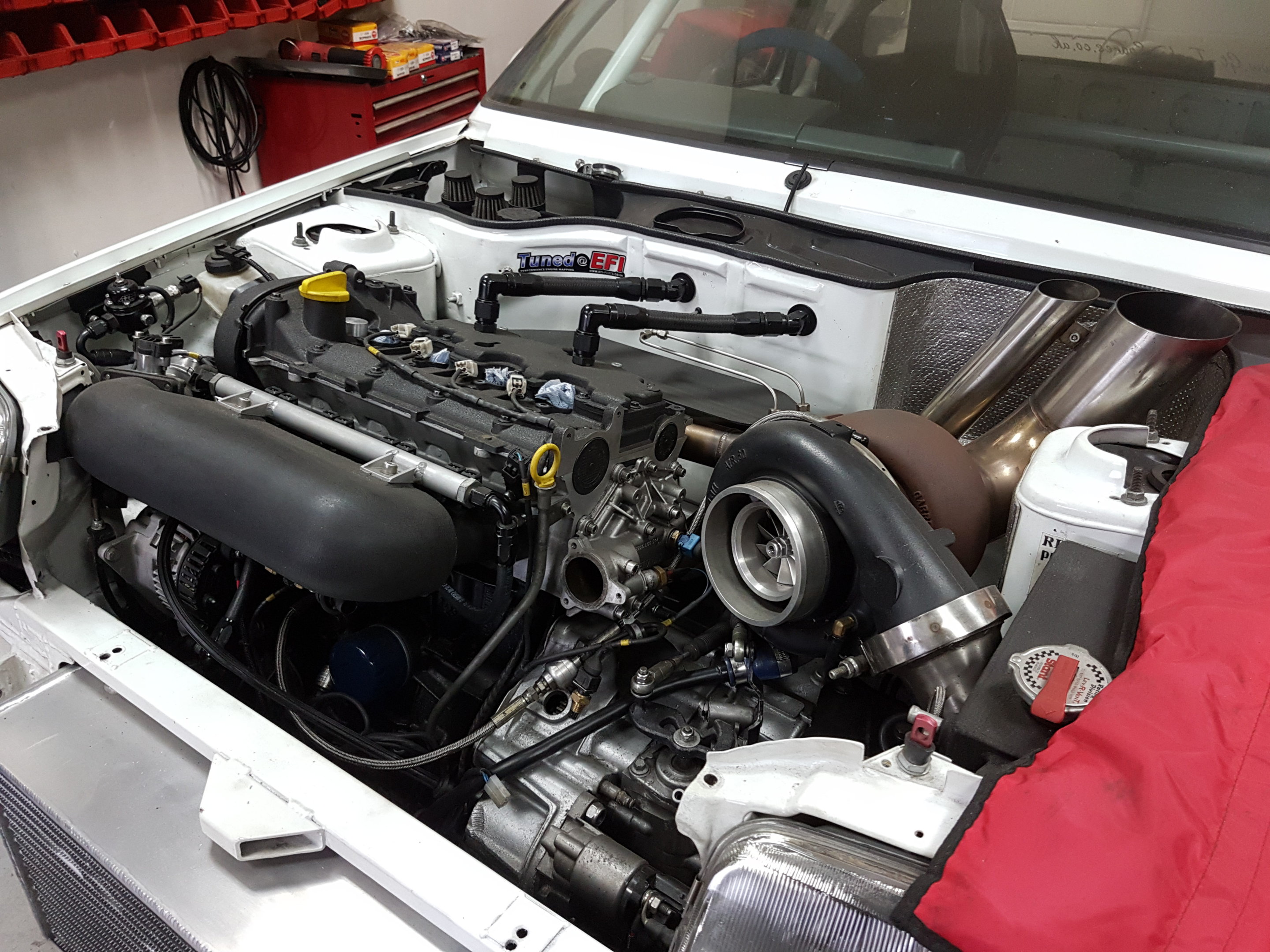

Does anyone know what the cam belt cover section is off , the bit that normally has the upper engine mount on it ?

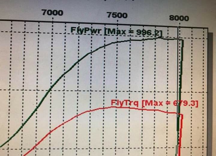

863hp at 44psi
996hp at 55psi :eek:

This latest iteration consists of a Clio 172 engine block and a Clio 200 cylinder head. Everything is worked of course. In a nutshell: Concrete filled engine block (no water), my own design 20mm thick girdle plate/main cap brace, I-beam rods, forged pistons, dry deck cylinder head, electric water pump for the head only, solid lifters, custom cams. VVT blank, 2x 2200cc injectors per cylinder, GTX4202 turbo @ 55psi and running on methanol.
I think he's about 400hp ahead of any other F4R i've ever seen (although granted this has limited application!), and fact the next most powerful 5 i've seen in the last 2 decades is Robbie Byrnes 1.8L F7R (Clio valver lump) at a smidge over 600hp. The most power I ever saw out of a 5 with the original pushrod 1.4 though was still Glenns >400hp lump (also tuned by Chris @ EFI)
