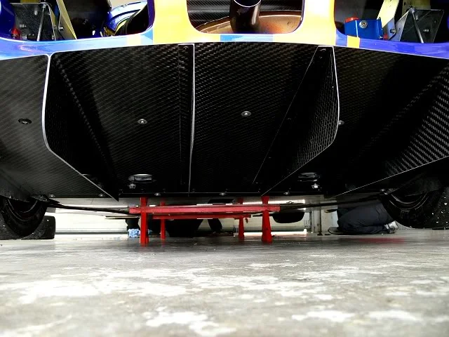

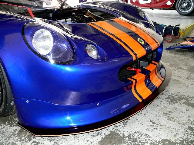

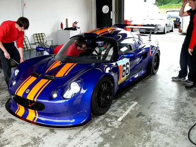

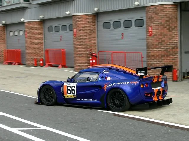

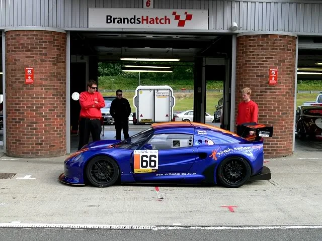

We're at Spa next week for a long race so with the engine doing about as much it can, the team had a think about a new aero package. The Elise had a stock Motorsport body, whereas the BMWs etc. in our series are considerably wider than their production counterparts, so we thought we deserved a few bits!

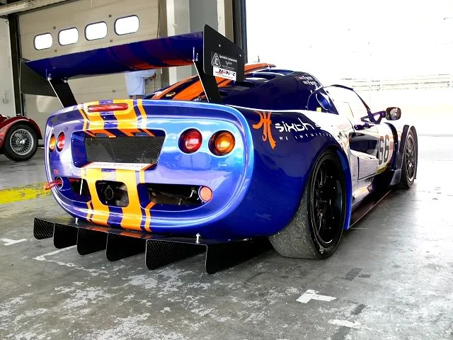

So, the car now has a long diffuser, fully covered underfloor and new splitter. The barge boards on the side increase floor area, which means more air and ultimately more downforce (in addition to the other bits).

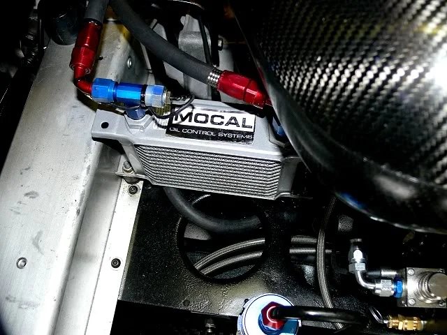

The previous underfloor had NACA ducts to cool the gearbox etc., so in order to be safe, the gearbox now has its own cooler.

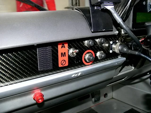

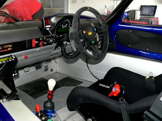

Its the first time i had been in the car with the sequential's paddles now working. The geartronics system has an 'A' for Auto mode which means upshifts are done without me needing to do anything!
The interior is starting to fill with buttons mind you! The gearlever is left in just in case something goes wrong with the paddles...

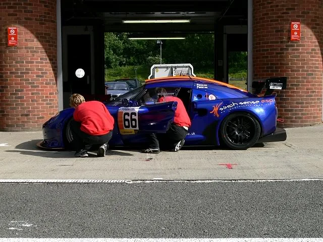

I went out for the first two sessons. A sensor going meant i pulled off on the first corner, so not the greatest start! The ECU was tricked to ignore it and after 10 mins i was back on circuit, eventually setting a best of 51.2 seconds by lunch.

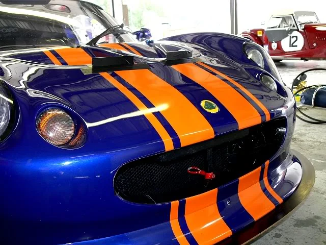

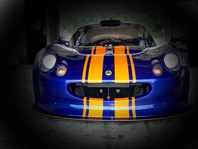

It was then time to hand over to our tame racing driver who will be co-piloting at Spa. The eagle eyed will notice the fog light holes have been removed, so we played around with the front to see how the rad would react to less/more air.
James was then on his way and managed to eventually get to a 50.4 second lap after tweaking the setup. The aero package had increased downforce but brought in slight understeer...

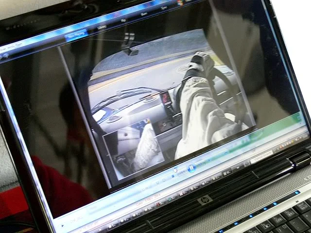

We viewed datalogging to see any areas room for improvement, i told James to stop being a pussy round Druids!
Everything went well, just hoping it all sticks together for the Spa race now!

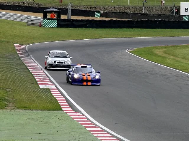

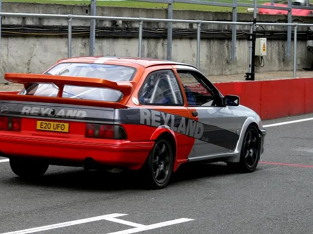

An interesting car on a personal level was the Reyland Cossie...
It sounded like a hurricane so not sure what power its packing, but the litle Elise was more than match!

Those aero additions look great! Any idea how much time they've saved over a lap?
Cheers!
About a second at Brands. Doesn't sound much, but on a longer track (i.e Spa!) the difference would be more marked. The sequential is worth a second or two as well.

Elise looks great. Love the central driving position! Is there a pump associated with the gearbox cooler? Someone was trying to get something sorted for the G40 gear boxes but the idea stalled when they couldn't get a hold of a suitable oil pump for a sensible price...though given the extent of the modification to the aero I doubt you were penny pinching with the gearbox cooler.
Wow. Nice car. Great opportunity racing it at spa. Like the work you've done. You going to play with the rear ARB to try and control the understeer?
A second at Brands Indy is very impressive if you ask me! Bolt on pre-developed parts or custom made?
In all honesty, not got a clue! I just asked what the new cooler was far, i'm not very mechanically minded i'm afraid... :o
The diffuser is intended for a a Mk2 Exige racer and bodged to fit. It is the max length for regs, ideally it would protude slightly past the wing. The rest of it just a case of covering everything underneath based on well known principles.
It was the front ARB that was softened, and a little rear wing was taken off as it doesn't do that much. We might run without a wing at all later in the season and go for a CSL style boot lip instead.

From memory the Sierra is running ~600bhp
