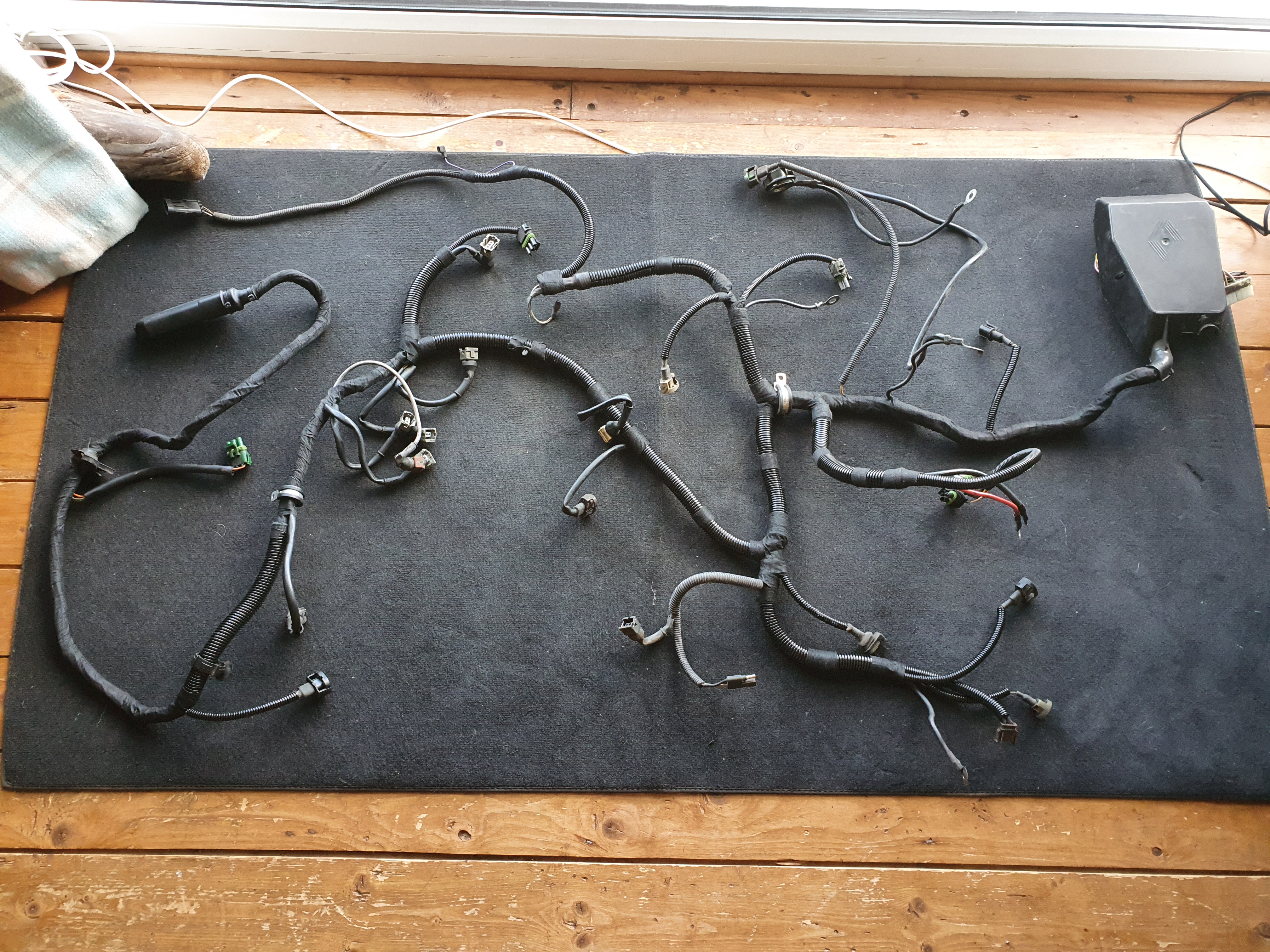

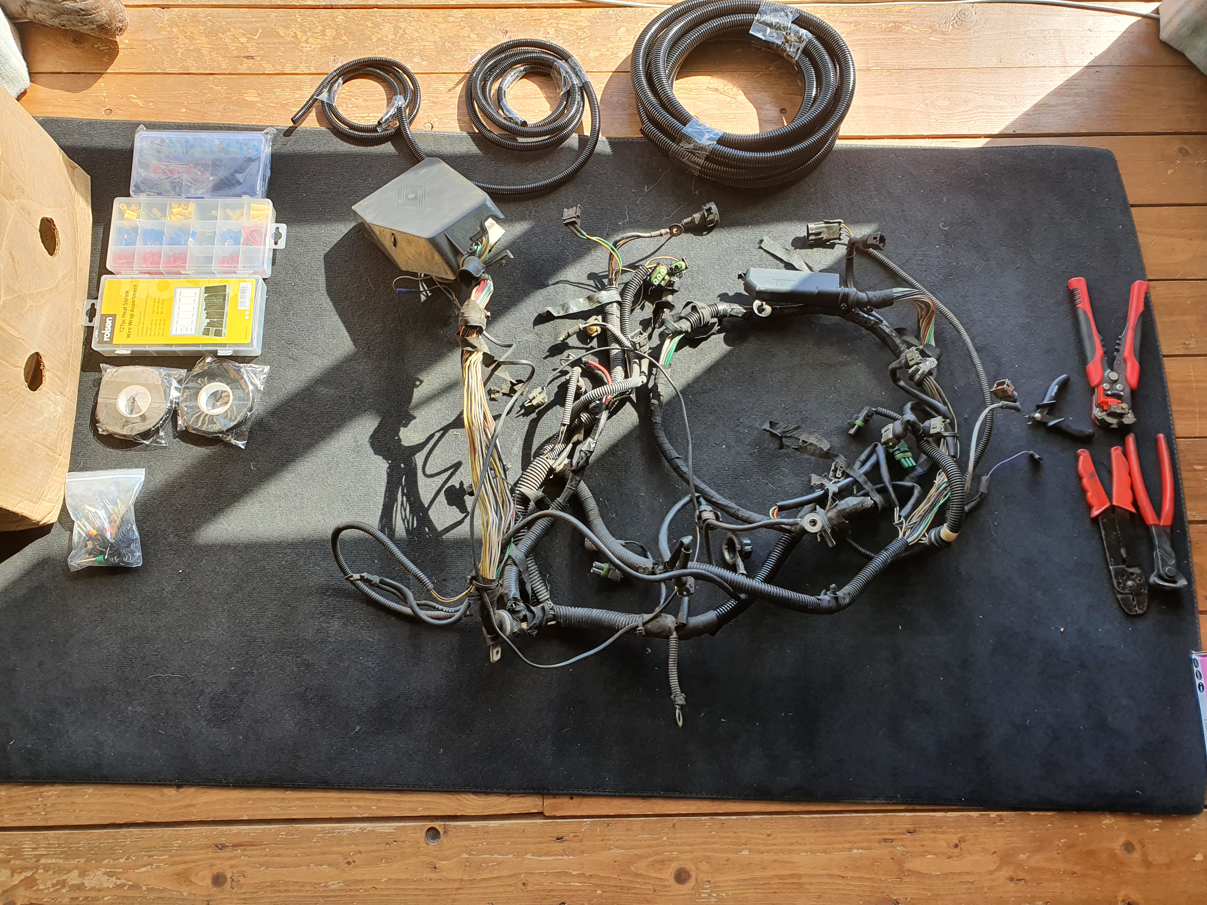

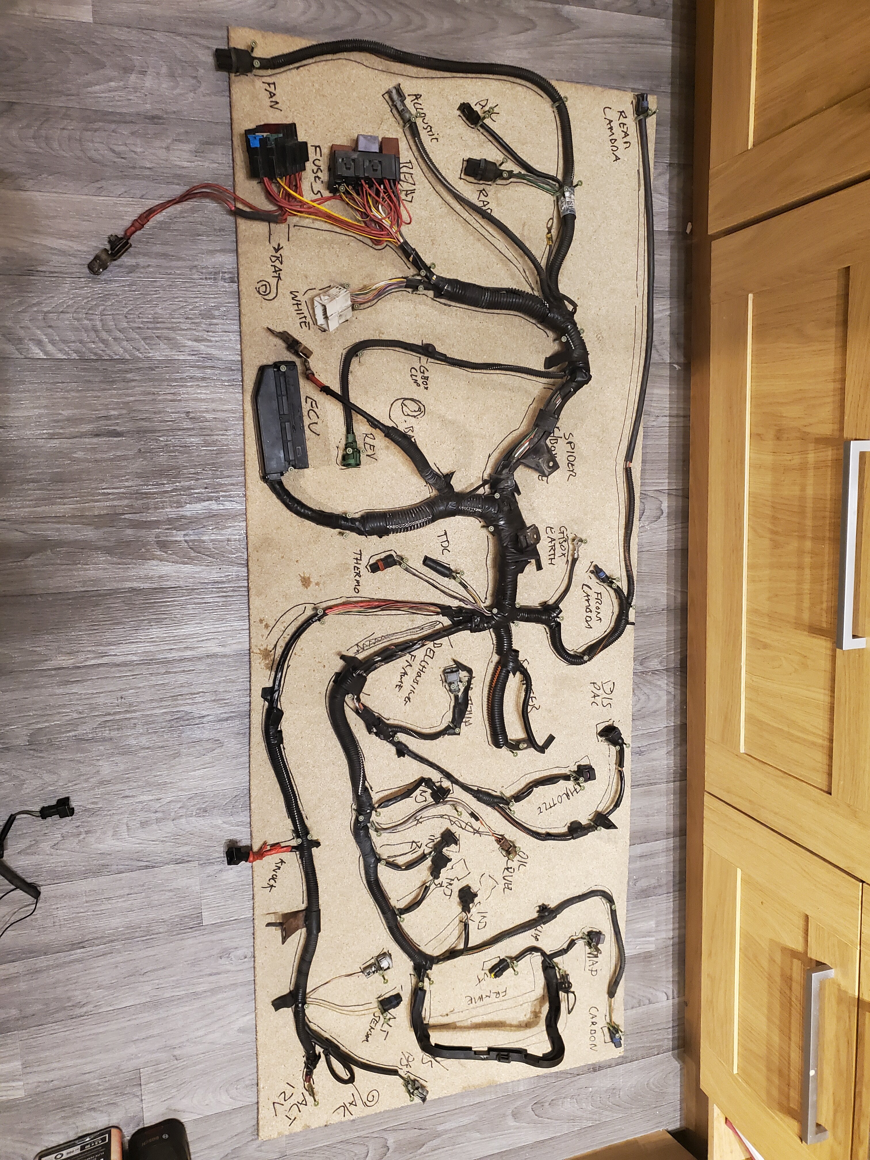

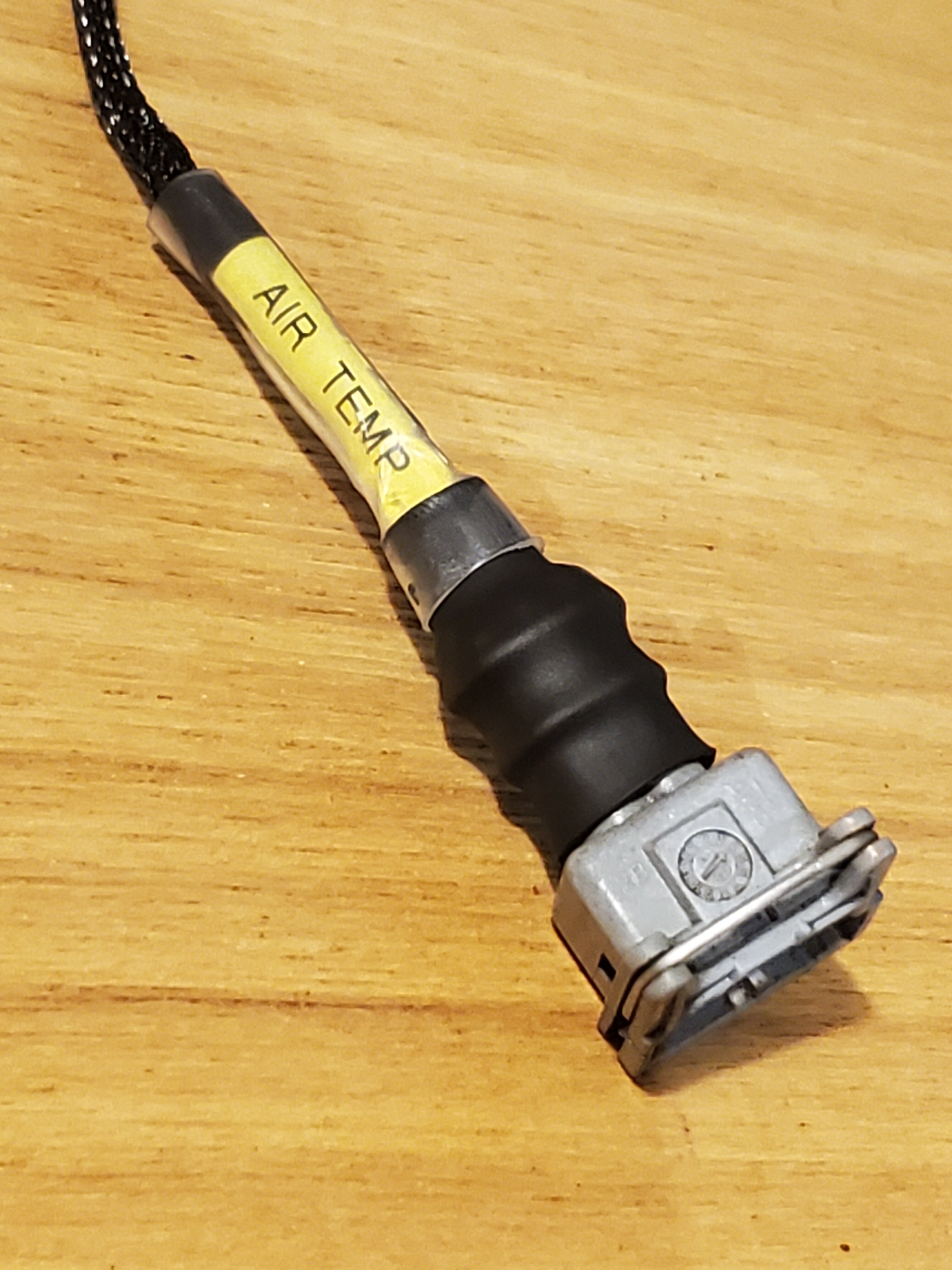

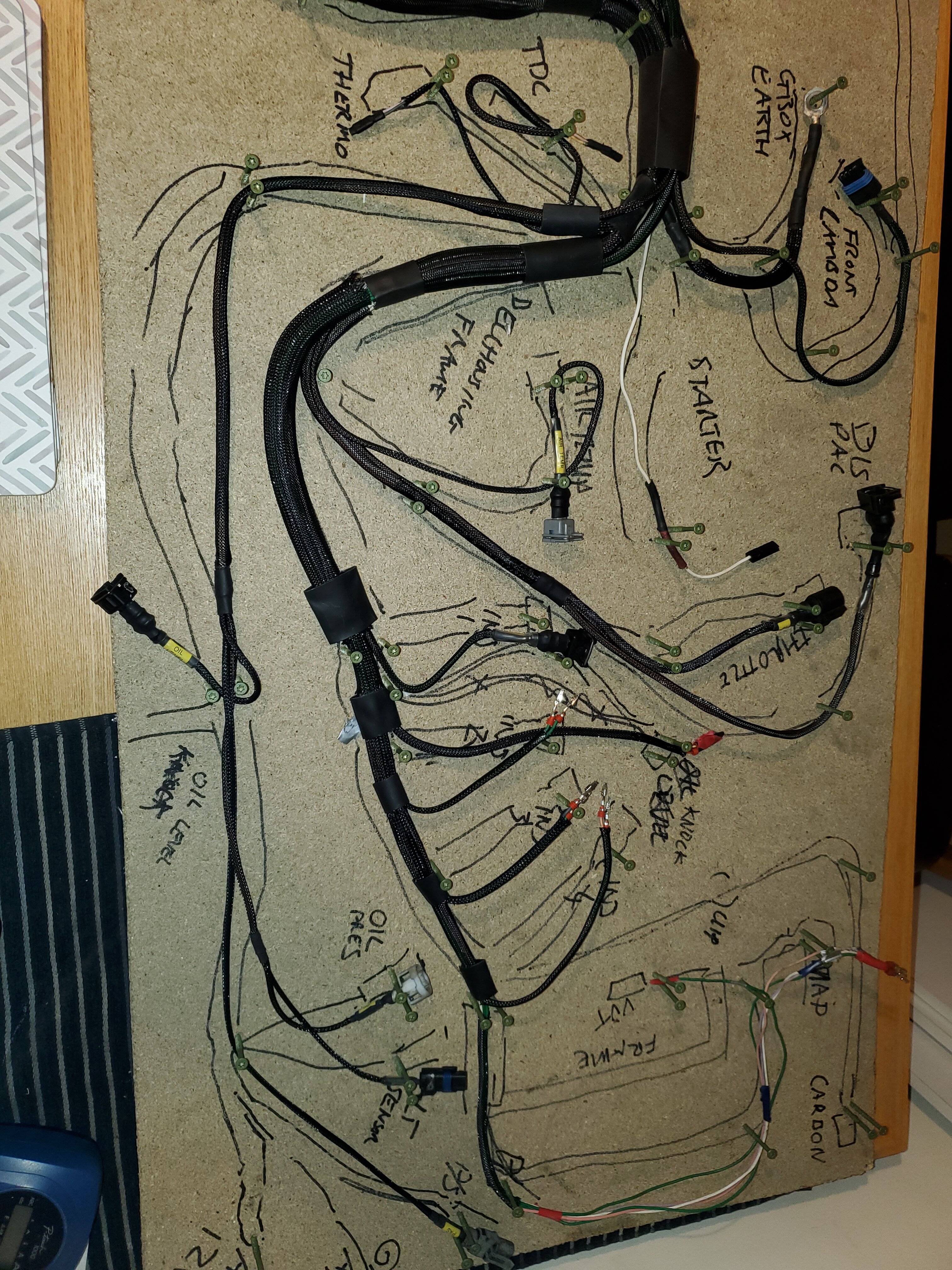

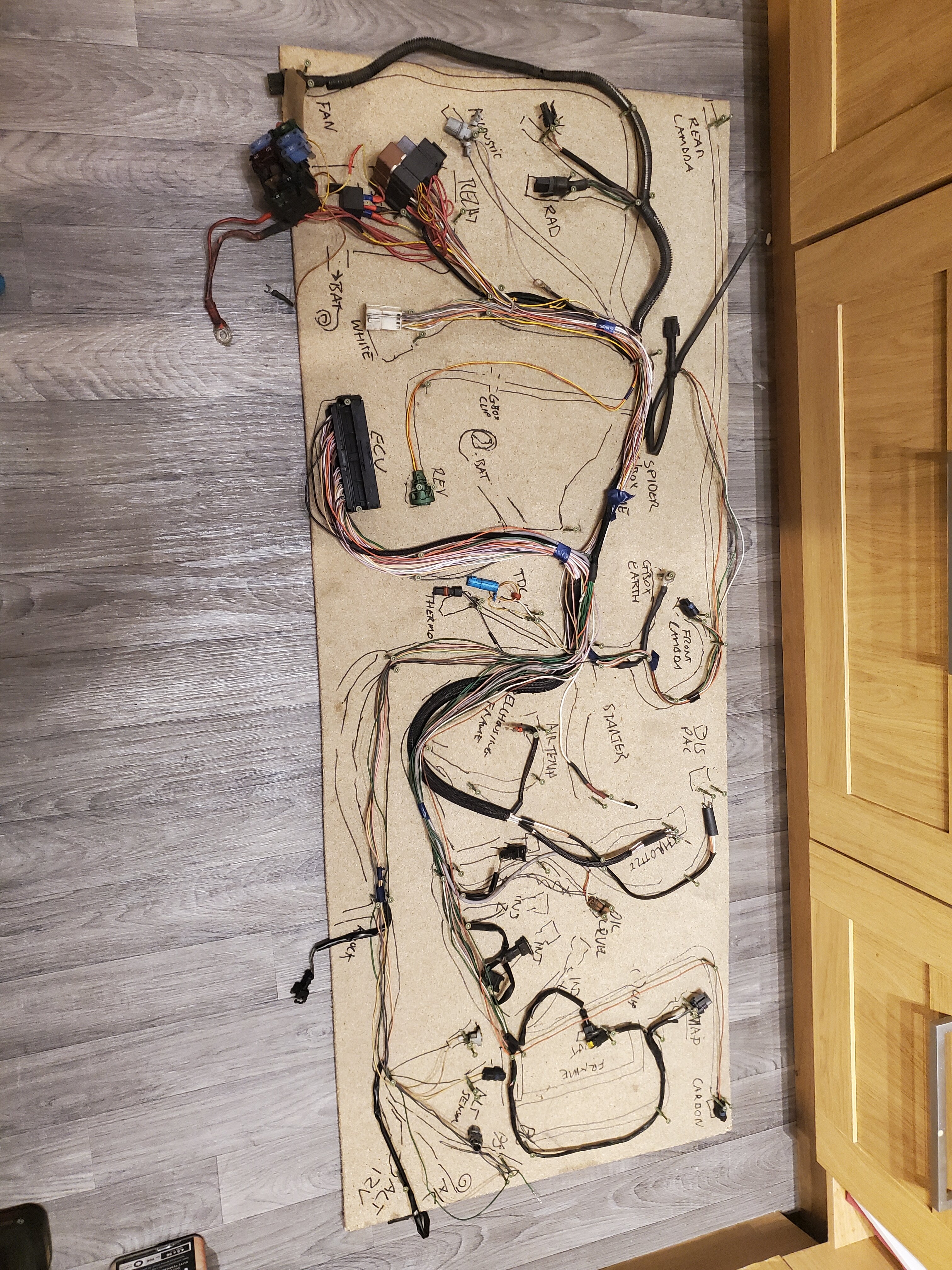

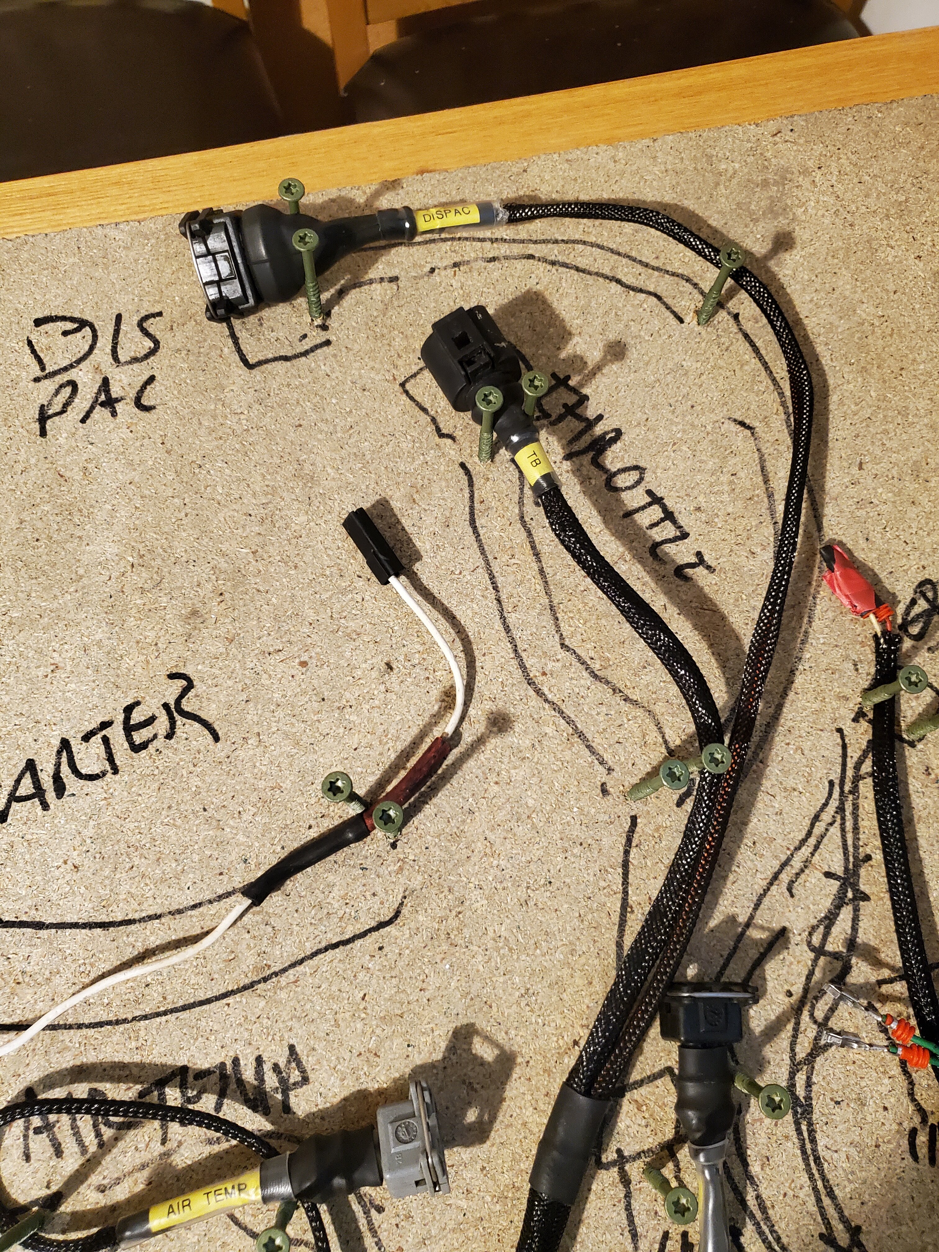

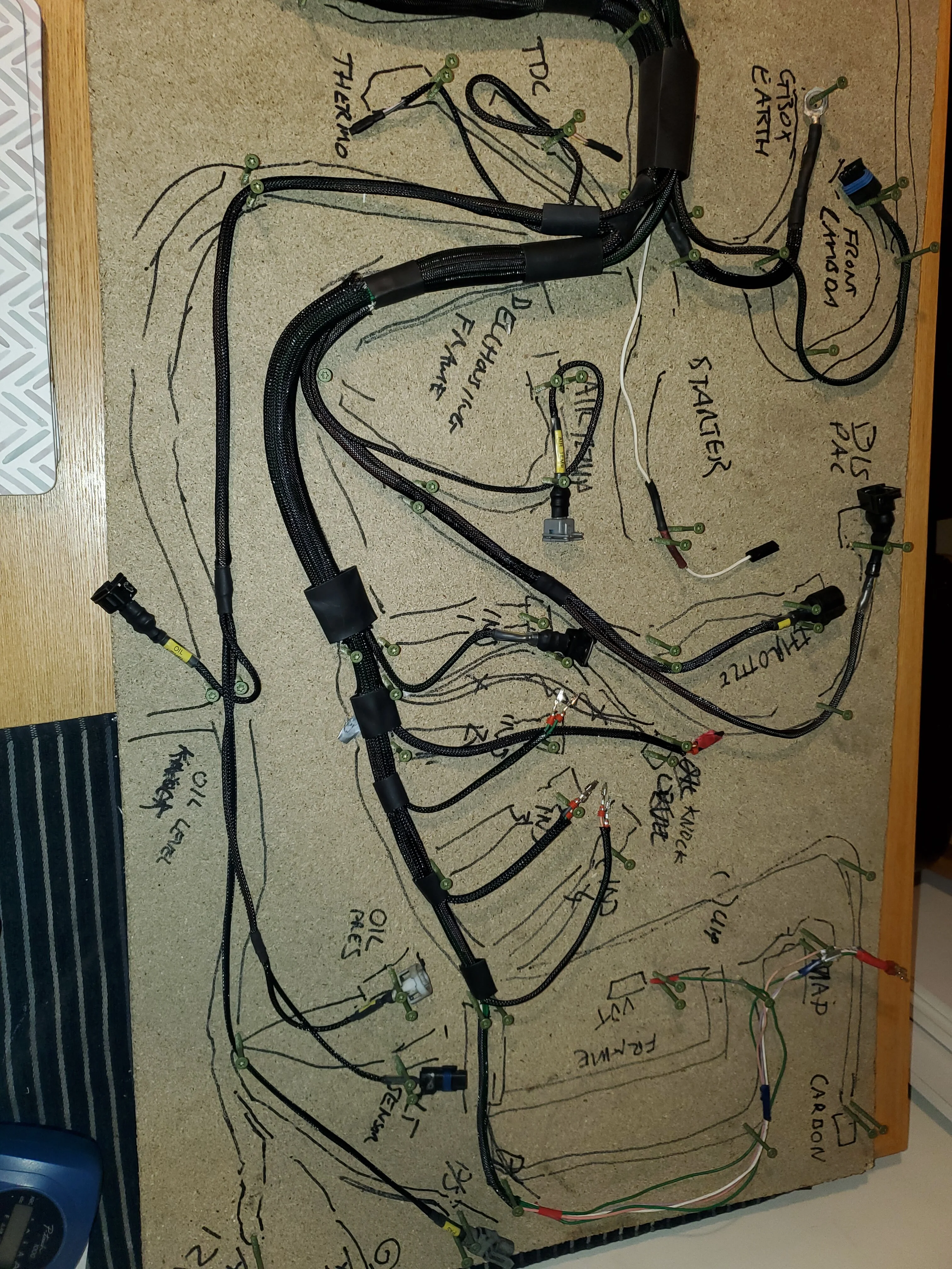

I re-sheathed my loom earlier on this year as I wanted 1) a winter job 2)an easier to diagnose easier to work with loom, 3) just something I always wanted to do.
I couldnt remove much as the 750 Race regs states OE loom must be retained, But I simplified it where I could tying back unused wires (AC, carbon canister, 2nd lambda, etc) back to one location. I used Durite overbraid as its a 'little' more heat resistant than the cheap ebay overbraid and not silly money. Used glue backed heat shrink then a Label write and Clear heat shrink to ID each connector.
That looks great and exactly what I hope to do. I’m going to do some spot tidying of what’s in view of the loom over the coming weeks. But longer term plan is to board a spare loom over the winter and do exactly as you have.
