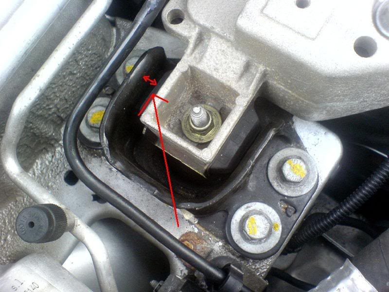

You can try moving the engine forward. Loosen the bolts on the drivers side mount pull the engine forward with the mount plate and re-tighten. It should have the gap show in the pic at the front of the mount, not the back (arrowed)if that makes sense.
also on that pic. undo the 4 bolts (16mm) and use a big bar to pull the engine to the front of the car as far as it will go. then nip them up tight!!
watch the aicon pipes
Can also stick a washer underneath the bolts as well as the mounts start to sag after a while, or something along those lines.

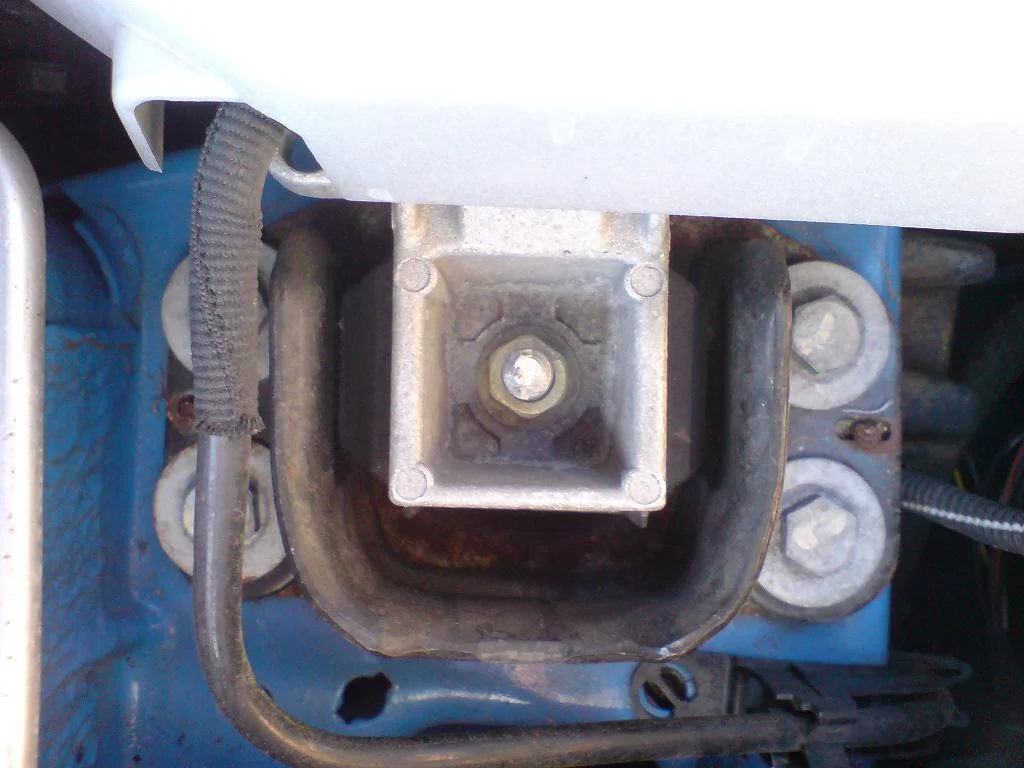

OK. So this is what mine is like at present. I take it that the whole mount moves forwards, not the inner part with the rubber on each side?
^Hmmm I cant see that moving much anymore, you already have the majority of the gap at the front. You can check the otherside under the battery, that will move a little too, if your still getting the problem it could be the lower gearbox dogbone mount.
Ok cool. I'll check the other two mounts next time I have a day off. What am I looking for in the other mounts? Ovalled bolt holes? Perished rubber?
