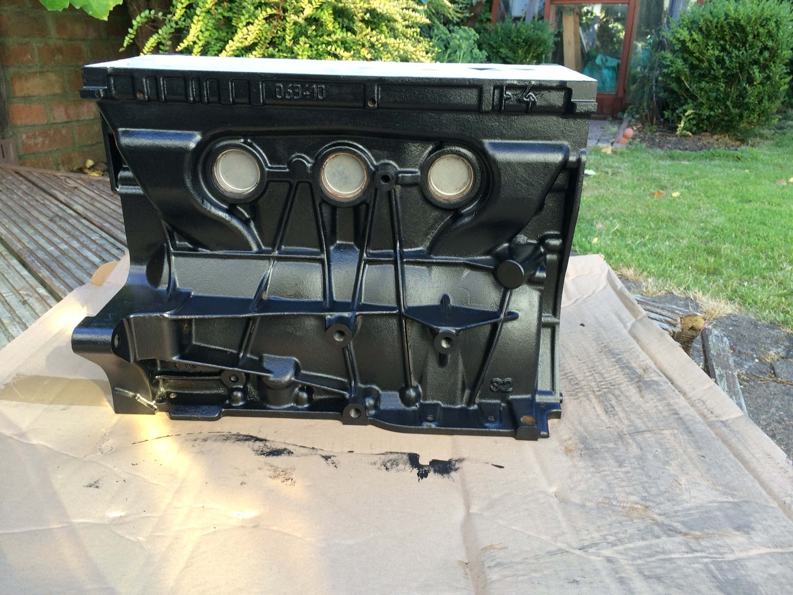

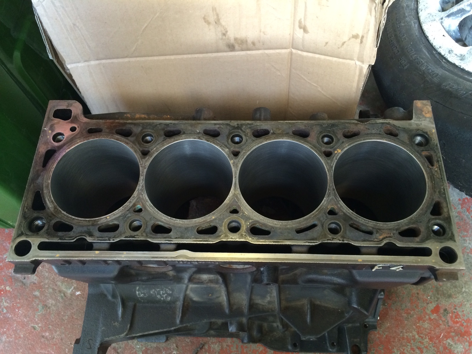

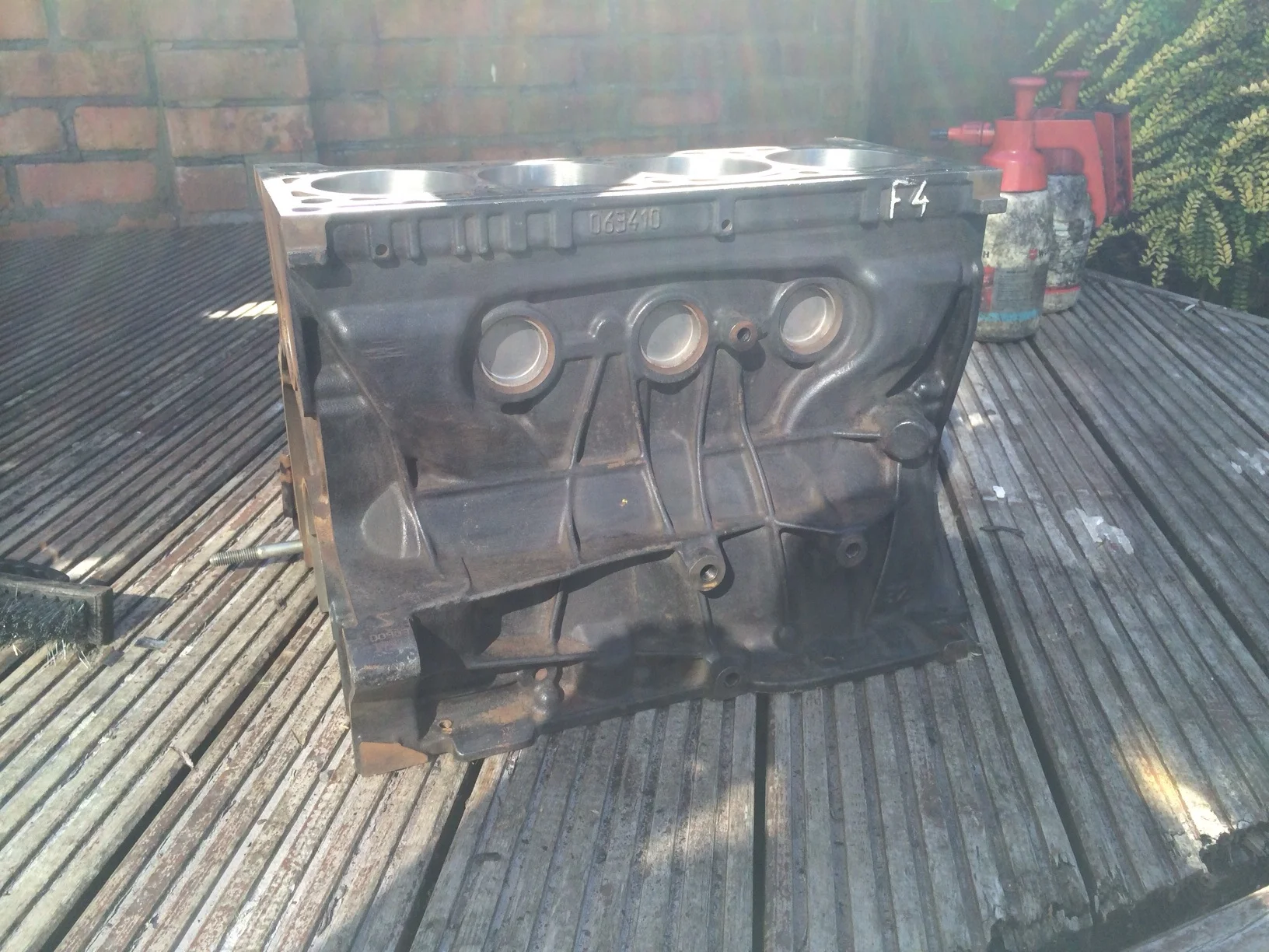

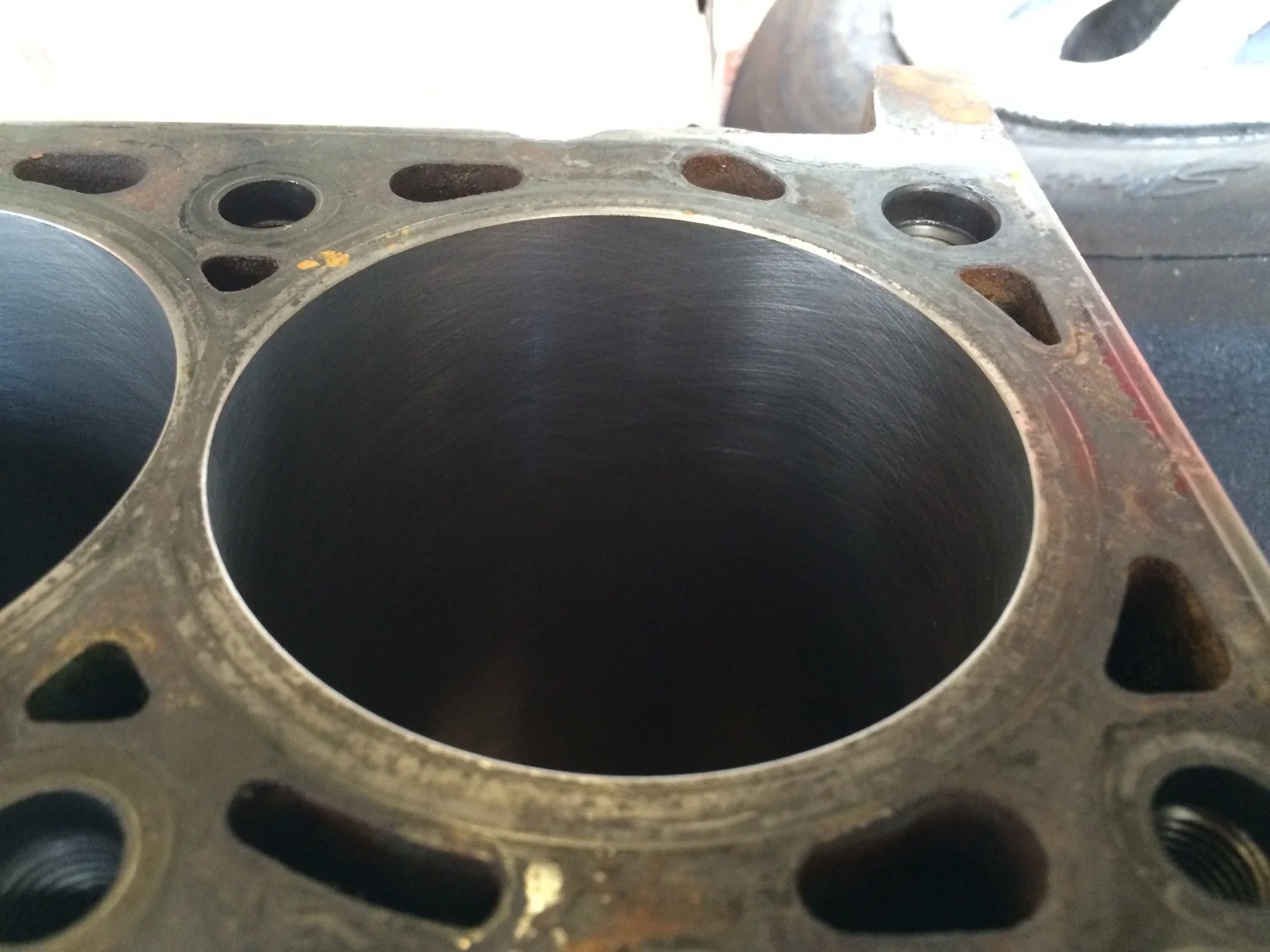

I got my block back after being bored out to ~84mm and set about cleaning it up ready for paint.
After one coat of high-temperature enamel paint I think it came out OK...

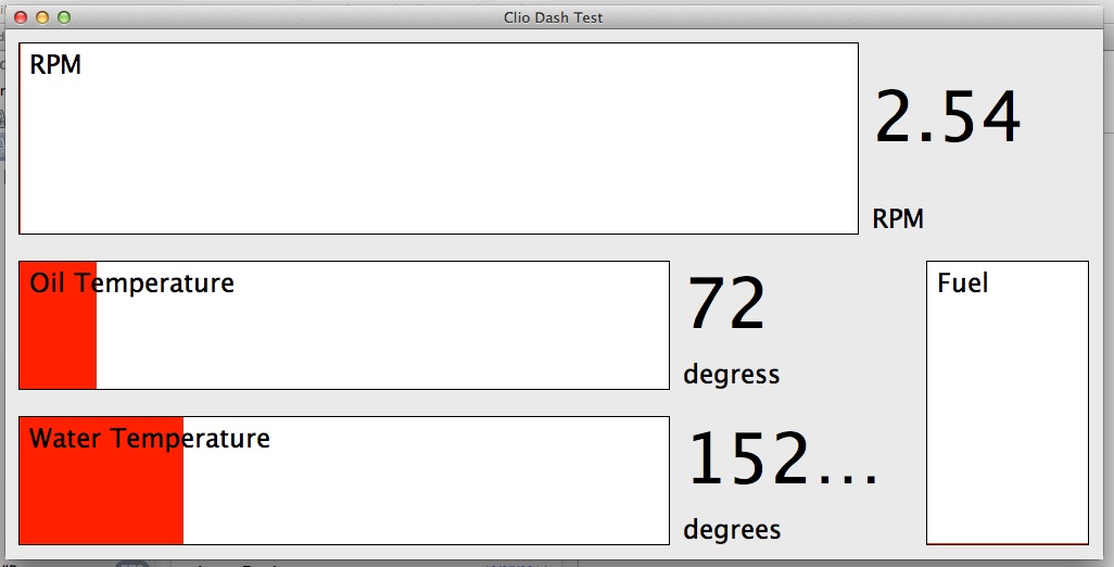

Haha, yeah thanks mate, I've already built the UI, ignore the randomly generated information...

Yeah, it's Java at the moment, but I need to test the performance on Linux/arm on the Pi. The update rate may not be ideal.
Plus, the above screenshot is a real beta, it will look a bit nicer and more polished when finished
