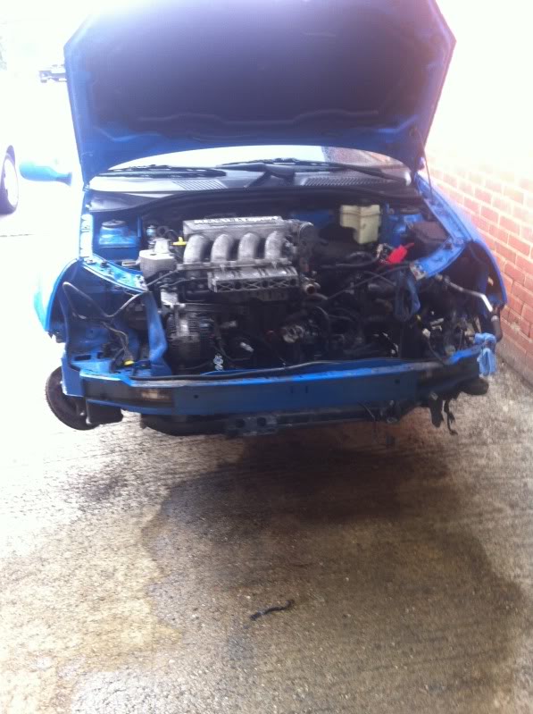

Well she's stripped and I've just picked up the crane to lift it out tomorrow.
Just trying to work out all the parts needed and she will be alive again and it gives me a good chance to clean the bay.

Why didn't you just unbolt A/C compressor and PAS pump from the block and leave it all hanging? Saves time, money and helps to get the engine out easier
It makes no odds to me really. No rush getting it out or back in again as its a second car.
With regards to new AC gas or power steering fluid I don't pay for those so it's no more of a financial drain.
Also the guide I read on here never mentioned removing them from block.

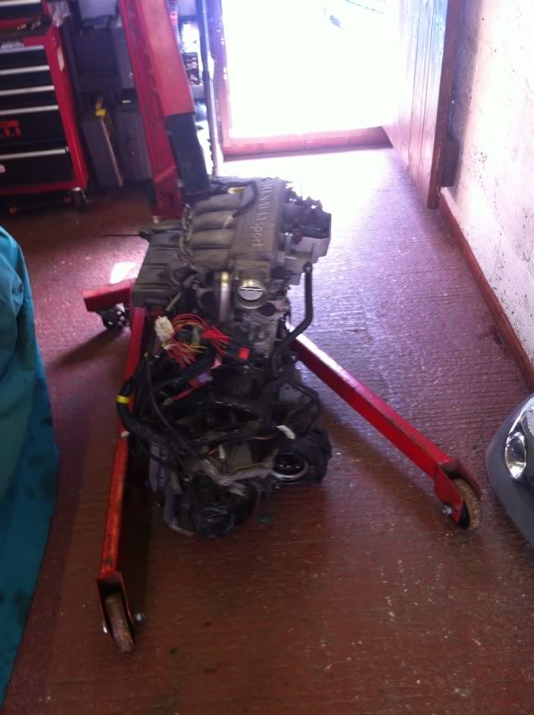

Just got the engine out. Alternator and pump were removed as suggested. Far to tight to take it out with them fitted.
i have slight play in the dephaser so I hope that's the issue found.
