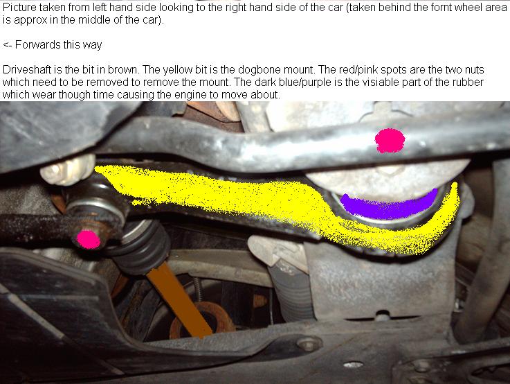

Nope its your dogbone mount causing the problems. Its under the car attaching the gearbox to the firwall of the car. (I'll get a picture in a second)
£35 or so for one from Renault

ok thanks m8, such a quick reply! would really appreciate the picture of the dogbone, have u got any of it from looking underneath the car?

I'll pop down now and get a picture.
Here's a not very good picture of the part only 2 bolts hold it in.

Edde, i got a picture of mine from under the car earlier, gonna upload it in a sec. Can you tell by looking at it, if it needs replacing?
From what you've said yes it does need replacing.
Cannot realy tell you need to remove it and see if the rubbers cracked.
