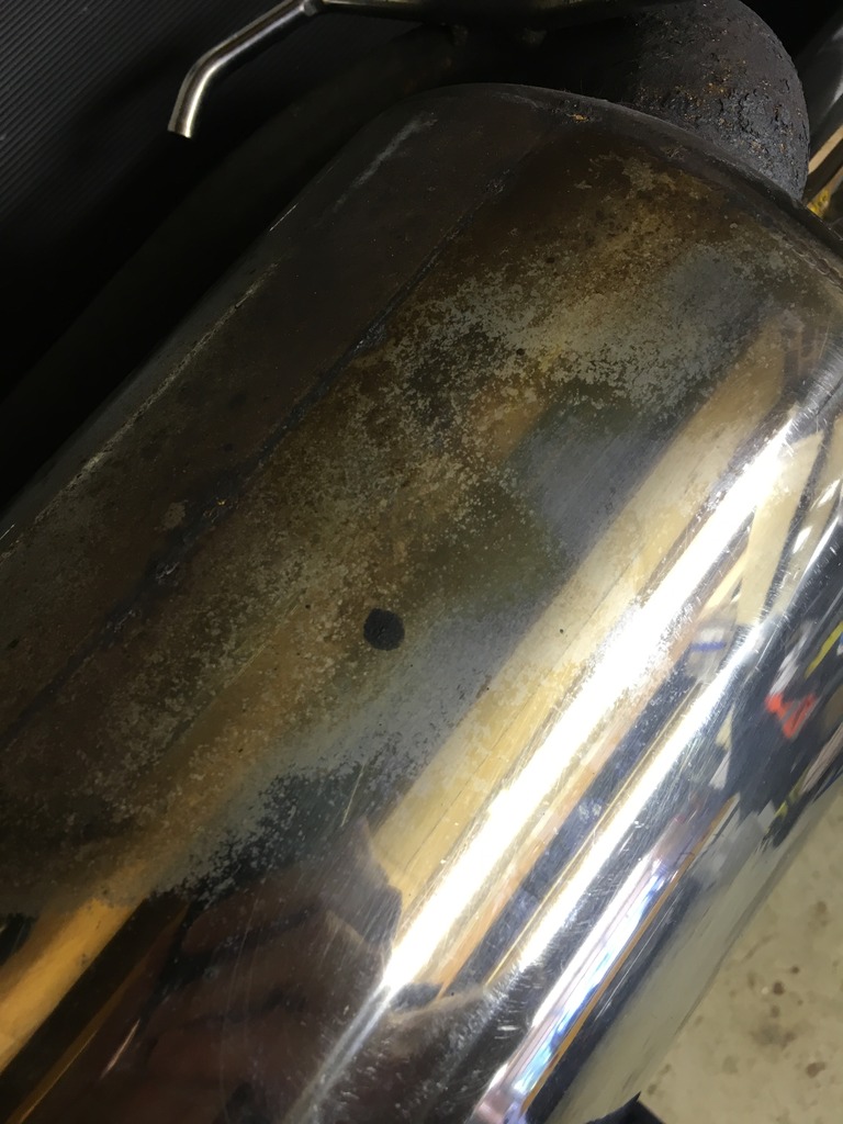

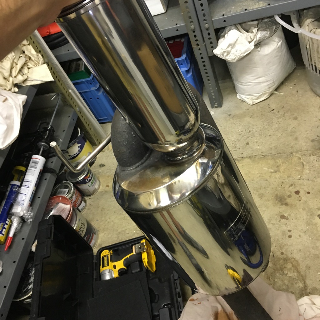

So I picked up a relatively cheap backbox for the Teg, and need to spruce up the box and tailpipes before I put it on.
What's best? I have autosol in the garage, and that brought some polished headlights back up to scratch. But I'm guessing an exhaust needs something more abrasive?

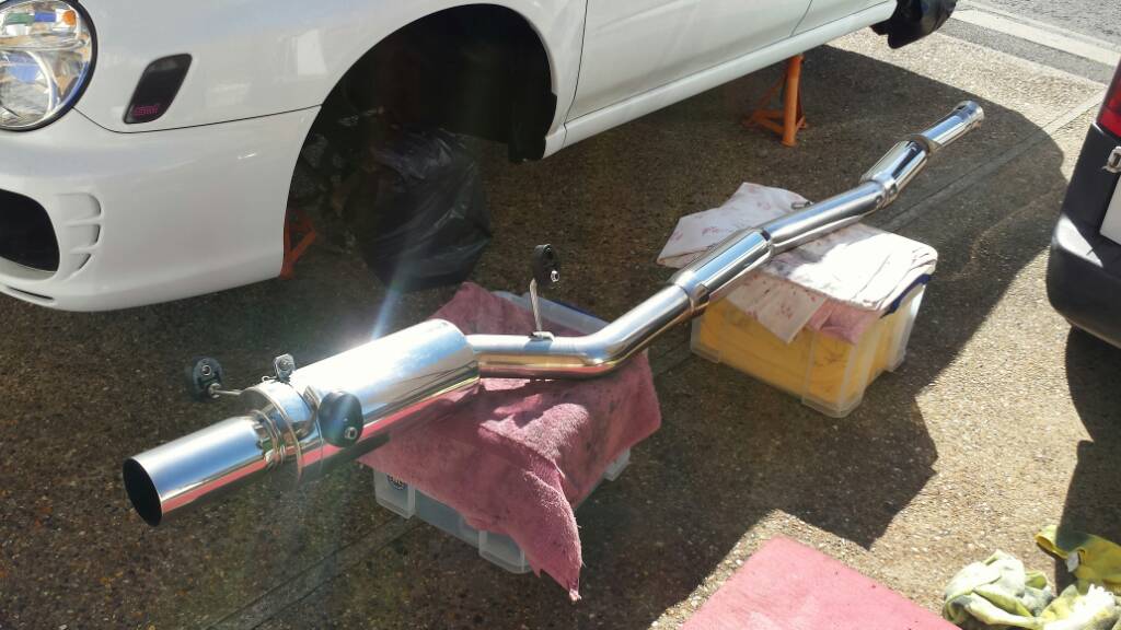

Pics for reference:

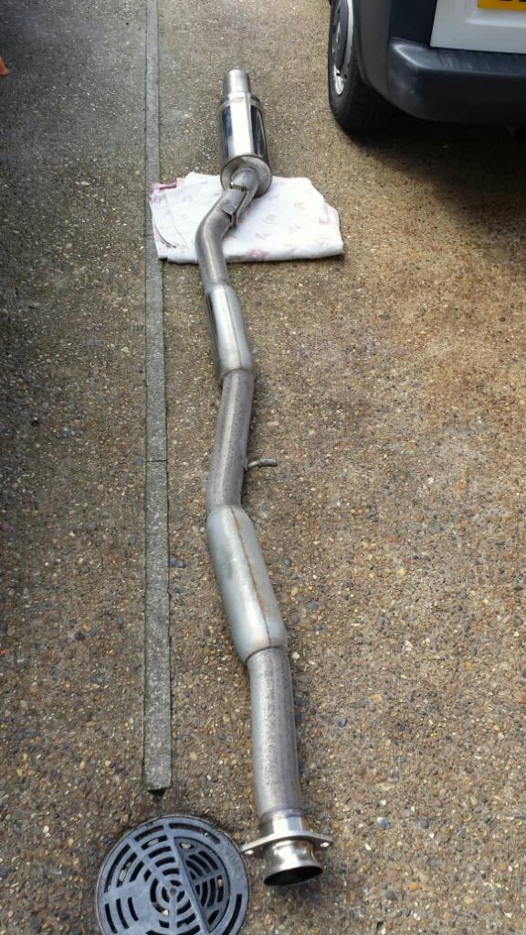

(Also, finally got a proper exhaust(ish) @Philip. :) )

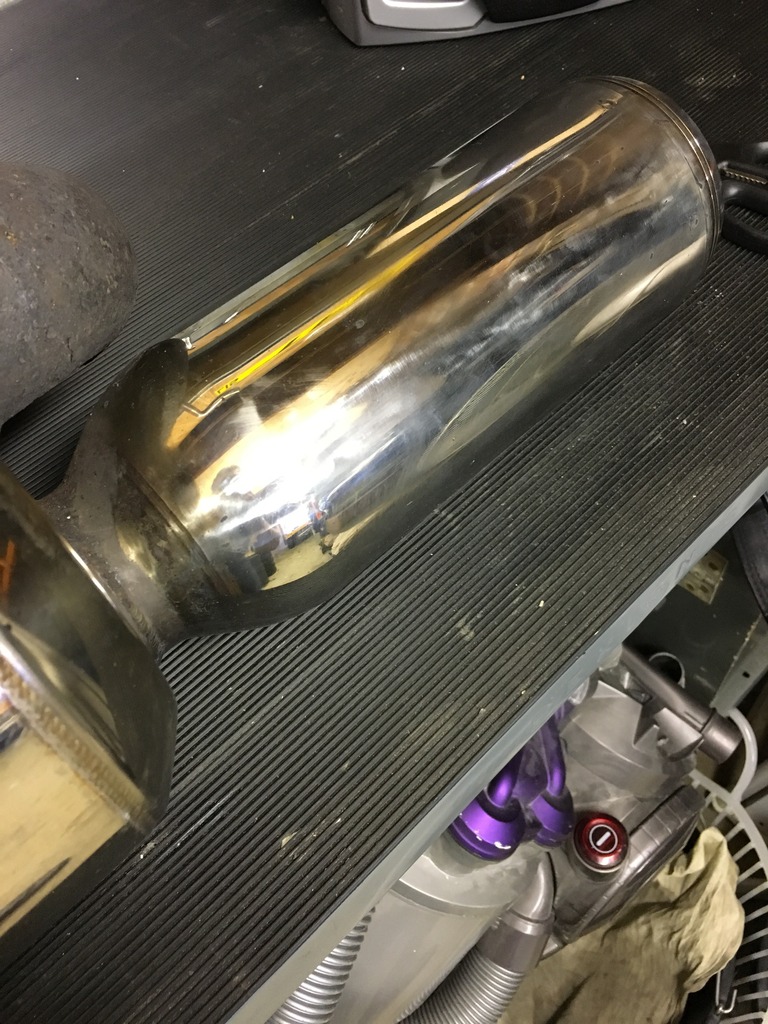

I use autosol and wire wool. I have the megs metal polish (yes it's spelt like that - no idea why!) but it's not as abrasive as the autosol.
I used this mate with fine wire wool.
From this.

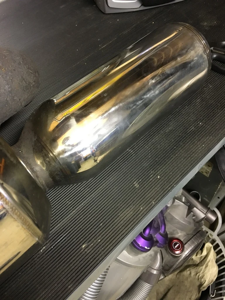

To this. [emoji41]
I use this stuff on my tips, never been bad enough to use wire wool so I just use a microfibre, comes up like new everytime. Brilliant stuff!

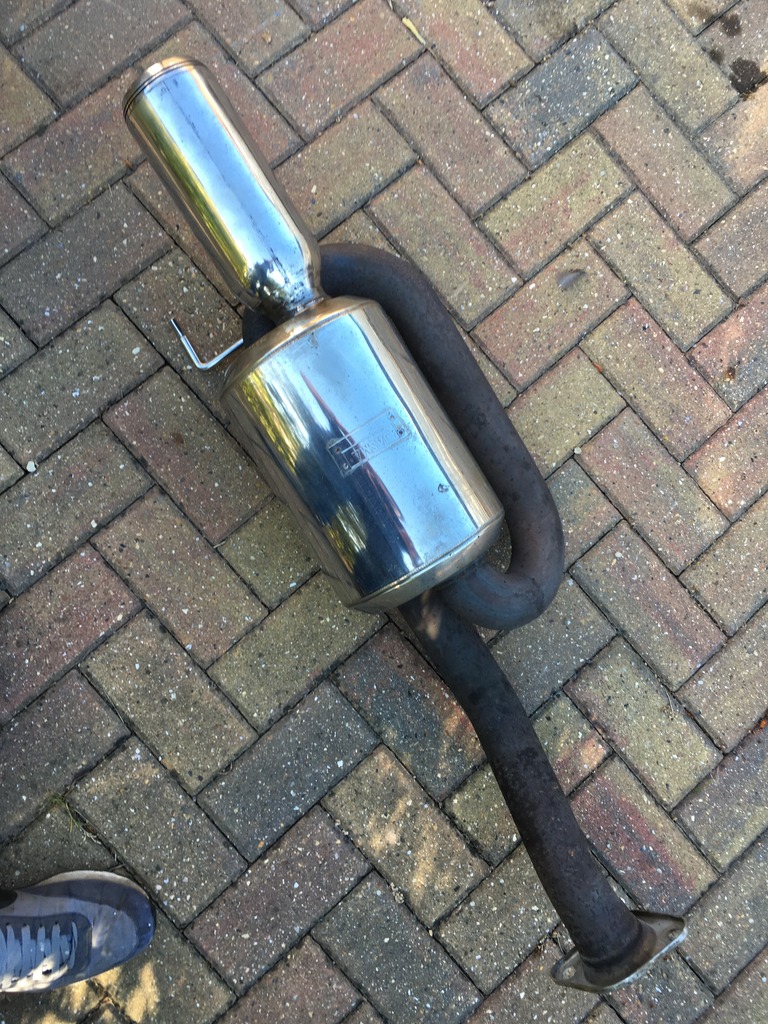

What's the idea behind the looped back box?
Is it for back pressure or to control noise?
I believe the twin loop is bypassed at high exhaust pressure/speed. But on idle and low rpm it loops twice and is therefore nice and (relatively) quiet.
