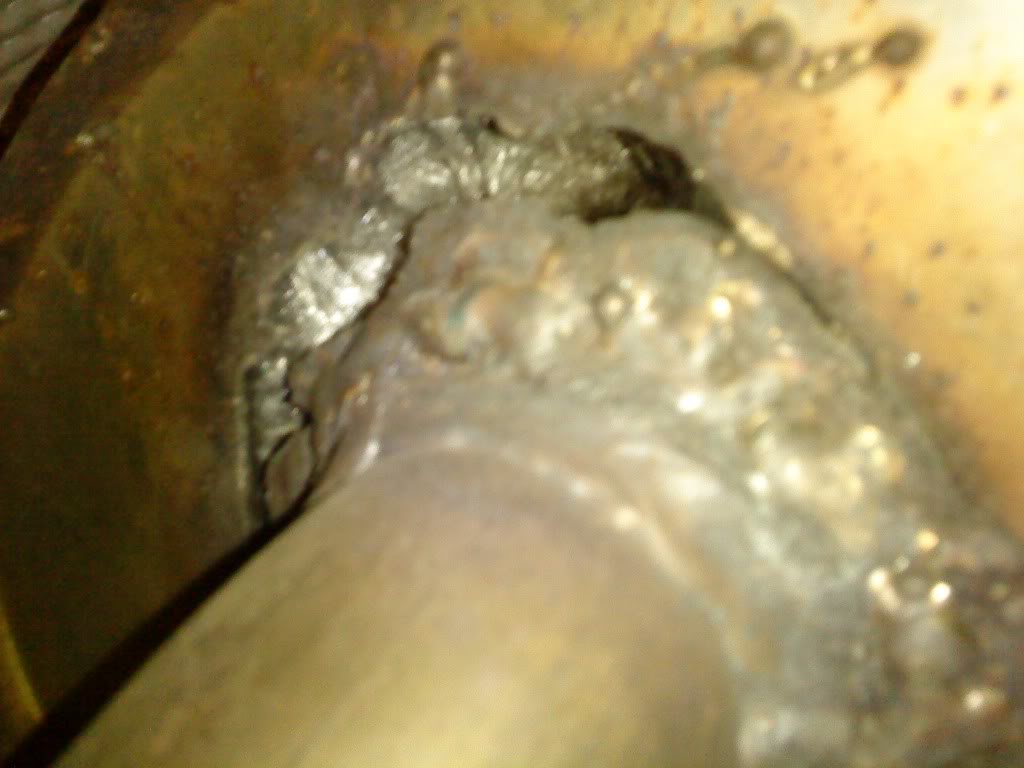

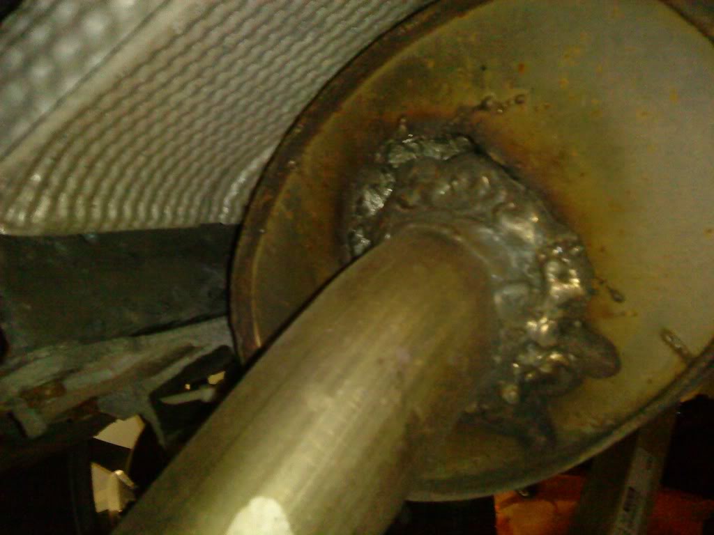

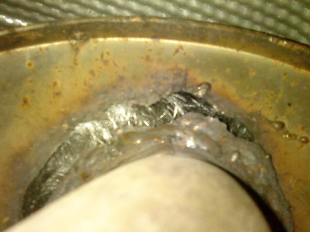

The car is fitted with a Milltek straight through exhaust system, which looks and sounded awesome. It was perfectly fitted when I picked it up and there was no way either me or the previous owner could have known this was about to happen… however the weld on the left backbox has now blown, and quite dramatically too - see pics.
Is this salvageable? It looks as though it may have been welded up before and failed again. If not does anyone know if Milltek supply just the backbox set up? (the centre straight through section is fine). Also can anyone recommend somewhere in the north west (manchester area preferably) or around northamptonshire (near my dad's in Rushden) who can fit a Milltek system well if I was going to get a new one?

Cracking welds on a miltek?!

Anyone know if this has got any hope of passing an MOT with some carefully place gun gum? Can you request which tailpipe they take the reading from?

it looks like a kindergarden-toddler has been given a welding tool in that pic! ! ! !
that's someone who has NEVER done a weld in their life before

Right, it's gun-gummed up now -*used a whole tin of the stuff! Fingers crossed it'll hold for a little while, if only to stop me going deaf until I find a replacement system!

Quick update on this*- supplied the part/batch number to Milltek and they're going to replace it FOC. Guess it was a part of their bad batch of exhausts with dodgy welds!

Yeah free replacement. I think the warranty does only apply to the first owner... however in this case it was a part of the notorious dodgy batch so they were happy to replace, didn't even have to ask, just enquired as to how much a new one was and explained what had happened
