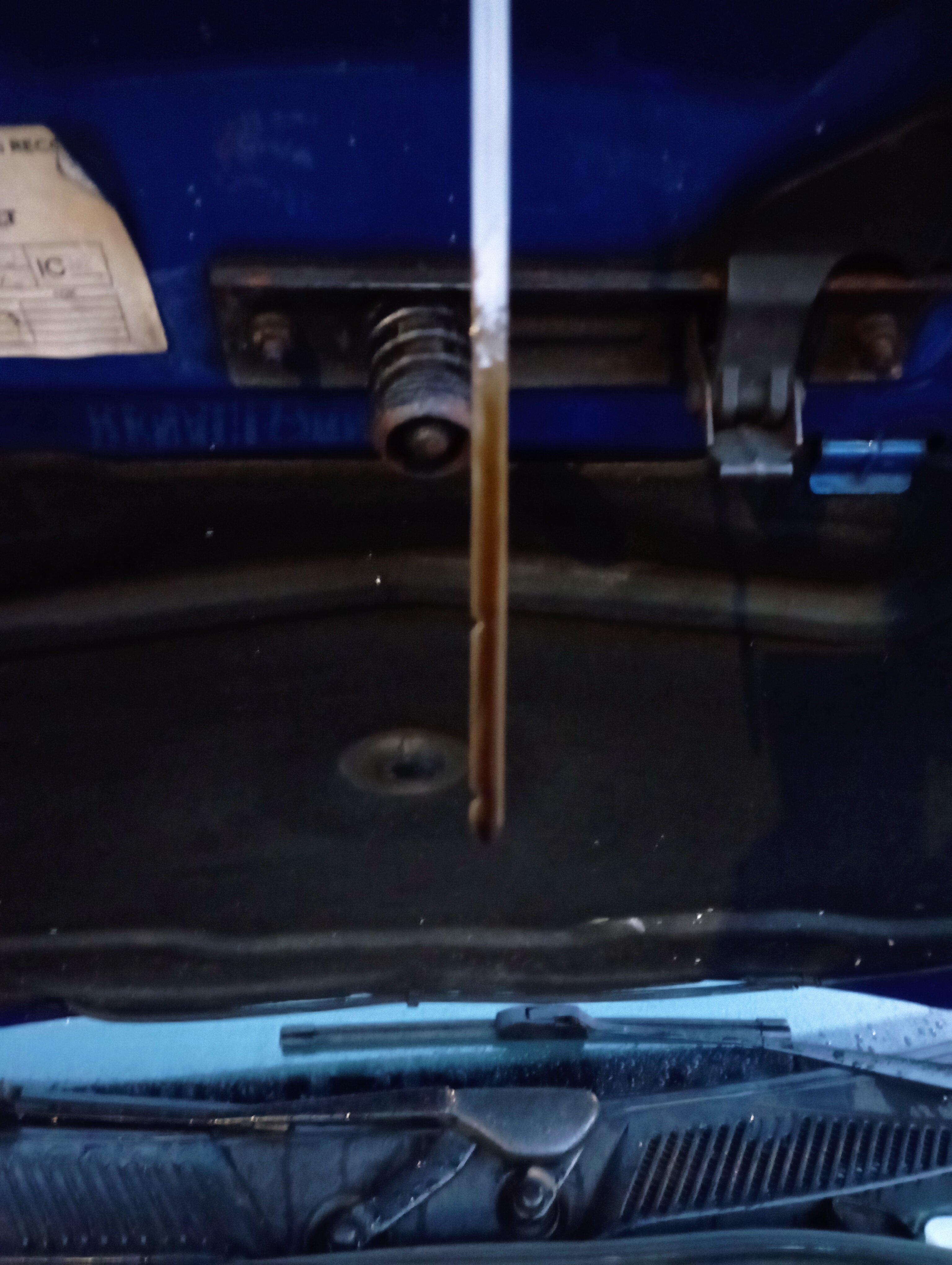

It's significantly overfilled. Looking at the dipstick this morning it's around twice the recommended amount so not a insignificant amount.

Never trust the digital readout, although mine is usually pretty accurate tbh.
Probably got 7 or more litres in it I'm guessing 😅
Drain it out to the correct level and see how you get on. The exhaust is going to smoke for quite a while, you'll need to get it hot.

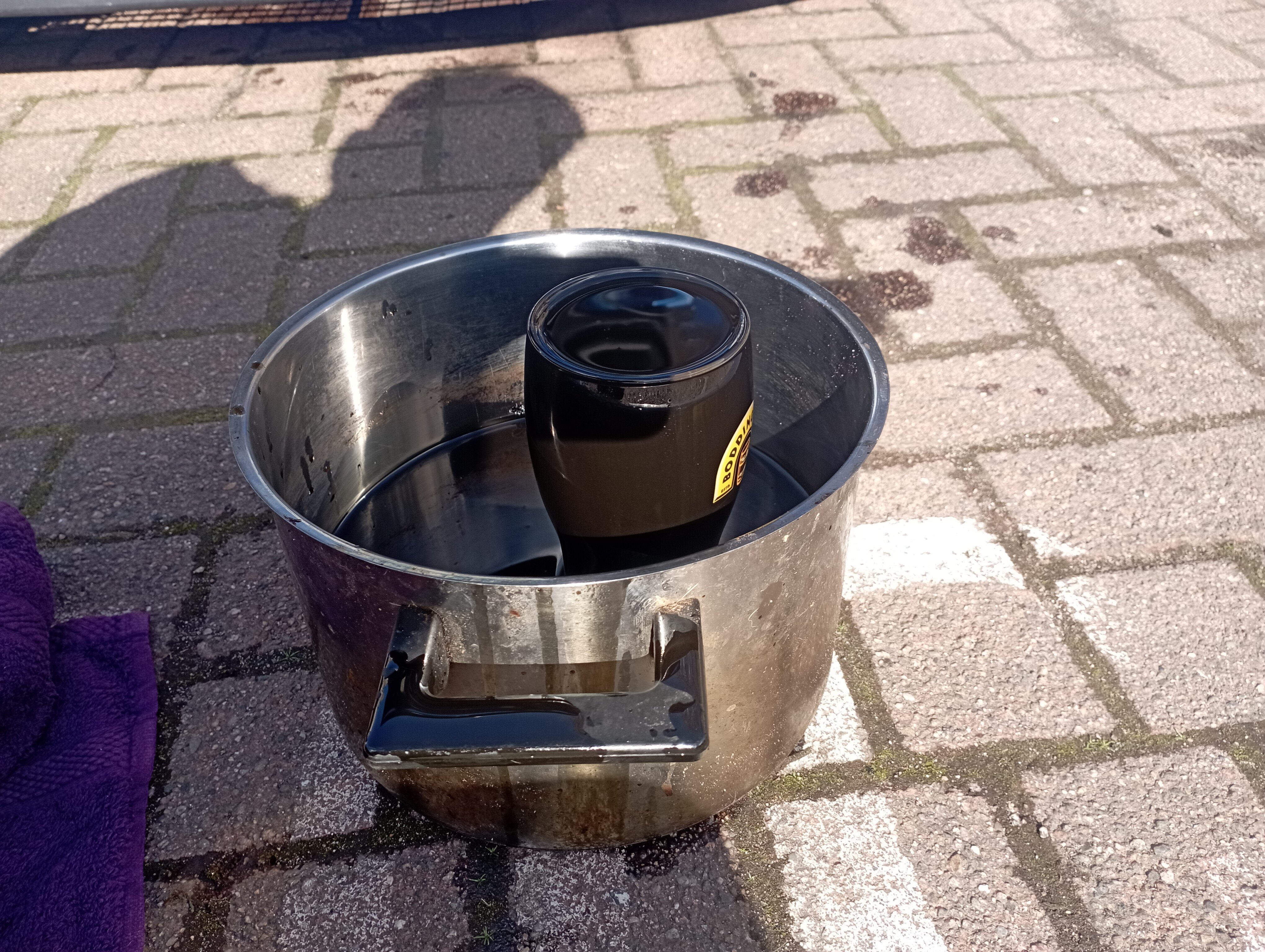

Looks like you got away with it with not driving too far 👍
How did you actually manage to put double the amount of oil in? 🤔 1 x 5 litre plus a little splash more is enough.

Here's a pic of the amount of oil I removed today. I was using the pint glass a guide on how much to remove cause that's a super scientific way of doing it 😎
