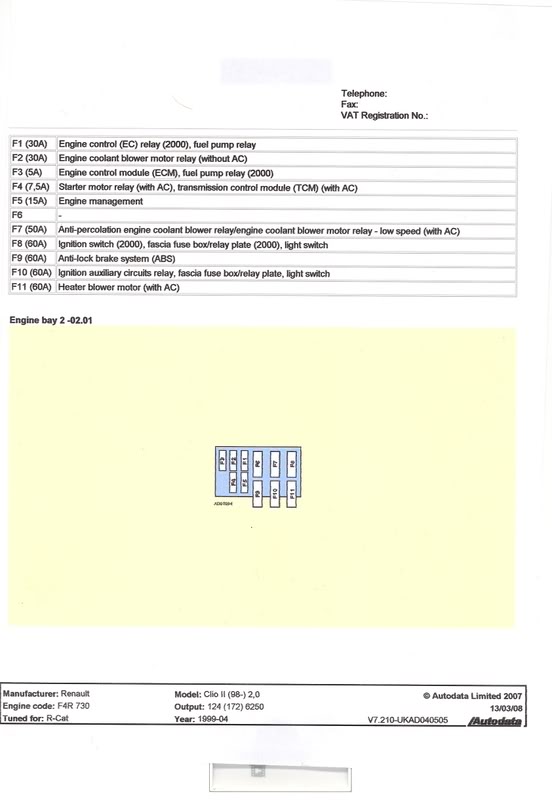

I am need of a hand, removed some wires and cant remember were they go. Opppps
Can any one take a photo or help me what goes were, i have just plugged them in any were for the photo its the three coloured plugs with the two 60 amp fuses and the 30 amp fuse.

Ive managed to get a photo froM RSC.
That does help as the fuse 9 is the ABS and i have removed that ;)
